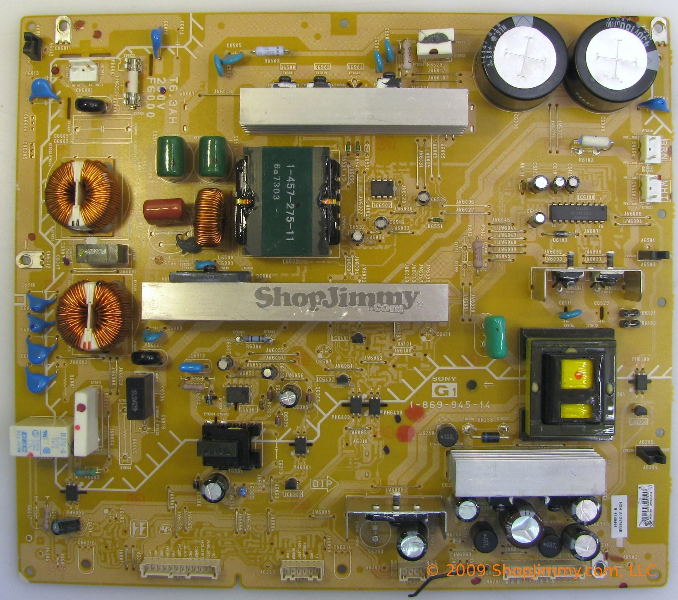

        This is a picture of the main power board

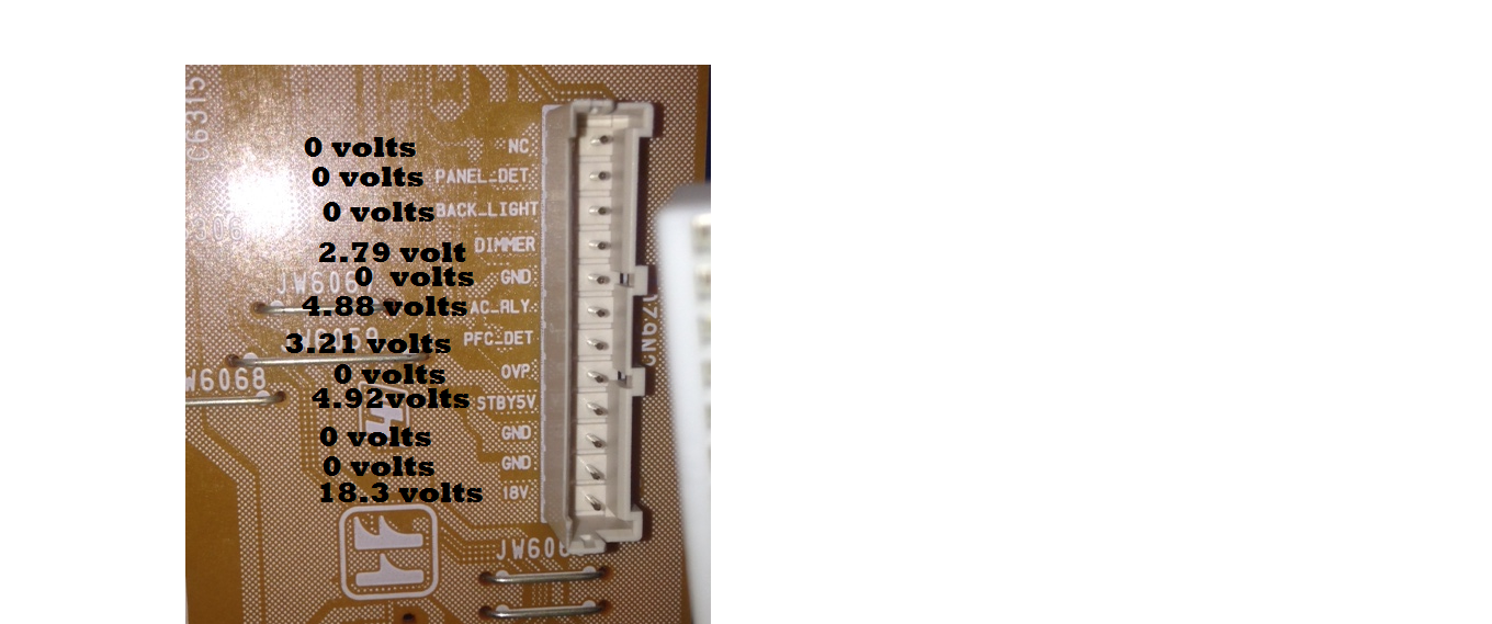

          This is a close up picture on pins that I measured voltage on power board the pin that says back light had 0 voltage the pin that had Panel had 0 voltage the pin that had Dimmer had like 3 or 4 volts

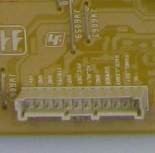

              Im having a issue posting close up picture sorry. I will try again.
              • bluedawg
                Bluedawg
                • Mar 2015
                • 60
                • united states
                Re: sony tv kdl 46 xbr2 no video or sound
                Hopefully this works

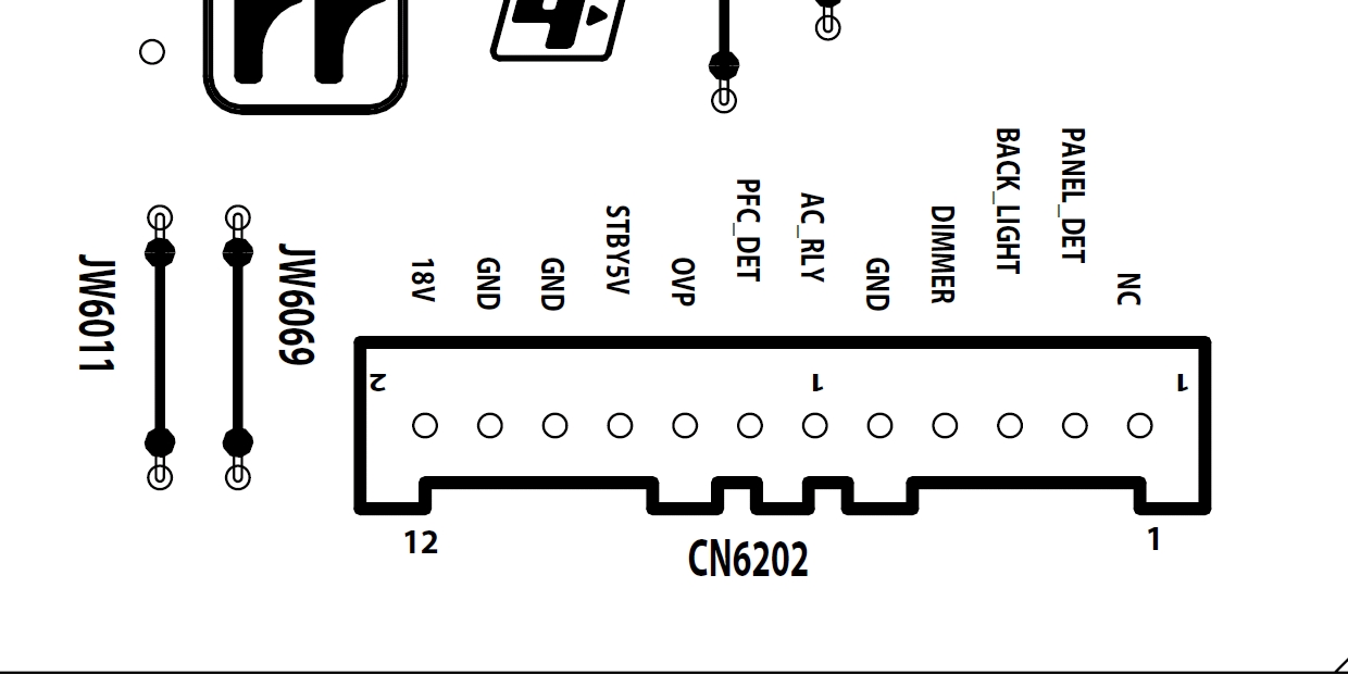

                      Pictures of the connector is too blurry to read the pin names.
                      So what exact DCV do you have on each pin of CN6202? No LED error codes either?

                          Mr Budm here is the voltage at the pins u requested with power button pressed and power on. Hopefully this will tell you something so you can help me
                            #33
                            OK, so the main board is not sending the backlights on signal so there will be no panel detect signal.
                            How about the DCV of 7VDC, 11VDC on the connector CN4000? Do you have them? See G1 diagram I already provided.

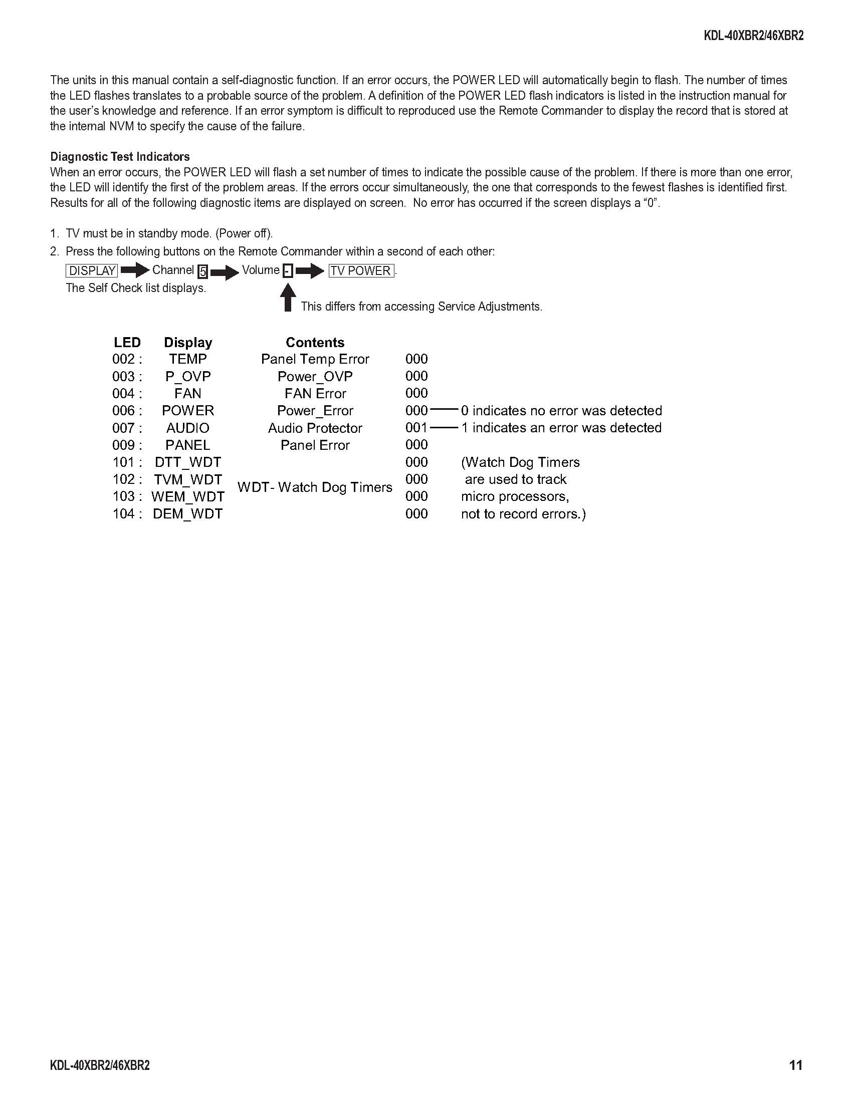

                                Do you get error code if the T-CON board is disconnected? Right now I expect to see error code due to to the no panel detect signal which should have trigger the error code, I wonder if the firmware is corrupted.

                                  #36
                                  I will unhook the tconn board tonight and see if i get a error code. There is no flashing lights at all on front only a on green light and the sony light. And as i said theres a tiny orange led on main digital board where tconn connector leaves main board that is blinking non stop but can only be seen from back of tv
