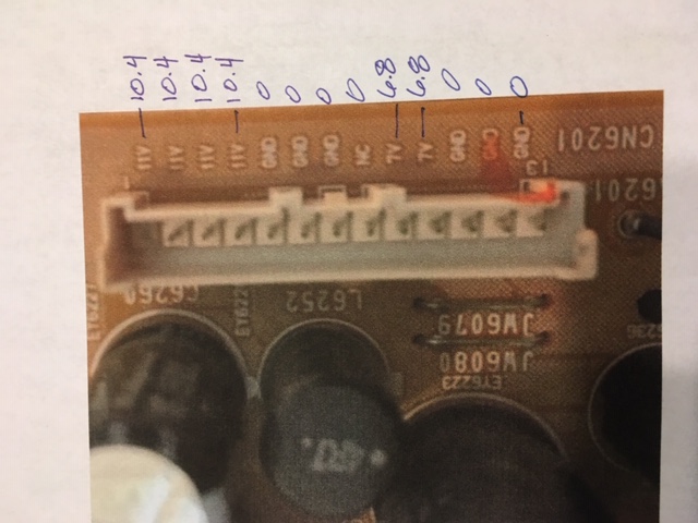

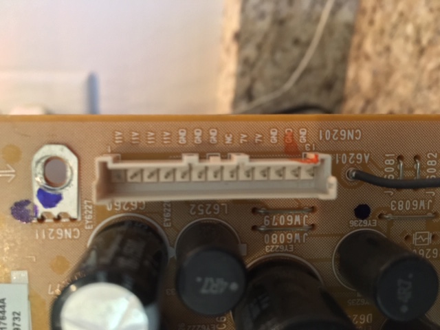

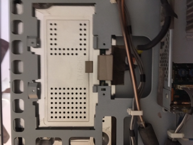

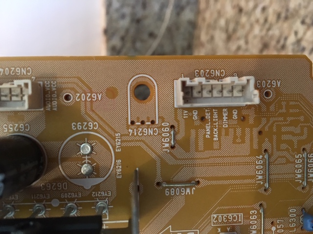

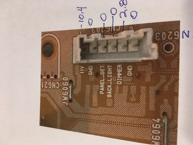

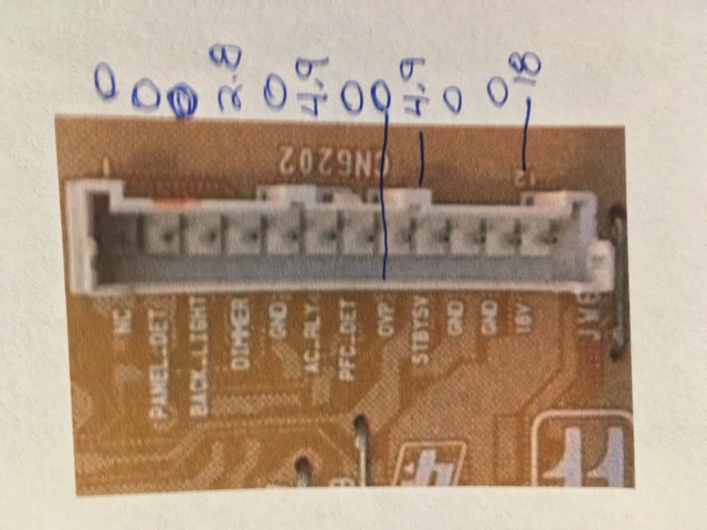

    Thanks .OK got heat sink. Still appears it wont come out /fit of opening in cover panel after undoing screws behing cover panel..Pic attached
    On top block cn6261 from top to bottom getting 10.4,10.4,10.4,10.4,0,0,0,0,6.8,6.8,0,0.
    0n cn6203 3rd block from top getting 10.4,0,0,0,2.8,0.
    on cn602 bottom block getting 0,0,0,2.8,0,4.9,0,4.9,0,0,18.

          #64
          Re: sony tv kdl 46 xbr2 no video or sound
          Can we see the pictures of the whole back side of the TV showing how all the boards are connected together?
          Right now the Panel detect and the Bl-on are 0V. I need to look at service manual to see what the Panel-detect should be high or low for normal condition.
          BTW, it would have been a lot better to put down pin name and follow by the Voltage reading for each pin.

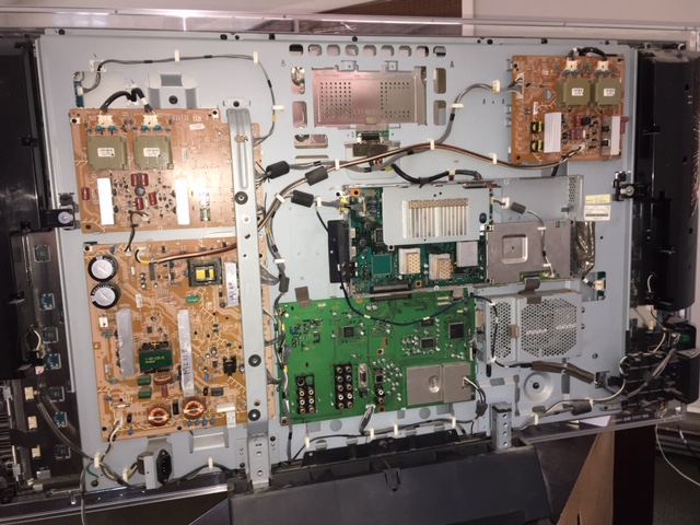

            #65
            Ya, did try to edit photo and put voltages next to pins but couldn't get it..
            Here's back of tv.

              #66
              its a "tube based" back light (I think). You probably don't have to worrying about access to the tcon at this time (but to get at it, you have to take off the metal sheet metal paneling). As budm directing, you probably need to investigate the voltages further. Make a "text list" of voltages versus label / pin will help get you further as oppose to making the forum "work thru" your pictures. One question, what is the history of the set?

                #67
                Thanks ..Will do on text list..

                        #71
                        Hopefully , these will work

                          #72
                          hopefully those will help. The one that I notice is the PFC - 0. To me, that indicates the PFC circuit is not turned on... maybe. Hopefully, budm will take another look.

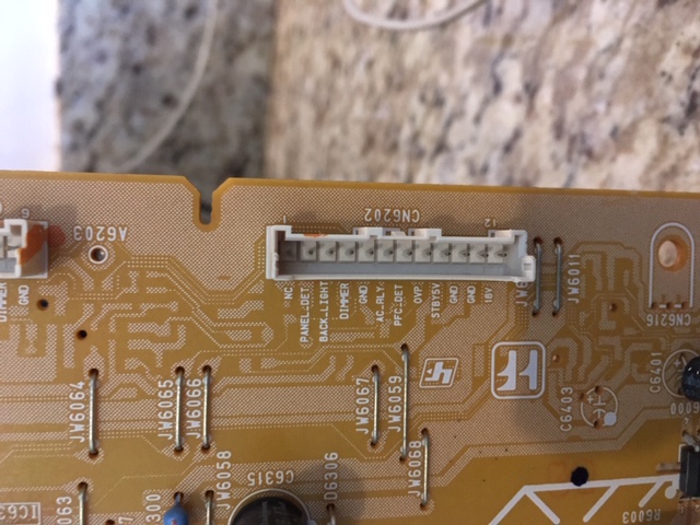

                                #75
                                So you do have Boosted PFC but the PFC detect pin on the Power supply board shows as 0V per your picture: https://www.badcaps.net/forum/attach...8&d=1555016484
                                It should be around 3V as shown in the schematic, so you need to check that PFC Det section of the power supply next, see the schematic.

                                  #76
                                  Just rechecked PFC detect and am getting 3.2 volts...sorry
