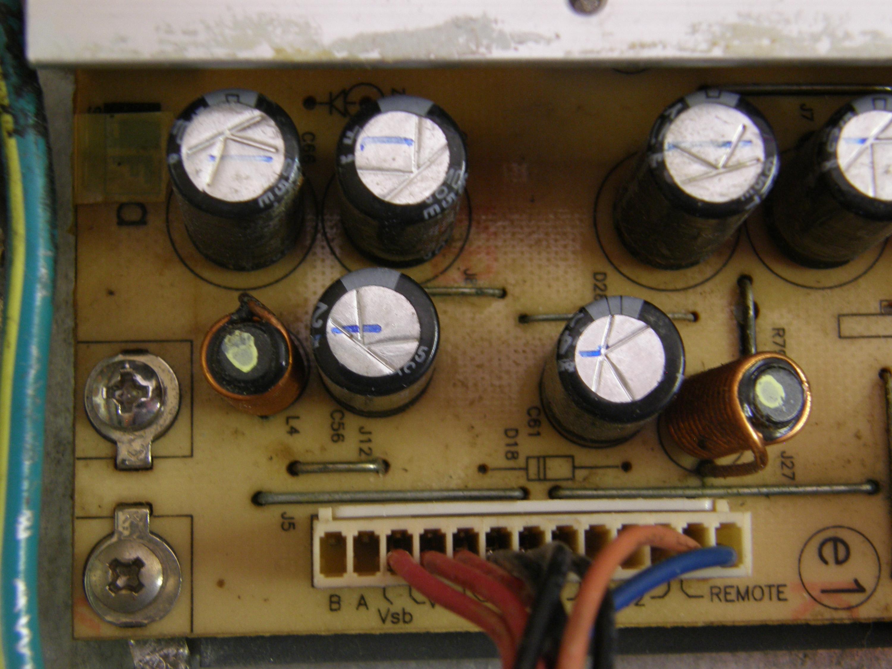

                    My name is Ken, and I'm a newbie here at badcaps.net. I found the site recently while researching repair options for a Polaroid TLA-04011C. I don't subscribe to forums as a general rule, but found that the posters here seem to be serious, and informed. So, I hooked up. If anybody wishes to offer any insight to my TV endeavor, I would be grateful. i am particularly interested to find out if member "ryr0909" was ever able to fix his, as he and others were working on a project just like mine. I should mention that I don't believe there are any....well; bad caps. They all pass visual exams, and rudimentary ohmeter test. Thanks. kfhaggerty@yahoo.com.

                      Can we at least see the pictures of your boards?
                      Bad cap can look normal with no sign of bulging or leaking.

                          I was unaware you had written requesting photos of the boards. I am such a newbie, I didn't know to check, or that I had a mailbox. I'm not even sure if I should send a private message, or just post here....so I'm doing both. I will set up a rig tomorrow and get some good, detailed shots. I've seen some of the pictures that are offered up, and I will try to do a bit better. I will include the tv's history as I know it as well. Thanks for responding.

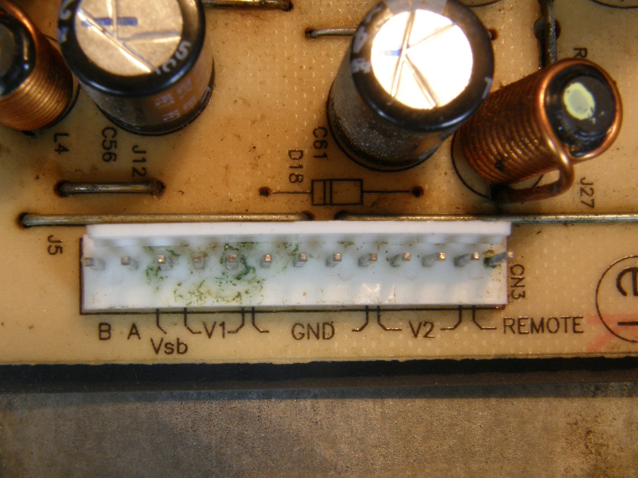

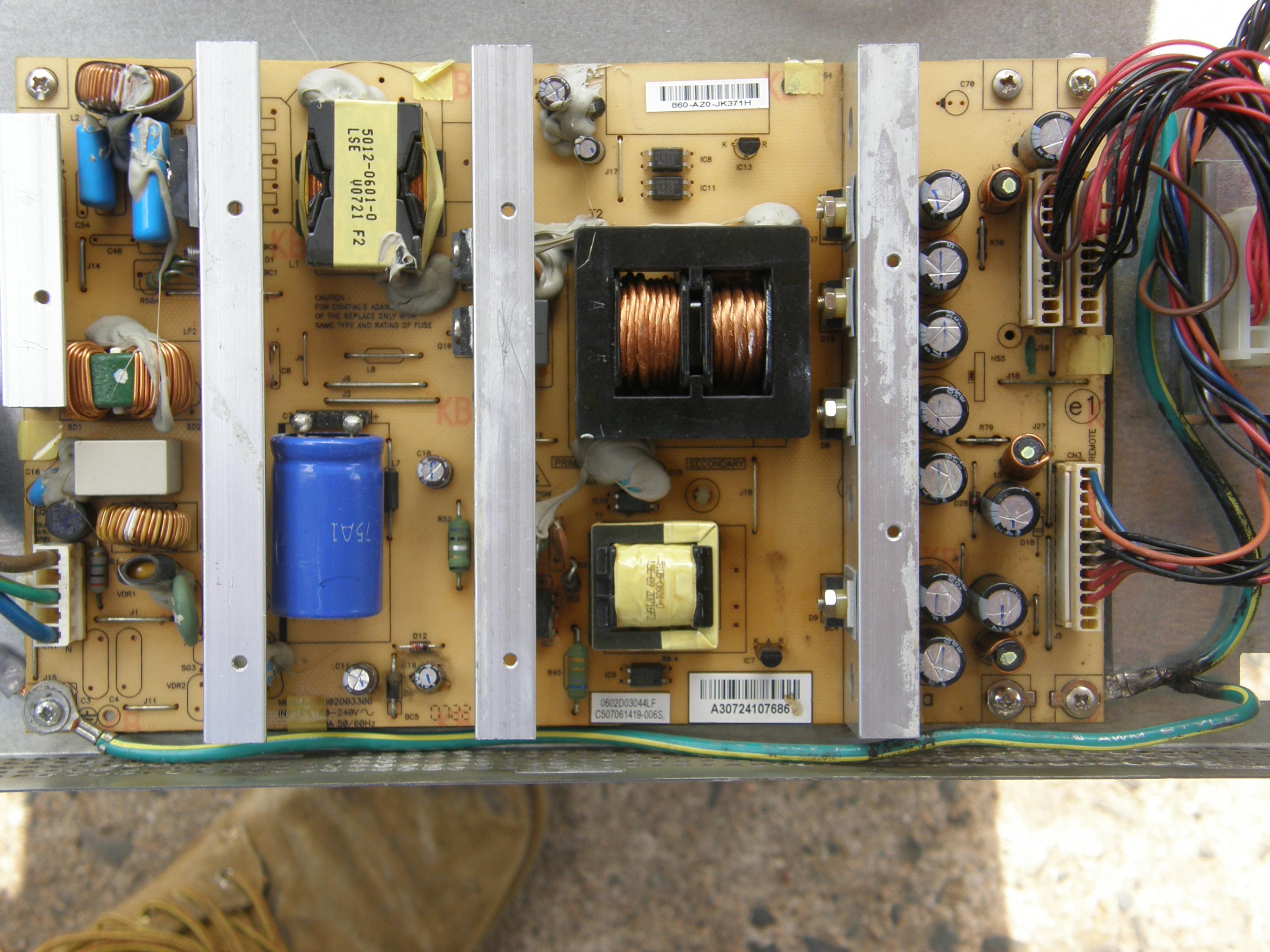

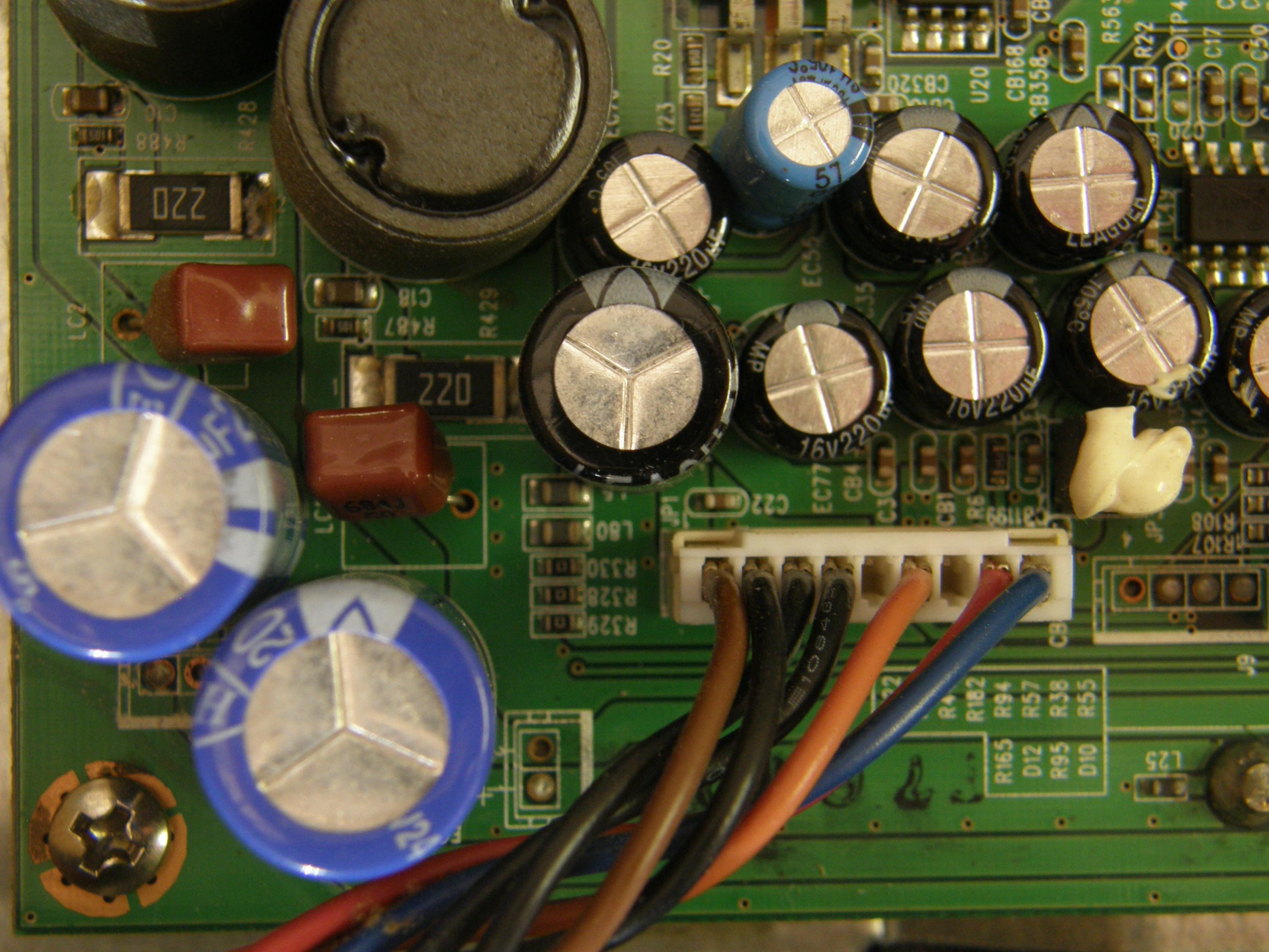

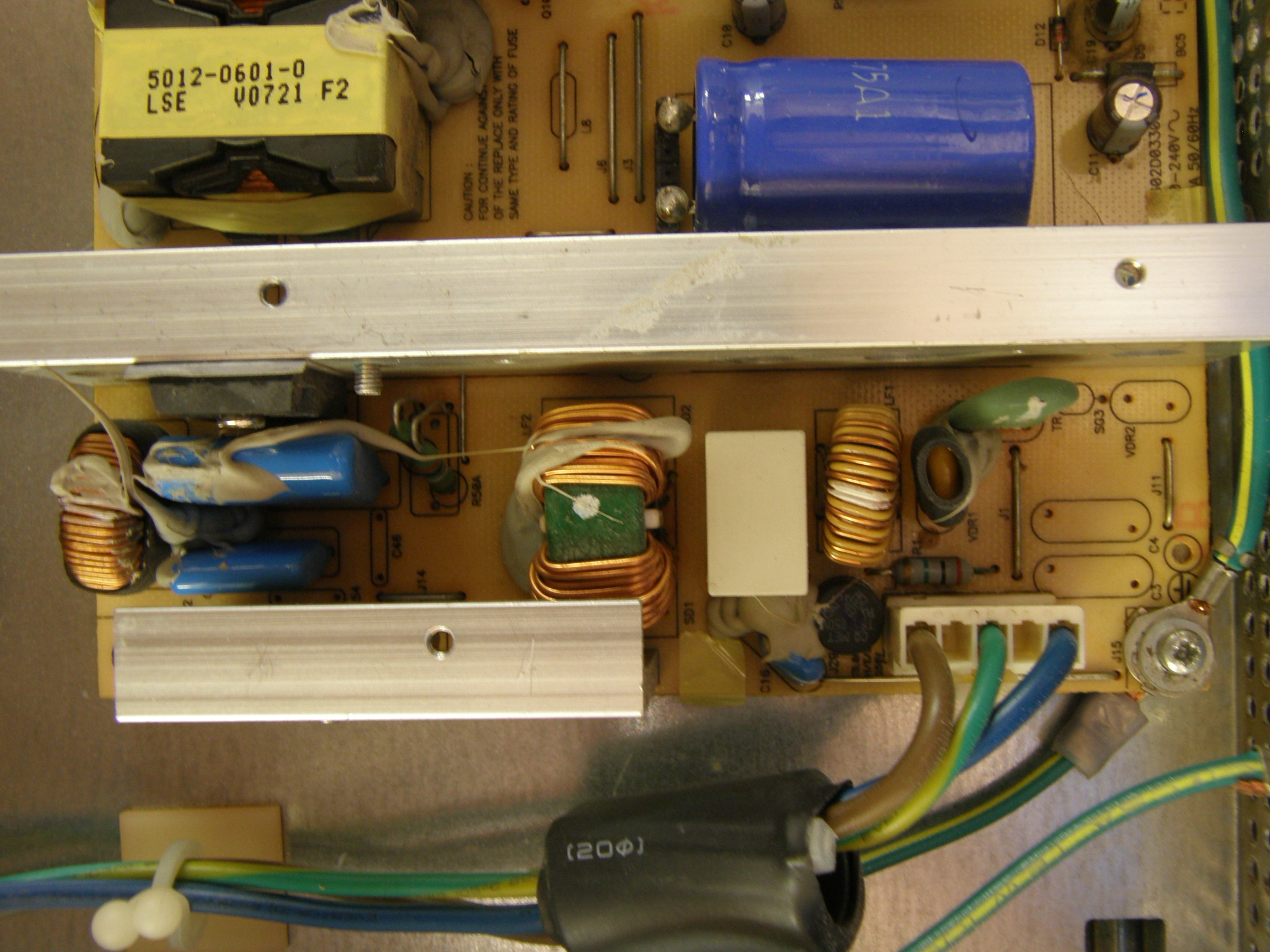

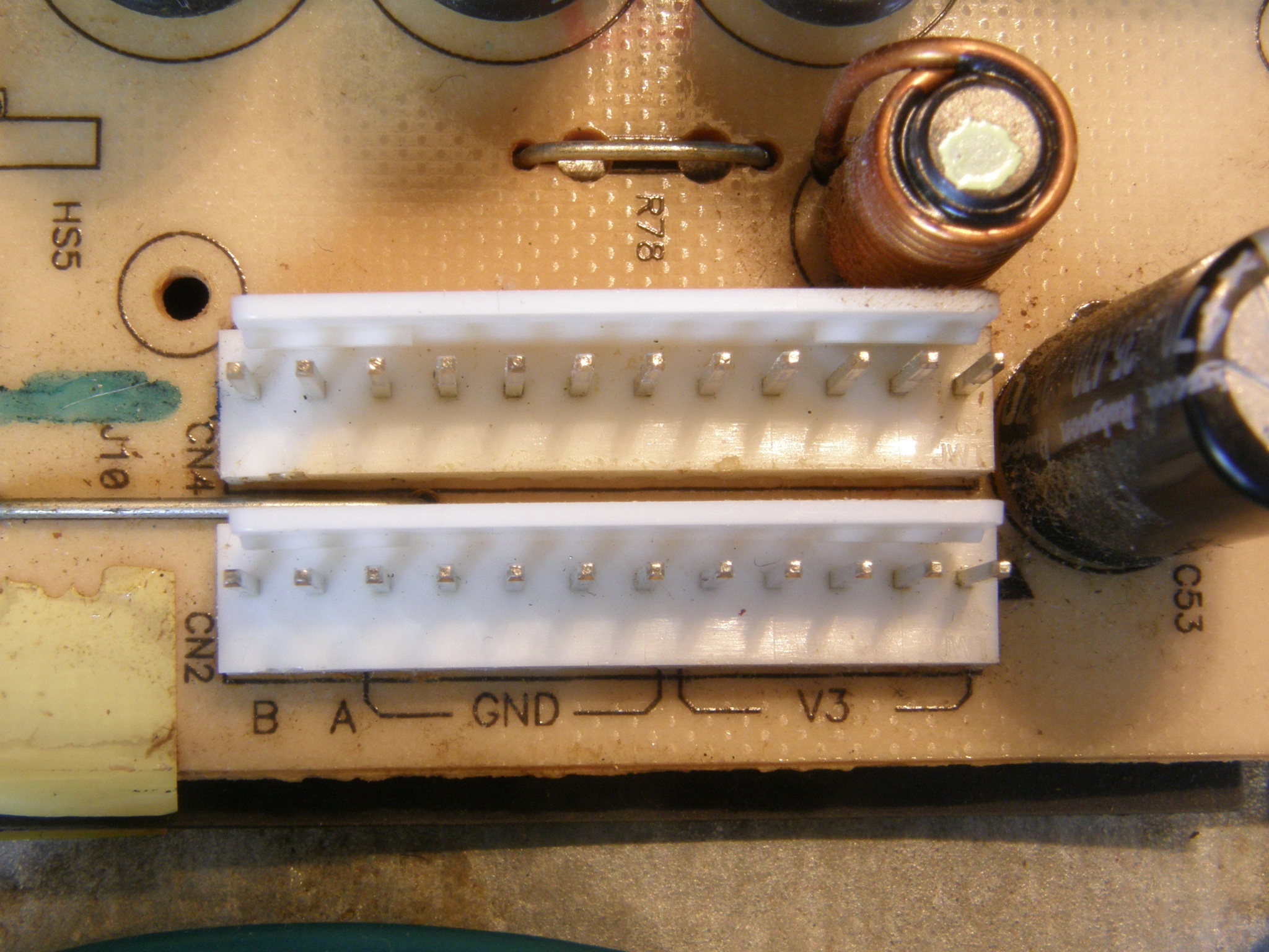

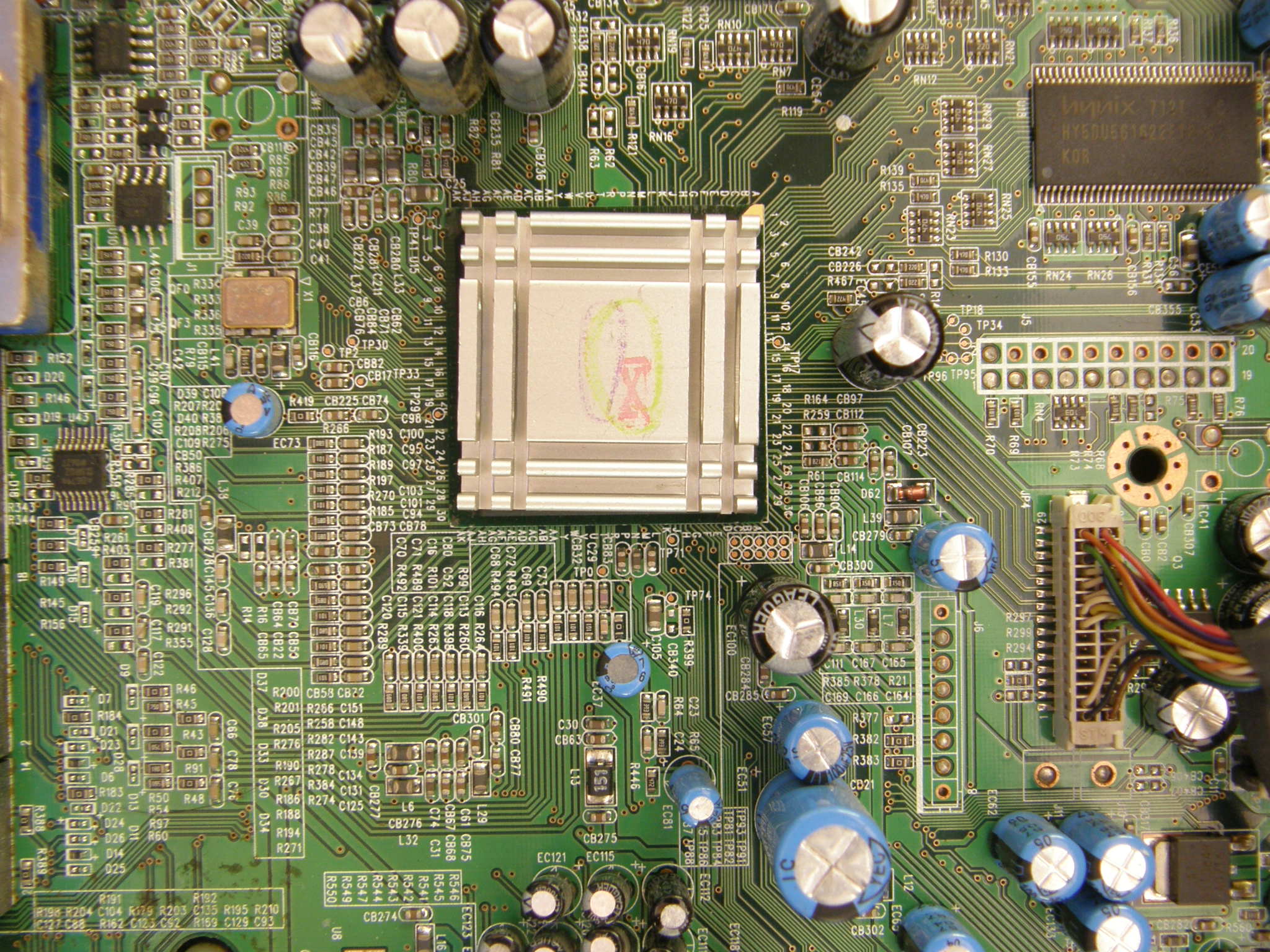

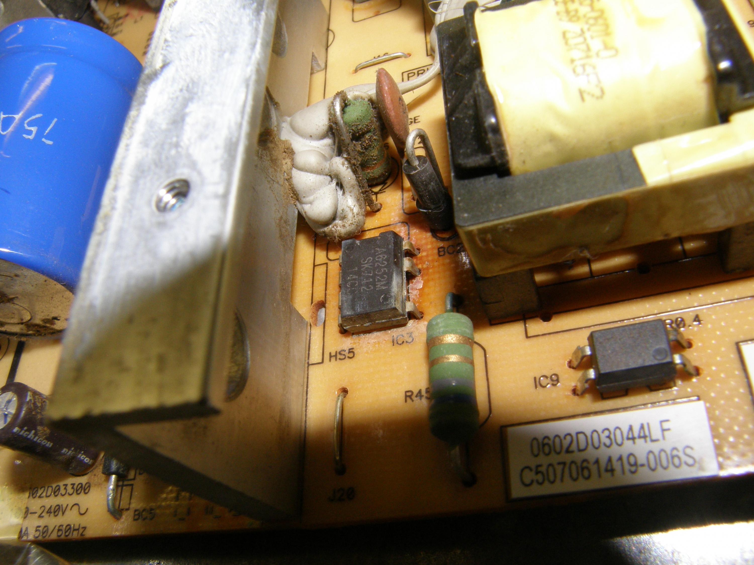

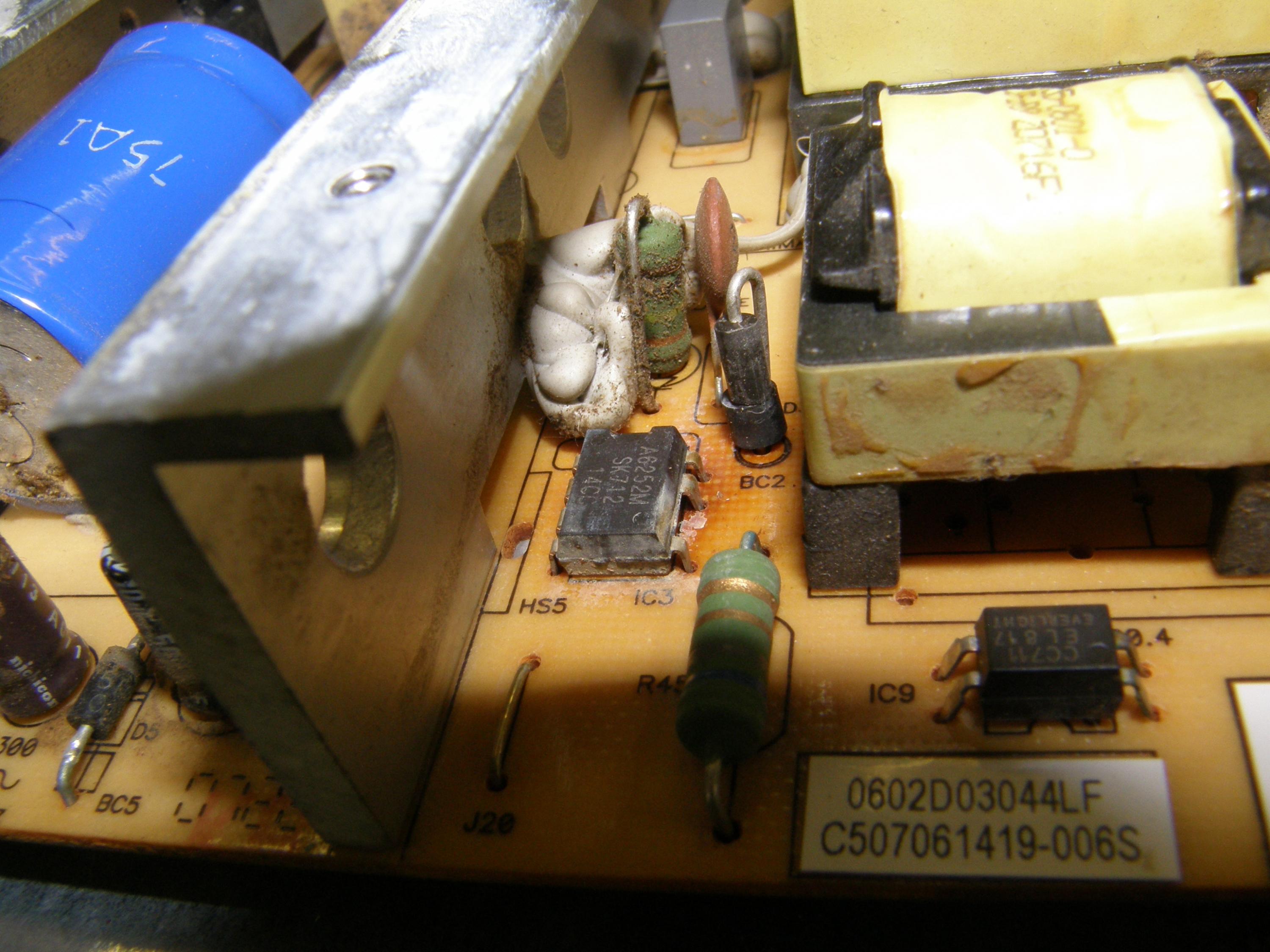

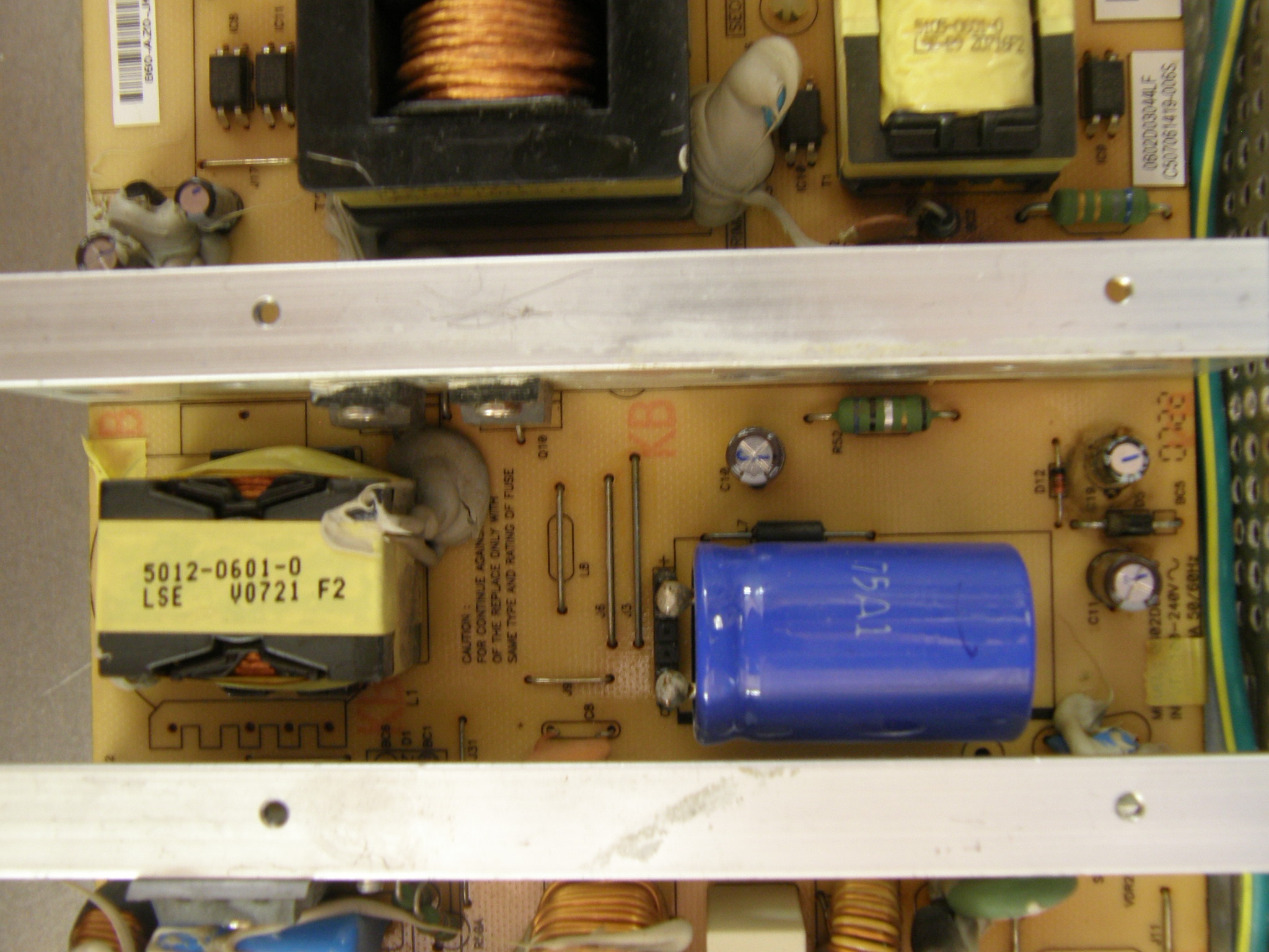

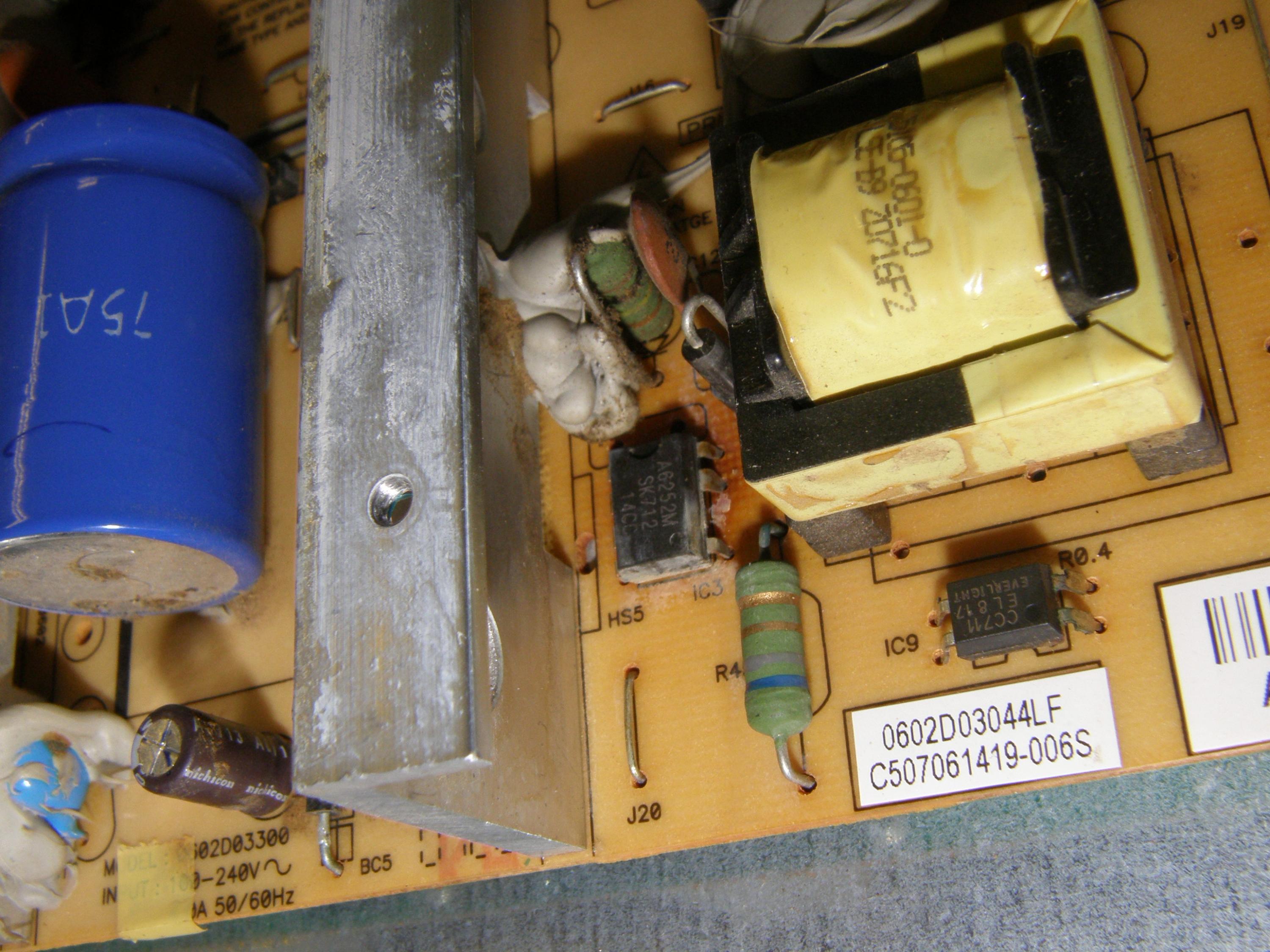

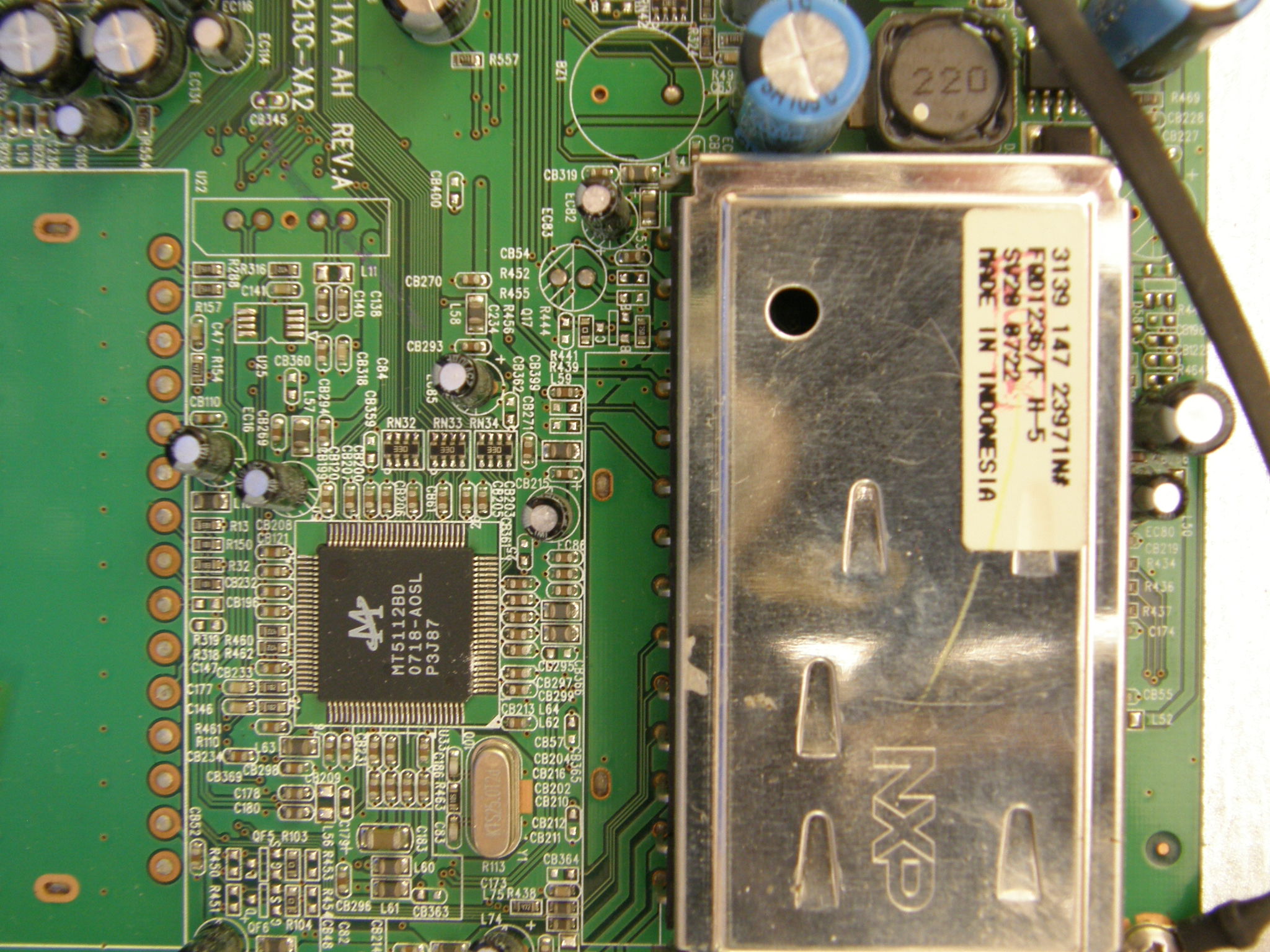

                            Polaroid TLA-04011C Circuit Board Photos
                              Re: Polaroid TLA-04011c Red Light on, no power on

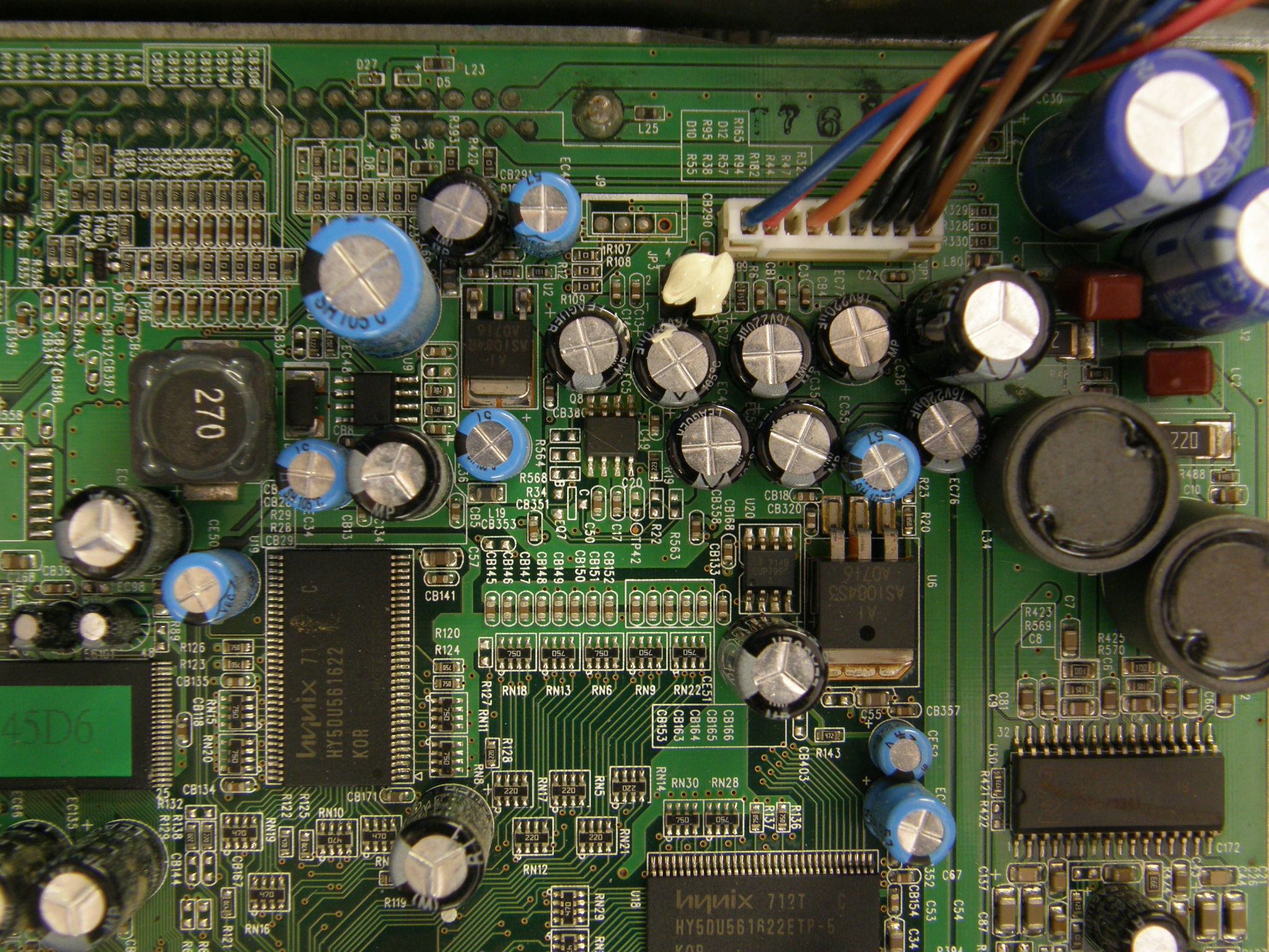

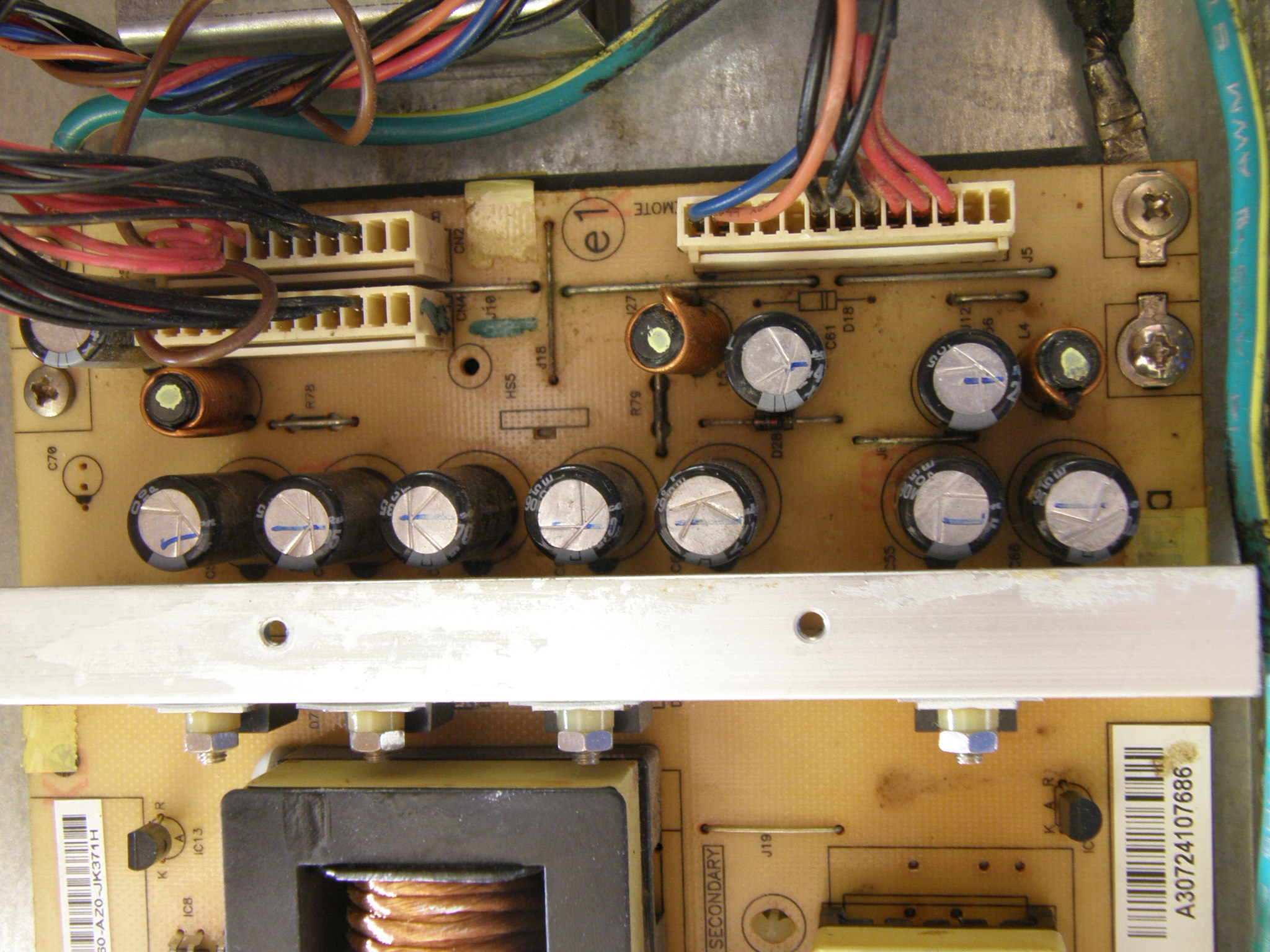

                              I thought I was going to be able to do better (the camera I have at my disposal is apparantly not as advanced as I had hoped), but let's see how they look online.
                              History:
                              I got the TV from a neighbor, who got it from a neighbor. It allegedly got pissed on by the first owner's cat. Whether it was broken before the pee letting, I am not sure. I brought it home and opened it before powering it, so as to minimize further damage. I found terrible corrosion aound the right side power button bar, and some circuit board-to- chassis ground connections (hence the extra green wire you may notice in the photos). After making the repairs, I started it up and....LO....it worked. Excited to have a free wide screen (my first), I started making its final living arrangmenents (moving the old TV out, etc). After 2 hours running time, and just minutes before finishing the whole set up, the TV simply winked out. I wasn't touching it or moving it; just turned itself off. That's when I started getting the red-to-blue power light cycling. No picture, no sound, no backlights. just flashing power button. I knew about the potential capacitor problem, but can't seem to find evidence of it here. Visually, they pass. They also pass the only in-circuit test I know, which is to watch the small resistance change when a standard ohmeter is attached. There looks to be some charing around the A6252M regulator, but I am of the understanding that if it were bad, I would have no power light at all. The I cannot find a legible schematic. I have no oscilliscope. I have NO money (I'm disabled, and unemployed - no income due to being screwed by the government). I'm trying to fix whatever board my be the problem with a multimeter and my wits, but cannot with any certainty determine which board, or board components are bad. I'm desperatly looking for someone who might be able to offer me some form of assistance in the form of knowledge, suggestions, paperwork, drawings, or anything else; and I humbly need it gratis. If anyone would like to help me, I would love to read your input. If I'm asking too much, I'm sorry....just tell me to piss off. If more photos are required I can try to take more specific ones if needed. Thanks to all. Ken.

                                P.S. The pictures seems to enlarge pretty well on my computer....I hope they suit anyone checking.

                                  OK, I will download the pictures to see what is going on.

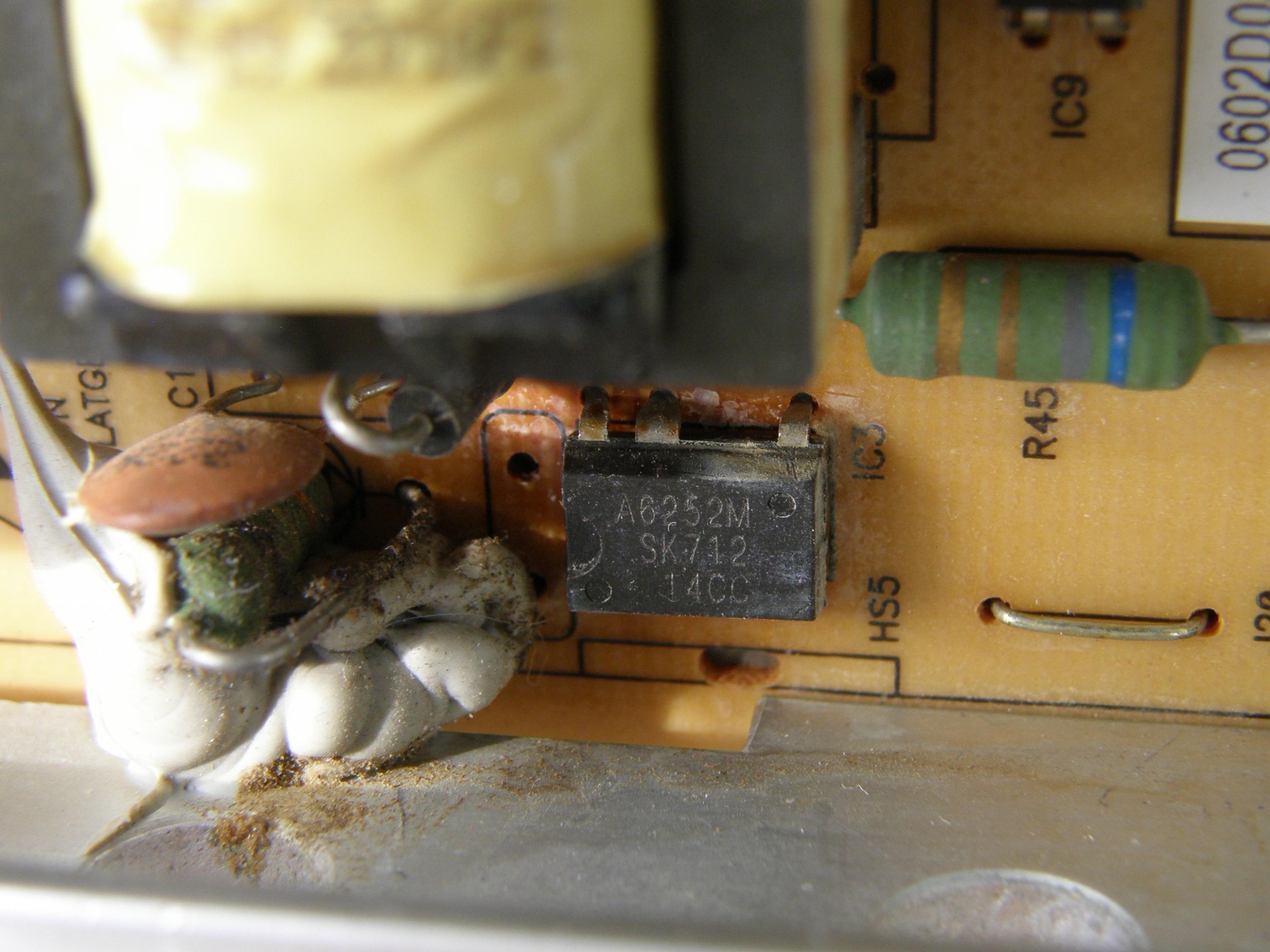

                                    OK, that small IC A6252M is the Switching power supply IC for producing the Vsb at the output pin of the connector.
                                    There are printing next to those white connectors that go to the Main board and to the inverter board. Can you take the pictures without all those connectors attached since I cannot see the labels.
                                    So check the DC voltage on that Vsb pin and report the reading. Black probe on the chassis.

                                        I think these are the photos you want. I checked for voltage at pin Vsb onCN3, and got 4.95 VDC. I also got that reading on the corresponding pin on the main board. This was done with the TV plugged in, but without turning on the power button.
                                          Here's the other one.
