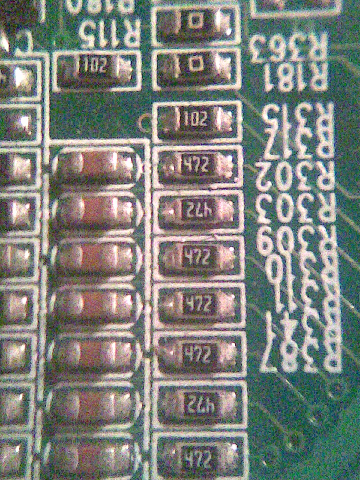

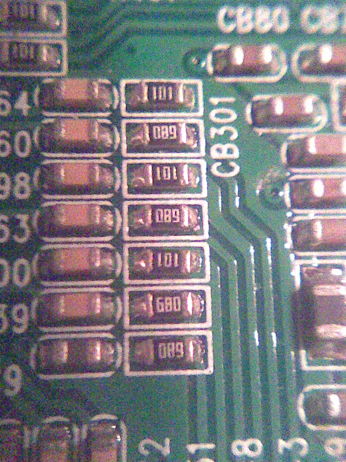

                              #94
                              Re: Polaroid TLA-04011c Red Light on, no power on
                              Originally posted by ryn0909
                              well i guess it doesnt surprise me that both boards would have separate issues. the seller of the second board was helping me to try and figure out what was going on. but ever since i brought this same question to his attention, he hasnt responded. so im becoming more convinced that this second board has an issue as well. On a side note, i did figure out a way to take "good quality & close-range" pics with my camera phone. I utilized one of the lens's from an old cdrom drive and attached it to my camera phone, with scotch tape.... i attached a sample pic
                              Son of a gun!!! That is an excellent picture. Well, the field of view leaves a little to be desired, but it is easy to identify the IC.
                              PlainBill
                              • ryn0909
                                Professor X
                                • 122
                                #95
                                hehehe well thank you, im glad i was able to produce a good quality pic. yea the field of view is what im trying to fix without degrading the quality..... lol ill get it figured out
                                this is the widest view i could achieve with what i had to work with....
