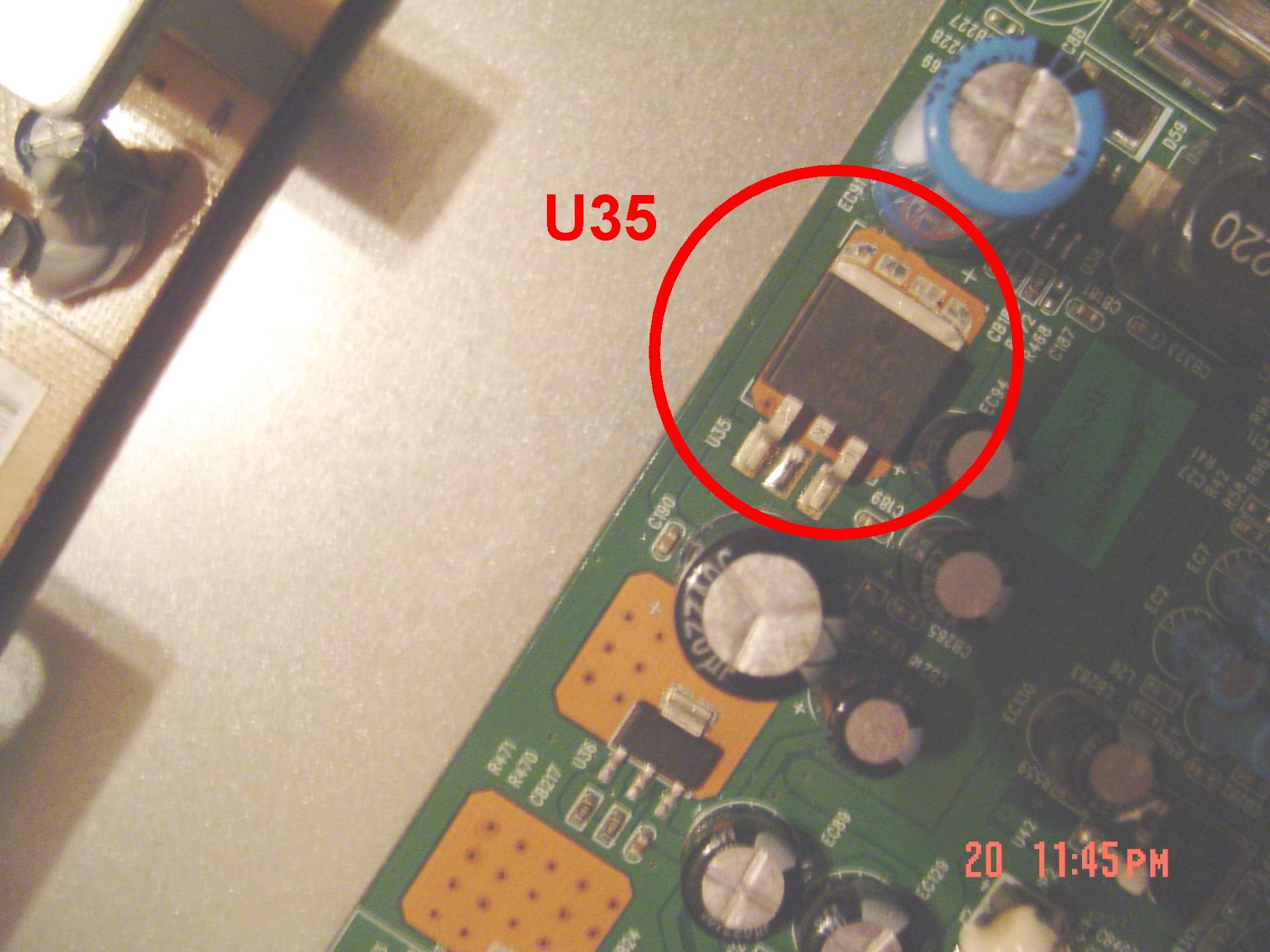

          ok ill do the checks. i did notice that this component had gotten really hot. hot enough to the point that the solder on the legs of it is pitted and the packaging is discolored. i circled it in the picture i attached. sorry for the not so great photos, my camera sux ass when i get it that close, i even zoomed in and out and its just a crappy camera.

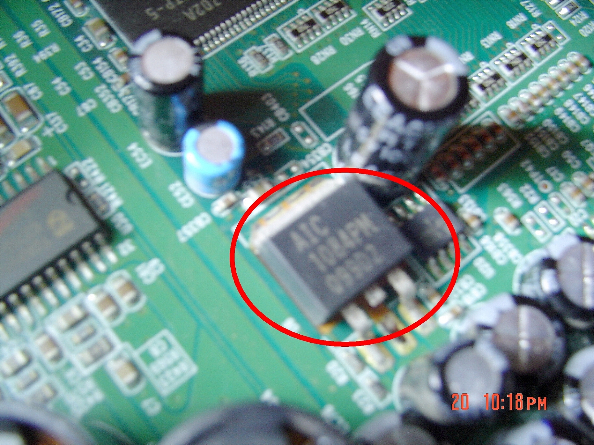

            ok after doing the checks on the ones labeled xx1117-vv, they all measured out to be the same. from board ground to PIN1: 2.08vdc PIN2:3.35vdc PIN3: 4.95
            Now, in the picture i attached, the one circled is labeled U35, marked with UTC 78TO5AL i checked it for shits and giggles and this is what i got..... From board ground to PIN1: 11.89vdc PIN2: 0VDC PIN3: 4.98vdc. i dont know if that is relevant or not. Sorry if im jumping ahead.....
              Re: Polaroid TLA-04011c Red Light on, no power on
              78T05AL is a beefed up version of the 7805 linear voltage regulator. basically (as in how they work) the same thing as those xx1117-vv.
              output 5V (05 at the end) with 3A (indicated by the T).
              you measured 4.98V, so that's probably ok.
              That AIC1084PM is an adjustable voltage regulator capable of 5A
              http://www.alldatasheet.com/datashee...C/AIC1084.html
              to find out if that's ok, you would have to find out what voltage it's supposed to put out first (as it's adjustable, not fixed voltage like the others).
