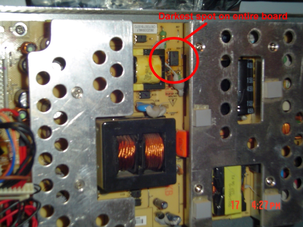

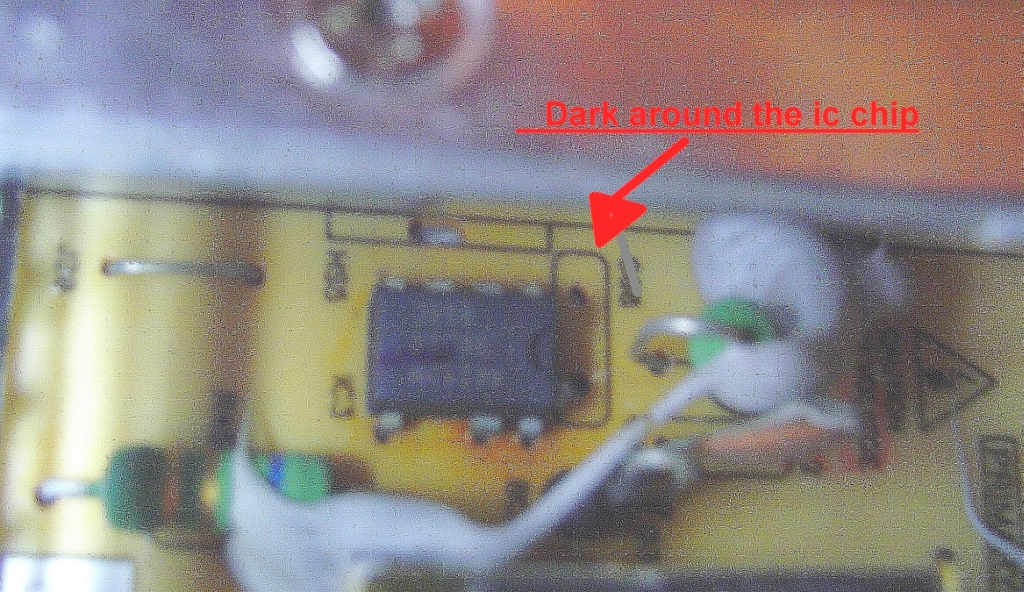

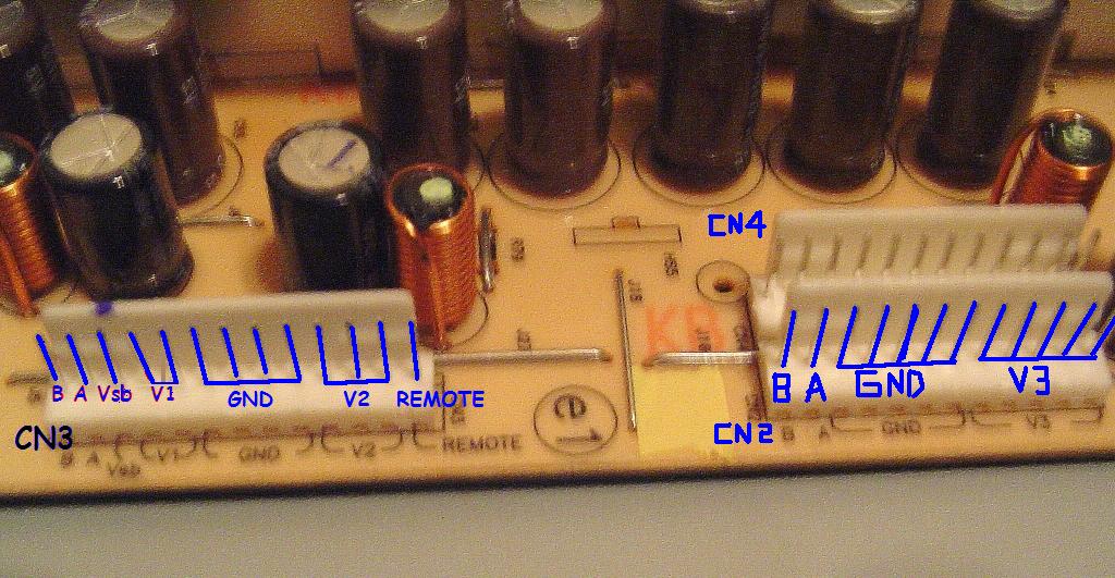

    Im new to this forum and im in need of some real help. Im trying to fix a friends tv for them. Its a polaroid tla-04011c. It wont power on, but the red indicator light comes on. ive tried the remote and tv power button and neither work. ive unplugged it and left it unplugged for 20+ hours, hoping it would reset, still nothing.
    I am mechanically enclined and familiar with using and reading a multimeter. ive taken the back cover off of the tv and thoroughly inspected the main board and power board looking for bad caps or something burnt. all the caps LOOK good, none bulging or exploded on either main or power board. However, there is one concern i have and its on the power board. to me it looks like something may have burnt, but i dont see any secondary indicators on any of the components near it. Attached are 2 pictures of what im talking about.
    Also, i did some checks on the power board with my multimeter and this is what ive got....
    CN3 (13pin header) 8 pins used
    pin 3 Vsb- 5vdc
    4 v1- 5vdc
    5 v1- 5vdc
    6 GND
    7 GND
    8 GND
    12 v2 0vdc
    13 remote 0vdc
    and C7 (Main Cap) 163vdc
    i hope this makes sense to whoever can help. Any assistance is greatly appreciated thank you
    Re: Polaroid TLA-04011c Red Light on, no power on
    Looks like the power IC may be fried. I can't make out the part number from the picture; but, you can read the part number from the top of the IC and google it for a datasheet. The datasheet will give you the pinout for the IC and you can take a reading accordingly.
    Make sure you test the "upstream" components to identify what fried the IC.
      the part # for that ic is a6252m. im downloading the data sheet now, and ill do the checks on it and post my findings.

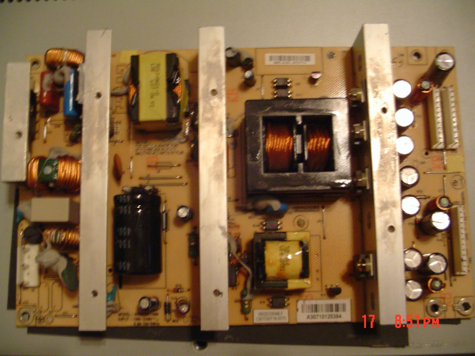

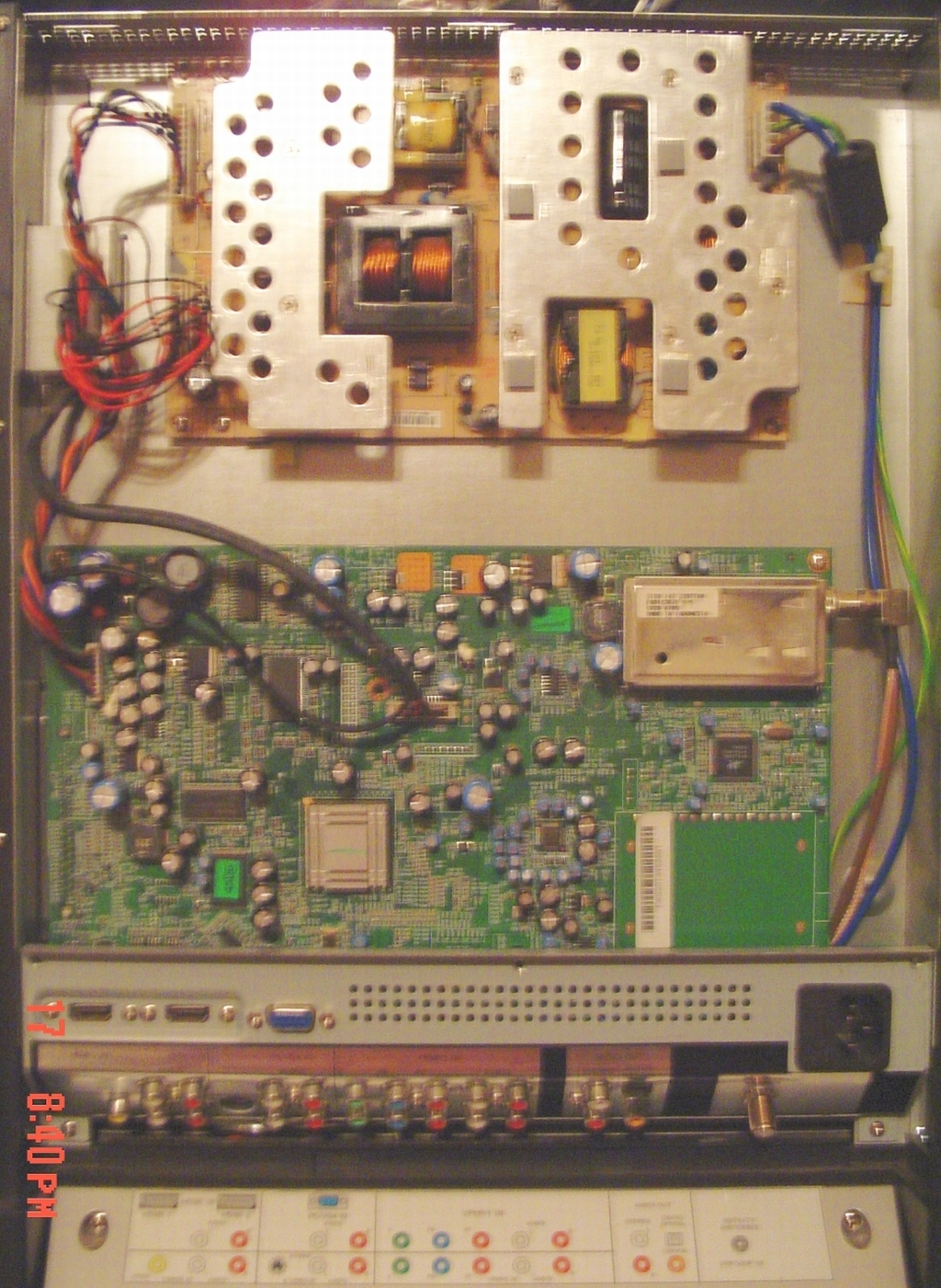

          By the location, that IC is the SMPS controller for the standby supply. If the any voltage is present, that IC is working. Notice it's only rated for 20 watts - fine for a standby supply, but not for the main supply.
          What would be helpful is three more pictures. The first would be an over-all shot of the TV, showing the relationship of the various boards. Then two pictures of the power supply, one of the top, one of the bottom. I'm particularly interested in any legends around the output connectors.

                  ok here are the pics. also i did the check on the ic and i got 16.45vdc

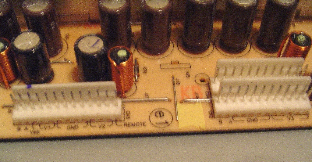

                    Aughhh!!! Horrible pictures.
                    On CN2, what voltages do you see at pins B, A, and any pin labeled V3? Measure from any pin labeled GND. Do any of those pins change voltage when you press the power button?
                    On CN3, what voltages to you see at pins B, A, Vsb, any pin labeled V1, any pin labeled V2, Remote? Again, measure from any pin labeled Gnd. Also, do any of those pins change voltage when you press the power button?
                    PlainBill

                        here is a modified version of the pic with the connectors
                          ok heres what i got....
                          (CN3) pin B- 0vdc A- 0vdc Vsb- 5vdc V1- 5vdc V2- 0vdc REMOTE- 0vdc
                          (CN2) pin B- 0vdc A- 0vdc V3- 0vdc
                          and there is no change when i press the power button

                            Please verify that are no other output connectors on the power supply. I am specifically interested in a pin labeled PSON or the equivalent.
                            A quick background: Virtually every LCD / Plasma TV uses the same general design for the power supply. It is a dual section supply with a standby section that is always on, and a main section that that is switched on and off as the TV is switched on and off.
                            The main board on the TV has a standby processor that monitors the remote input and the keypad. When the power button is pressed, it performs a few tests, then turns the main supply on via a control line which is usually labeled PSON, On/Off, etc.
                            Assuming there is no additional connection to the main board, the problem is the power supply is not being commanded on. That is a problem with the main board.
                            OOps!!! IS there a separate legend identifying the pinout of the connector behind CN2? (Repeat complaint about the poor quality of the pictures omitted.)
                            PlainBill
                              there are no other output connectors on the power board. and there are no pins labeled PSON.
                              threre is no legend identifying the connector behind CN2, which is labeled CN4
                                  so what should i do ?
                                  Your call. There are several main boards for sale on eBay (make sure the part numbers match), and a complete TV with a damaged screen.
