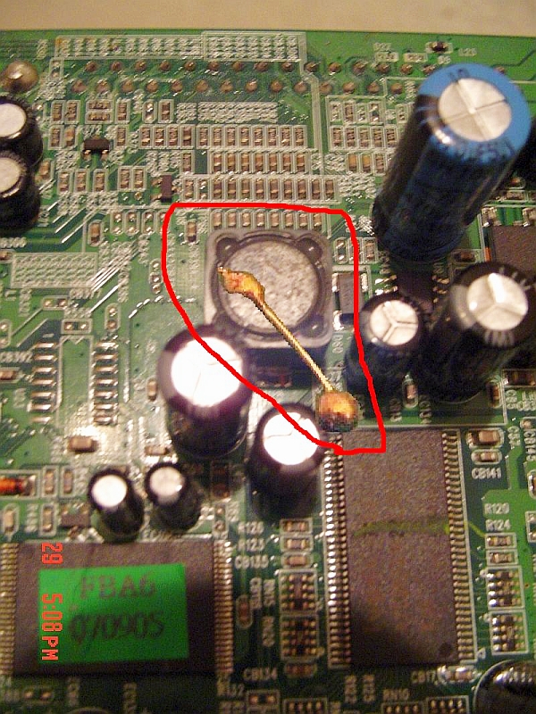

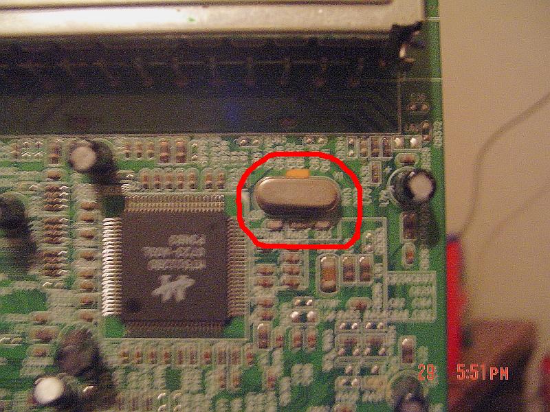

                Here are some concerns i found with this new board. i dont know if they have anything to do with the problem but i figured id ask.
                In the first picture "reversed.jpg" i noticed that the circled component is soldered to the board reversed compared to the the other board. i noticed it by looking at the the numbers on it and their orientation to the board.
                In the second picture "jp1.jpg" one side of the board is the JP1 connector and the other side they joined pins 4 & 5 together. Now at the cable, pins 2,3, 4 are ground and pin 5 has no wire. The old board DID NOT have pins 4 & 5 connected.
                In the third and fourth pictures "sideA.jpg & sideB.jpg" Side B, the circled component, is some kind of a bridge soldered to the board. In respect to its orientation to side a, i did an overlay of the bridge to give you an idea of what its bridging. Once again, the old board DID NOT have this.
                I hope i havent confused the hell out of you. but thats where im at with this problem. Thanx again for all your previous help. i really do appreciate it.

                  First, a good bit of detective work. I've stared at boards like this for hourse trying to spot differences, I know how difficult it can be.
                  Picture 1. That component is a crystal; used to generate a precise frequency. It does not have a 'polarity', so that is not a problem.
                  Picture 2. That does not appear to be a problem. As closely as I can tell, pins 1-6 are all ground (You can verify this on the original board); only pin 7 carries a signal. Still, that's poor workmanship.
                  Pictures 3 and 4. I find this disturbing. The component that appears to be bridged is an inductor - used to reduce noise on a power supply line. There is a diode next to it, and an IC that might be part of a bucking DC-DC converter. I can fathom only one reason for that jumper - the inductor is defective (open). Bridging it like that is a REALLY bad idea.
                  Before returning it for replacement, I would look at the revision level of the two boards. If they are identical I would assume this is a bit of inexpert repair.
                  PlainBill

                    is there a way to check that inductor in pics 3 & 4?? ill look online to see if i can find the specs on it. Could that be the reason for having no picture?

                      So far the 3 concerns i found were just from doing a quick scan of the board. If you think i should, i will give it a thorough inspection and ill list any concerns i find. here is a pic of something i remembered about circut board components, those 2 dont sit flush
                      OK, there IS a difference in the revision level of the boards. Interesting.
                      The picture shows another example of sloppy workmanship, but it shouldn't cause this problem.
                      While I'm posting, take a look at this thread about a different Polaroid TV. In particular, note post 4.

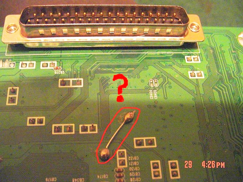

                                    ok well im getting closer to fixing it. On advise of the seller, i went ahead and removed the "homemade jumper" from the back of the board. I hooked it all back up and this time i secured that ground cable to one of the mounting screws for the "main board" this time. Prior to this time, i was securing it to a mounting screw on the "power supply board". When i turn it on, it will power up and now its getting a blue screen, with verticle lines in it. i attached 2 pics to show u what i mean. it seems to be responding to the buttons i press because when i press the menu or input button, the verticle lines will shift from side to side. please tell me im gonna be able to fix it. lmao jk i just hope i can

                                      so is the board still bad?? the seller told me he'd refund the full amount and that. but he doesnt have any more boards.

                                        I'm trying not to sound like a jerk here, but there are a number of questions that I can't answer. Without definitive answers to those questions, I can't give an absolute answer to your question. In a nutshell, you don't know what you are doing. You could be making some minor mistake and I wouldn't know it. For example, that problem COULD be the TCON board. Troubleshooting logic says it is very unusual for two boards to fail at the same time. Maybe you disconnected the tcon and failed to reseat the cables properly. Maybe when you unplugged the LVDS cable you damaged it. Maybe you zapped the replacement board while installing it.
                                        There is a strong possibility the replacement main board is bad; the seller may not have tested it. (I'll get back to that later).
                                        Even experienced technicians can make mistakes. If you were Toasty, Wizard, or dozens of other people here I would be confident the problem wasn't 'technician error'. If you were one of hundreds of other people here (I'm NOT going to name names ) I would not be confident it wasn't technician error. Unfortunately, you are one of those hundreds of people.
                                        There are many people selling 'used, working' boards on eBay. Some of those are professional operations who have tested the boards and are sure they are good. Others have stripped the boards from a dead TV or monitor and are letting the buyer test them.

                                          well i cant say that i dont agree with you, because you are totally correct in saying that i dont know what im doing. You are also correct about the seller not testing it. Here is his message to me
                                          Dear figave209,
                                          Must have missed that somehow, sorry. I only tested the TV when it was still in one piece, worked fine with the cracked screen, didnt take close enough look at the board i guess.
                                          can return it for a refund, and will refund your return shipping as well.
                                          or if removing the jumper would solve the problem, feel free to try that, and if it didnt work, Id still offer the refund.
                                          - kjlewter
                                          so ill be returning it and looking for another one thanx alot for all your help PlainBill and everyone, i do appreciate it
