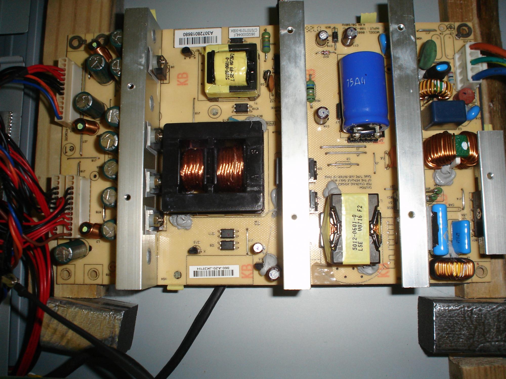

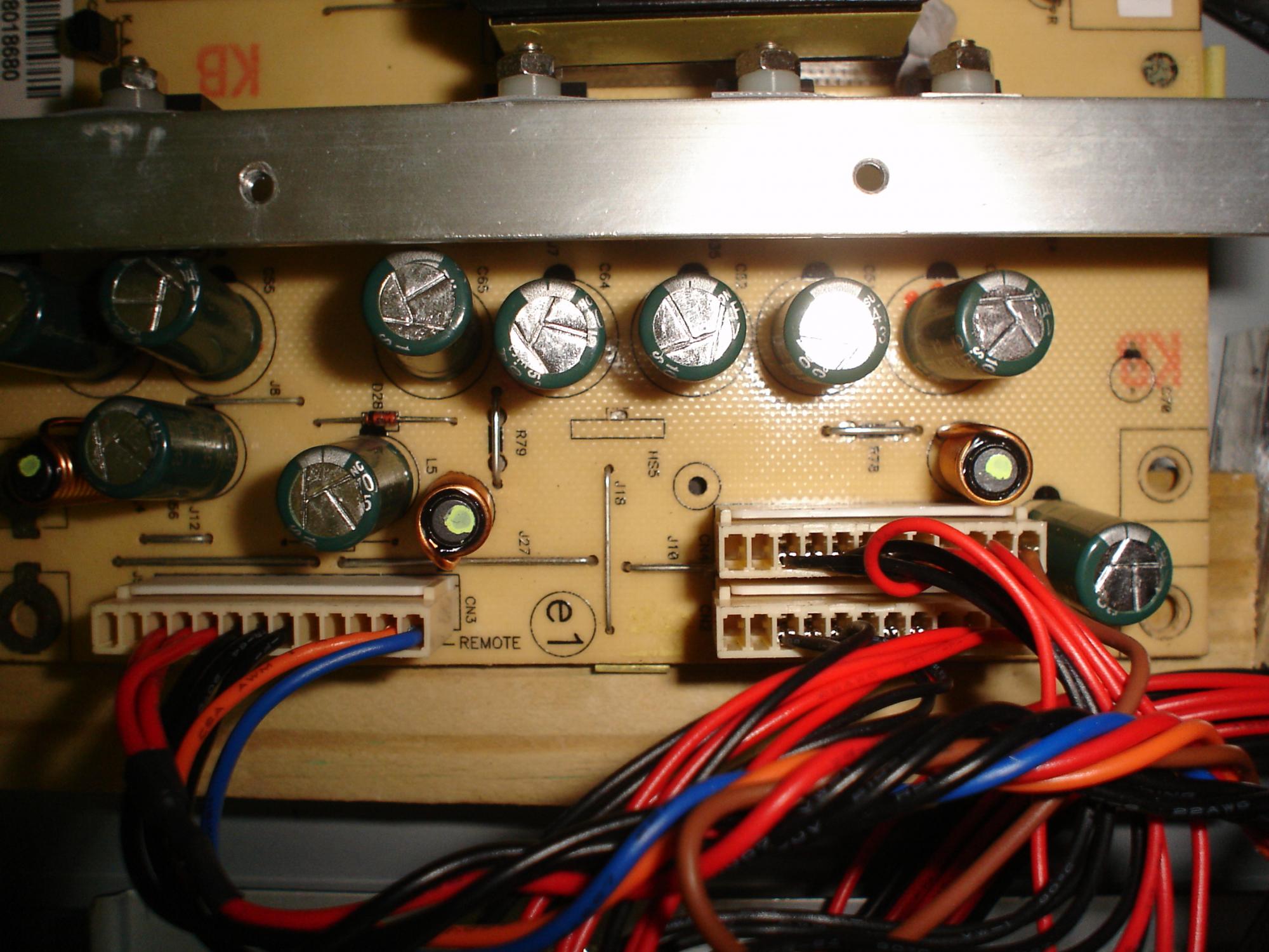

      Im not trying to do a thread High Jack Here... But I have a similar problem where the Red Light comes on and when the power button is hit the Blue light comes on and the screen illuminates -ie backlights come on- and nothing more... The Guy who gave me the TV put it in the Shop and they told him it needed a Power Supply...
      So I searched around the internet and I found a Video of a guy who repaired all the caps on his Power Board and it fixed this same problem...
      My problem is I removed the Caps from the Board, only noting where 3 of them went... So I have 7 Caps I dont know where which on goes...
      4 - Black 16v 1000uF
      3 - Brown 35v 470uF
      I got the factory Service manual in PDF but the image is crap...
      Can anyone or does anyone have a pic of the row of Caps along the left side of the power board under the Aluminum Heat Sink Transistor Panel or the Values of:
      C50 thru C53, C55, C56, C61, C64, C65, & C66
      I believe C56 & C61 are 25v 470uF & C53 is 35v 470uF

        Re: Polaroid TLA-04011c Red Light on, no power on
        here ya go bro....
        c50 thru c53-- 35v 470uF
        c55,c64,c65,c66-- 16v 1000uF
        c56,c61-- 25v 470uF

          Thanks Ryn... I installed all the New Caps; But It didnt fix my problem... I have the same model as Listed here on this thread... the TLA-04011c...

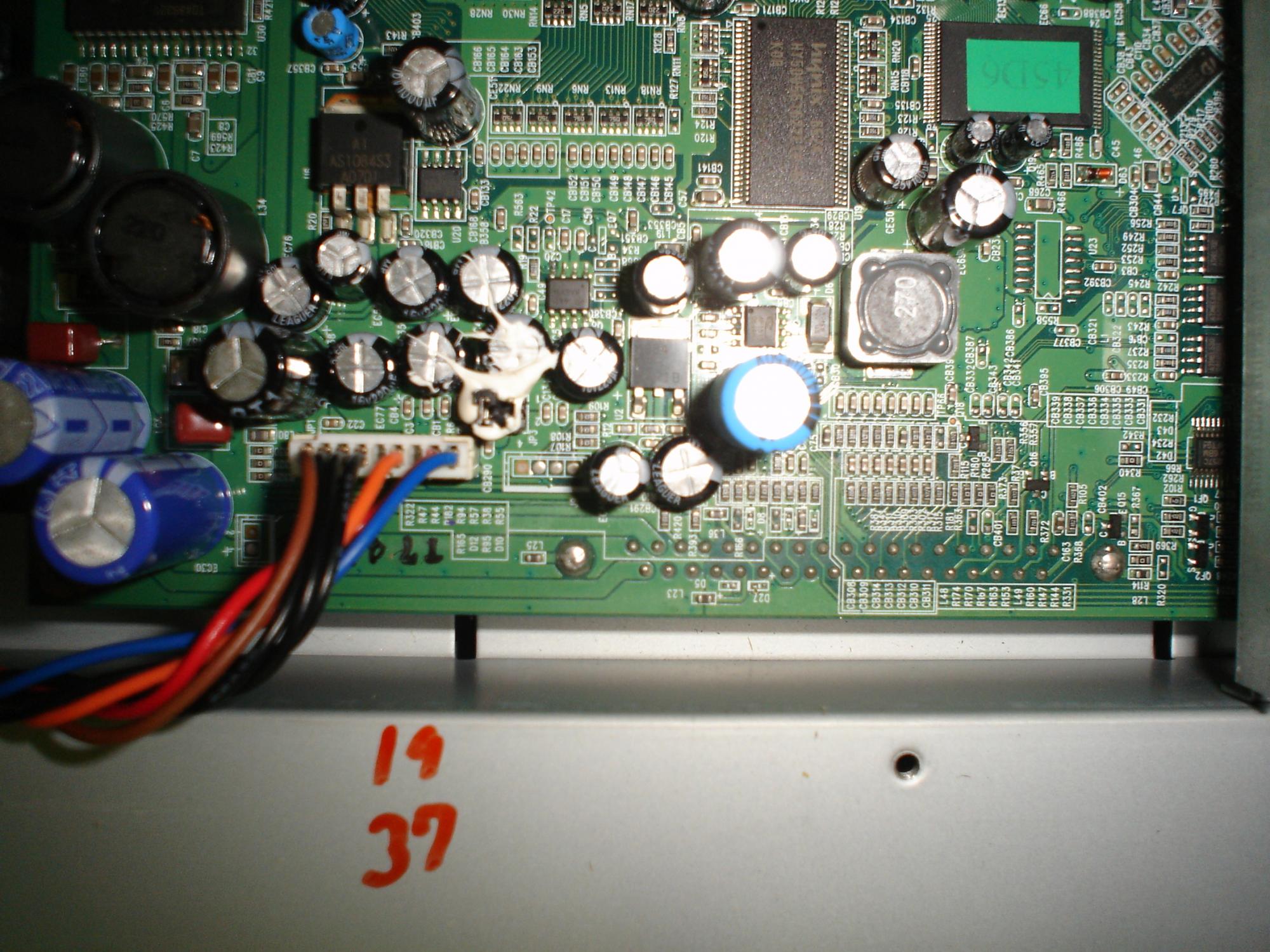

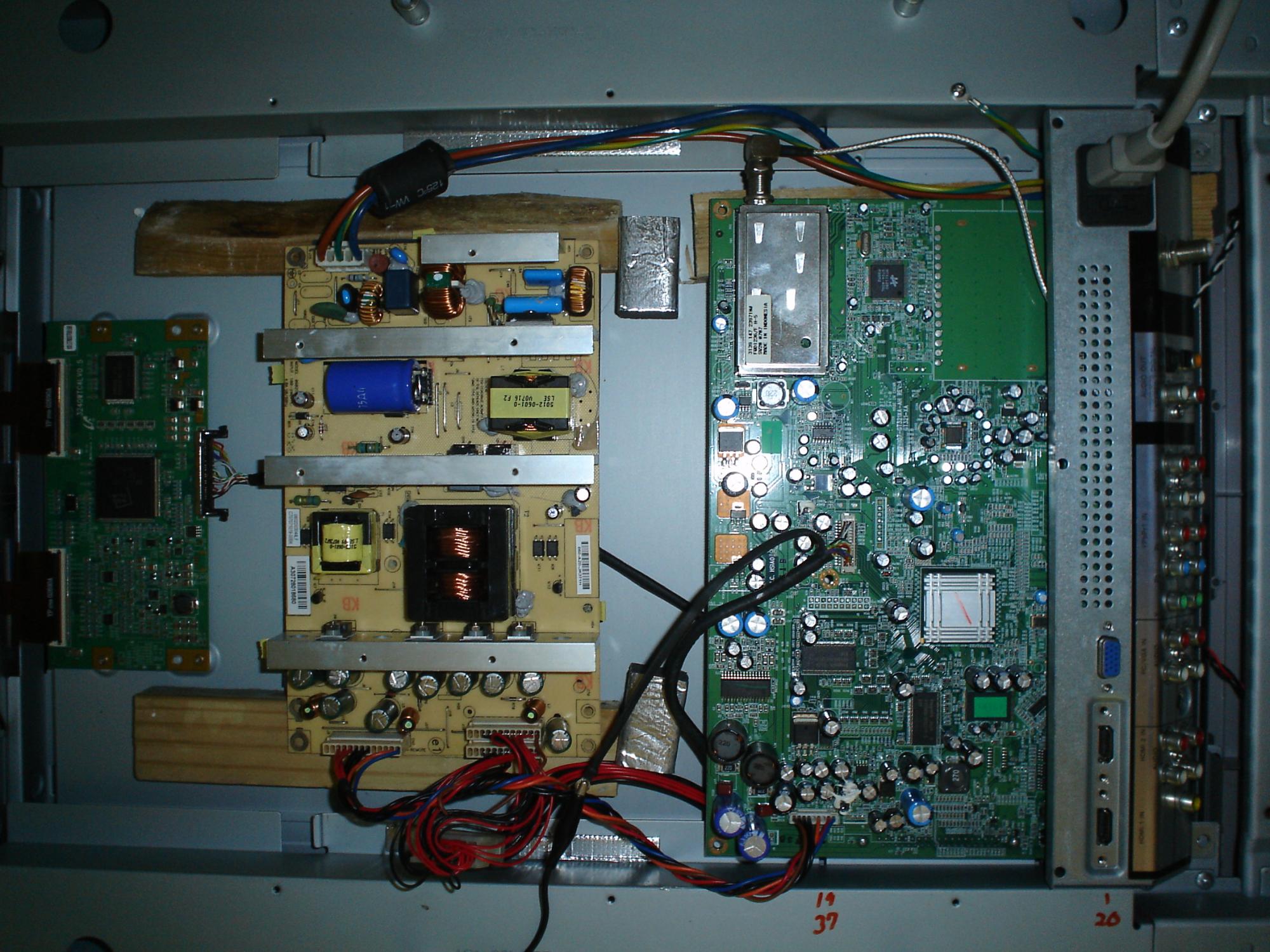

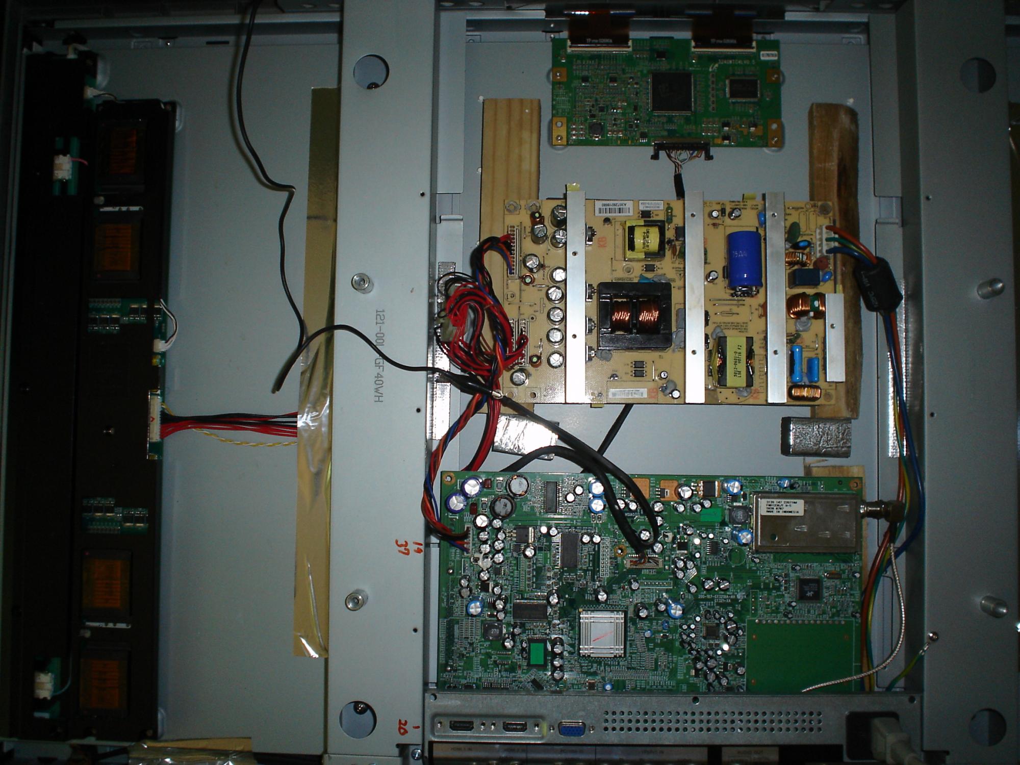

              OK so per the "service manual" and at the advice of the previous posters of this thread to check the transistors on the "Main Board" I did the Following with the Following Results...
              Per Service Manual:
              -Note All Tests were done with Unit complete connections as photoed in Pic1-

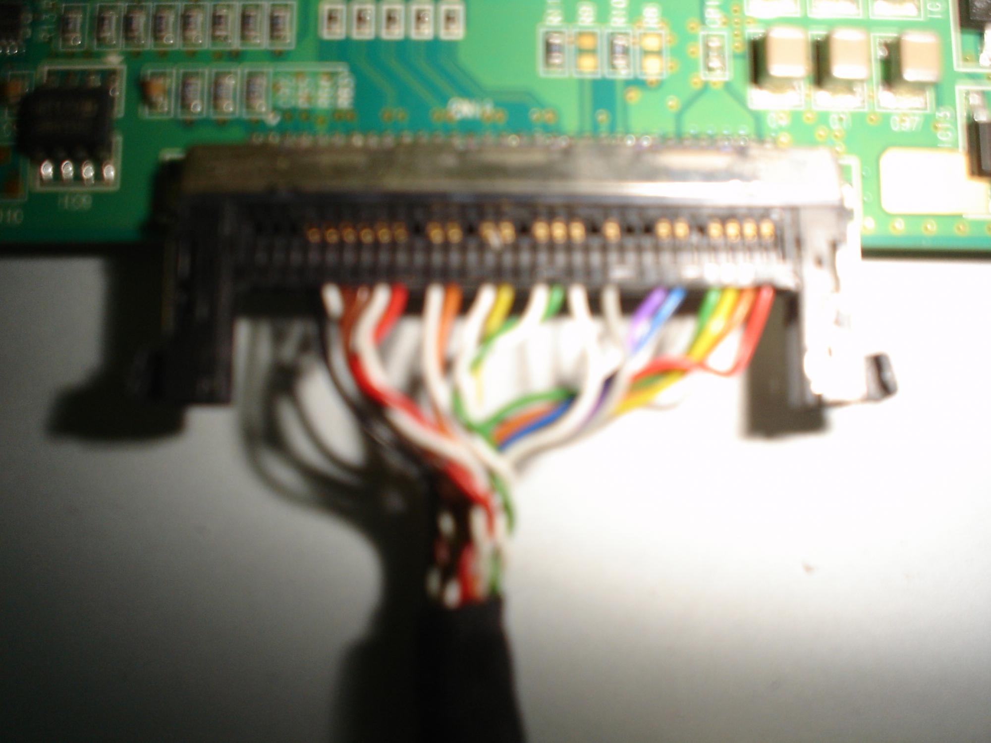

              Check Pin 7 of the "D-Sub 37 Pin" Connector;
              Is pin 7 Active High..? = Result: 1.287v

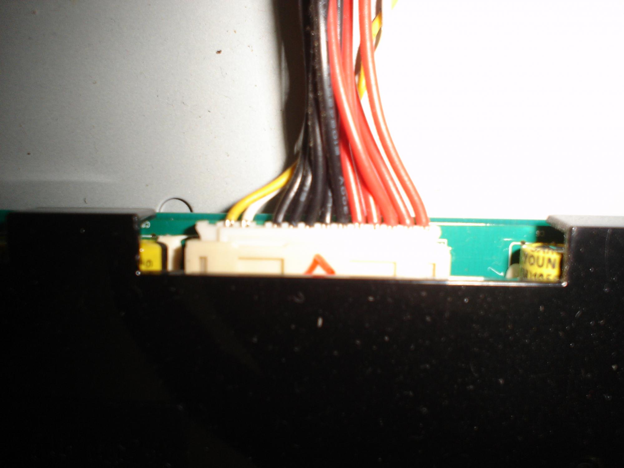

              Check Inverter Power (24v) of LCD Panel OK?
              All Reds = 23.6x volts at power supply and inverter board
              Check Pin 5 of DS37P Conn. Active Low (see panel Spec)?
              Pin 5 = 3.239v
              That completes the Service Manual Checks all results end in what they call changing the "AD Box" which I assume is the Main Board... =/
              -Note: it seems to me that the "high" of pin 7 is Low and the "low" of pin 5 is High.-
              Additional Tests Done by Me... I tested most all the Transistors on the Board... For the Most part they all seem to within Spec Except for the Following on the Main Board...
              -Note all Voltages are placed on the Pins as how the appear on the Main Board Installed-

              Any Advice or Help with the situation would be great...
              Forgive me for not Highlight exactly where on the circuit board the "U" transistors are I cant find my photoshop CD to install on this Computer...

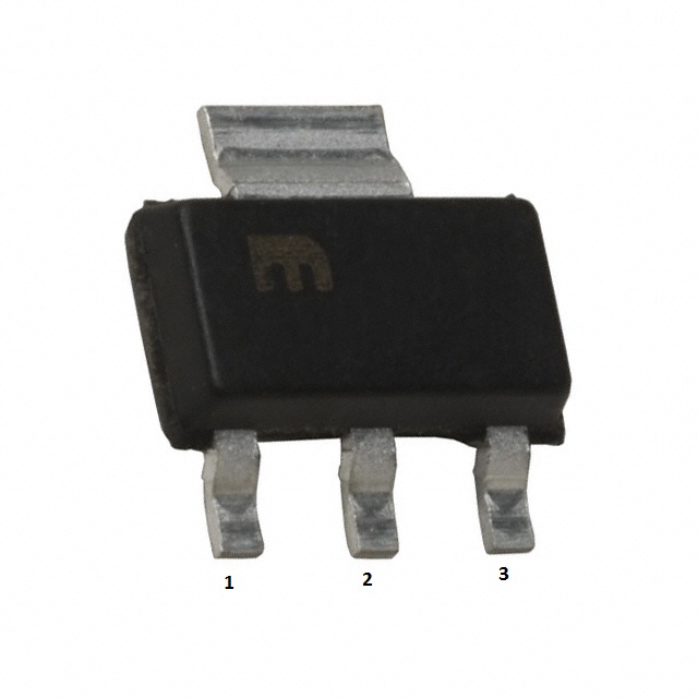

                You certainly put in a great deal of work, but there are a few problems. Let's deal with them one at a time.
                While Photoshop is an excellent piece of software, using it for labeling pictures is similar to using an elephant gun to kill a fly. Microsoft included a flyswatter grade program in Windows. It's called 'Paint'. OK, Paint is more rolled up newspaper grade, but it does the job.
                The readings on U4 and U8 don't make a lot of sense. Let's start over on those. I've attached a picture for the standard package of the AS1117 regulators. Pin 1 is either Gnd or the Adj input. Pin 2 is output, pin 3 is input. The tab is electrically connected to pin 2.
                The AS1117 family comes in fixed and adjustable versions. The usual part number for the AS1117 family is AS1117L-n.n where nn is 1.5, 1.8, 3.3, etc.

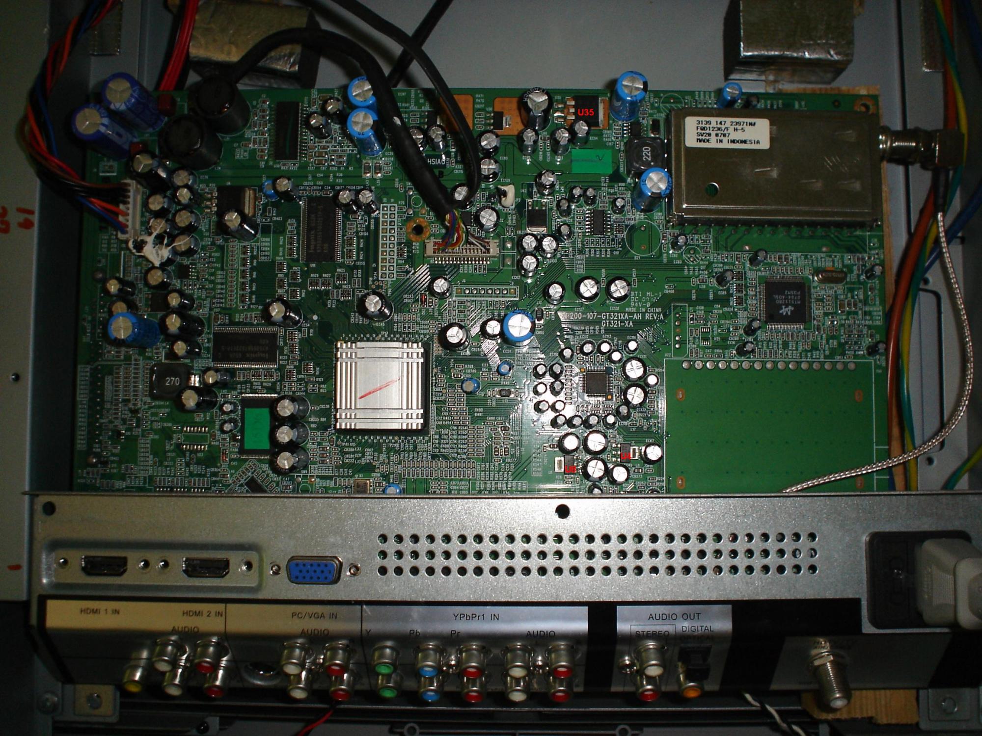

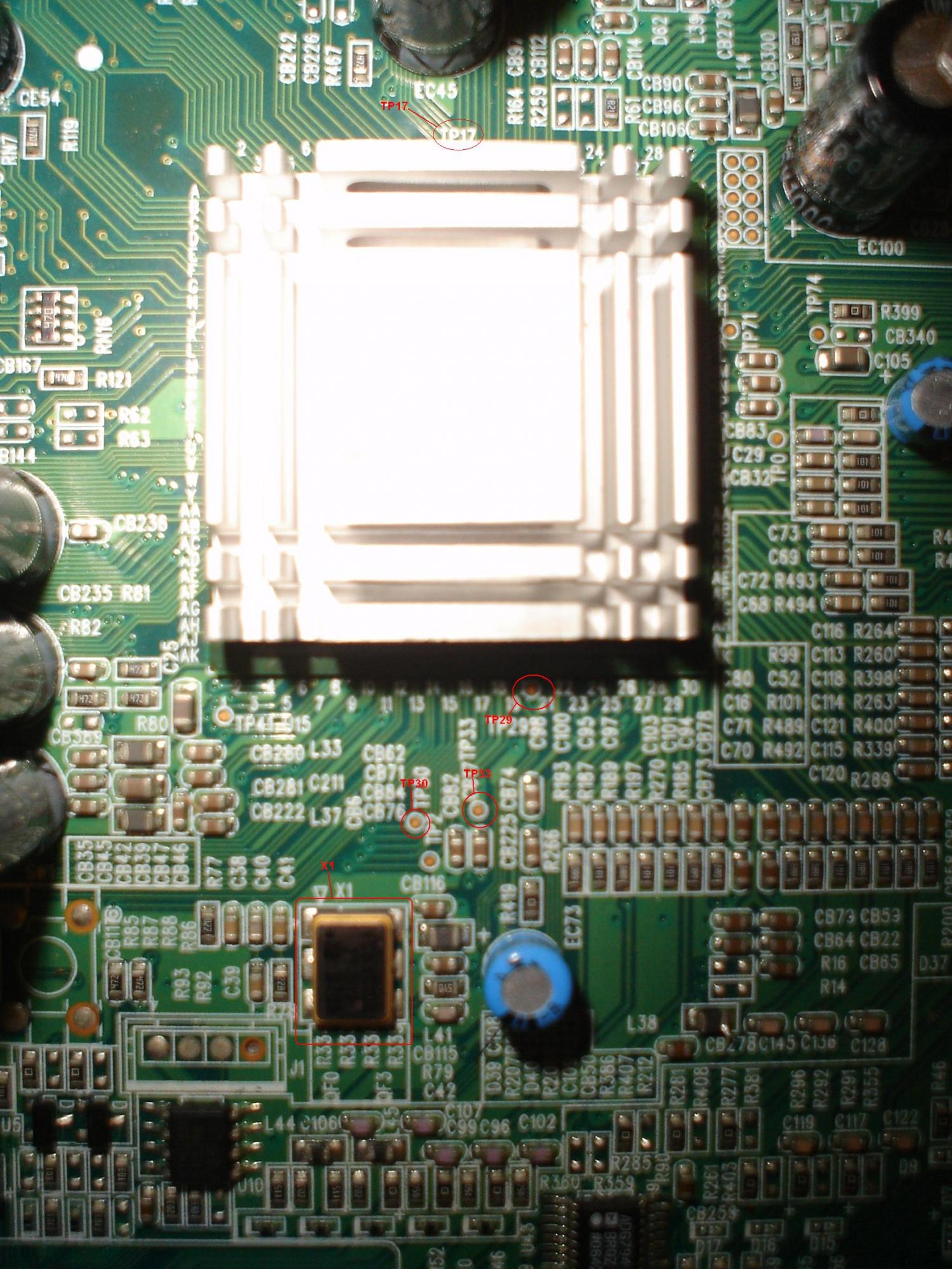

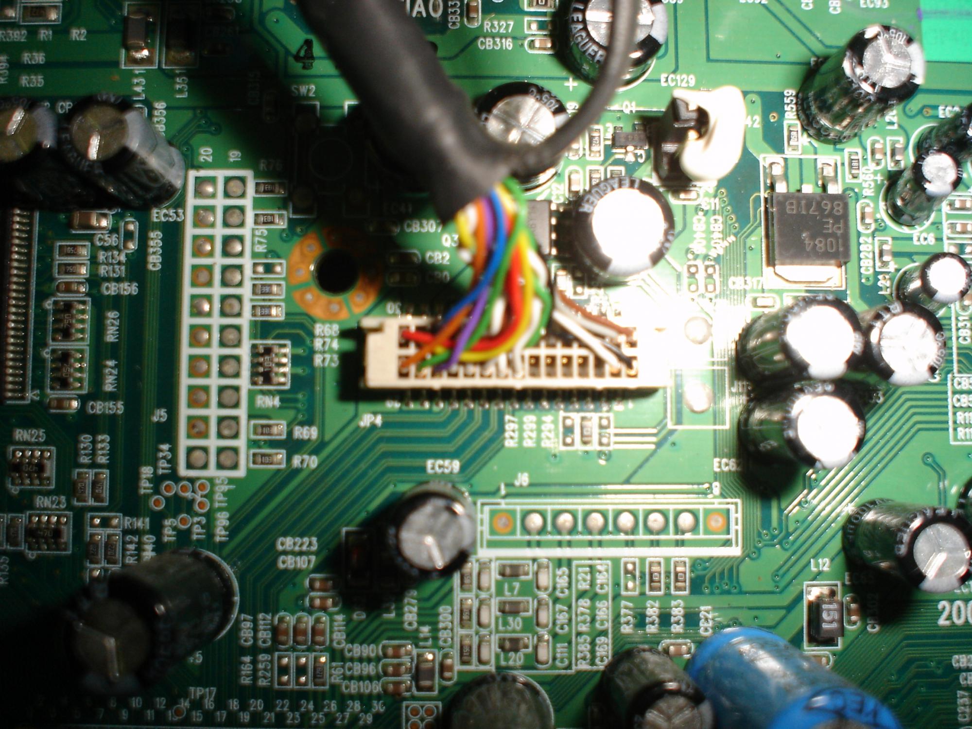

                                  Ok took me awhile to Locate all the test points but here are my results:
                                  J7 = 10.97 - 11v
                                  J8 = 10.96 - 11v
                                  TP17 = 3.242v
                                  TP29 = .57Xv
                                  TP30 = .026v
                                  TP33 = .037v - .031v
                                  U35 = Pin1= 11.97v Pin3= 4.93v
                                  According to the Tests Procedure Provided;
                                  J7 & J8 - are supposed to be between 12v-18v; Which they are not...
                                  TP17, TP29, & TP30 - are supposed to be at 5v; they are not...
                                  TP33 - Is to be a "Digital Signal" which this appears to be; if it is at the right level I do not know because I dont have an oscilloscope...
                                  U35 - Appears to be within acceptable Voltage Range...
                                  I have Included Pics of where and what was tested...
                                  What and where to Check Next..? Do I go Back to the Power Supply or is the Issue within the Main Board..?

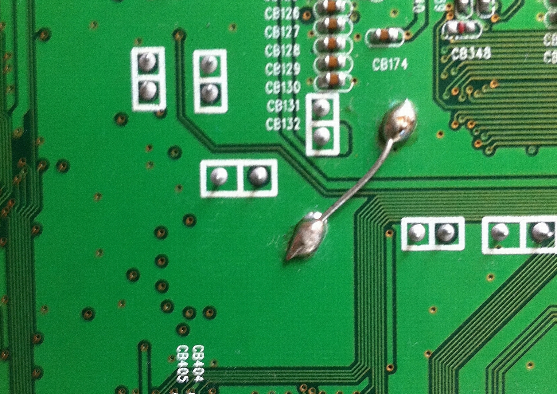

                                      hey slick, question for ya....... on the back side of your mainboard, does it have a jumper-like piece soldered to the board, similar to the one in the pic i attached?????
                                        #79
                                        No Ryn; that is an Obvious repair... Have you tested across the Jumper for power..?
                                          #80
                                          no i have not yet...... however i was told that jumper it part of a revision upgrade for the replacement mainboards that was done BY Polaroid themselves...... ill let you read the emails, i attached them in txt file.

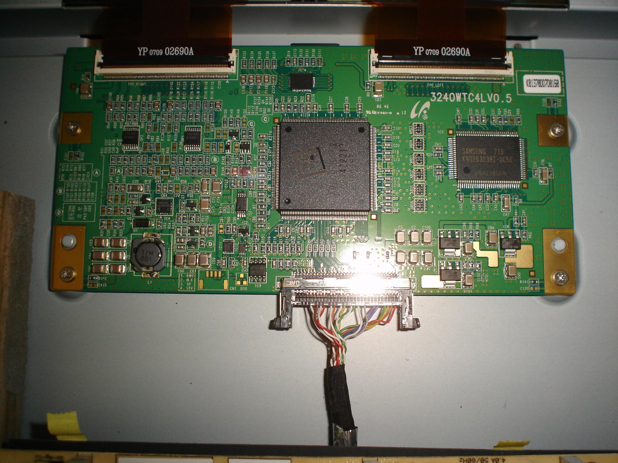

                                          ALSO...... here is the other email i was loooking for, that was sent by the seller of my recently purchased board....
                                          1) Flourescents/backlights have a feedback to the main board/SSB and communicate with the FPGA.
                                          So-if any of the flourescents are leaky or not putting out sufficient light, the OCP (Over Current Protection of UCP (Under Current Protection) will tell the microprocessor to activate PD (Power Down).
                                          2) The T-Con (Timing Controller) also gives feedback to the microcontroller (which is on the board that you purchased) to
                                          shut the screen off.
                                          It is very difficult to troubleshoot without a DSO (Digital Storage Oscilloscope) because of the nature of the digital signal.
                                          We always try our very best to make sure the customer's problem gets resolved because that is how we have built our business in the past 40 years. We feel bad you are having an additional problem which does happen.
