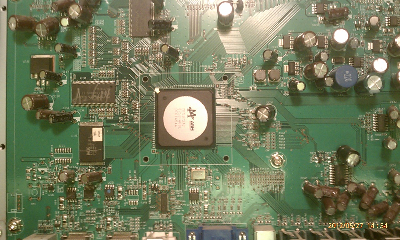

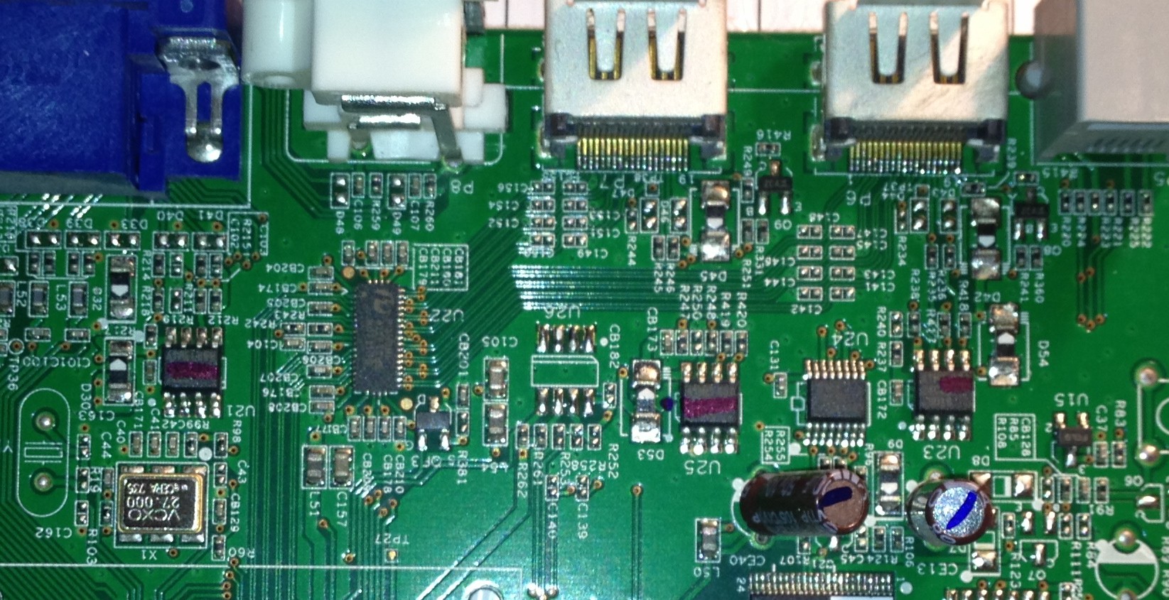

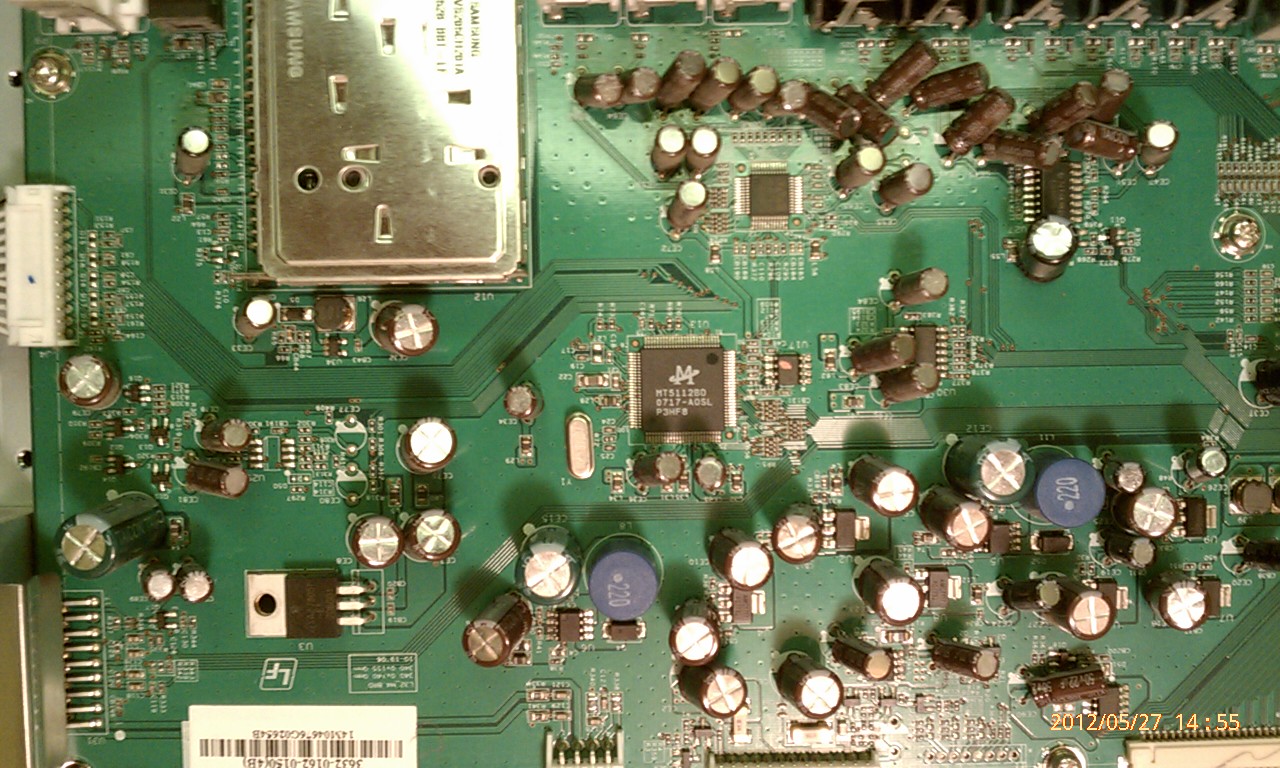

              • kevinm34232
                • May 2012
                • 1884
                #67
                Re: Vizio VX32L turns on with backlight, no video or sound
                Im trying this is my camera phone it seems if I go back far enough to get the whole board in there is too little detail so here are 2. I think I can increase resolution if necessary.
                • selldoor
                  Slow Learner
                  • Dec 2010
                  • 7870
                  #68
                  Better pics but not great - All the caps that are bent are they simply bent and not the plugs coming out at the bottom? Also check none are snapped off In the bottom right hand corner of pic 1 there is an ic with 16 legs it has a brown mark on it. Is that just the pic, just some lacqer stain or a burn? The bigger cap leaning over it also has brown on the end is that just the pic or has it leaked.
                  Its also not good news to see that they are mainly Taicon
                  • kevinm34232
                    • May 2012
                    • 1884
                    #69
                    So is it possible white screen could be from bad caps on main board? There's a lot of them

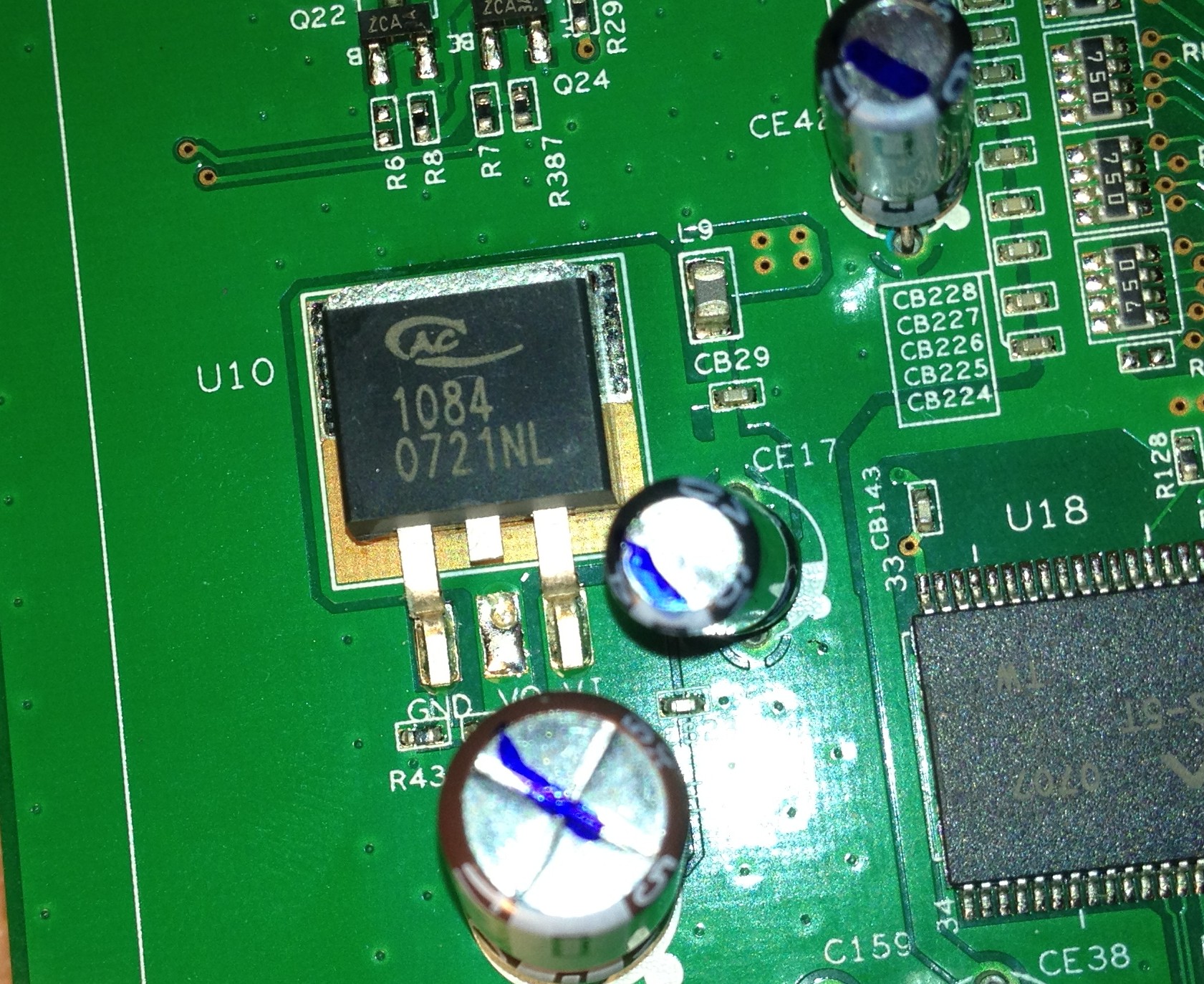

                    • woodyfl
                      • Dec 2011
                      • 17
                      #70
                      Hello I have a similar problem with a Vizio VX32L i picked up cheap since I have a VW32L and VX37L working fine.
                      Vizio light would glow but nothing else. When I swapped out the main board from the VW32L the TV worked So the problem is narrowed down to this board.
                      Its removed from the TV so I located the fuses with the help of this forum.
                      D32- ok
                      D30 - BAD
                      D45 - ok
                      D53 - BAD
                      D9 - ok
                      D54 - BAD
                      Does this seem likely that 3 fuses all went bad? I dont know how to identify these to find replacements. Any help would be greatly appreciated.
                      I read as much as I could here so i hope i've not repeated a common issue.
                      I havent tried to tackle something like this since 10th Grade electronics class back in the late '70's but im getting bored with my regular job and getting cheaper as I age.

                        #71
                        d usually stands for diodes try retesting these on diode test they should read in one direction only
                        • woodyfl
                          • Dec 2011
                          • 17
                          #72
                          Oh ok D for diodes that explains the arrows. D stands for dummy me too.
                          Luckily upon further inspection it seems the old U10 has seen better days so I guess its the culprit hope this is the only problem.
                          Man does that iphone take great closeups.
                          • woodyfl
                            • Dec 2011
                            • 17
                            #73
                            I cant seem to find out what is the equivalent of the U10
                            CAC 1084 0721 NL regulator? I guess
                            Where can one purchase this? Thanks in advance

                              #74
                              @woodyfl perhaps we could make relevant suggestions if you were to update your profile with at least your country and while your in there mains voltage
                              Have you tested it - doesnt look burnt or anything

                                #75
                                Ok I fixed it. Here we get 110 to 115v at 60hz. no I didnt test it I am not really sure how to do that. I was assuming that it wasnt supposed to look like that. it was my impression most of these components were very low priced if one could find them.
                                  #76
                                  What are the voltages on the pins of that device? Check with the black probe in a spare screw hole and the red probe on each pin in succession (except the chopped off one, include the tab/fat pin at the top.)

                                        #79
                                        "I just want to be clear where we are going and make sure if we get there i am capable of completing the tasks"
                                        OK we can explain things at whatever level is needed.
                                        Obviously we cant do the soldering or testing but can give step by step instructions. Whilst the set will be connected to the mains and on, most of the measurements will be low voltage so as long as you are careful to stay away from the HIgh voltage (Hot) side of the board except when guided to do so, you will be ok. I guess it was just a saying but drink and fixing electronics tend not to go well together.
                                        Is your soldering iron electric and what wattage is it? 40 is often best. If you have time practice - just on any old bits of wire or electrical item. Similarly with your meter - practice on different setting check battery/cells car battery fuses bulbs power adapters - anything. It all helps you to get used to holding the probes and looking at the meter.- When it comes to the board checking there are two good rules.
                                        Measure resistance = Power OFF
                                        Measure voltage = Power ON.
                                        You can get some practice on this board just measure resistance of various components and at the same time learn the board descriptions and what they look like.
                                        Getting to the component in question, it is not fried-it is not meant to have 3 legs connected. The centre leg is meant to be cut off short, so that is why I suspect as it is not burnt it will be ok.
                                        Unfortunately many of the tests to try and find the fault on the board rely on voltages and signals it receives from the other boards so it has to be connected.
                                        It would be great if you tried to fix this as there are a lot of reported problems with this set and at least in your case it seems certain a problem on this board. If we can fix it then it will be something to help others in the future.
                                        • killian6pk
                                          • Apr 2010
                                          • 502
                                          #80
                                          SellDoor is correct there are several versions of that Regulator Package (how it looks) Some have 3 legs and some have only 2 legs soldered with the middle leg cut off. In that case usually the wide metal tab at the top takes the place of the middle leg. I found a datasheet for this Regulator (not sure it is the exact same). It should give you some idea about these and their different packages.
                                          http://pdf1.alldatasheet.com/datashe...X1084-1.5.html
                                          Also on your Fuses they should be small white surface mounted (soldered on each end) and be marked as F1 and/or F2. Often there is written on the board the Amps and the Voltage of the Fuse. You can check them with a Digital MultiMeter set on Ohms with a probe on each end the DMM should read no more than 0.1 ohms. If it reads more than that the Fuse is probably bad. Good news is that they are cheap as are most of the other components on the board. Find the Fuse or Fuses and report back the Amps and Volts you got.
