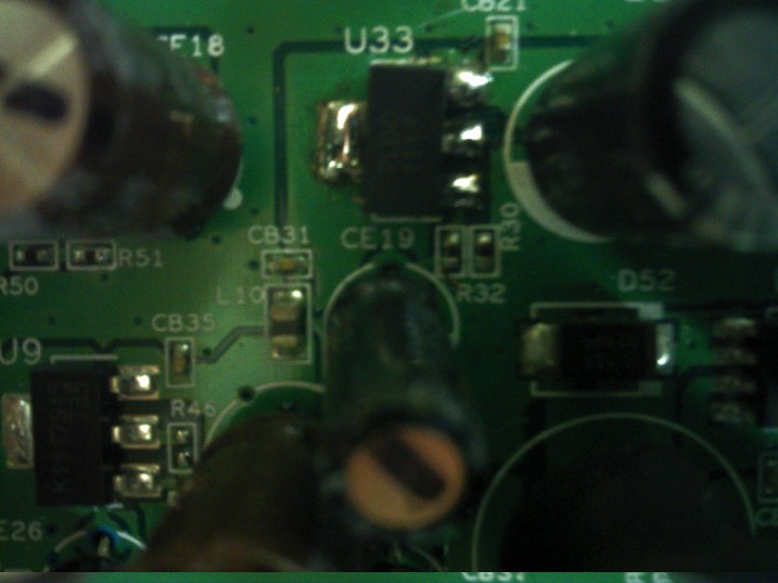

        I purchased a VX32L on craigslist with the same problem, folowed the service manual to diagnose the DC-DC regulators. The U33 regulator just like everyone else here who has succesffuly fixed there's, was the problem.
        When testing U33 to ground I would get the following to the CASE GROUND (do not test with the 3rd pin as that is an adjustment pin, not a ground)
        In to case ground > ~3v
        out to case ground > ~2.2v
        U33 is supposed to have 5v in and 3.3v out. I was worried that i wasnt getting 5v to it, and that U33 was not the problem, but i bought the part anyway and soldered it in, and the TV works perfectly.
        The part number is AMC1117, as has been said here already, that is a really generic part that comes in adjustable or fixed versions. The board clearly uses an adjustable version. I purchased STMicroelectronics LD1117SC-R http://www.mouser.com/Search/Product...511-LD1117SC-R and it worked fine.

          Well I thought it was fixed, but then it went bad after ~ 12 hours of testing.
          It turned off randomly twice during the 12 hours, so i thought it was heat, but then the next day after it being off for 10 hours it started compleatly then a few seconds later went to the white vizio logo, but not able to be turned off using the power switch.
          I tried a different brand adjustable 1117, but it didnt work right when i soldered it on, but after probing it a while it worked for a bit (i think maybe it works if i accidentally bridge the input (in the broken state around 3.0v), to the output (supposed to be around 3.3v)...

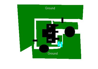

          Im concerned my error is slightly different then other people as i dont just get a lowered output, but also dont appear to get 5v to the input. The testing path says to consider replacing U1 (the 8 pin IC that gives 5v to many regulators once the tv is switched on, part 4953gm), but i measured 5.0v on all the output pins from it.
          Originally before my regulators arrived by mail I replaced the electrolytic cap that filters the 5v input area to ground with a panasonic EB, and although EB probably isnt the proper cap for this position, it didnt work after replacing just the cap, and i wouldnt think the cap would go bad this fast, so i dont think its the cap , although i could be compleatly wrong.
          So my question is basically is it normal to have a lowered input voltage to ground when a regulator fails, or is there likely a different problem then the regulator, such as the cap or one of the tiny smd caps, or the IC that provides the 5v to this regulator.
          In the attached drawing the adjustment pin is connected by 2 blue resistors to both the output and the ground, the resistor to the output is ~ 100ohms, and the resistor to ground is 150 ohms.

                I havent tested caps much, as usually i only replace them if theyre bulging, but i used my multimeter on a high ohm setting to read resistance on a few of them, and was expecting to get the resistance to go up, which most of them did, but between the output of u33, and the ground, in multiple places since it is filtered a few places, i get a resistance of 270ohms, which does not change, i see thats comming from the 2 resistors that i explained above handle the adjustment pin, but is that normal? cause it seems like it might defeat the purpose of having filter caps if the output and ground are connected by a total of 280 ohm resistance.
                So perhaps the ouput is almost shorted to the ground and this is causing a huge strain on u33, causing its input and output to both be lower? Im not sure how regulators work though, so not sure if a huge current going through it can lower the input.
                Anyway i know very little about how circuits like these are designed, so just tell me if thats not where the problem is.

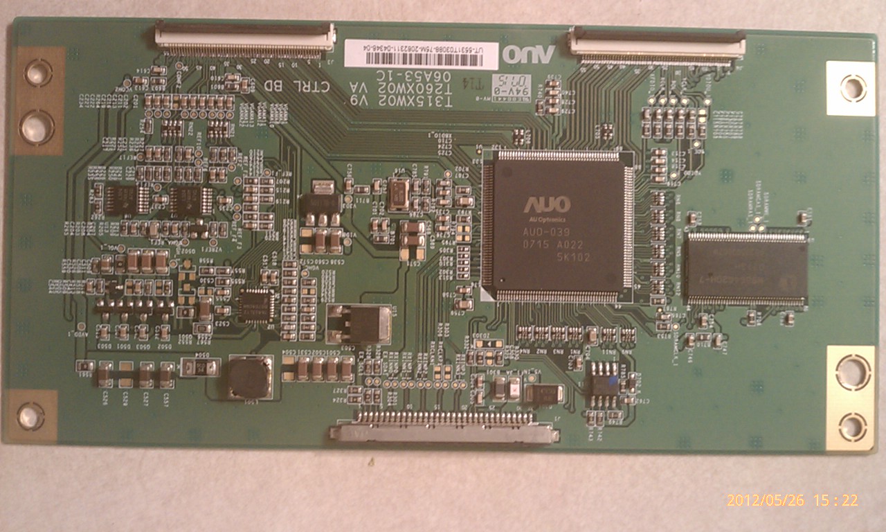

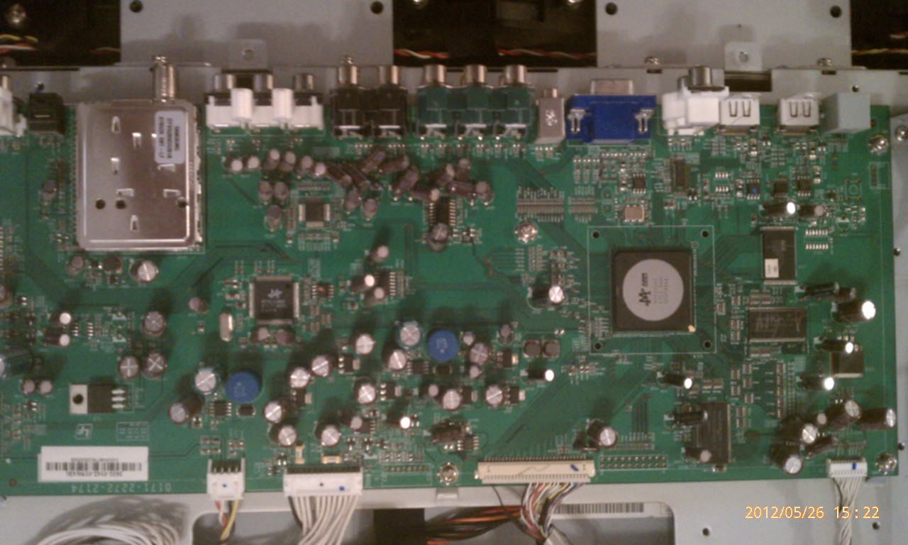

                      I need some help please. I have a VX32L that powers up with an all white screen. I tested all the voltage regulators described in this thread with the following results:

                        #51
                        Re: Vizio VX32L turns on with backlight, no video or sound
                        Welcome to the forum-
                        We can help a lot more if you please post good clear pictures of the whole chassis, and then pictures of each board, front and back and close up of connectors, (max resolution 2000x2000 and 2MB) using the manage attachments button, which is found by clicking "go advanced" under quick reply.
                        Examples of what is needed
                        https://www.badcaps.net/forum/attach...1&d=1290283049
                        https://www.badcaps.net/forum/attach...7&d=1280167246
                        It will be useful if you can say how the fault started flashing screen ?? etc and a bit about yourself - skills tools etc.
                        White screen can be caused by a number of things and often by a fuse on the Panel Board. Also loose cables can cause this. For some reason or other there does not seem to be any pictures of this board so I cannot show you where the fuses are. Try reseating all cables.
                        If you post good clear pictures I will look and try and help you find them.
                        Do all the on off controls and the led work?

                          Yes controls and on/off working, do you want a pic of the main board or the T-Con board? Vizio logo goes orange to white when turned on, then to orange when turned off.
                            #53
                            May as well do both while youve got the camera going - its only to help you locate the fuses at the moment. Go carefully if the T con is attached to the panel.
                              #54
                              Pics of VX32L main and T-Con board...
                                #55
                                Ok Main board pic is not really clear enough for trouble shooting, having said that there are two fuses I can see just above the second connector from the left.
                                They are white rectangles with gold? ends- board may be marked as F1 & F2 but I cant read it.
                                On the Tcon there is a white fuse near the right hand end of the connector at the bottom of the pic - it looks to have a red marking on it.
                                There may be others - now you know what to look for you can look.
                                To test these POWER OFF for 5 mins Meter set on OHMS 200 one probe on each end - should be the same as touching the probes together. Post results
