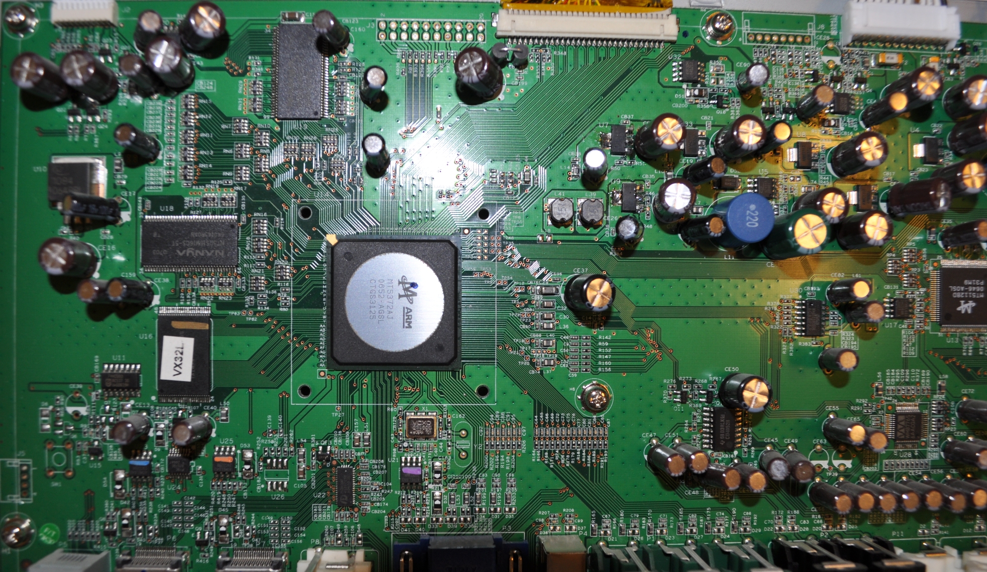

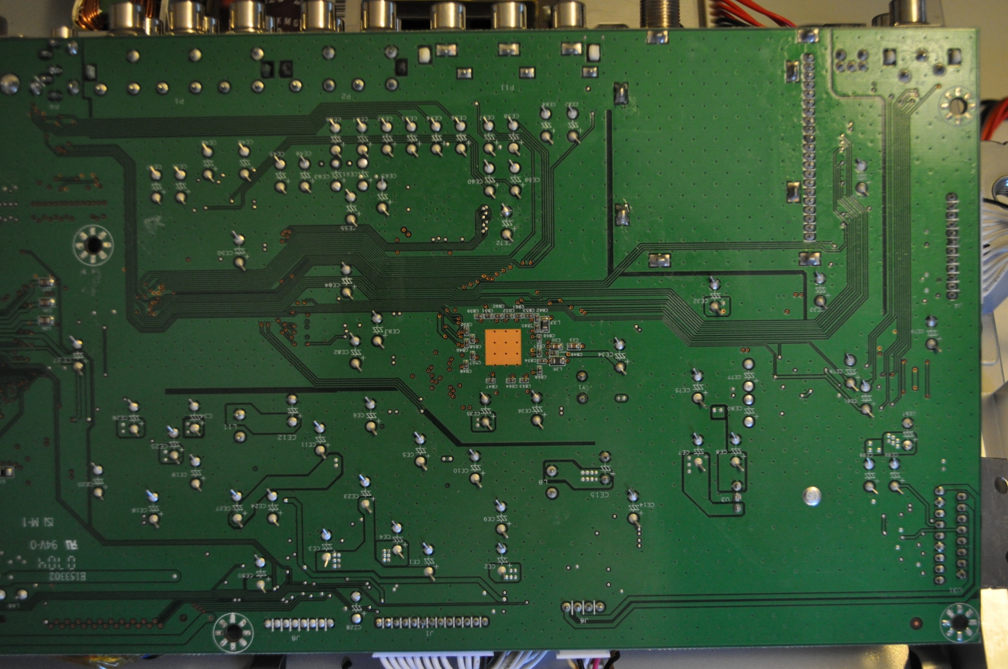

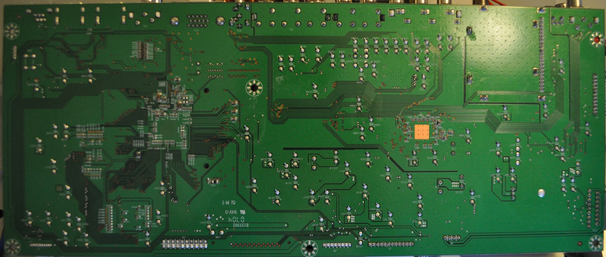

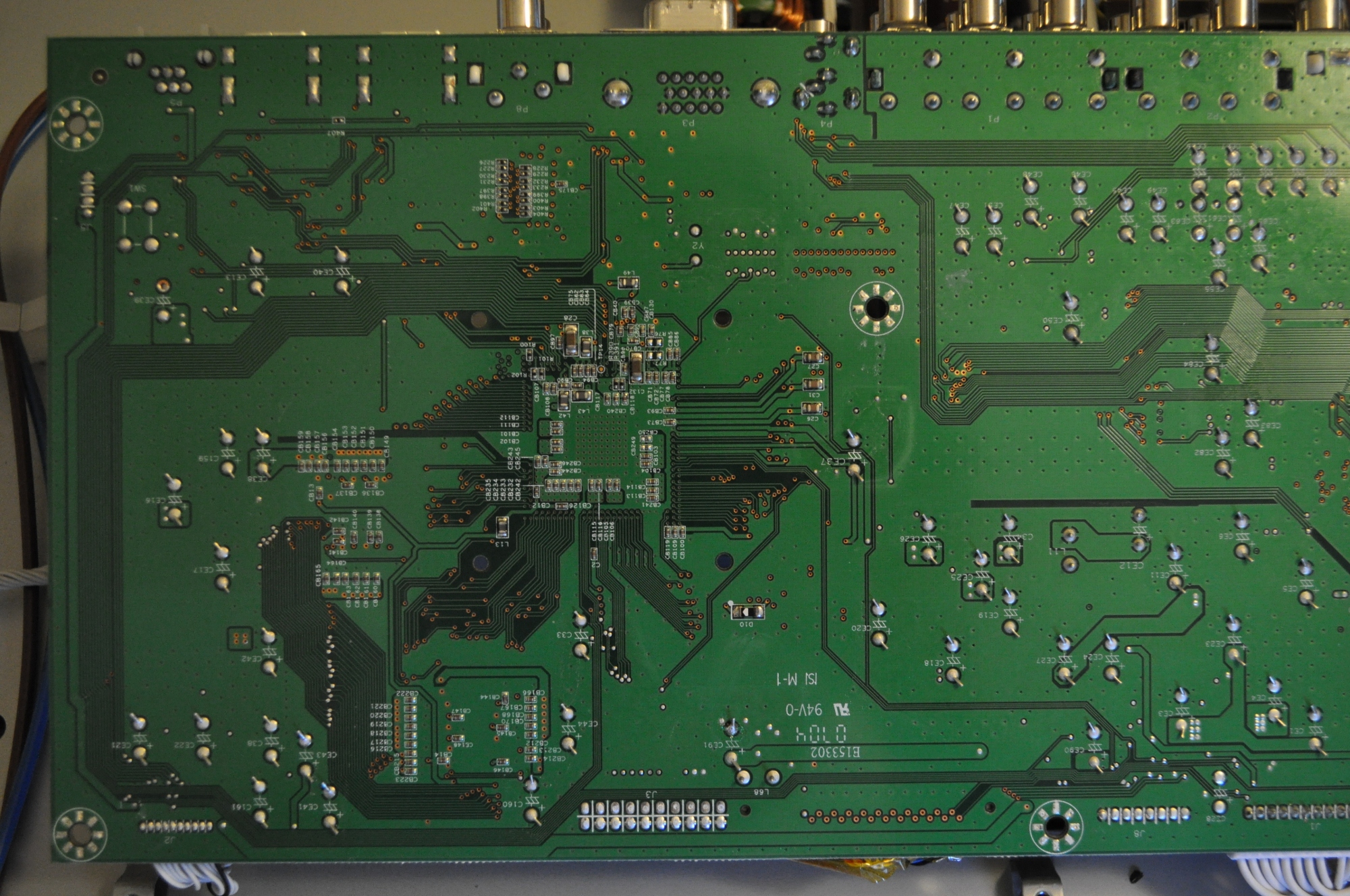

    OK, so I'm rereading posts, have new adjustable regulators on order (to replace the wrong AP1117E18 fixed voltage regulators I put in ). Not much to do until I get those parts replaced, but attached are a series of photos of the main board.
    To summarize:
    Problem: Vizio VX32L (2007) TV powers on, backlight is on, but no sound, no picture, and only way to turn TV off is unplug. All other controls are unresponsive (both remote and the buttons).
    Inspected/Tested/Tried:
    No visible caps blown, no other smoked components seen/smelled.
    reseated cables/ribbons
    tested fuses on main board OK (0 ohms), 5V on one, 12V on the other
    Tested outputs from power supply- 5V, 12V, and 24V all present in appropriate places.
    Tested fuse on T-con board(?) (at top under a bunch of metal), 0 ohms.
    IC Top Mid Bottom
    U7 3.3, 1.8, 0 (after I replaced with the wrong regulator!)
    U9 is 3.3, 2.2, 0.4 (after I replaced with the wrong regulator!)
    U8 is 5.1, 3.3, 2.0
    U33 5.0 3.35 2.1
    U2 5.1 3.3 2.0
    U4 5.1 3.3 2.1
    U15 5.15 in , 5.05 out
    Status:
    Waiting until correct regulators come. Is there anything else I should be testing while I'm waiting? Is it likely I cooked something else putting in the wrong regulators, in which case I should look for a new main board?

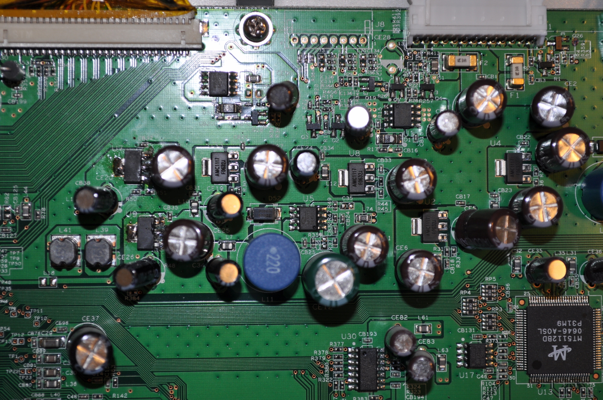

      I soldered in the new (correct adjustable AP1117EGDICT-ND regulators) into u7 and u9. The problem of no sound/no picture, but + backlight still exists. These are the readings after i replaced u7 and u9 (done the correct way-pins 1-3)
      These were all AMC1117,F0646J
      IC PIN 1 Pin 2 pin 3
      u7 0.001; 1.258; 3.351
      u9 0.249; 1.493; 3.350
      u33 2.095; 3.359; 5.08
      u8 2.080; 3.339; 5.12
      u2 2.071; 3.332; 5.13
      u4 2.079; 3.334; 5.12
      according to what I have read, pin 2=(pin 1+1.25), which puts these about where they should be.

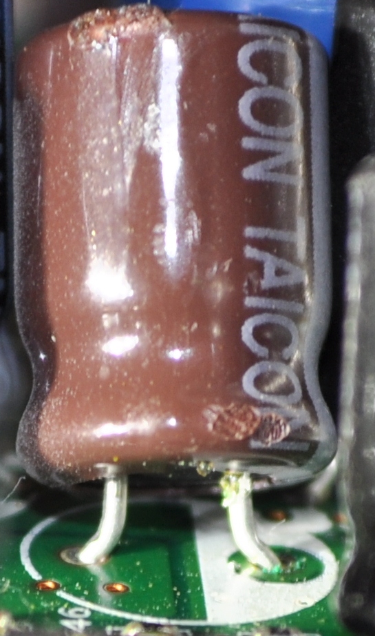

      On second inspection, I did notice there is some corrosion under c34 and c18 (220uF, 25V caps near u7 and u9)- see attached photo of cap (cathode has corrosion on both) . Worth replacing?
      Other thoughts?
        Re: Vizio VX32L turns on with backlight, no video or sound
        Yes, replace the cap, it looks like the right leg is coming off.
          I replaced c18 and c34. I am still getting the same symptoms. Where to from here?
