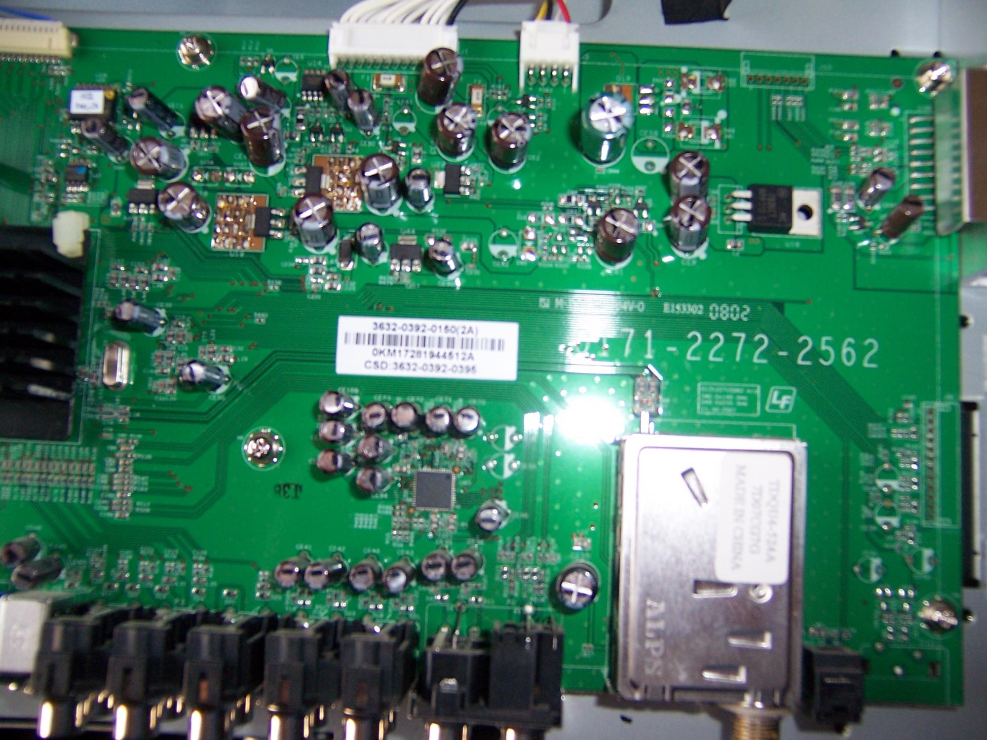

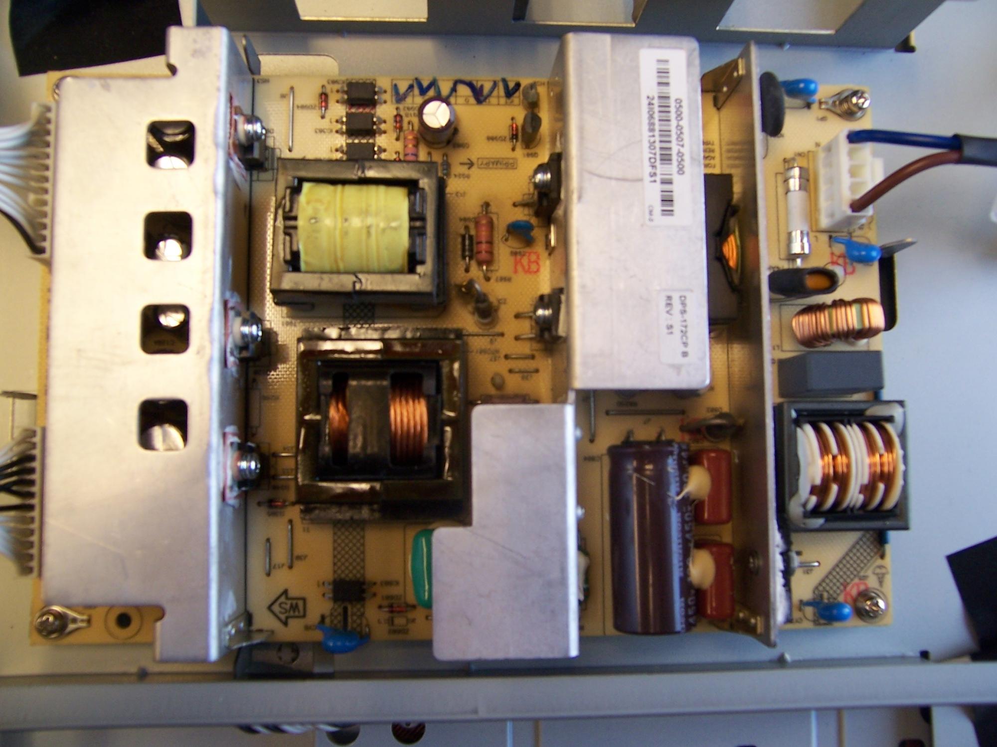

            1. The power supply is a dual unit, standby and main. The standby section (typically 5 volts) is on whenever the TV is plugged in. The main board switches on the main section of the power supply.
            Obviously you have a different version of the main board. I suggest posting a picture of your main board and another of your power supply. Sharp, well lit pictures at a resolution of close to (but not over) 2000 x 2000 pixels are best. Attach them using 'manage Attachments" below the text entry area. If you also list the part numbers of the ICs you listed above, it will be easier to identify the problem.

              Sorry,, i will have to try a different camera to take pics with, from this one they will not upload, thanks,

                Perhaps the pictures are too large? I recommend VuePrint Pro for resizing. Cropping, resizing, and saving is a simple 3 step process. It's free, note the serial number on the download page.

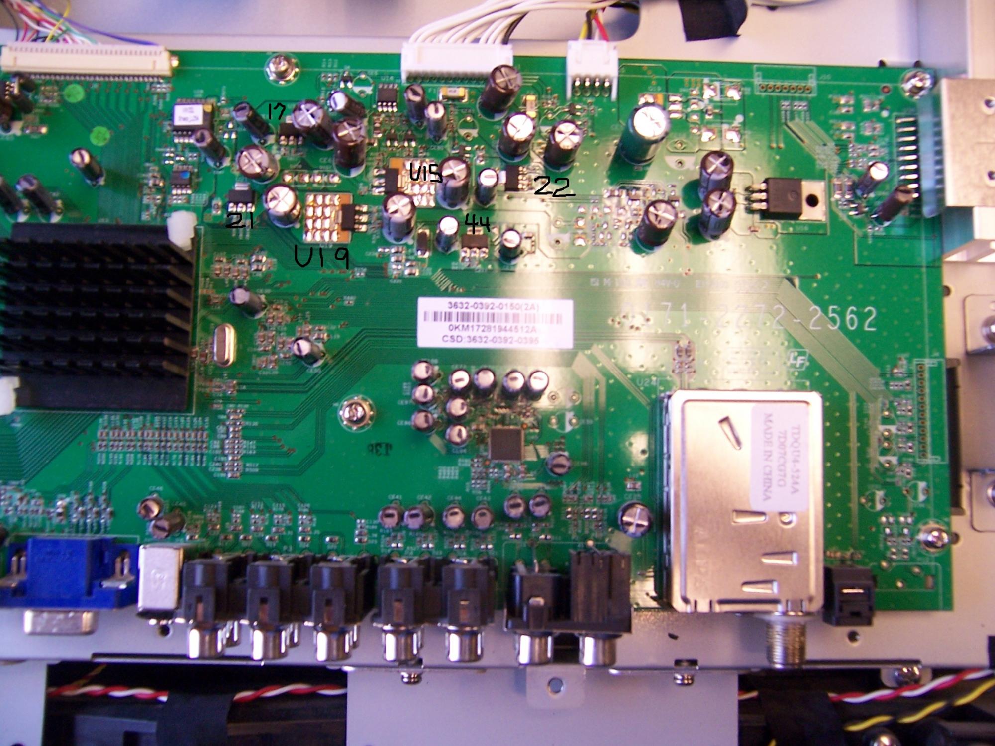

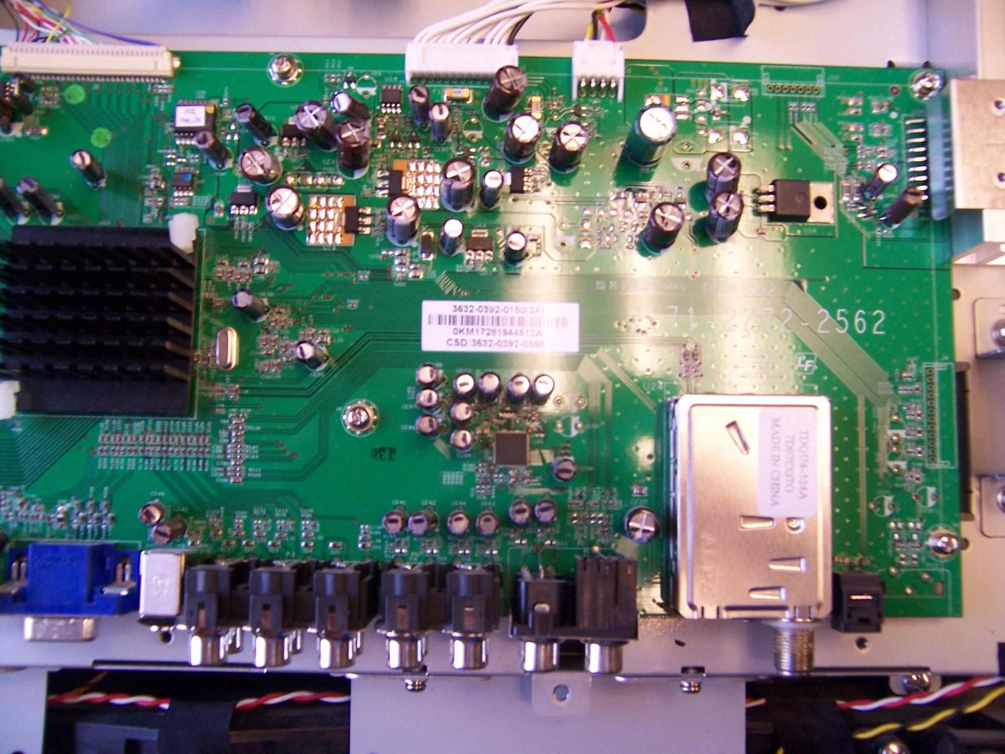

                  Okay, so i took some pic's and i labeled one called 4533M (to help see location)- here are the voltages i read with tv plugged in to AC and nothing else.
                  u15 Gnd Vo Vi
                  1.4 2.3 5.13
                  u19 1.2 2.4 5.13
                  u21 0.1 1.2 2.4
                  u44 0.01 1.2 2.4
                  u22 2.02 3.3 5.15
                  u17 2.0 3.3 5.15
                  thanks,, maybe i just need to purchase a handful amc1117 and go to soldering. BTW these are all amc1117

                      There may be something wrong with U15. I can't be sure because you only give 2 significant figures, I would expect the voltage on pin 2 to be 1.25 volts greater than the voltage on pin 1. It is only .9 volts higher, but I'm not sure if that is due to your using too high a range.

                        PLain Bill, YOUR the MAN!!,, i replaced U15 and the TV is working fine. odd to me tho when i replaced U15 i couldn't read voltages on U15 like VI VO but yet TV turned on and worked fine. O well,,, all good that ends good, thanks so much,,
