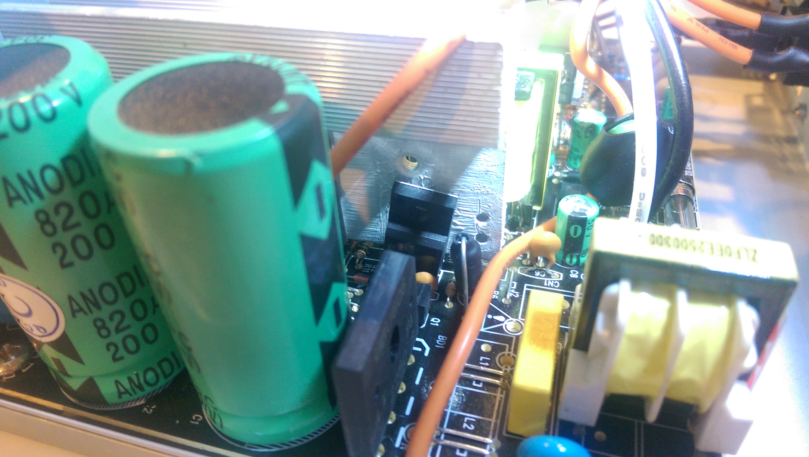

 Wow! It's like a 4th of July fireworks show went on in there.https://www.badcaps.net/forum/attach...1&d=1437463738 (LARGE IMAGE - overview of the main area of damage, coil completely burned, caps obliterated, and I just noticed, one of the cap tops is behind one of the large caps)
 I wonder what caused it to burn like that. It looks like the main and 3.3V output toroid inductors are okay. Perhaps the fan went and short circuited and started burning? Or a short on primary that somehow didn't blow the fuse? I'm more inclined to think it is the fan. If it was wired straight up to 12V, there will be nothing to stop it from burning if it short circuits. I've seen cheap fans on older MSI and XFX cards literally melt their cases after their driving FETs shorted. Wouldn't be surprised if this is what happened here. Unfortunately, there isn't much left of the fan here to see if that is the case or not. And yeah, I can imagine why no one will want to analyze this PSU. I tried to open up a burnt out SSR once (which had a shorted Triac inside), and man, what a smell that thing let out. I got a stink on my hand that I couldn't wash off for a few days afterwards.Last edited by momaka; 07-23-2015, 02:10 AM.Comment

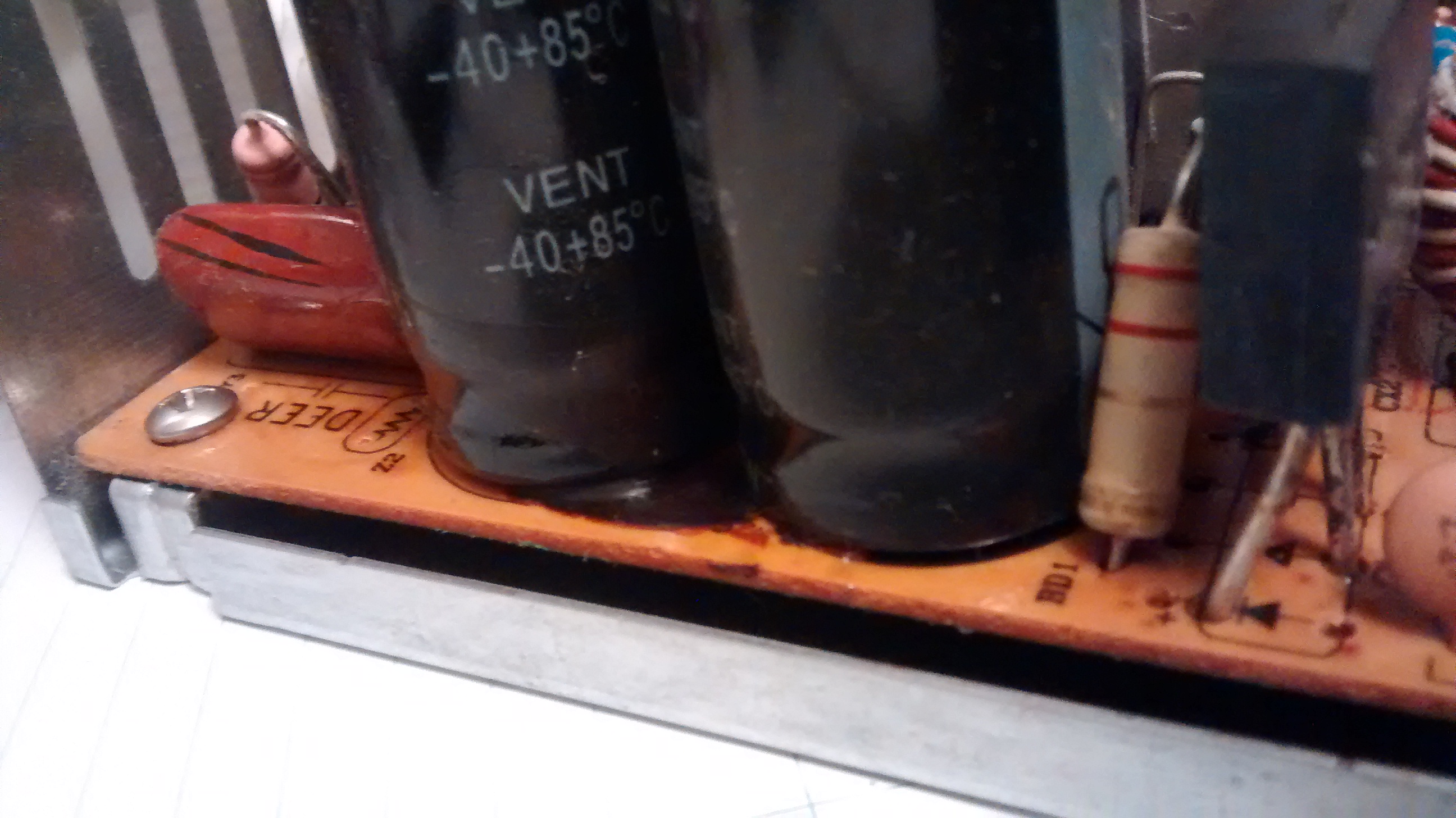

 Originally posted this on jonnyguru but this deserves to be here
 But this one in particular was hard to pass up, i usually peruse craigslist for free computers in my area, and a pentium 4 custom built PC popped up.
 I arranged the date and i went and picked it up he said it ran fine since his son who built computers (and was an expert) built one for him.
 I took it home and the first thing i took a gander at was the PSU, and guess what i found a Deer PSU 250 watt max on a P4 system i was like oh deer, pun intended.How bad was this going to be and i found my favorite caps to make fun of Rulycons!!!.And most were popped, the main caps were VIVA which were leaking in the bottom
 What i still wonder is how could th is have supported the system with 256mb RIMM's a video card,adaptec scsi card,modem,sound and a pentium 4 1.4ghz processor two cd drives and 2 hdd's which were removed. It was a 15 yr old PSU and it actually started i actually hid under a table when i turned it on..any thoughts if this is the worst psu of the milleniumYes i love Nichicon MUSE Audio Capacitors...they would look awesome all over any motherboardComment

 We, the people at badcaps.net, love Rulycons!I took it home and the first thing i took a gander at was the PSU, and guess what i found a Deer PSU 250 watt max on a P4 system i was like oh deer, pun intended.How bad was this going to be and i found my favorite caps to make fun of Rulycons!!!.And most were popped, the main caps were VIVA which were leaking in the bottom
 So, thank you for posting . .

 Basically, your PSU appears to have the same (or very similar) design as the first one I posted above, but with cap choices and heatsinks of the second unit.

 Yeah, amazing indeed how such gutless units still continue to run. What's even more amazing is that the PSU you got has a self-oscillating 5VSB circuit without feedback that still works. Those designs usually send the semiconductors in the sky after a few years.
 I got a PSU similar to yours last summer. Off of Craigslist too, with bulged caps, but still working, so same deal like yours. I just finished posting it here:

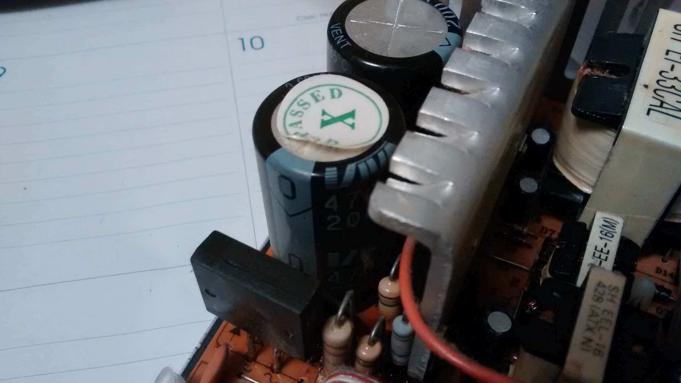

 Any chance this is just glue at the bottom of the primary caps?Comment

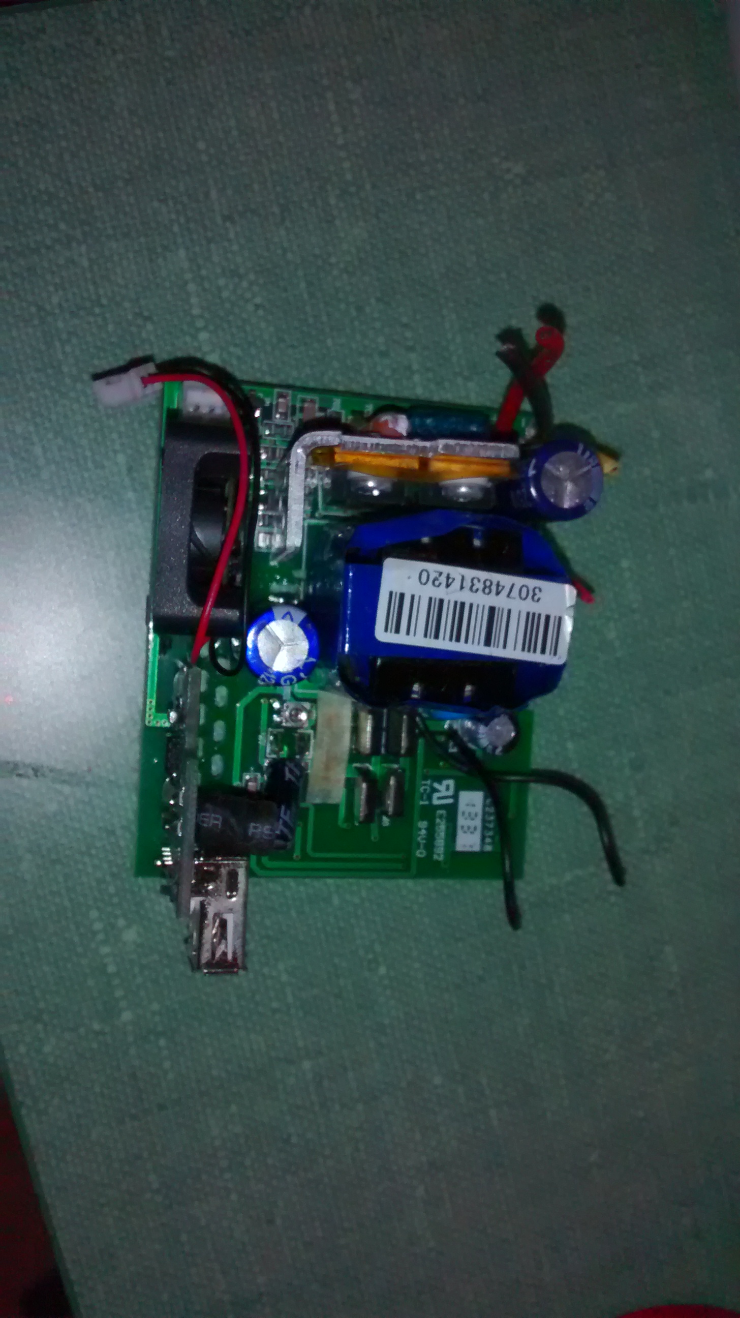

 This one is not exactly a power supply but it is an Inverter, it's designed to convert 12vdc car battery power to 110 to 130 watt AC power and a USB port for charging...after being on this site, i knew i had to take it apart,because it failed after 1 year, the fan works but the caps look unusual, but the fan seems to not spin correctly (its a yateloon fan)We, the people at badcaps.net, love Rulycons!
