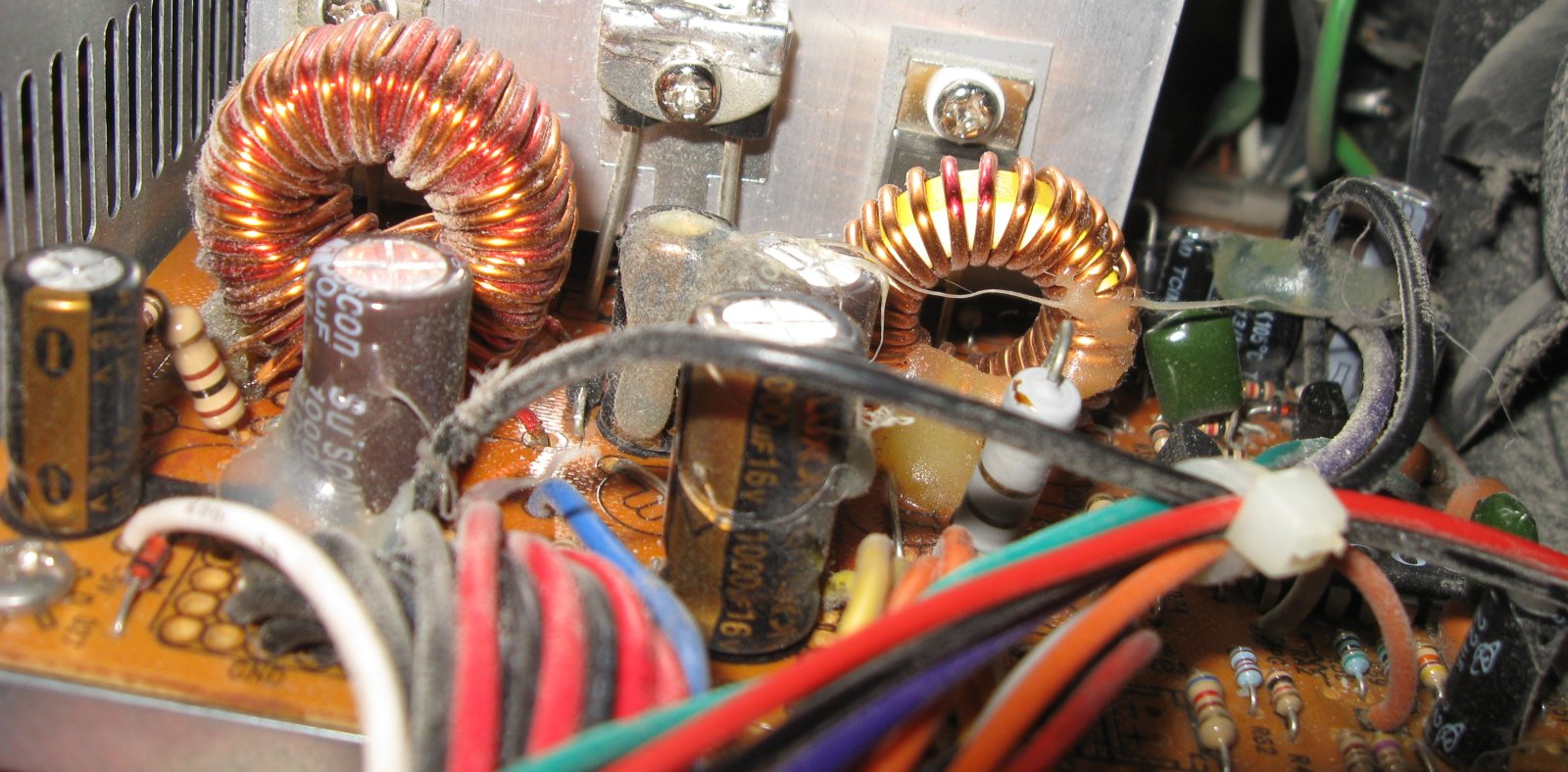

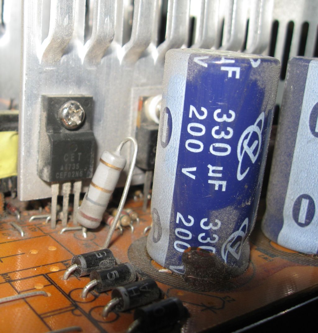

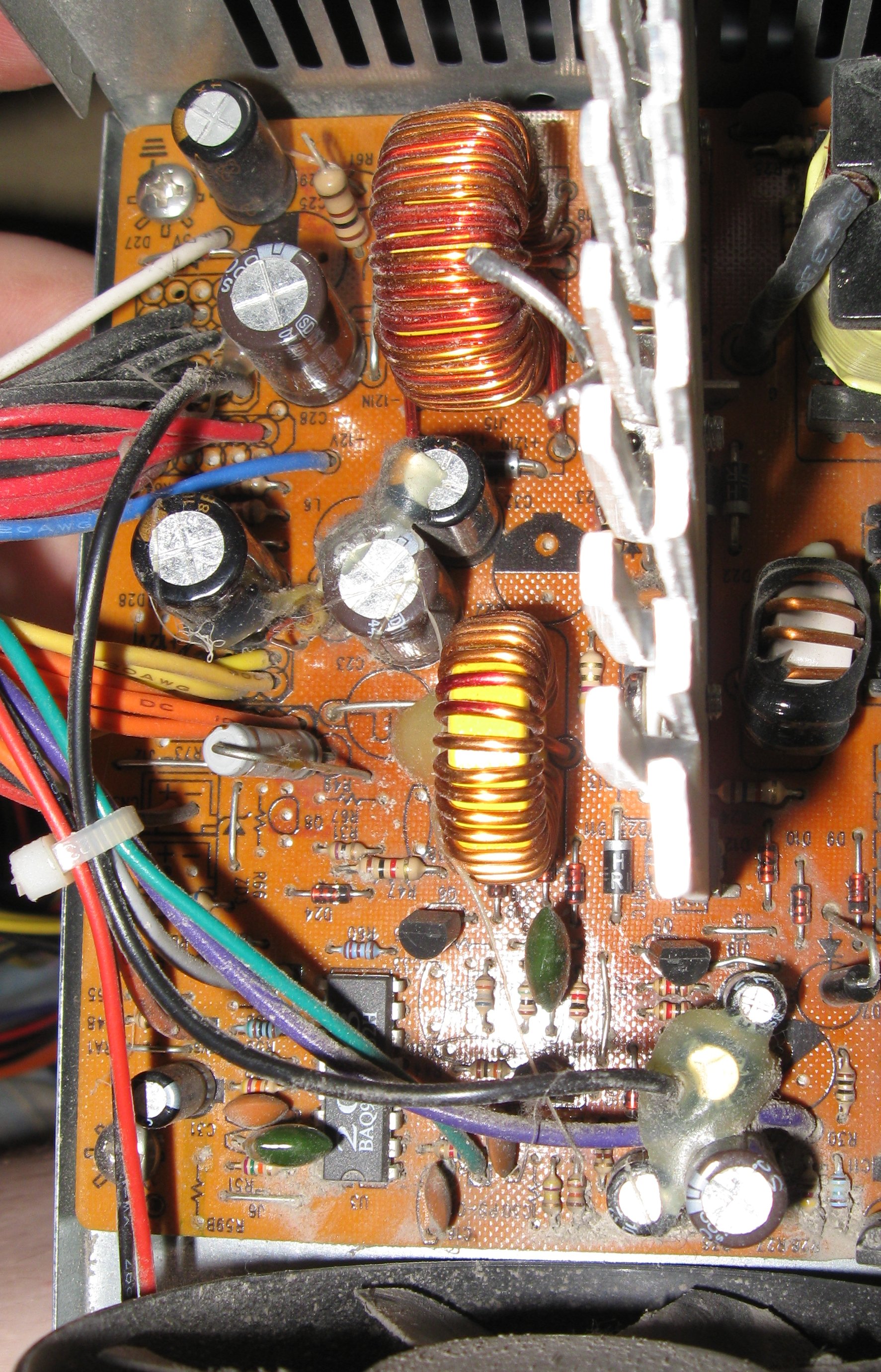

                  And here's the shitty power supply that the power supply above is gonna replace.
                  This one in theory still works but I'm a bit concerned about the 12.5v output. After opening it up, I realize it's actually worse than the above power supply.
                  Just some Y caps that I doubt they're safety rated on the primary side,
                  puny rectifier diodes good for probably 1A each,
                  330uf/200v YC brand capacitors that in reality are 216 uF each (and about 0.15 ohm esr not that it matters here)
                  didn't bother to write down the mosfet/transistors on primary, i though they can be read from pictures... can't be bothered to open it again
                  ei-33 (in theory) transformer
                  SBL1640CT (16a/40v max) schottky on 5v, SBL1040CT (10a, 40v) or 3.3v, two big diode treatment on 12v (who knows, maybe 4-6 amps? )
                  Some YC caps on secondary side, some Su'scon (probably on 5v and 3.3v) , I think maybe a G-Luxon on 12v? 470uf/16 on -5v , 1000uf/16 otherwise as far as i can see
                  no secondary side inductors in sight, just a couple of minimum load resistors (3.3v and -5v?)
                  Weak, really weak...
