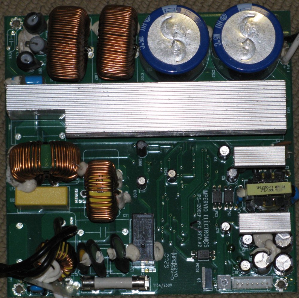

    Here's a big one:
    SilverStone ZM1200M (Impervio IPS-1200EP)
    PFC board:
    390uF 450V x2 Hitachi HU primary side units.
    1000uF 16V Chemi-Con KY x2 before +5VSB inductor with 1000uF 16V Chemi-Con after it.
    20N60C3 x2 (two parallel sets) for interleaved PFC stage.
    STTH15R06D x2 rectifiers for PFC stage.
    20A 600V bridge rectifier at AC input.
    TOP243Y switching regulator for +5VSB stage.
    MBR10100CT rectifier for +5VSB stage.
    Delta IEC AC input filter.

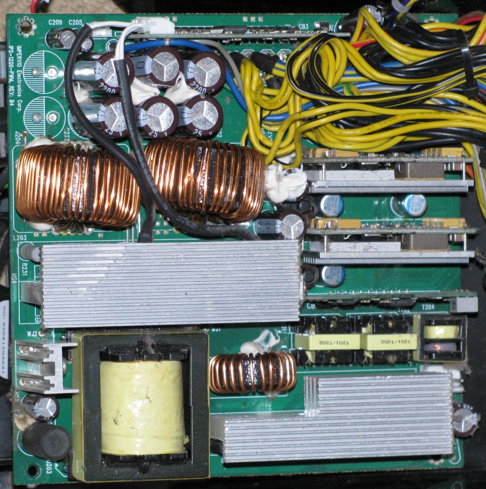

    PWM board:
    2200uF 25V Chemi-Con KZE x6 at +12V output with 1000uF 25V Chemi-Con KY near end of 12V rails.
    270uF 16V Chemi-Con polymer units at the input (after inductor) and output of the +3.3V and +5V synchronous switching regulator modules, each having an L6712 IC.
    Both modules have 47uF 25V x4 tantalum units at input and 330uF 10V x4 tantalum units at output.
    1000uF 25V Chemi-Con KY before inductors connected to +3.3V and +5V regulator modules.
    1000uF 16V Chemi-Con KY at +5VSB output.
    220uF 35V Chemi-Con KY at -12V regulator input with 100uF 25V Chemi-Con KY after it.
    10uF 450V Chemi-Con CLA unit before full-bridge converter.
    UCC3895 PWM controller.
    PS232S output monitor.
    IRFB4410 x8 used as synchronous rectifier for +12V rail.
    20N60C3 x4 configured as a full-bridge converter.
    Both boards: All other electrolytics are Chemi-Con KY Series - no poor quality electrolytics anywhere.

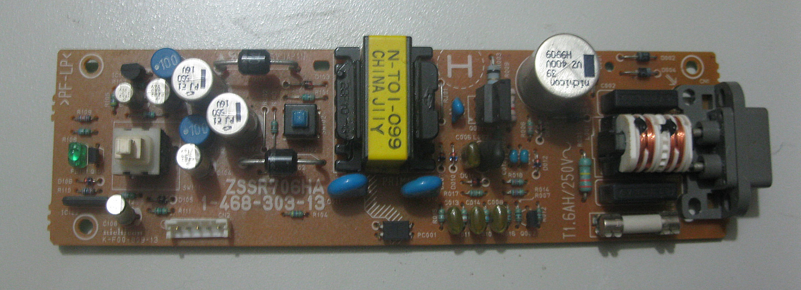

        If I can rip apart the slimline PS2's power brick I'll post pics. For now, here's the guts two "identical" PlayStation systems (all of 10 Watts)...
        Matsushita power supply from an SCPH-7502 PlayStation (date code 9925E1 stamped on solder side). All caps from the same company.
        C005: HB 82uF 400V 105°C 9802 (primary)
        C102: FC 560uF 25V 105°C 98FB
        C103: FC 560uF 25V 105°C 98FB
        C104: FBZ 180uF 25V 105°C 982L
        C105: FC 330uF 25V 105°C 99MA
        C107: SU 1uF 50V 85°C 96FK
        Nichicon power supply from another SCPH-7502 PlayStation (date code 99407A stamped next to mainboard connector). All caps from the same company; different PCB layout. This PSU has poly caps on it, but I have seen other Nichicon units with standard electrolytics.
        C003: VZ 39uF 400V H9909
        C101: PJ c1 560uF 16V (lowercase 'c' with a line over it)
        C102: PJ c1 560uF 16V
        C103: PF a2 180uF 16V
        C104: PF a2 180uF 16V
        C105: VR b3 2.2uF 50V
        C106: VR Z2 1uF 50V

          japlytic: It is supposedly Impervio, bud made by IS Quasar. Never heard of that.

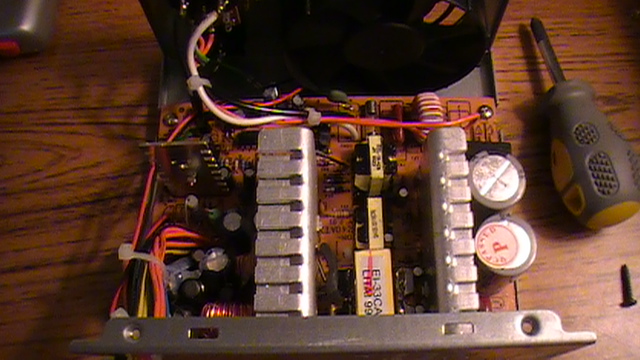

            Power Win 235W PSU...pulled from a Socket 423 system! Manufactured December, 2000. It actually looks honestly rated.....and I'm AMAZED to see transient filtering and a bridge rectifier on this old thing...The primary caps are CapXon and all the rest of the caps are a brand I've never heard of. Anyone ever heard of Yihcon?
            I didn't know Jamicon made fans!!!!!!!!
            For a 12 year old Chinese PSU it doesn't look too terrible...

                    Those aren't polymer.
                    The cross shaped vent marks are a good give-away.
                    It's just the can that looks similar.
                            It's more or less honestly rated IMO. Caps most likely survived because the fan was running at max speed. I have a old, cheap L&C (posted a few pages back) with all of its Jun Fu and CapXon caps still good because it had a powerful fan that ran at full speed.
