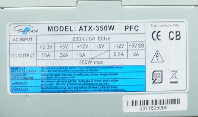

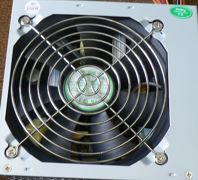

                                          Prepare your vomit pail
                                          This is older revision, I will also talk about newer one which I got to my hands a year ago. This thing is still sold for like 24 USD/19 Eur incl. VAT. I tried to get local inspection to forbid that, you will see how many things it violates, but I think the „engineer“ dealing with me was both morron and on paycheck of the manufacturer.
                                          Pic 1 and 2 shows nothign spectacular, just remember the values

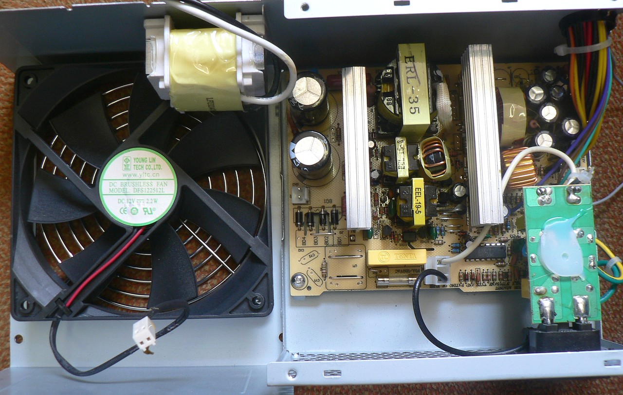

                                          Pic 3 - overall looks. This thing even has PFC, the newer revision got absolutelly tiny coil and ceramic cap - most likely PFC imitation, usefull for 5 W max PSU. According to inspection, PFC is not a must, the European norm actually talks about harmonics radiation - you can use just good ol' input filtration for this! No PFC is required in EU! Thats common mistake from those who actualyl never read the norm But when they write PFC in the name, there should be one, right

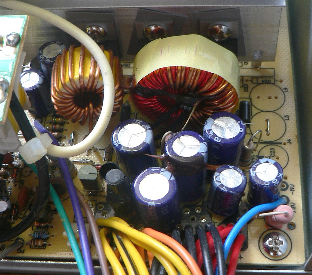

                                          Anyway, filtration is on daguhter board, but nobody would be harmed if they used the free spots too. Thermistor and varistors nowhere to be found. I will add all the things missing. Newer revision actually has two varistors.
                                          Tiny diodes, newer version even has rectifier, but 2 A labeled with rubber electrodes. The things is really small and starts dropping current at just 50 °C. Basically no difference here.
                                          Input caps are 470 uF, Fhy, never ever heard of that. Never revision has similar crap. Transistors are Toba T3866 and T13007-R. Found only bullshit, no actuall datasheet. Transistors seem OK, both heatsinsk really thin (2 mm) and tiny.
                                          Ordinary diode on +5 V SB. 20A schottky for +5 V, 12A fast-recovery for +12 V and 10A schottky for +3,3 V. Do you still remember the values from pic 1? But according to inspection: it is OK, the values on casing are just peak ones, manufacturer cannot expect you will connect it somewhere else than ordinary computer so it does not need to provide the wattage specified for longer period of time (longer than like 1 second).
                                          Only coils there are on +3,3 V rail, otherwise plain wire or stuff. Notice the termistor on common coil - seems that rectifiers are not the hottest things in this PSU, considering no coils and small Asia'X caps -5 V rail is not occupied by components
                                          Overall soldering quality is mediocre, PCB is not worst. Newer revision has even thinner PCB and casing. They most likely have one engineer for researching how these things can be cheaper because I found something new every time in there
