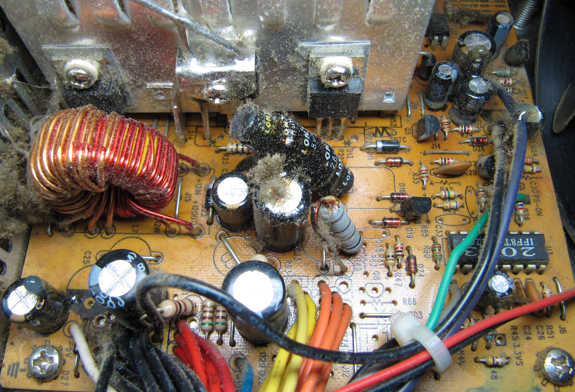

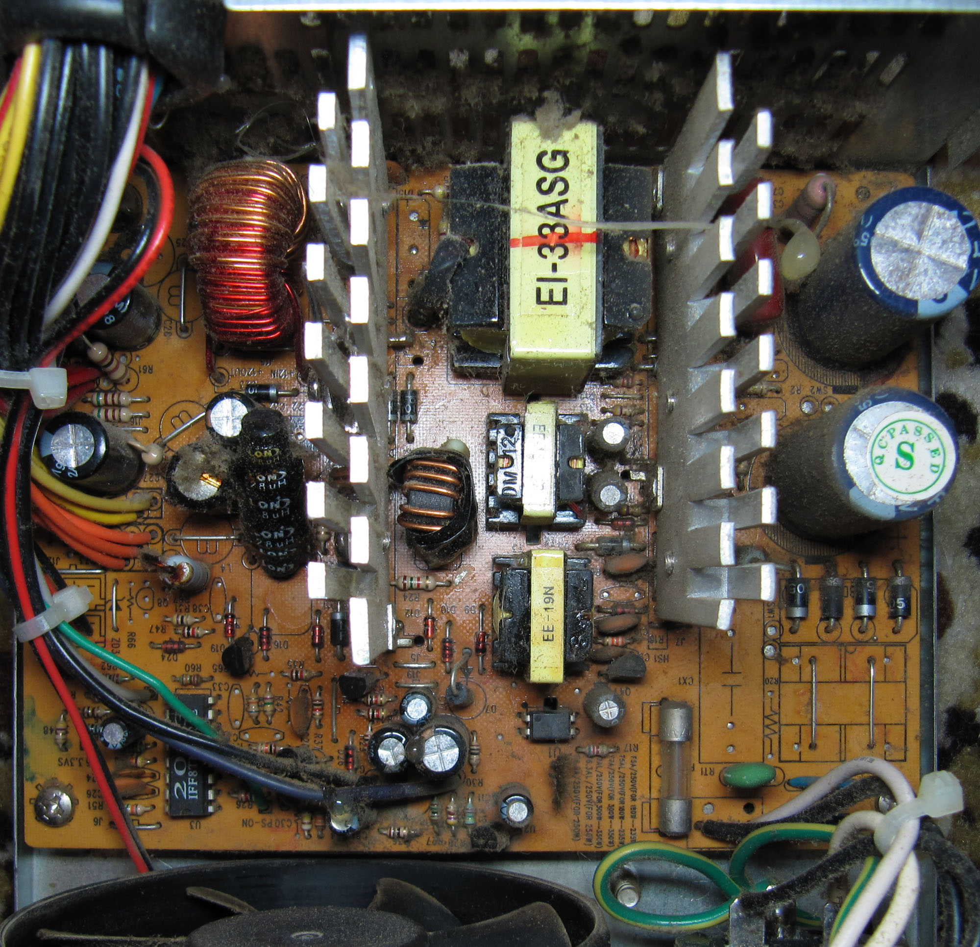

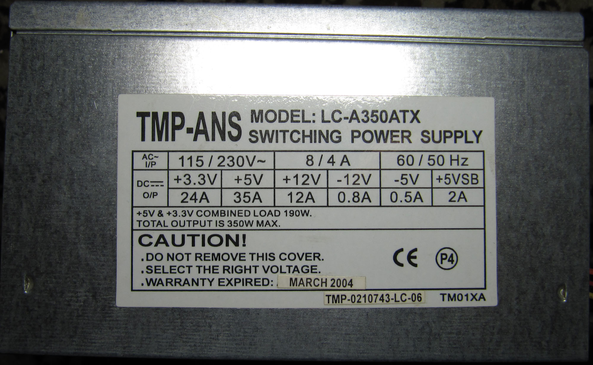

          #524
          TMP-ANS LC-A350ATX
          The good thing about this power supply is...... that it is not going to power a computer anymore
          Not worth of anything!
          It reminds me of those power supplies:
          https://www.badcaps.net/forum/showth...ier#post114292
          https://www.badcaps.net/forum/showth...ier#post199701

            #525
            Originally posted by goodpsusearch
            TMP-ANS LC-A350ATX
            Sledgehammer Bait.
            I see nothing redeeming about that PSU, other that that at least the PCB is full size and that there is no lead weights inside.
            This PSU belongs in the hall of shame...

              #526
              Come now, rats! There's not a lot of stuff, you know, beefy components to block airflow ... assuming the fan turns. "LC" = Lousy Crap, right?

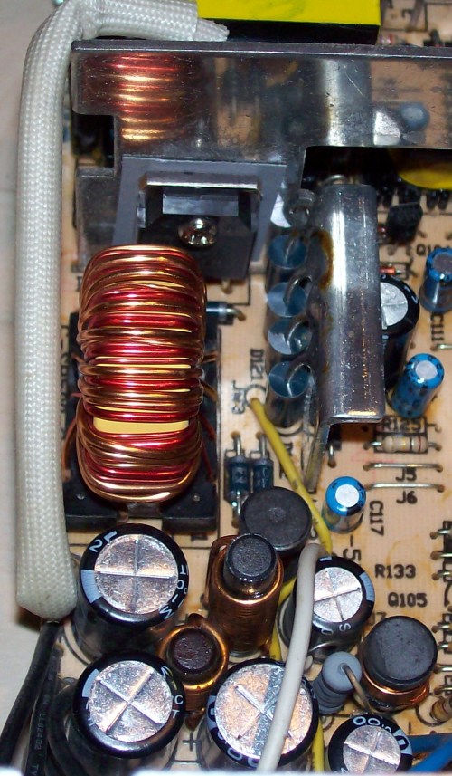

                  #528
                  TMP-ANS LC-A350ATX
                  Looks very similar to the LC-B300ATX I posted in post #491. It's funny they rated yours for 12A on the 12V rail, yet it only has the 3A "diodes-on-a-bracket" for a rectifier .
                  What brand of fan was on yours? Powelogic, Rulian Science, or something else? If Powerlogic, keep it. They are actually pretty decent sleeve bearing fans. Properly oiled at the facory so they don't seize up like other cheaper sleeve bearing fans.

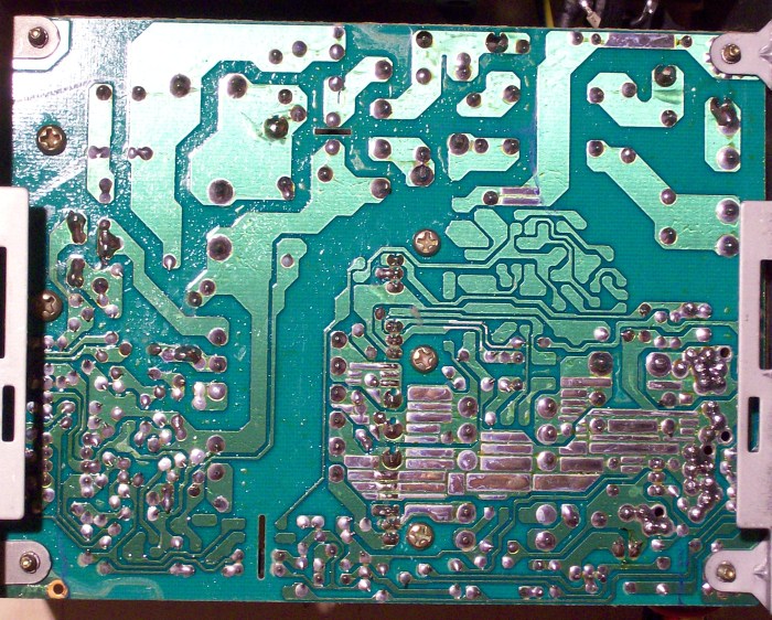

                                #535
                                Since we started to throw out a bunch of old e-waste that piled up in the years I managed to save some AT psus recently. From Compaq and some unknown desktops mostly. These are all working models.
                                Here is an Enhance unit from circa 90-91. Half bridge, usual AT abilities and connectors. Has an interesting setup of diodes for the 12V rail. Nitsuka primary and Luxon secondary capacitors Voltages are fine, the fan runs at full speed all times.

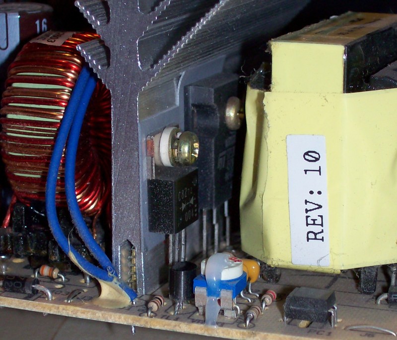

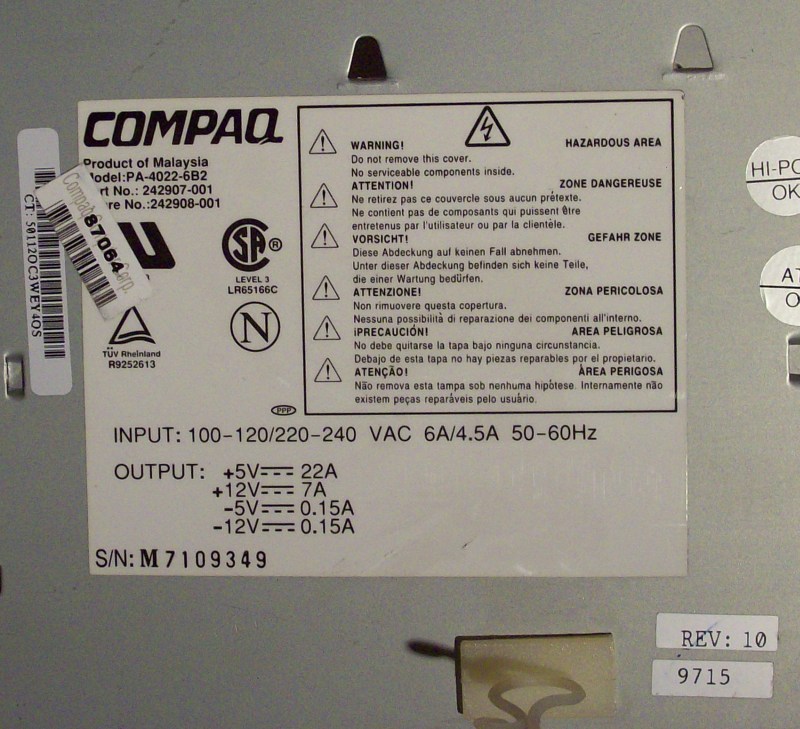

                                  #536
                                  Liteon AT psu for Compaq. Components are brutally overspeced for the labeled wattage. It has a single 6 Amper mosfet in the primary. I wonder about the efficency. Caps are NCC except a 1uf 450V Jamicon in the primary. This psu won't start without a load, first I though it's faulty. There is no Power Good wire. The fan is temperature controlled, a thermistor is tied to a small capacitor near the output filters. 40A for 5V and 15A schottky on the 12V rail... okay. Would somebody lighten me up on this topology?

                                    #537
                                    And yet there are still cheap power supplies out there that use the 2 diodes on a bracket for the 12v rectifier. At least this one has 4. Still better than a no-name cheapo PSU.
                                    The traces on the underside are funny on that Enhance. Reminds me of old-school 8-bit 2D games .
                                    That's pretty typical for an old Lite-On PSU. The Lite-On PSU in an old Dell Dimension XPS R400 I have is build like that too.
                                    Topology is single-transisor forward converter. I think it's a little newer than the ancient half-bridge, but still very old. Efficiency is probably the typical 75%<.

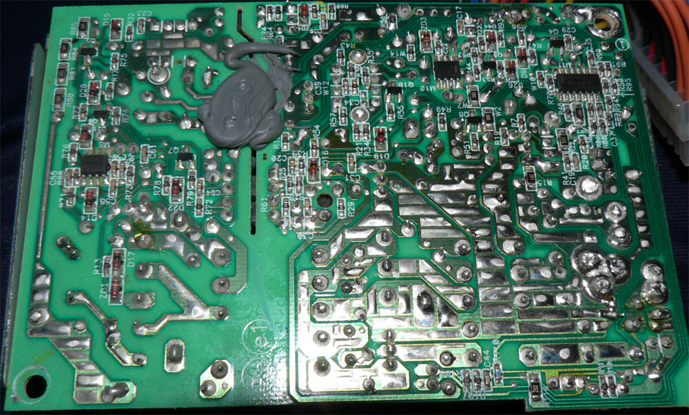

                                          #540

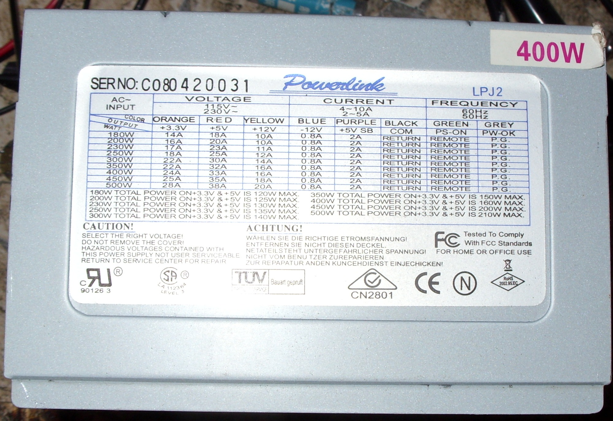

                                          Powerlink LPJ2 "400W".
                                          4-diode treatment with lame 4A diodes. Non safety approved Y caps. No other input filtering to speak of.
                                          Primary: D13007s as main switcher, C5027S on standby. EI-33 label on the transformer... i ain't buyin' that. It's an ER-28 actually. 2x 470u Canicon caps, but judging by the can size real capacity is lower.
                                          Secondary: 20A schottky on +5v, 10A schottky on 3.3v, and 12A fast recovery on 12v. 12v diode is stuck directly to the heatsink without a silpad. Small output inductors (coupled inductor is on a T90 core). No pi filters. 2x 1000u 10v Fuhjyyu TM on +5v. 1x 1000u Fuhjyyu TM on +5vsb and 3.3v, both bloated. 1x 2200u 16v Canicon on +12v, and 1x 470u 16v Canicon on -12v. Weltrend controller.
                                          Can you believe this thing was trusted to power a C2D E6400 and 7600GS?
