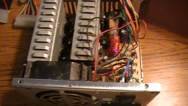

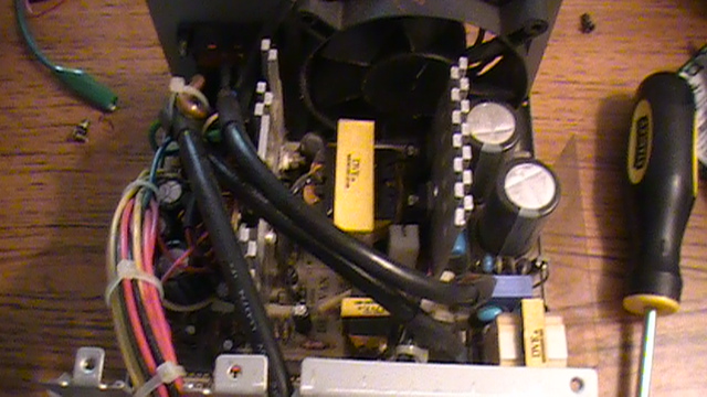

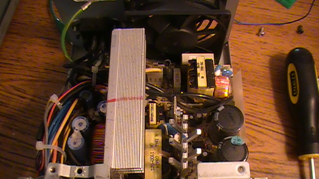

            Got some more units to show:
            Pic 1: VERY OLD Lead Year Enterprise TG-200X 200W ATX power supply
            Has a bridge rectifier and input filtering, unknown cap brands. It's so old, the 92mm fan blows into the PC case instead of the power supply.
            Pic 2: Achieve AX250 250W ATX power supply
            Has 4 diodes, one filter coil, "VIVA" caps everywhere. I'm guessing it's an L&C.
            Pic 3: Thermaltake Purepower ISO-400 300W ATX12V power supply
            Has a bridge rectifier and input filtering, JunFu caps everywhere. It's probably one of the best built Channel Well's I've ever seen.
            What do you think?
            • goodpsusearch
              • Oct 2009
              • 2848
              • Greece
              #566
              The first one is definitely overbulit for 200W. I am impressed.
              • ncovert
                • Feb 2011
                • 291
                #567
                Interesting. Do you think it could do a little more then that?

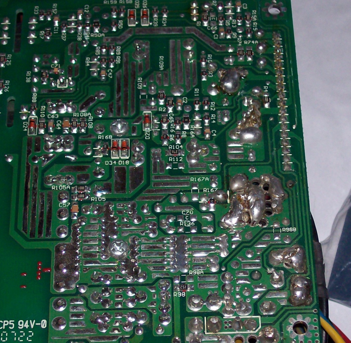

                                        #579
                                        A friend brought me a Chieftec Cft-750-14c. He got it in 2007 and it wasn't opened ever since. This psu was literally stuffed with dust. The fan couldn't move and the unit was shutting off. It was easy to clean it with air compressor and a brush. Suprisingly caps look ok. Hitachi primary and Samxon secondary. Take a look at the soldering... this is how it came out from Channel Well...
                                        I haven't touched it up since my friend was already in shock that I opened the unit up He took it back so it's going to work like this.
                                        • c_hegge
                                          • Sep 2009
                                          • 5219
                                          #580
                                          CWT aren't exactly known for good soldering. I probably would have checked the screws for the heat sinks. CWT often don't do them up tight enough and don't use any thread lock on them.
