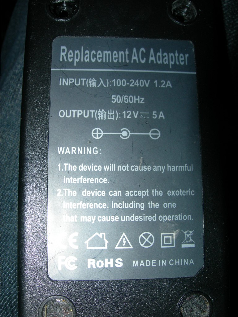

          #504
          "Replacement AC Adapter"
          12V @ 5.0A
          eBay: £5 including postage from Hong Kong.
          How bad can it be?
          Claims: FCC, CE certification. Also "exoteric interference" may cause undesired operation.
          First look:
          - No input fuse! This is already a CE fail.
          - No line filter! No way it'll pass FCC/CE!
          - No transient protection: MOV, X caps, TVS etc.
          - Full EMI metal shield around PSU... fairly decent and definitely going to help with emissions
          - Cheap but okay caps. 1000u x 2, reasonable for output rating.
          - Input cap is a 100u 400V. No PFC, of course. Decent size for output power.
          - Good size transformer for 60W output.
          - Not a self-resonant converter: it actually has a controller IC!
          - TL494 feedback
          - Fair heatsinks for the output power
          - Output common connected to earth (EMI reduction again)
          - Wave soldered well. All components are properly seated. Where necessary a bit of glue is used.
          - Easy to disassemble - just two screws. Why can't every manufacturer do this?
          It's a shame they just didn't go the whole hog by actually putting in an EMI filter - after all the metal shield and earthed output add slightly to the cost, how much does a simple filter cost?!
          I will be scoping the output of this PSU later and seeing how well it copes with just 1.5A of load. I use it to recharge my LiPoly batteries with my B606 battery charger.

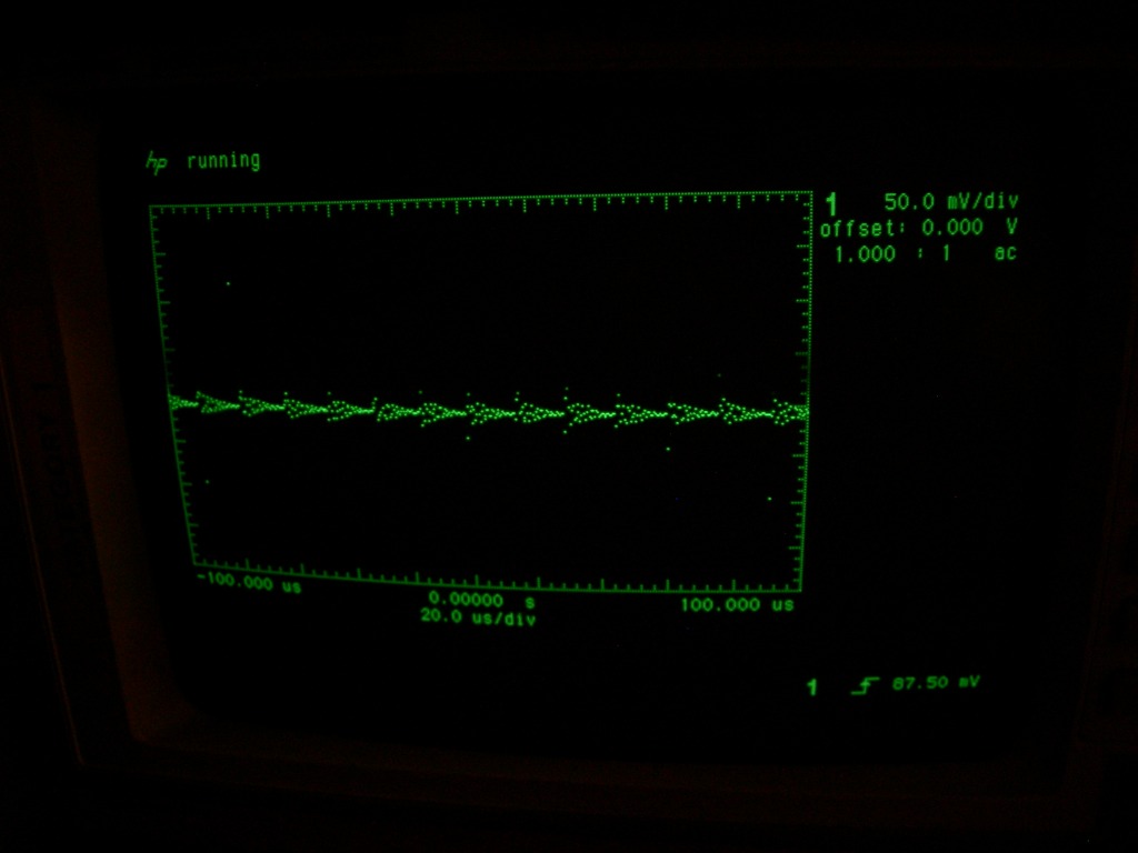

                              Yes, this is a ~165W output supply, but the rated input is 250W!
                              The design is fantastic... and the output caps! So... many...! Noise is sub 1mVp-p on most rails, which is pretty amazing. About 16,000uF on the 3.3V rail, 8,000uF on the 12V. (Just for CRT and fan.)

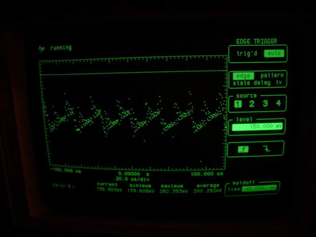

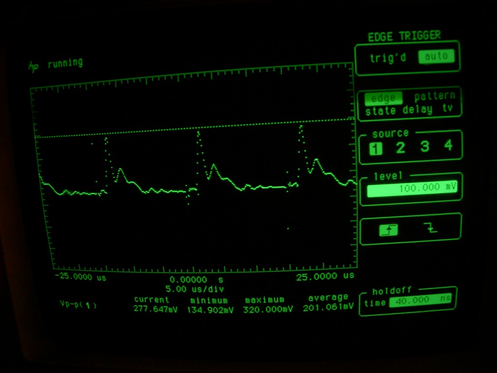

                                      Some tests of the output ripple:
                                      At little to no load (just the LED or my charger paused) the ripple consists of a high frequency ringing, but overall quite low amplitude. If I turn the 20 MHz bandwidth limiter on my scope on, then the ripple appears smaller, but the ringing is still there.
                                      With a 1.5A charging load (approx) the ripple is aroundabout 200mVp-p. It's not going to win any awards, but it's acceptable. My charger has a very poorly implemented software controlled buck/boost converter, so it's not entirely surprising that I saw that kind of ripple. I'll try it with some resistors later.
                                      Frequency is more or less constant, around 33kHz.

                                          With a 10 ohm load (~1.2A), ripple is about the same - around 200mVp-p. I may end up replacing the cap at a later date, but my charger doesn't seem to mind so I'll leave it for now.
                                          Very strange ripple waveform, almost like it's overshooting and then settling fine... I wonder if the control loop is properly compensated? It would be a shame as the rest is fairly well designed.
