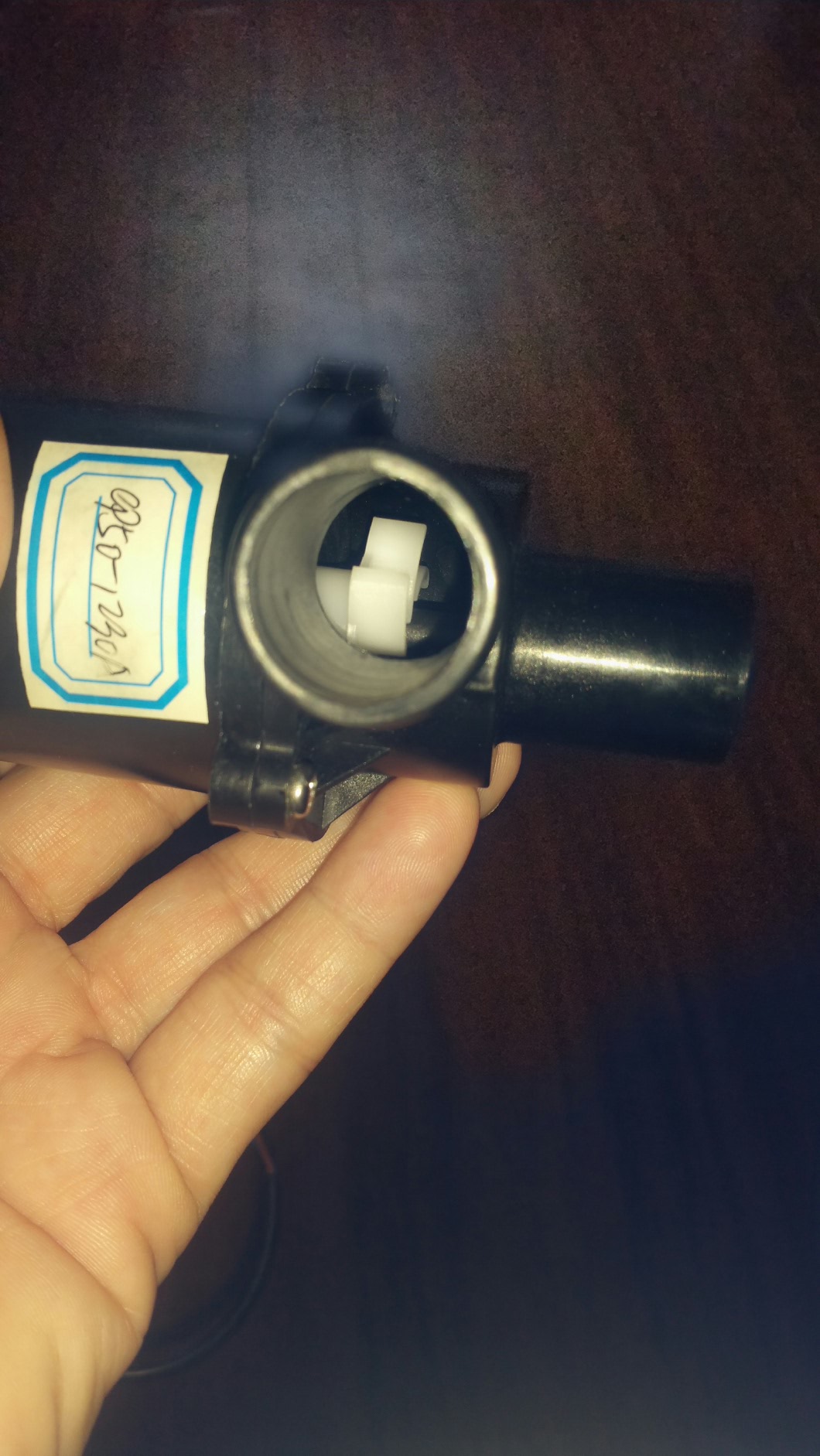

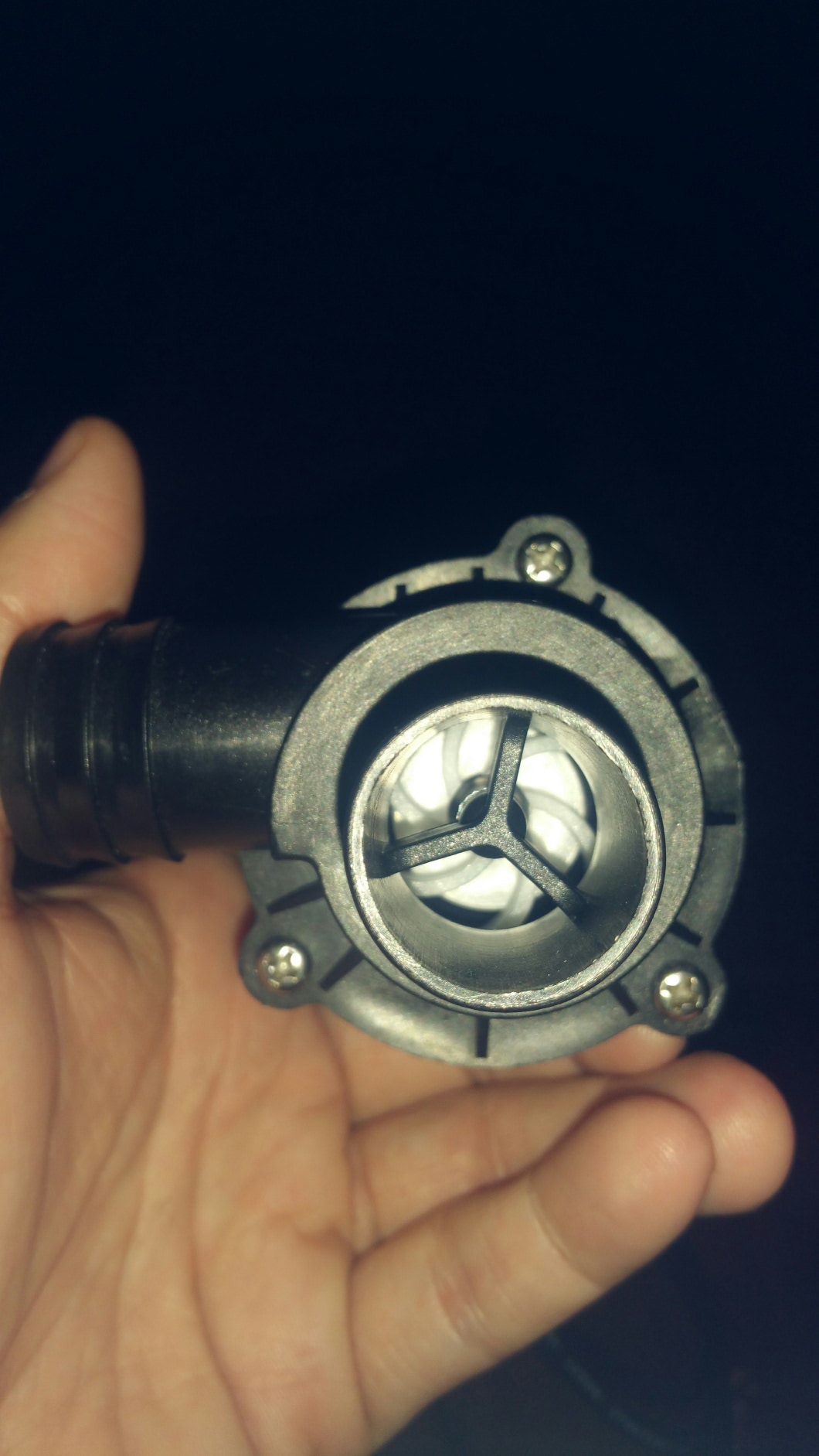

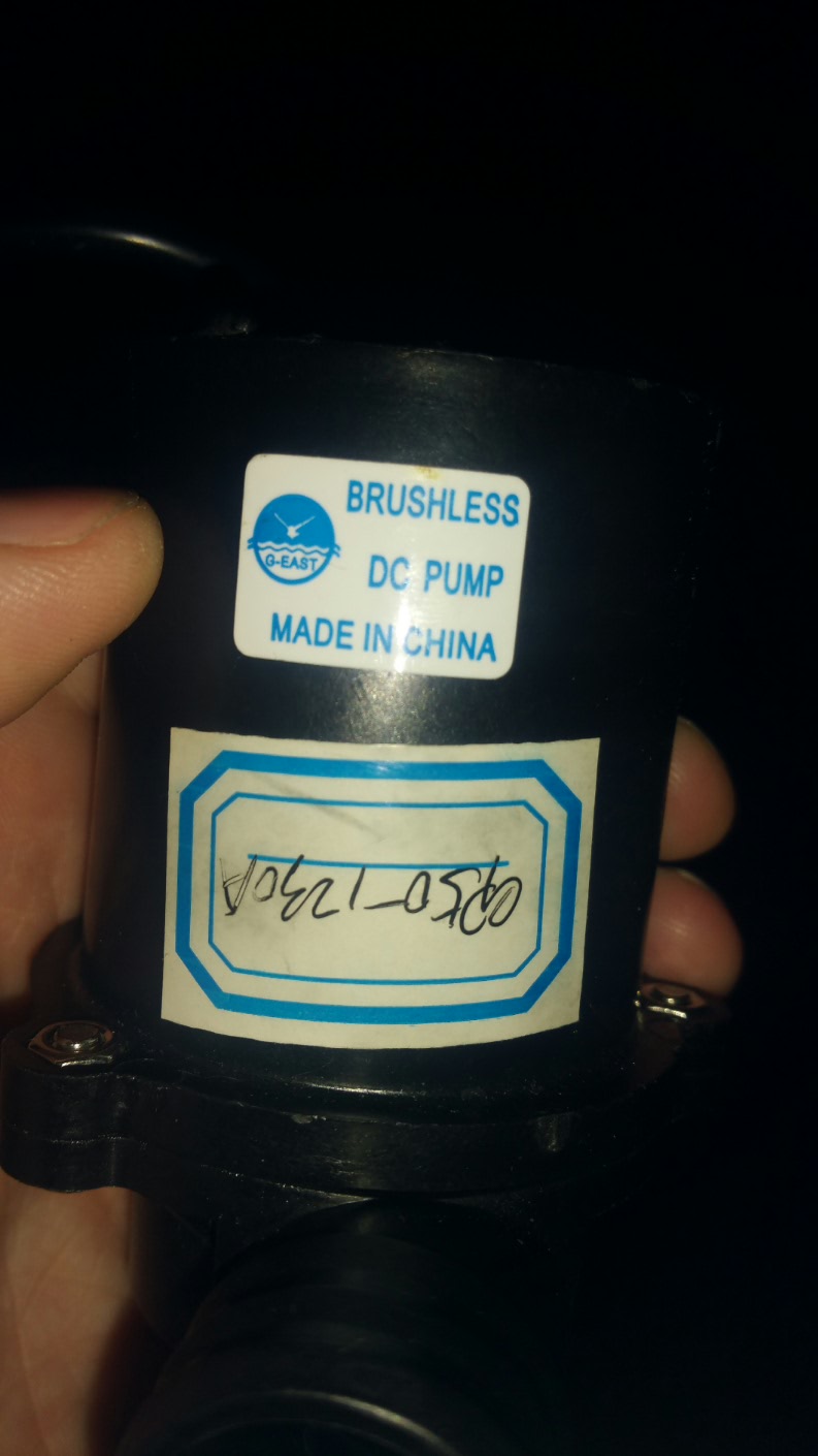

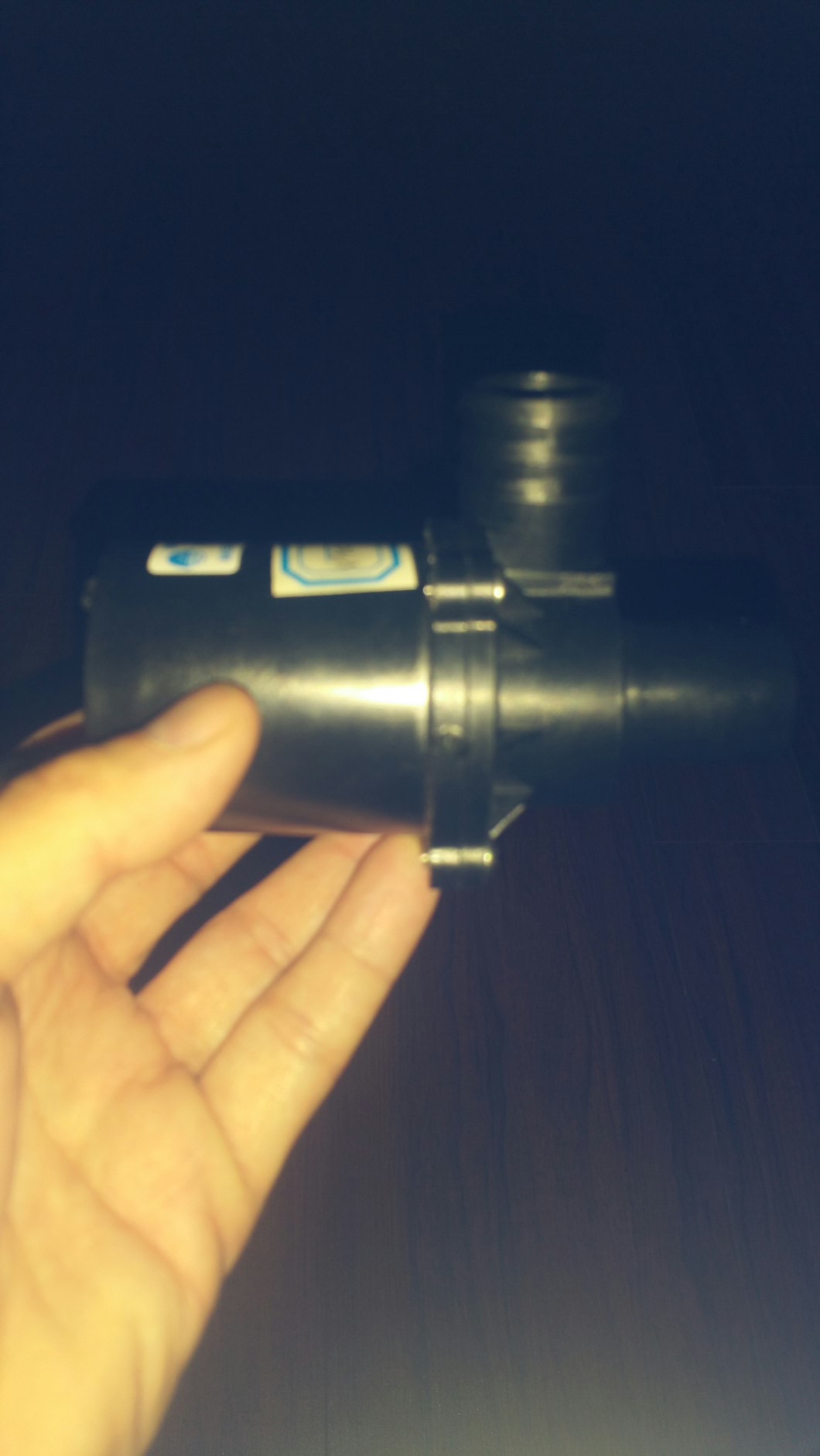

                          Re: Intex Inflatable Spa - Pump Problems
                          Can we see the pictures of this replacement DC pump?
                          • mmartell
                            • Oct 2013
                            • 3189
                            Sorry bud I took pics but they need to be resized so let me figure that out first.
                            • mmartell
                              • Oct 2013
                              • 3189
                              Here you are bud - not much to see really.
                                G-EAST
                                Shenzhen Chenzhou Electrical Appliance Co
                                CP50 series
                                CP50-1230A: 12VDC 2.2A
                                BTW, pictures always help.
                                DC Brushless Pump CP50 series g-east
