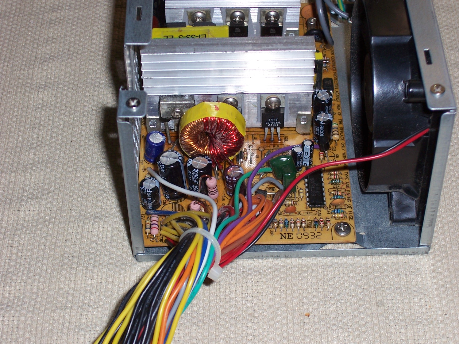

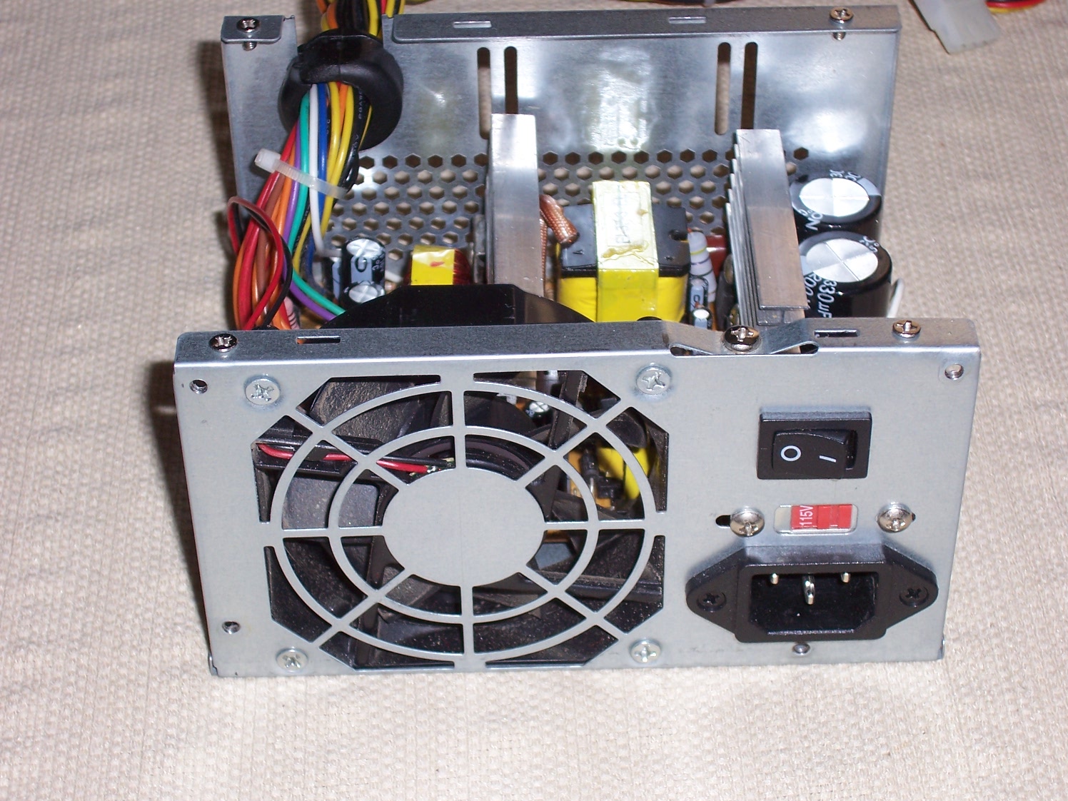

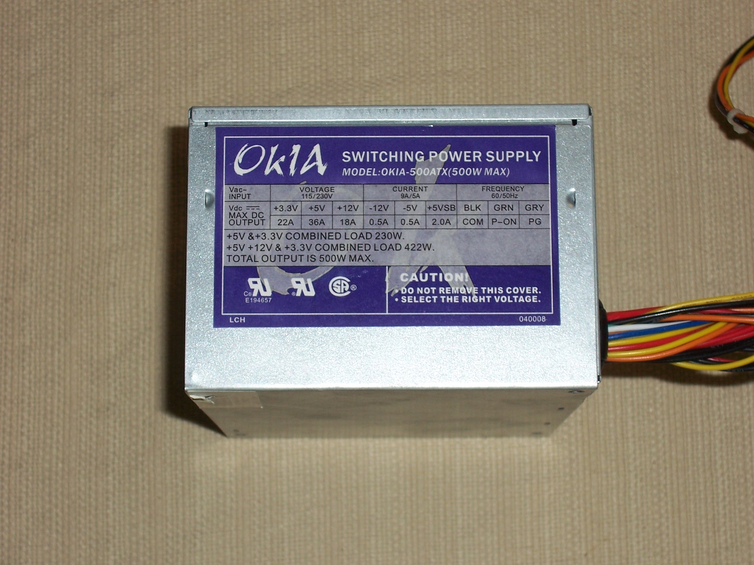

    500 watt cutie
    Here is a 500 watt cutie. It arrived with stuck fan, output capacitor on all three rails were bulging, one of the diodes on the 5 volt output rectifier was shorted, and the FET linear regulator on the 3.3 volt rail was shorted. I replaced the S20C40 output rectifier in the 5 volt rail with a S20C45 from my junk box. I figured that an extra 5 volts wouldn't hurt. I replaced the CEP3120 FET in the 3.3 volt rail with a CEP603 from my junk box. It was only 5 amps less than the original, but probably wouldn't hurt. The output rectifers on the 12 volt rail are two single diodes soldered to a small frame. They measured OK. I had a fan of the exact same brand in my junk box, so replaced the fan rather than repairing the old one. This 500 watt cutie uses a pair of 13007 transistors for the switching circuit. Input main capacitors are RICON 330 uF/200 volts. The Y caps are ceramic capacitors, a money saving Chinese innovation. Diodes used for the input bridge rectifier are 1N4004. There is no line filter, just jumpers where the line filter transformer should go. I replaced the bulging RICON capacitors in the output circuits with capacitors of equal voltage rating and equal capacitance from parts in my junk box. The output circuits do not have pi filters, just a single capacitor.
    This 500 watt cutie is now working. Just need to find a mother board that needs 500 watts so I can test the power supply under load!

                  ^ Sounds about right. The original fan was stuck......really stuck bad. I replaced it with one that looked brand new, same brand label. There is no fan controller, the fan is wired directly to 12 volts. When I turn it on, sounds like a thrashing machine. So I don't think the fan will last long. Then the popcorn starts popping!

                              Looks like they keep increasing the rating on these without actually doing anything to the actual components inside. I opened one of these up several years ago (identical inside) that claimed to be a "420W" (couldn't handle 150W for more than a few minutes in reality).

                                40A on +5???
                                There's nothing that'll handle 40A in that thing, unless it's on fire.
                                Gotta give em a little credit- the +5VSB transistor is on the heatsink.
