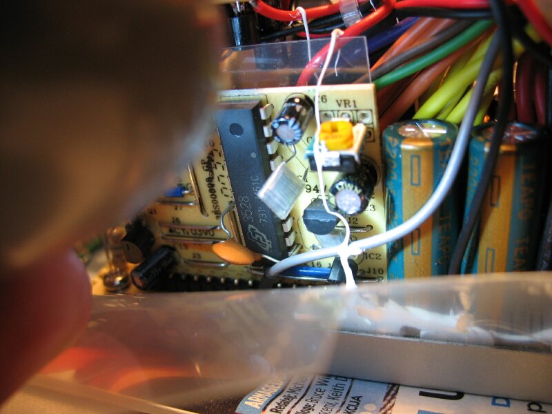

    here's what i decided to use.
    fair enough, i would say.
    higher class starts at wattage and prices i percept as overkill. i'll rather pick few fortrons and keep an eye on them.
    ost/teapo all the way, so wish me luck!

      Preventative recap on the output might be a good idea, otherwise looks alright!
      It is an FSP, so I don't think you'll have issues with it for quite a while, even considering the caps. Provided that you don't overload it of course.

        astech, it's powering mobo with g33 chipset and c2d at 2.2ghz. everything in the box added it should be well under 300w...or even under 250w...using onboard video.
        i won't be touching output caps, i think i'll just monitor esr of caps on the pwm-ic daughter-board (https://www.badcaps.net/forum/attach...achmentid=7340) and the board for fan regulation (https://www.badcaps.net/forum/attach...chmentid=7344), also 5vstb circuit, offcourse.
        check it once a year, or even less.

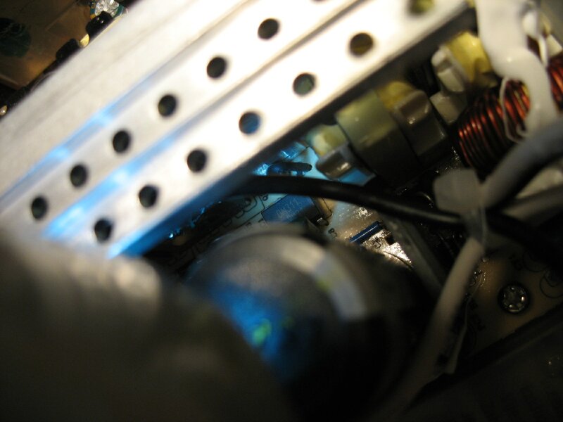

                Is that using passive PFC? looks like it

                      thanks willawake I thought it would be with that big inductor hanging off the side
                      just wasn't sure of the vintage, seems a lot now use Active power factor correction.
