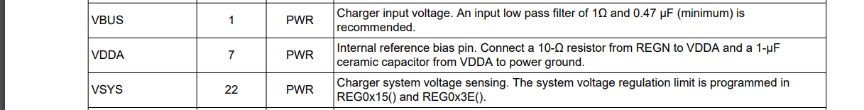

                  What is the voltage to ground of the REGN pin # 28 on the charger IC (bq25710)? This must be ~6 volts.
                  Check the voltage to ground of the following pins of interest.
                  • danny34
                    • Jul 2024
                    • 49
                    Pin 1 VBUS - 17,94V
                    Pin 7 VDDA - 6,08V
                    Pin 22 VSYS - 9,18V
                    Pin 28 REGN - 6,07V
