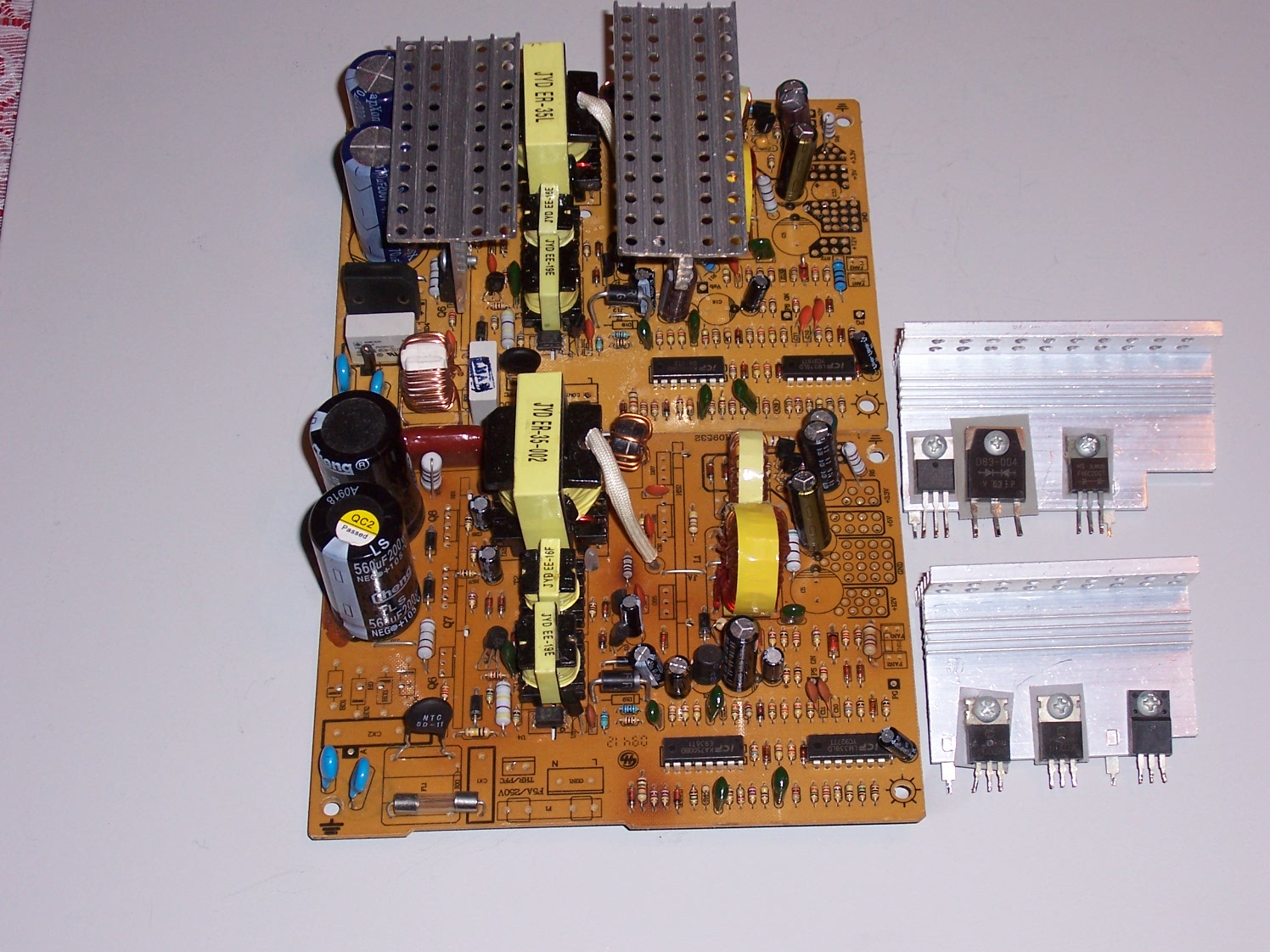

    Re: Fun with fixing I-Micro power supplies

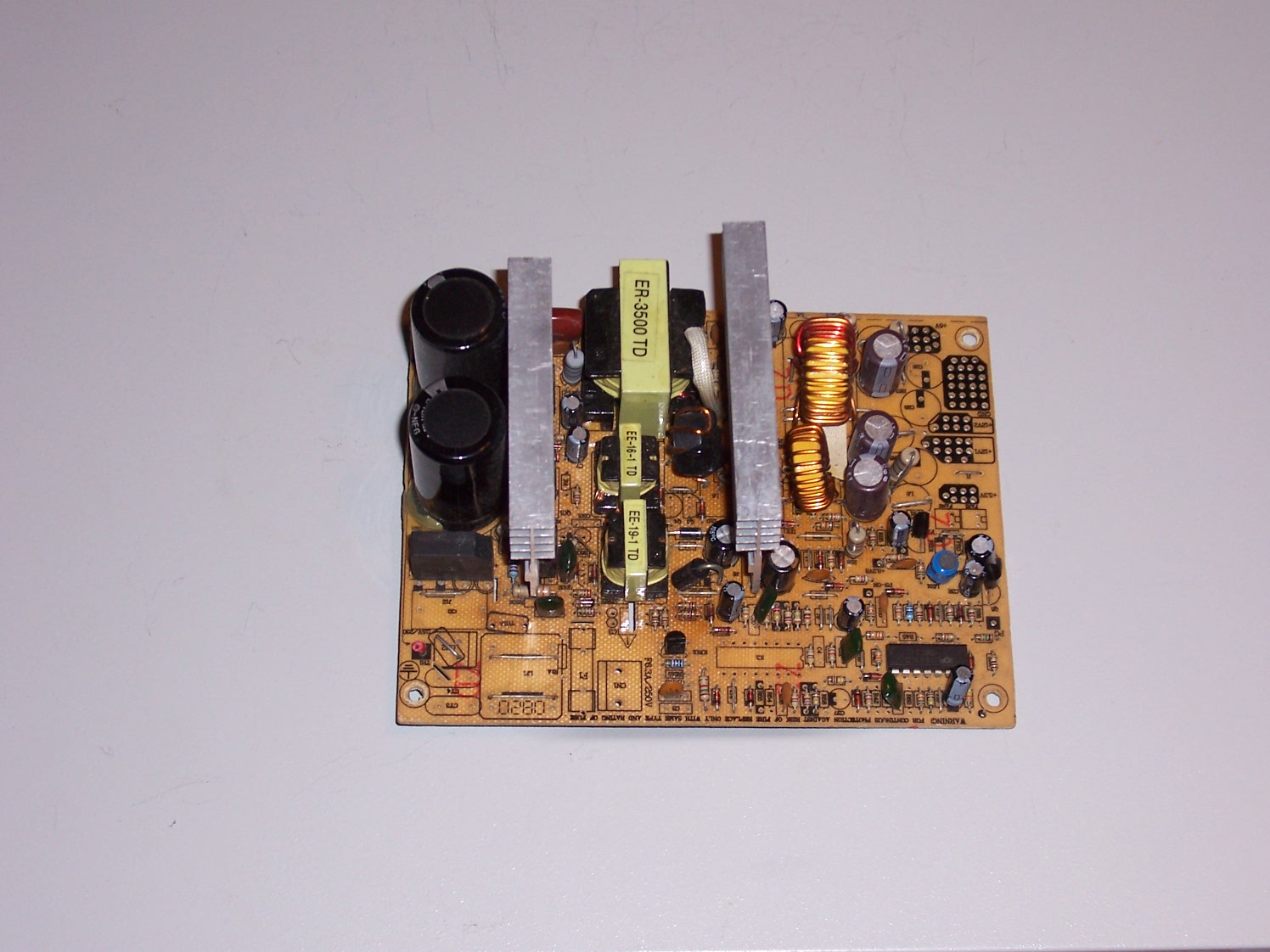

    The remaining two power supplies and "junked" pc board all had ATX 12V2 VER 2.0 marked on the pc board. This pc board has room for full pi filter on the output circuits. But all three boards had one output filter capacitor, the pi filter coil space was jumpered, and one capacitor space was not used. Even more curious, output filter capacitors for all three outputs was 680 uF/25 volts. I don't think that is enough filtering to meet ripple requirements for a 400 watt or 450 watt power supply!
    Seems to me that I have seen this ATX 12V2 VER 2.0 pc board in other off brand power supplies. Has anyone else seen one?

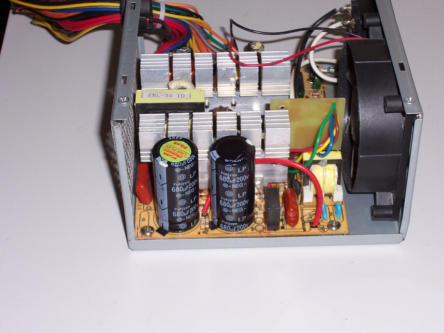

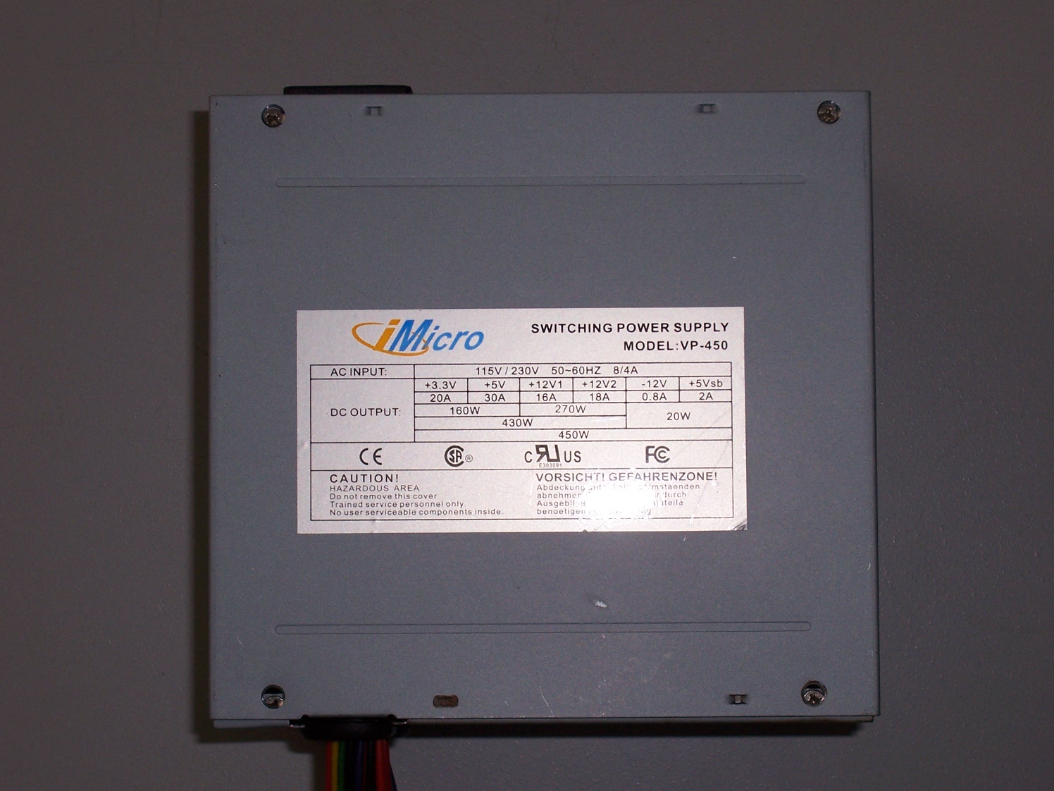

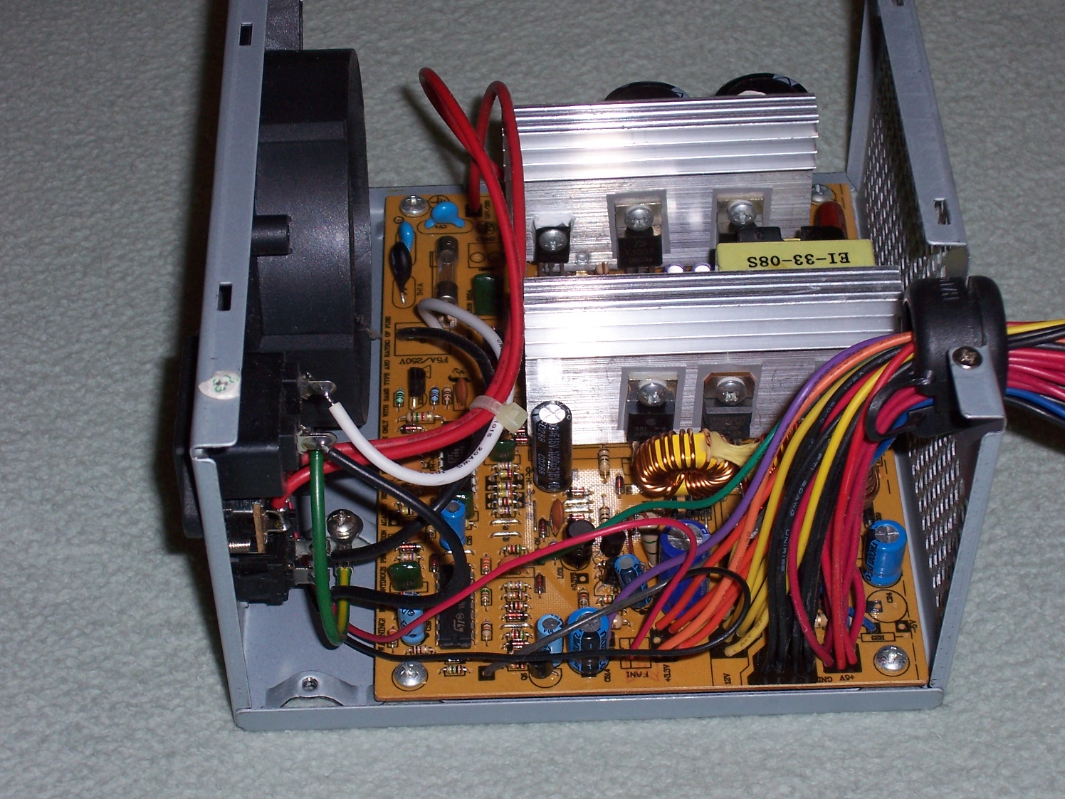

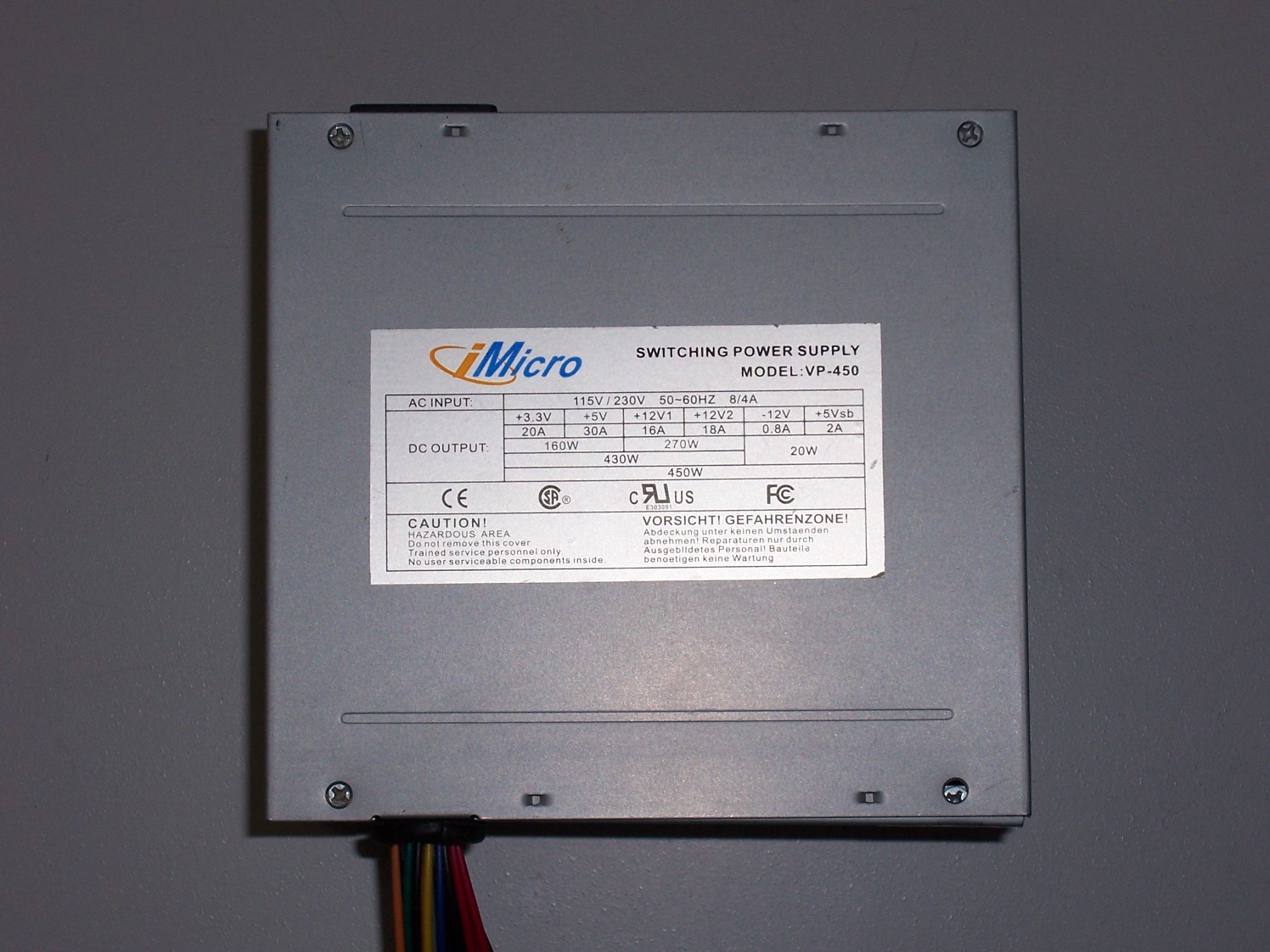

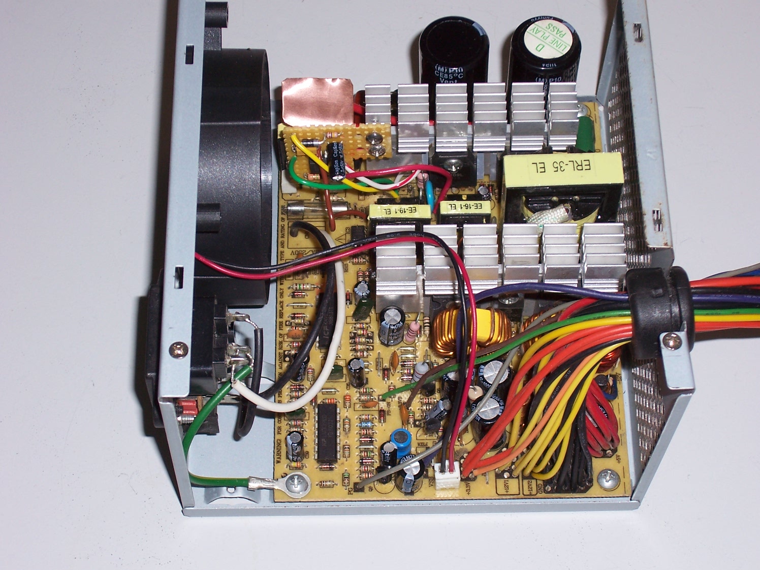

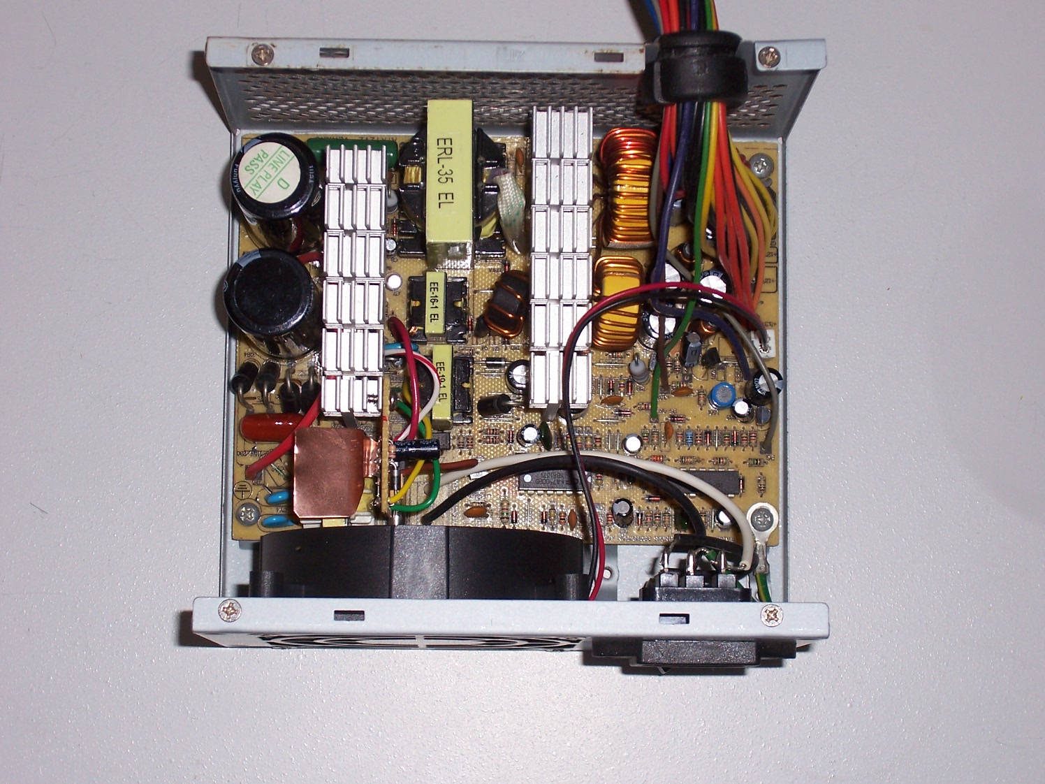

        The first "fixer-upper" is rated for 450 watts as shown in the picture. I used the best of the heat sinks I had from the five units. I removed the ZWCON main capacitors and replaced them with Fuhjyyu pullouts from a Antec Smart Power. At least their capacitance was in spec! I used the larger sized switching transformer, and a pair of pull-out D209L switching transistors. I installed three coils in the pi output filters, and used some pull-out capacitors to finish off the output filter circuits. I gutted the two transistor 5vsb circuit and replaced it with a DM311 chip and circuit. Made a nice little heat sink from a piece of copper flashing. And....I added a line filter with X and Y capacitors. Now it looks like a "half" decent power supply.

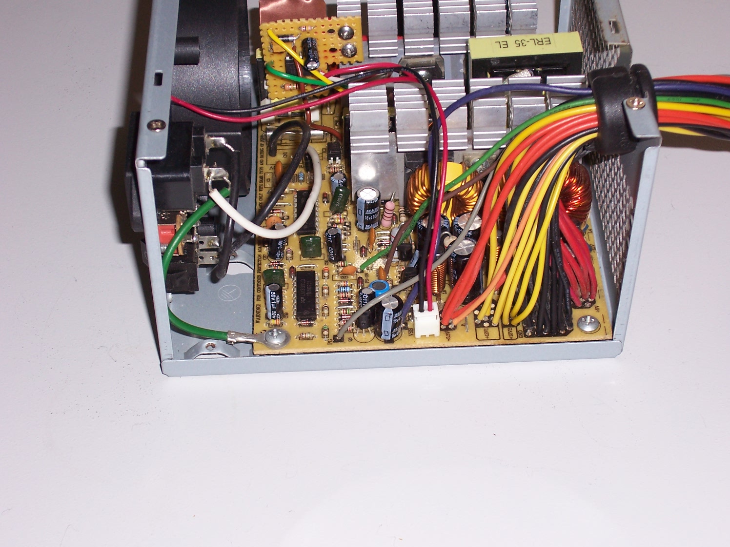

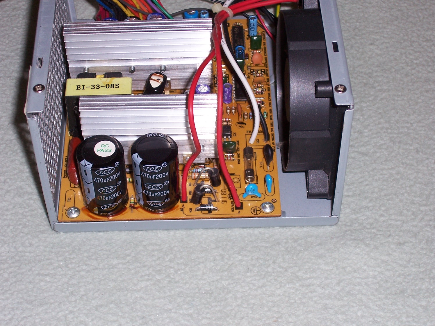

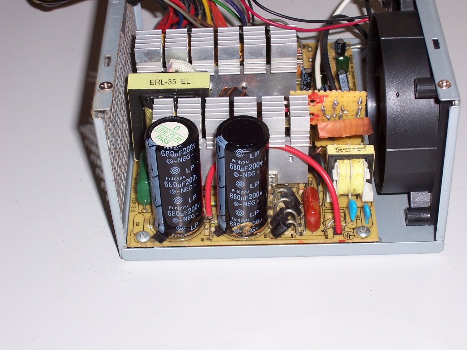

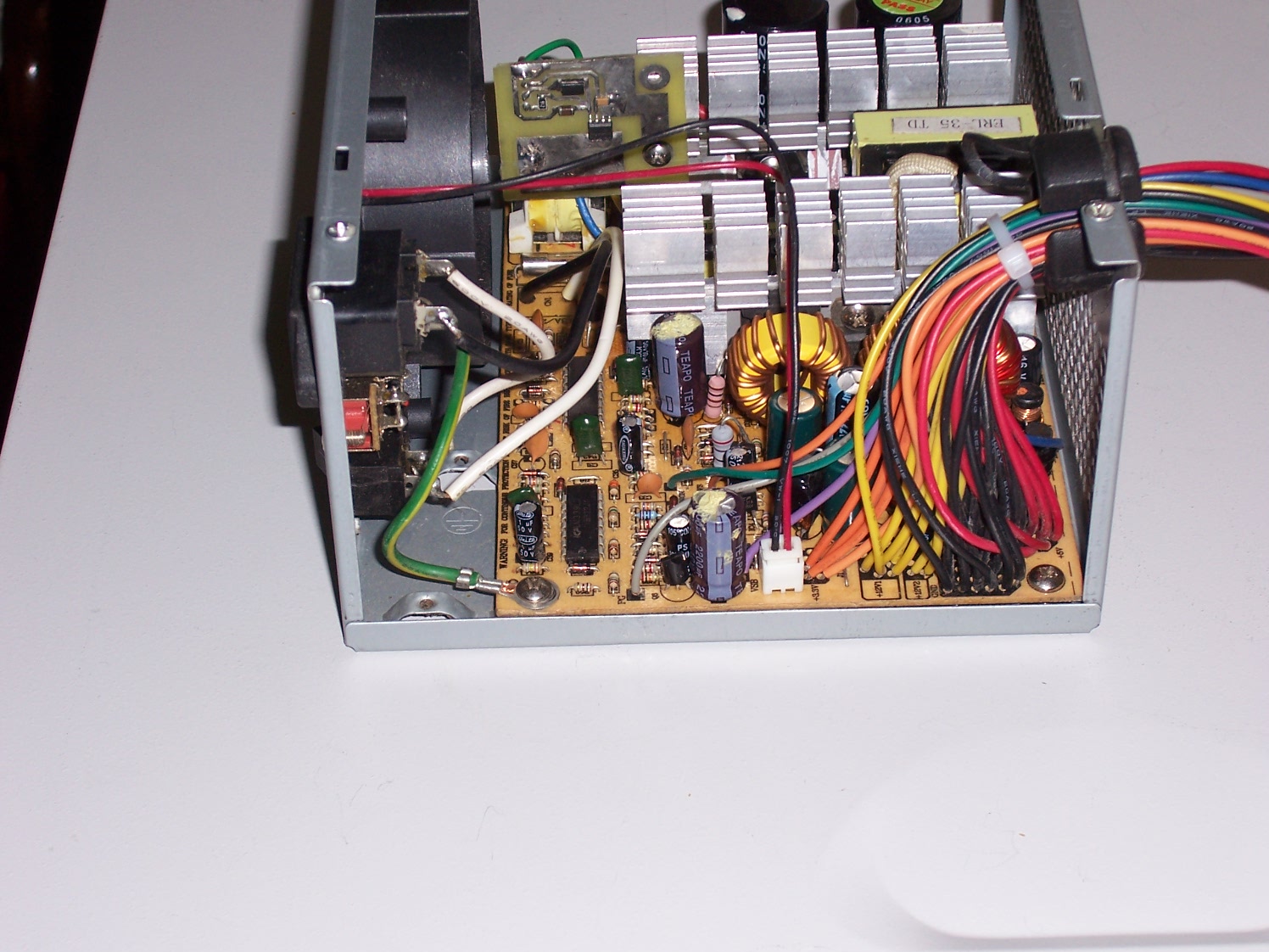

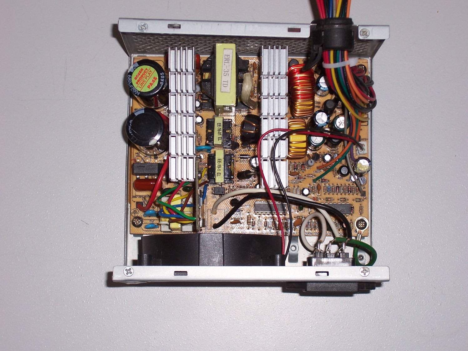

          The second "fixer-upper" is also rated for 450 watts according to the case. I used a second set of the "better" heat sinks for this one. Also removed the ZWCON main capacitors and replaced them with Fuhjyyu 680 uF/200 volt capacitors. Added the three coils in the output pi filters, and replaced all output capacitors with "better" measured output pull-out capacitors. I really didn't want to spend money to put super good capacitors in a power supply which I know is not going to do its rated 450 watts. Added line filter transformer and X and Y capacitors. Gutted the two transistor 5vsb circuit and installed a Viper 22A smd chip. My thanks to ldsishere for making the circuit board. I installed two D209L pull-out switching transistors. They were singing to me, so replaced them with a pair of pull-out 2625 transistors. Now this power supply works.
            I had my doubts, but I tested both of these "rebuilt" power supplies by powering up a Gigabyte motherboard with 3.2 Gig Prescott Pentium 4 cpu and 2 GB of PC3200 memory and a PCI express video card. I was expecting them to either not turn on at all or at least give a few hick-ups. Both power supplies ran the motherboard without giving any trouble.
            Both also powered up fine on my Pentium 3 Biostar M6VLQ test mother board.

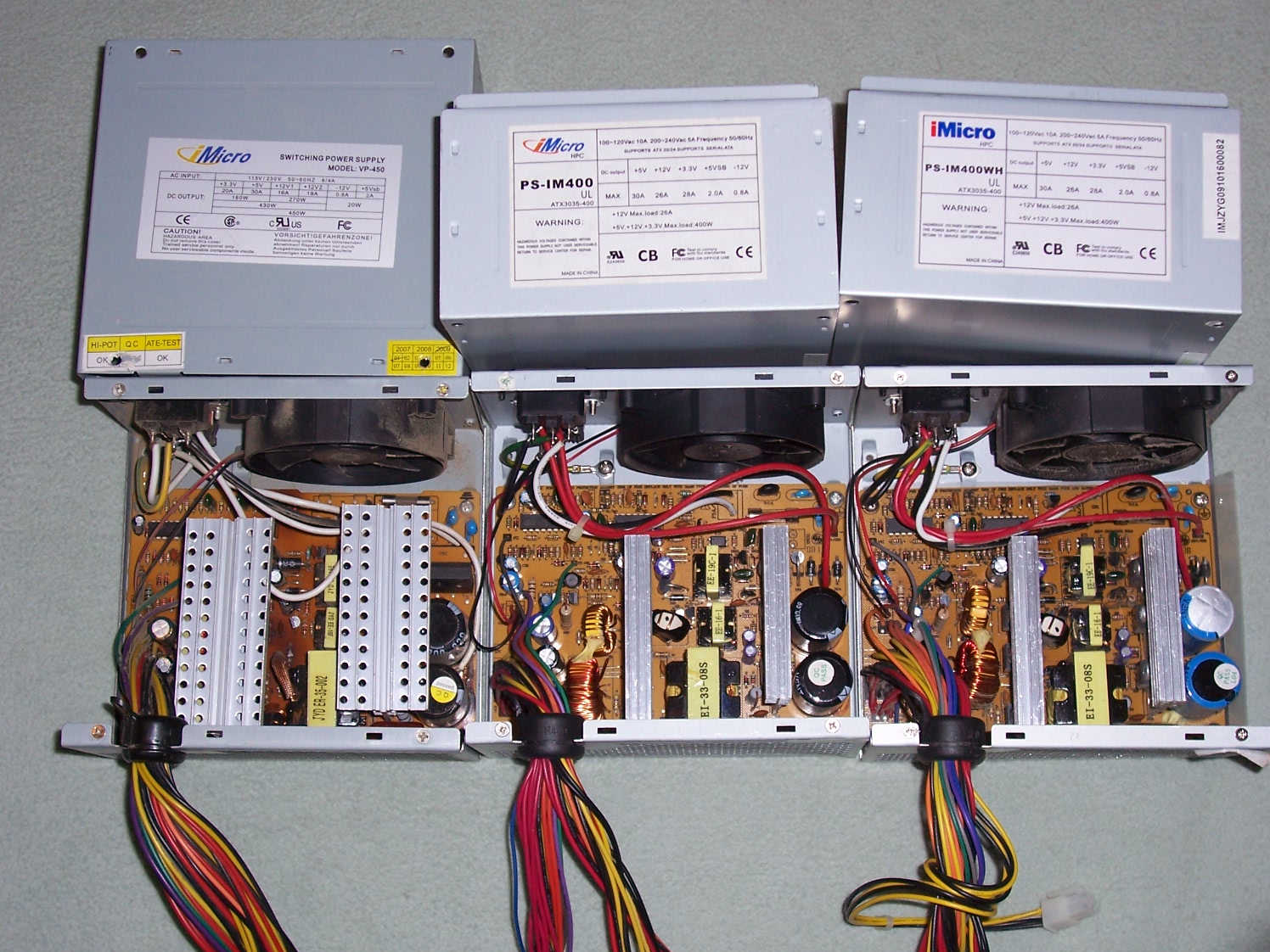

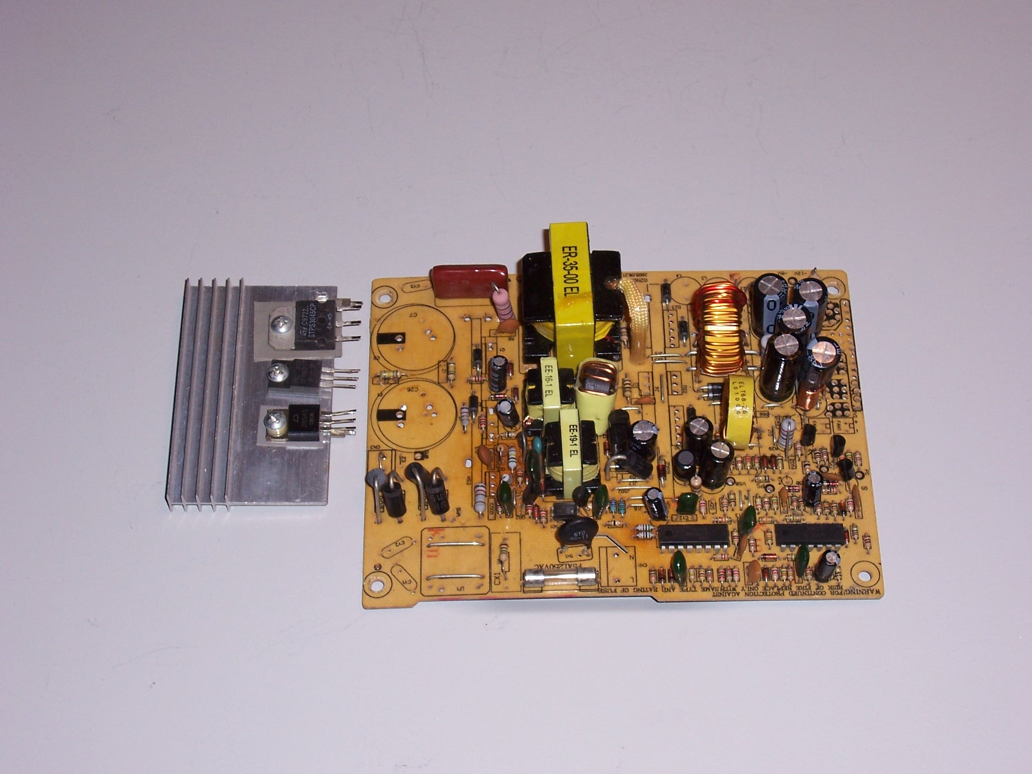

              Found three more IMicro's. One had a pc board like the ones in my first post. The other two had yet a fourth version of pc board layout. All three of these had one capacitor for each output voltage, no room for a coil and second capacitor to form a pi filter. So all will go to the scrap pile. The thing that caught my attention to this "fourth" pc board layout is that not only did it NOT have a line filter, it has no place to put it. Take a close look at the pictures. Nothing on the pc board layout for a line filter! How can you possibly make this power supply better.....when the pc board can not accomodate pi filters on the output and line filter on the input??? Cheap.....no wonder these things fail quickly.

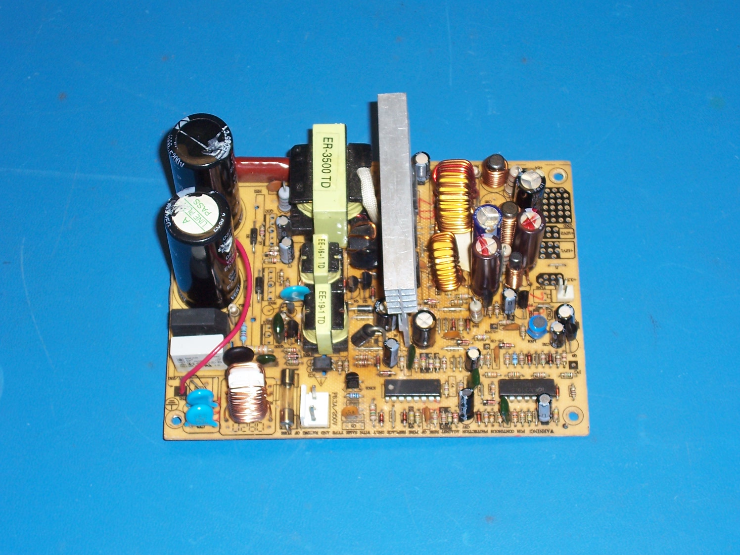

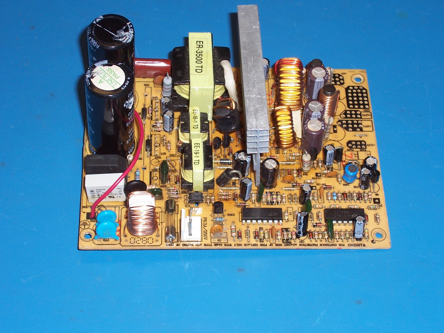

                The IMicron pc board from my scrap pile (shown earlier) does have room for line input filter and output pi filters. Maybe there is some hope for this one! So lets see if I can find enough parts to put it together properly! Found line filter components from one of the less desirable IMicron units. Found three pi filter coils in my pull out parts collection. From my pull out capacitors, found a pair of 2200 uF/16 volt capacitors for the 12 volt output, a pair of 3300 uF/10 volt for the 5 volt output, and a pair of 2200 uF/6.3 volt for the 3.3 volt output. Found a pair of 1000 uF/200 volt caps for the main input capacitors. Installed a pullout 7500 pwm chip, and a few other missing parts. Now it looks much better.

                        LOL That power supply with no EMI filtering on the PCB.
                        My only other guess as to why they did that is because their intentions were to use an external EMI filter. But being cheap... who knows what they were thinking.
                                As per the first post, a computer shop salesman asked the question....why are so many IMicro power supplies failing right out of the box? Based on what we have seen so far, what could we tell him?
                                1. Only one had emi line filter.
                                2. Main input capacitors have too low value AND measure only 60% of marked value.
                                3. Switching transistors inadequate for advertised wattage
                                4. Switching transformer too small for advertised wattage
                                5. No pi output filters on any of them.
                                6. Output filter capacitor values too small, inadequate for advertised wattage.
                                Two were "fixed" or "enhanced" and I am confident they will probably do half of their advertised wattage. I am working on one more.....I like to play with power supplies.
                                Anyone have anything else to say to the computer shop salesman?
