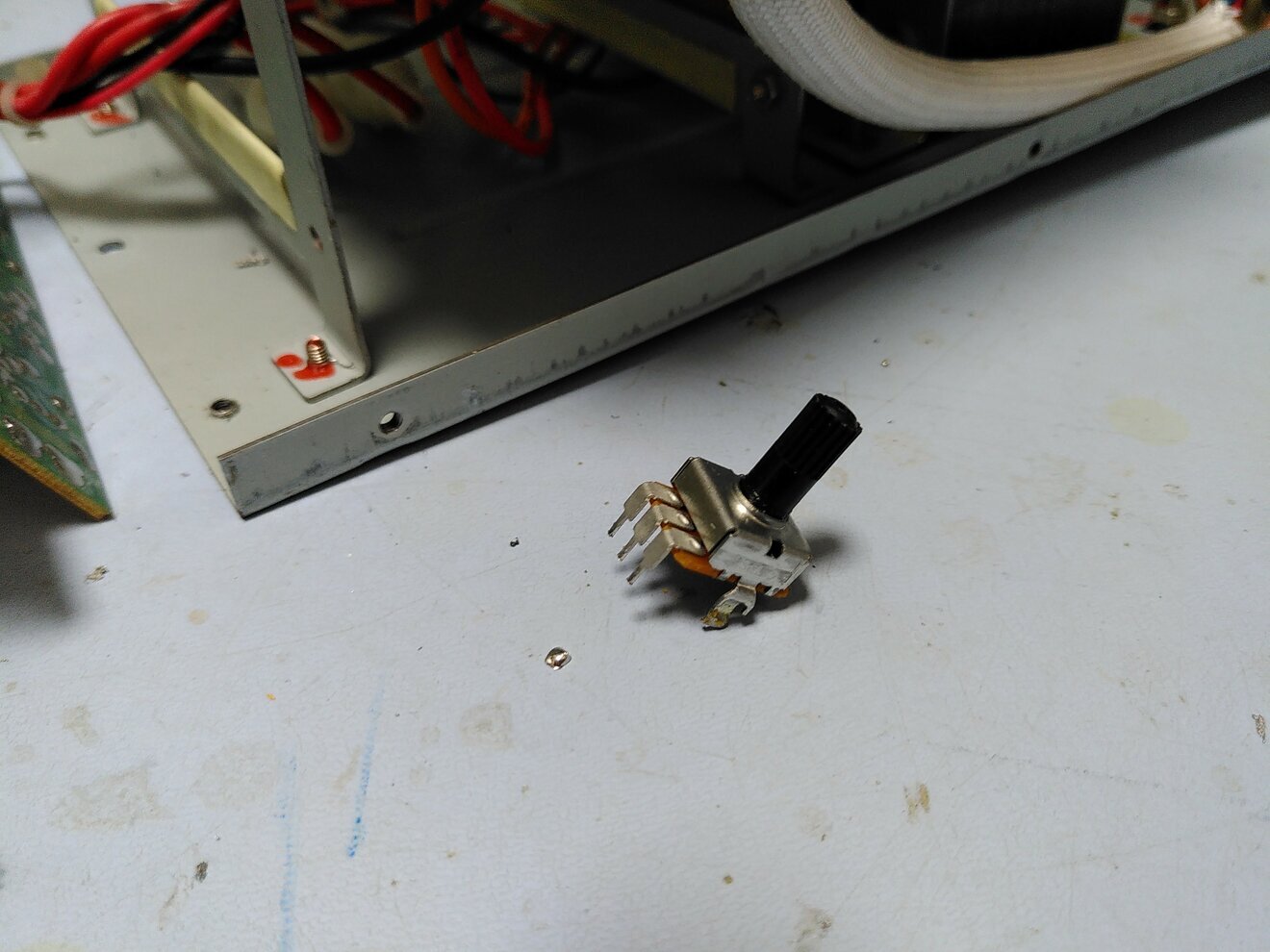

    The voltage control potentiometer VR2, 50K is faulty - going high resistance / open circuit in the CCW end and leading to the output voltage jumping around.
    I have already ordered a replacement potentiometer, so that's not an issue.

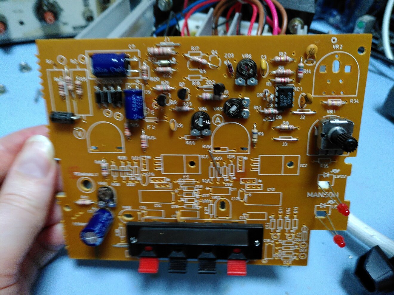

    Now, I want to replace all three electrolytics on the PCB as they are CapXon and I don't trust them so much, I will replace them with something better while I've got the thing apart anyway.
    All are CapXon GS - a general purpose series.
    Two are simple - just filter capacitors for the +/- rails to the control circuitry and op-amp.
    I can source general purpose Panasonic (M series) but the ripple current rating is somewhat lower.
    I doubt this is an issue when powering an op-amp at milliamps, however.
    But I am unsure of the output capacitor - C5 - a 470uF, 35v one.
    The CapXon GS is rated about 750mA but the Panasonic M for the same size is 550mA.
    I may be wrong, but I imagine the ripple current seen on this capacitor is not very high, given the bulk filter capacitor on the supply's input is a nice 10,000uF already
    So I expect it's unlikely I need to meet the same ratings as the original, even if the PSU is delivering the full 5 Amps....
    But, I feel like a higher quality one might be a good idea in this position, as I have seen posts about this and similar power supplies where this output capacitor is blown.
    However, if higher RCR is good, I can only meet this with Low ESR capacitors with over double the RCR rating of the CapXon GS as I can source nothing else.
    And of course these are much lower ESR than the originals, I'm sure.
    My question is whether the feedback/regulation and overall stability of the supply would be altered with the use of a Low ESR capacitor?

    use something decent like Rubycon YXF, not baseline crap.
    why would you want 2000hour lifespan caps?

      Figured there was no point, the lifespan will be longer since they won't be running anywhere near 85 degrees anyway, I imagine.
      I don't think I can get YXF for all of them. I can get YXG and YXJ for some. Others the only good series I think are ZLH or others.
      If Low ESR capacitors will not cause issues, then yes I could get them. Just wasn't sure if there might be problems, especially on the output.
