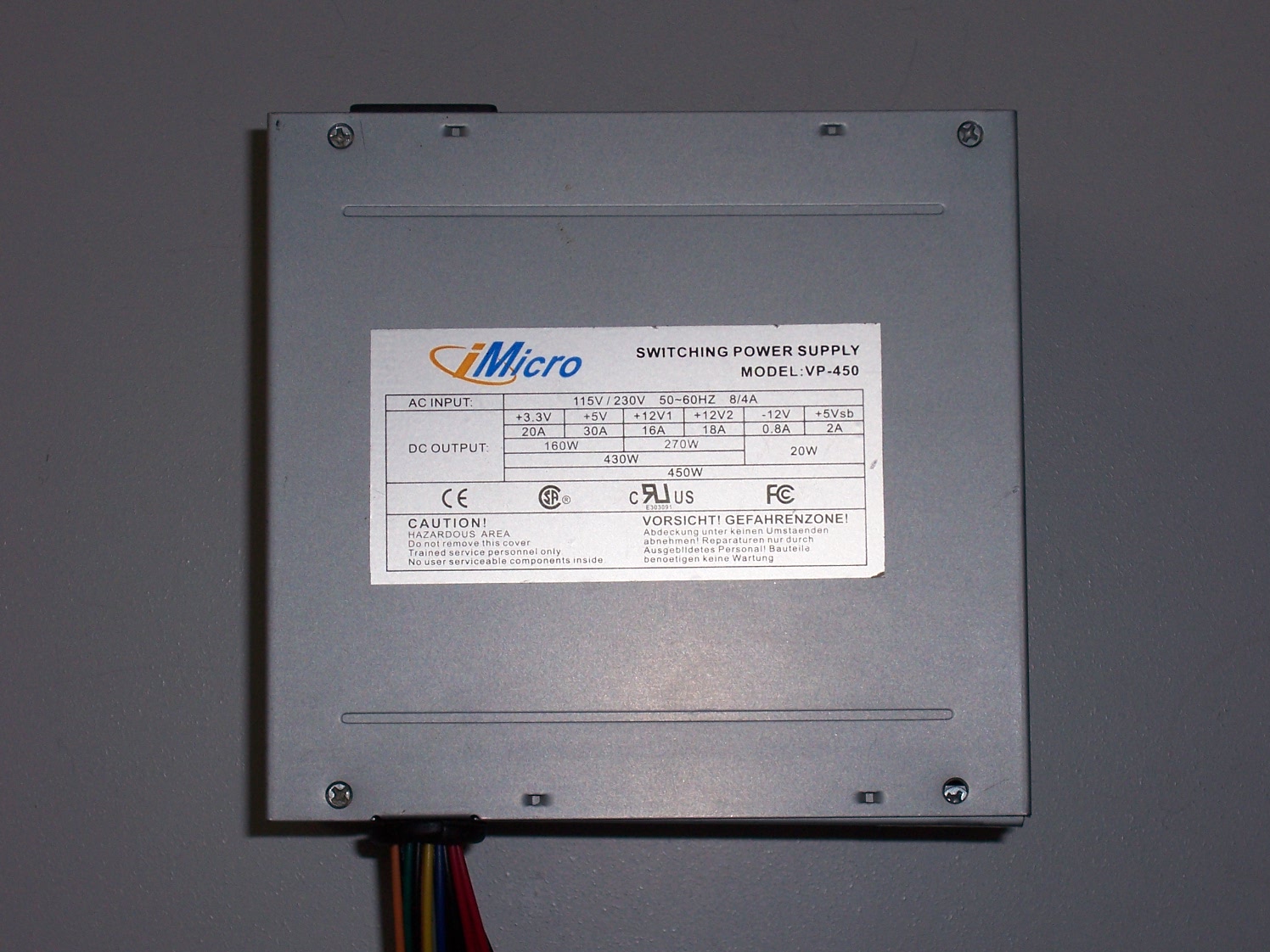

    Can it do labeled power now?

      Re: Fun with fixing I-Micro power supplies
      I don't have a load tester so I don't know.

        #63
        Are you kidding? Of course it can. Didn't you check the label on the power supply case? It has UL and CE certification, along with certifiction from a couple of other certification agencies.

          #64
          that certifies the case, not the contents.

            #65
            Am I the only one who thinks that UL logo is fake?

              #66
              Back to the story of the last I-Micro I fixed. I was ready to test, hooked it to a Pentium 3 mother board, and watched the fireworks. I repaired it (see previous posts). It ran the Pentium board fine, but after a few hours it quit. I decided to give it the "Uniqu3" modification. I removed the output diodes and installed a Shottky 3045 on the 3.3 volt rail, a Shottky 3045 on the 4 volt rail, and a MBR Shottky 20100 on the 12 volt rail. To improve the input side I installed a pair of C2625 switching transistors. Applied power using the Pentium 3 Biostar M6VLQ motherboard as a load. Ran it many hours with no trouble. At last it is fixed.....I thought.
              With boldness, I attached it to a Pentium 4 class motherboard. Pushed PS_on switch.....BANG, fizz, and a small fireball! Both switching transistors shorted, the C945 driver transistors were bad, and the 7500 pwm chip was shorted. Also a couple of bad diodes, and the resistors in one of the switchers had blown resistors. I replaced the switching transistors with 13007. I also replaced the two electrolytic capacitors in the switching transistor circuits. Replaced the driver transformer just in case it shorted. Attached it to the Pentium 3 motherboard and once again it came to life.
              Some interesting measurements: with no hard drive attached, the 5V rail reads 5.12 volts and the 12V rail reads 12.58 volts. When I attach the hard drive, a 40 gig Maxtor ATA100, the 5V rail reads 5.01 volts and the 12V rail reads 12.48 volts. Seems to me to be a rather large voltage drop when adding only a hard drive. I think that trying the Pentium 4 motherboard would again farkle its tra-la-la, so I am reluctant to put a heavier load on this 400 watt power supply.
              So what do you think?

                #67
                Wow, it exploded just connecting it to a P4 board?! What else was it powering?
                What else did you have hooked up to it? Was this with the P3 board or just a paperclip? I think it's very normal for the 12V to read very high with low 12V load on half bridge units. Since they were usually designed with low end ultra fast diodes, the schottky seems to bring the "low load" voltage up very high. As we know, these designs like 5V. It seems like the extra 5V from the hdd "levelled" it out a little bit. I'm just guessing. I bet if it were to power a 12V heavy machine, the 12V would drop to something around ~12.3V
                I don't blame you. Maybe try a different board? I'm not sure why it would power the P3 fine and not the P4 system. It looks beefy enough especially with the new silicon you put in it.

                  #68
                  At present, the power supply is attached to a Pentium 3 Biostar M6VLQ motherboard with onboard video, 512 meg of PC100 memory, PS2 keyboard, PS2 mouse, and 40 gig Maxtor ATA100 hard drive. I don't consider this to be a very heavy load! The voltage measurements were made using this motherboard and hard drive as the load.
                  The board that blew it up turns out was not Pentium 4. It is a pullout motherboard from a EMachine, a K7MNF-64 made by FIC. It has a Sempron socket 462 AMD K7 2 gig processor (SDA3000DUT4D) and 1.256 gig memory. I am using the onboard video. It also had PS2 keyboard, PS2 mouse, and hard drive attached. I tried using one of the other rebuilt IMicro power supplies on it.....worked OK for several hours. The IMicro that worked had a much larger switching transformer.
                  The EMachine board was a pullout with some bulging capacitors. I had already replaced capacitors and checked out with blue esr meter. I tried using several of my repaired power supplies on this motherboard, and all worked fine. With a good power supply this motherboard does fine.
                  I am beginning to think that the small switching transformer is the culprit. It looked like the same size transformer that was in the power supply Uniqu3 rebuilt (from pictures he posted). I would have thought it would be capable of handling the AMD K7 processor mother board. I guess that the motherboard needs more than a 400 watt IMicro power supply.........
