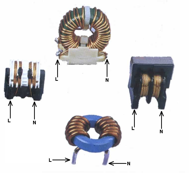

        Originally posted by momaka
        Looks like "33" or possibly even "28" size.
        It's a real 33 size. I have a Intex 28-er and the 28 is even smaller than what those iMicros use.
        BTW,I just had an PSU exact to that iMicro blow its fuse after I installed PI coils and completed the AC filtering that now awaits fixing,along with the Intex 28-er that is an candidate for some lil' modding.
        The cause for blowing isn't exact,but I think it's because I tried securing the AC filtering choke with super glue,which if I'm not mistaken it's conductive,and from that fuse the was heard. It's literally CRACKED. I also discarded my Deer PSU - by now my rule is it's not worth anything UNLESS it's an Allied. (Allied PSUs are the more "beefier" versions of L&C/Deer PSUs)
        Until I fix it I installed my old Key Mouse built Rexpower PX-400 into my system. Blows quite warm air after an certain time but I don't think it's gonna blow - maybe it's powering an A64 AM2 CPU but most of this PC is low power (1TB HDD,GT210[8400GS],1.50GB DDR2 and as I said a Athlon 64 3200+ single core) At least it has an bridge rectifier - strange thing,all SG6105 based PSUs I've had,they all had an bridge rectifier - even my Linkworld-built Powerlink PSU!

          Re: Fun with fixing I-Micro power supplies
          ASSuming it's not any of the semis...
          Maybe you put the common mode choke in 90 degrees out, putting one coil across the line and the other across the input to the supply.
          The ones with the base can be off and still put in- dead short.
          Depending on your PCB, L and N will be reversed; just be sure to put one coil in series with each current carrying conductor.
          That fuse cracked because you inadvertantly made a bolted fault.

            #45
            I used a wire choke and installed horizontally (parallel with board) on the desired place on the board (my PSU was the same as the last iMicro everell fixed. However,mine came with a bridge rectifier from factory)
            BTW,the only parts missing were 2 PI coils,a common mode choke (which courtesy of my stupidity made it blow because I should have installed it vertically [parallel with the primaries and bridge rectifier ) and a X cap (yellow and rectangular caps IIRC). Maybe installing the choke vertically and replacing the fuse will fix it? What do you think?
              Yes I second that, only a very severe short circuit (low resistance) would make a fuse do that, UNLESS, it was just a cheap fuse with a low interrupt rating xD
              Make sure you have installed the EMI choke the right way, and be sure to double check things like the bridge rectifier and switching transistors for shorts, just in case
              Oh, and make sure the EMI filter choke hasn't gone open-circuit now too!
              FYI, it would be best to use a "dim-bulb tester" for this. You just use an incandescent lightbulb in series with the PSU to limit the current. If there is a short circuit, the bulb will glow brightly, but it is much less likely for components to be damaged.

                #47
                I don't think that's really possible since it's just 2 wires wrapped around a ferrite bead.

                  #48
                  Fault currents CAN be hundreds or even thousands of amps ... they WILL blow out PCB tracks as well, fairly often. :P

                        #51
                        Don't worry about the ferrite anymore since just the fuse blew,not a biggie for me. Replaced it,placed the choke in the correct position and now it works fine.
