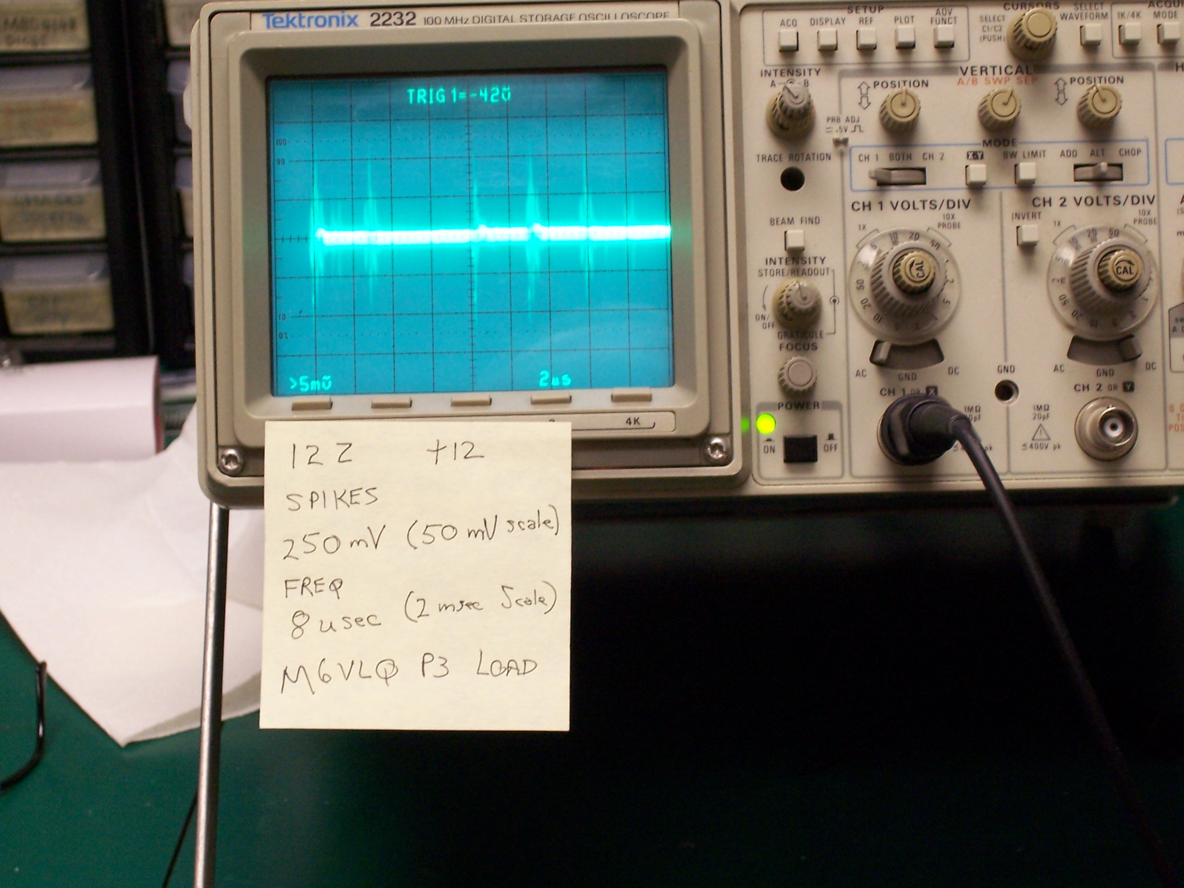

            #105
            Re: Fun with fixing I-Micro power supplies
            Originally posted by momaka

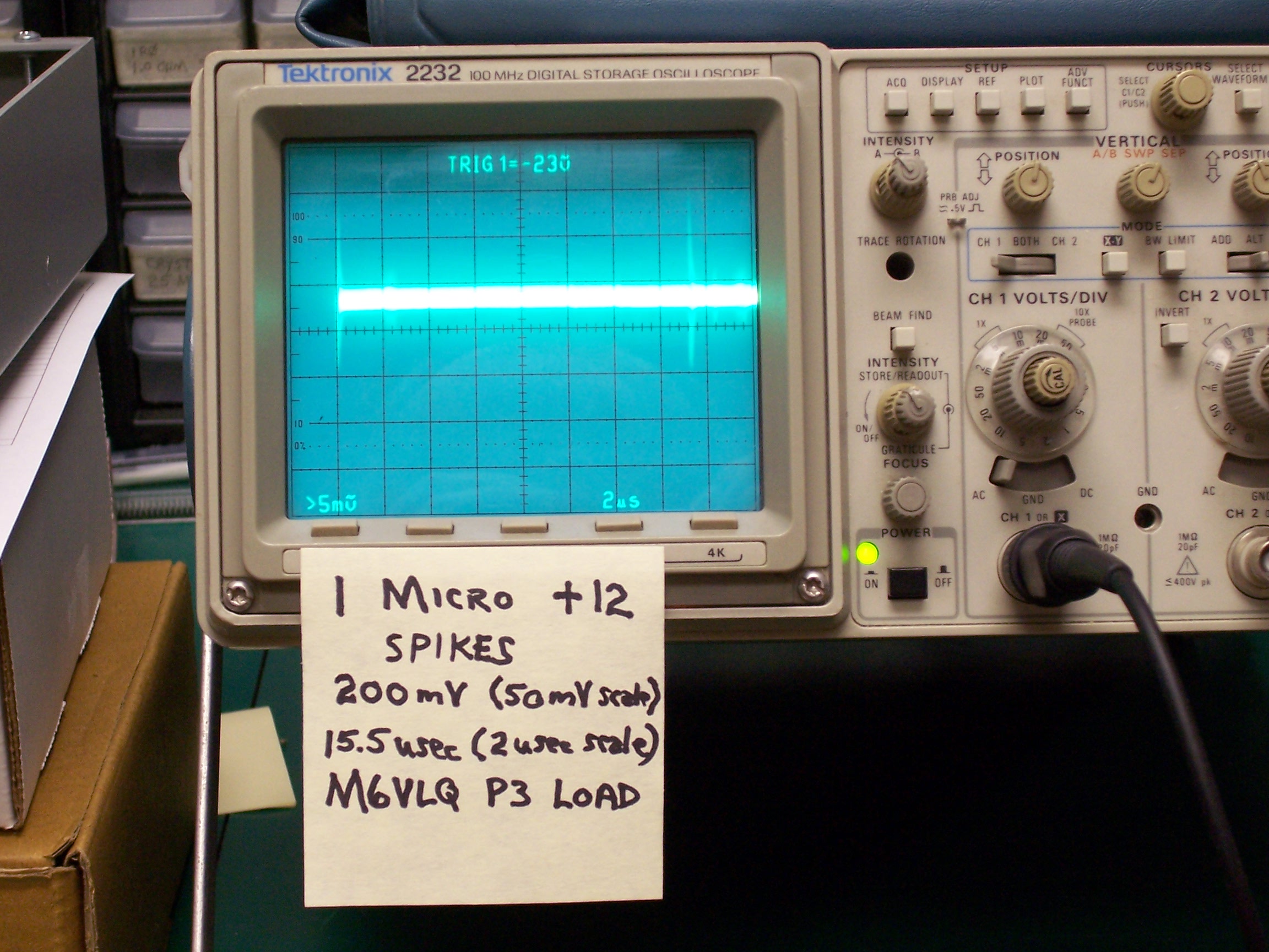

            Very interesting experiment, everell (as always ). Do you by any chance have an oscilloscope, though? I'm rather curious to see the noise and ripple on the outputs, as super-low ESR caps can sometimes cause excessive "ringing" on the PSU output filters and possibly even produce more ripple and noise than if the PSU had failing/inadequate filter caps.
            That in itself is the only reason I don't do poly recaps on PSUs, especially these cheaper units that are based on the oldschool slow-switching speed half-bridge design.

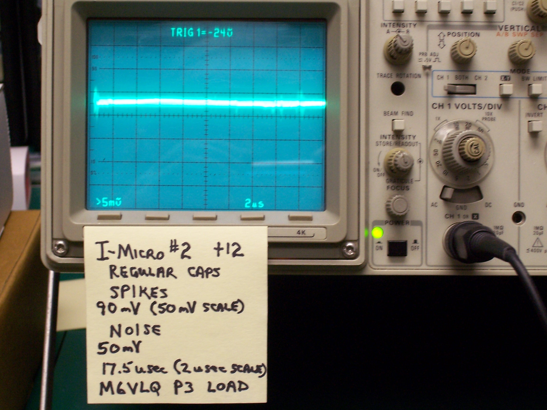

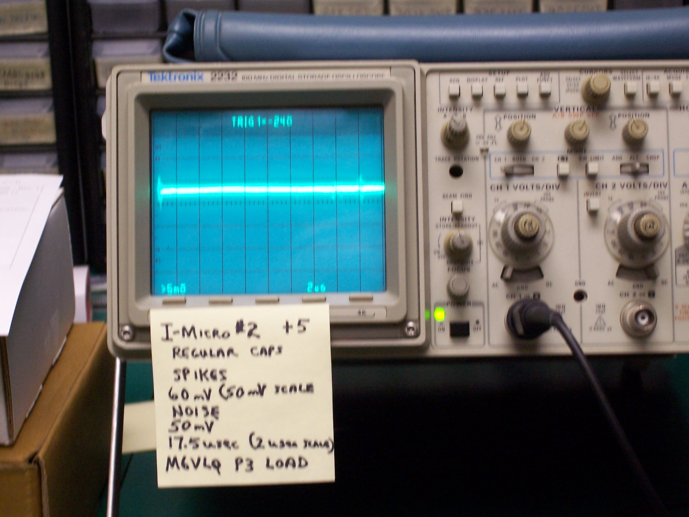

            Here are some pictures I made showing noise spikes, 160 millivolts on the 5 volt line and 200 millivolts on the 12 volt line, 15.5 microseconds pulse time (64.5 kHz) using a Biostar M5VLQ pentium 3 mother board for a load.

              #106
              I used another similar I-Micro with cheap Chinese caps to compare with the recapped poly cap I-Micro above. As can be seen, the noise between spikes on the Chinese caps was about 50 millivolts whereas with the poly caps was about 20 millivolts. The amplitude of the spikes was higher with poly caps than with the Chinese caps. I am not sure if the spikes were coming from the power supply outputs or if it was from spurious signals in the air coming from the switching transistors and transformer. Both power supplies were tested using a Biostar M6VLQ pentium 3 motherboard as a load. Is it an improvement? Can't say for sure yet.

                    #109

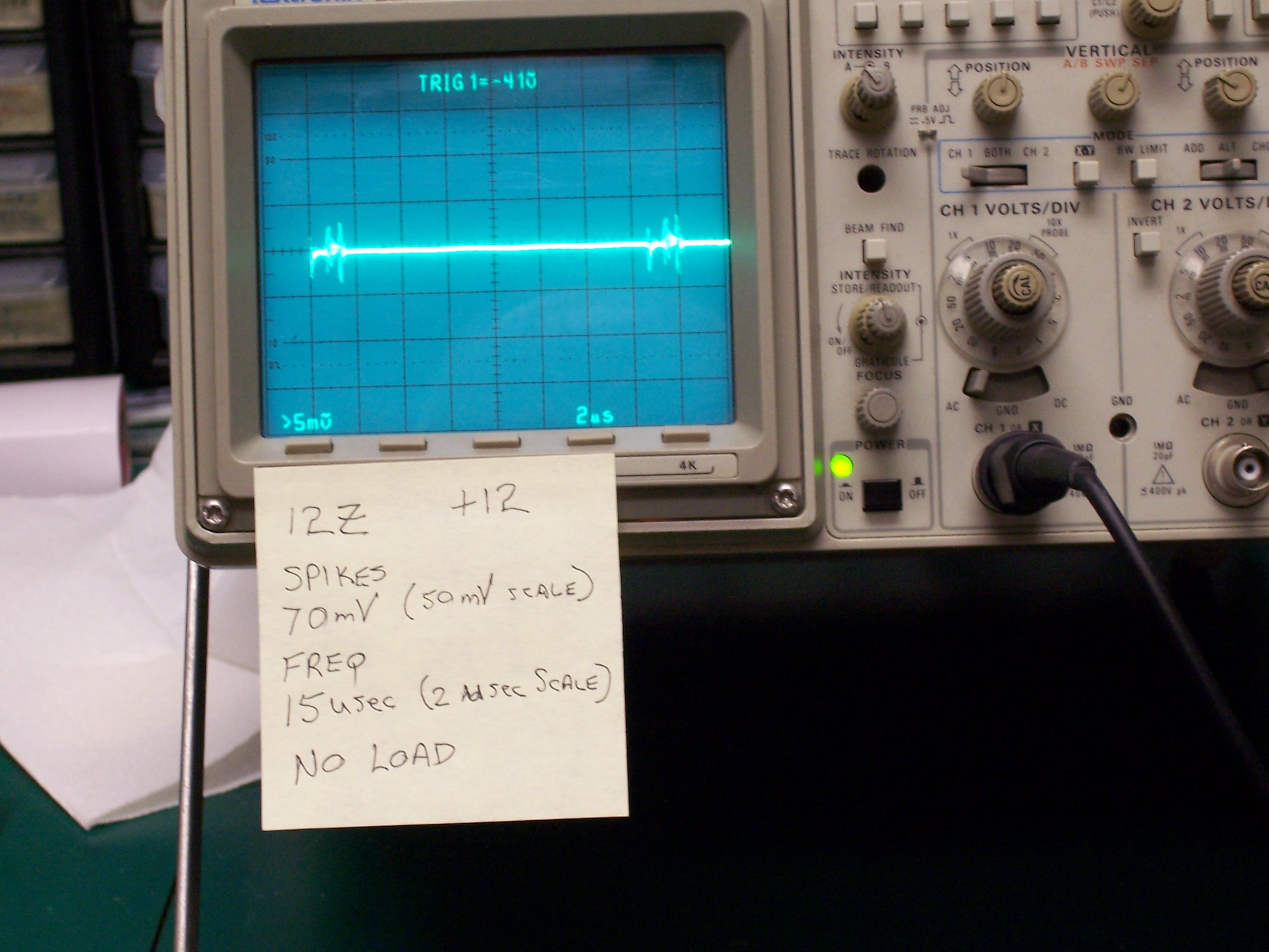

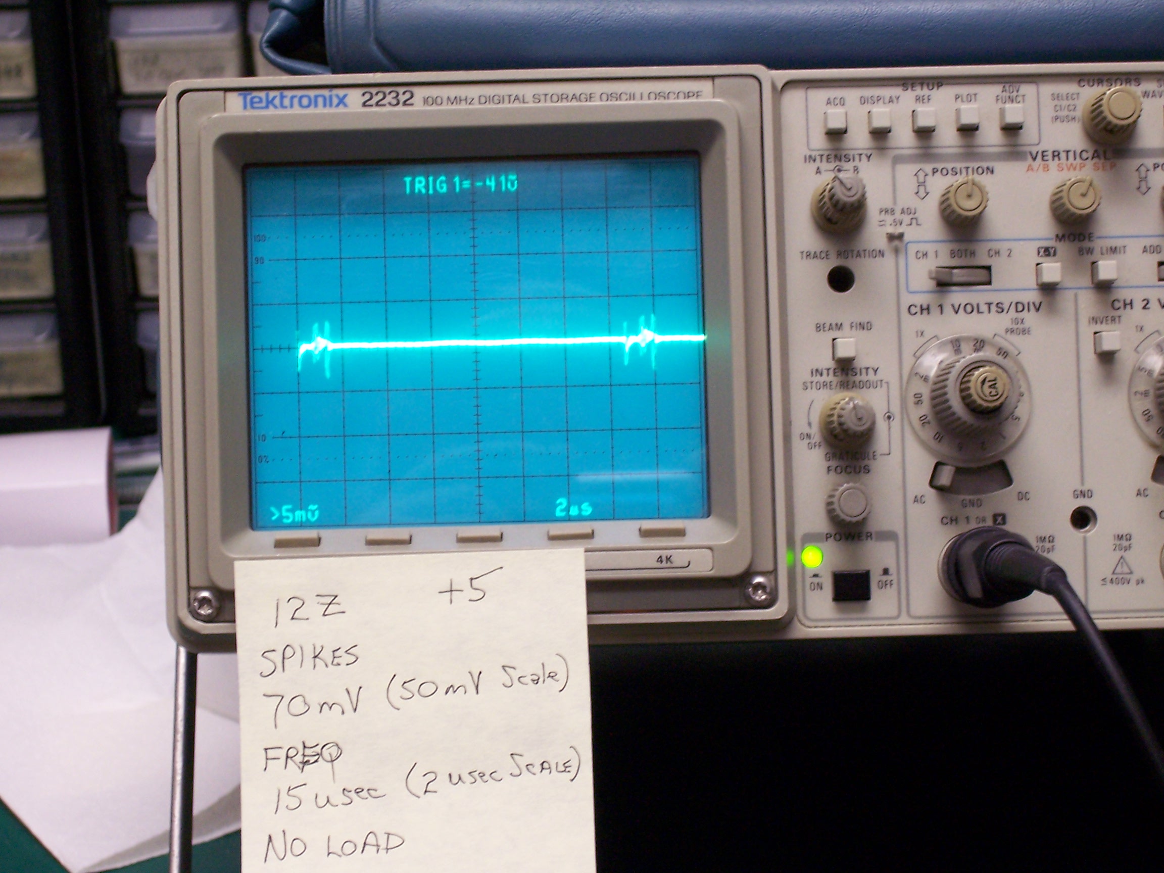

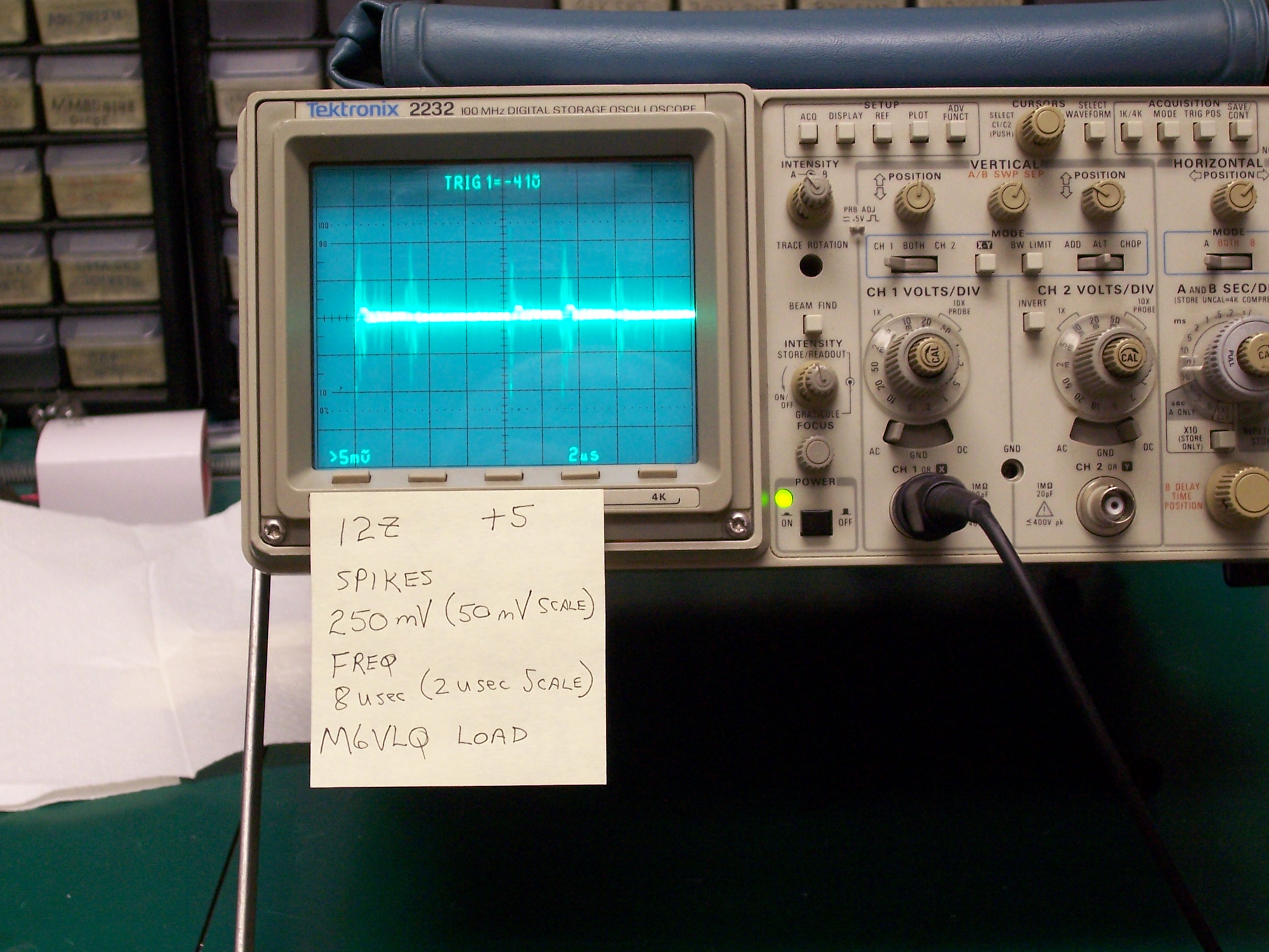

                    Next I did a poly cap on the outputs of a Bestec ATX-250 12Z. Here are the scope pictures. The I-Micro is a half bridge design. The Bestec is a current forward design. The scope pictures of the I-Micro above did not look too bad. The Bestec with no load had spikes at the switching frequence, but very little noise between the spikes. The Bestec with the same Biostar M6VLQ pentium 3 mother board as a load looks terrible. I would have thought that the Bestec with the current forward design would show much less noise when loaded.

                      #110
                      Did you try putting a 10uF electrolytic and 0.1uF ceramic cap in parallel with the load as the Intel ATX testing guidelines mandates?
                      I second this.
                      Everell, you should follow the testing procedure according to the Intel PSU spec. See page 23 of this PDF document:
                      I realize you're testing with a mainboard so maybe it makes no difference in this case. (Depends on how close it's caps are to your probe point).
                      Indeed.
                      It's best to test PSU with some kind of a linear load (i.e. non-switching).
                      Well, it matters quite a bit how the feedback loop of the output filter is designed. Some feedback loops simply aren't designed to handle the ultra-low ESR of polymer capacitors. In addition to that, if you lowered the output capacitance due to using those polymers, that too will affect the feedback loop.
                      In essence, many older PSUs like these are simply not designed for polymer capacitors. On that note, you may want to look up output filter ringing on switching power supplies.
