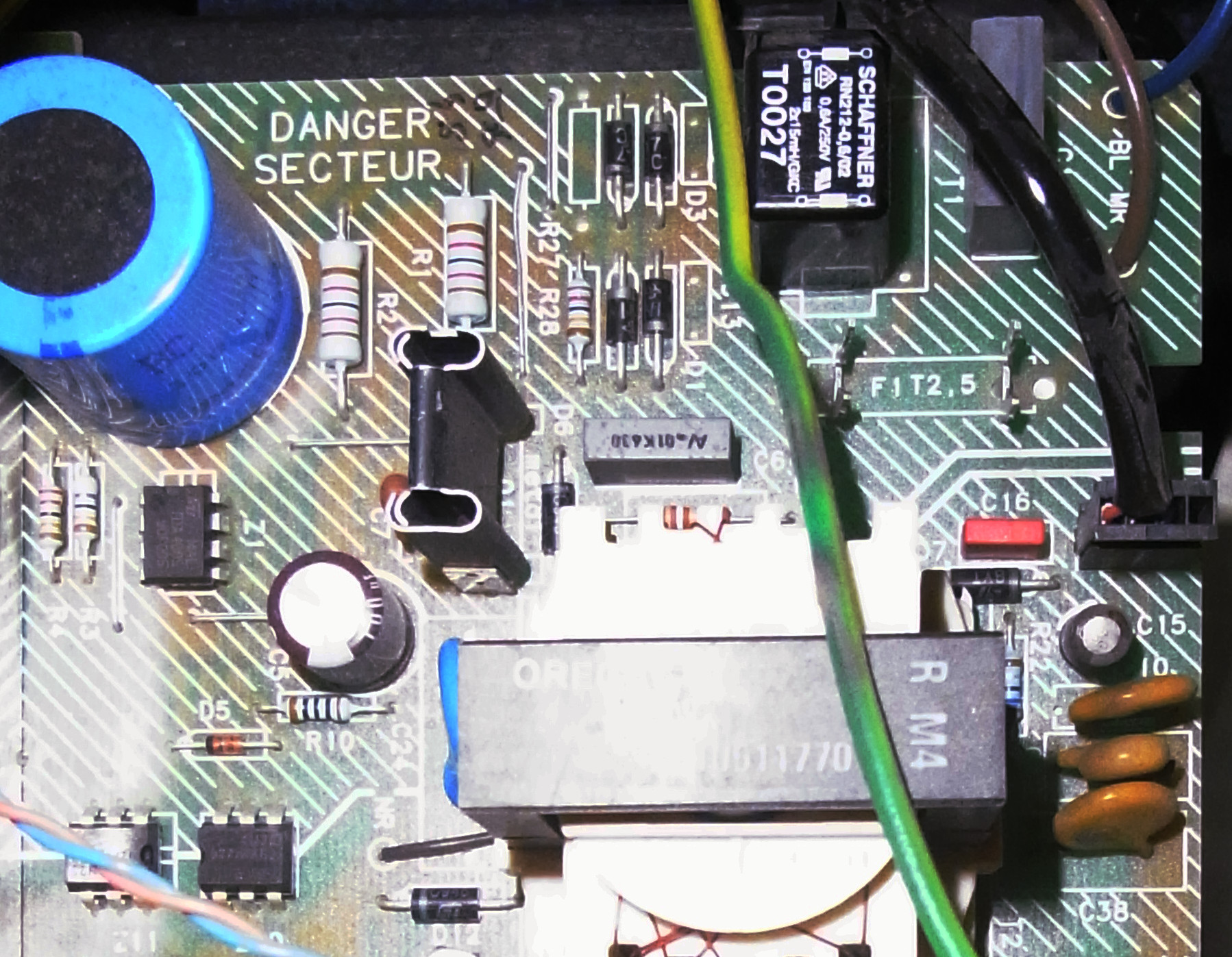

    I'm looking for a bit of advice or better yet a schematic for a Metrix 803B oscilloscope.
    The 40MHz animal here...
    .. I picked one up for very little on ebay, and it looks quite a useful thing to have around.
    The listing stated that it was dead, but in clean condition, so I took a gamble that it might be something simple.... needless to say it wasn't the fuse or the mains switch, and the next logical step is to check the power supply.
    Naturally I can find no schematic on line for it, so before I start to reverse engineer the thing, I wondered if anybody else had a schematic, or access to another 803B to compare.
    Everything looks clean and there are no obvious crispy bits or popped or bulging caps. When I power on, the mains gets from the power jack board, through the mains switch and over to the PSU board, and appears at the input side of the switch mode supply. Thats as far as I have probed so far, other things keep getting higher priority.
    I dont appear to get any audible high frequency squeak from the switch mode transformer or static on the tube, at start up suggesting it might be fairly simple to track down, but before I actually start to get my hands dirty I thought I would ask around in case the fault is a well known issue that someone here has enountered before.
    An incomplete set of pictures of the innards of the poor beast complete with optional dust are available here.... and yes, I know that the fuse is missing in some of those pictues, I had popped it out to test it. I did remember to re-fit it.

    upload the foto's, that google shit gives me a headache trying to see the foto's fullsize.
    and what is the part number on the 8pin chip near the big capacitor?

      I have every sympathy with your Google allergy. I posted there because I didn't want to clutter up this forum, and Google tends not to mash the original images up *too* much, or impose limits on their size.
      I plan on getting some better pictures of the PSU board in particular, this evening. I'll make sure that as many of the markings on the componets as possible are legible. If I have the time I might unsolder the mains input wires and pop the silkscreen side on my flatbed scanner too, in case I have to reverse engineer from the PCB.
      While I had it in bits, I spotted an un-connected single row of header pins, on the main PCB, which I suspect are for the "RS232 Serial" option (the case also has a punchout next to the 25 way D one, for what looks very like an IEEE connector, but there is no mention of that anywhere on the manufacturers site).
      If I manage to coax the thing back in to life, I will take a crack at seeing what the signals on that header connector look like.
      My gut geeling is that the serial option is probably a very expensive 25 'D' type on a bit of flat ribbon cable, with some equally expensive software to drive it.
      However first on the list of things to do is identify the 8 pin chip beside the 400V cap and the two other chips that look suspiciously like opto couplers nearby. I'll see if I can also identify the "transistor" on the black heatsink.
      Armed with that, and the values of some of the other eletrolytics, and passives you never know... it might not be such a poor investment after all.

        i suspect it's the startup capacitor,
        and it's only about 10p to find out.

            probably c5, but change c15 too.
            and use high temp, low esr stuff like panasonic FR
            i say probably because i dont know the chip number.
            psu chips need a startup current, most do it by charging a small cap.
            older ones used a high-voltage bleed using a couple of high value resistors in series to the mains smoothing cap.
            those often changed value but looked o.k. to the eye!!!

                    The "mystery chip" is a TDA4605 and the two caps C5 = 100uF (250V?) exact voltage to be determined when I find my small dental mirror and poke it behind the cap to get a better look. C15 = 22uF 50V and the two other chips are as we suspected optocouplers - in this case 4N25 . Finally the switching transistor is an ST P4NB80FP
                    The TDA460 PDF is watermarked as "Obsolete Product", suggesting there will be a better alternative, does anybody here know what that might be?

                        Hi stj, yes I checked the fuse, and I even remembered to re-fit it afterwards but thanks for the reminder. Good advice... I even buzzed the fuse out in circuit, as it would not be the first time that grubby contacts on one of those cheap blade style fuse holders had caused things to stop working.
                        Looking at the application circuit, and comparing with the PSU, I would suggest that C5 is not likely to be 100uF 250V (as I previously suggested) since this cap is the chip supply cap (i.e. connected between pin 6 (V6) and ground and is shown as 100uF in the Seimens reference design).
                        Since the supply (V6) voltage to the TDA4605 is stated as having an absolute maximum rating of +20V, I would think that a 100uF 100V cap would do the trick, and since I have some of those "in stock" as it were, I will swap that.
                        For C15 I have just picked up a 22uF 100V from Maplin Electronics for the heady sum of 0.49p
                        Both caps are physically very similar in size to the originals so I think tomorrow might be time to break out the solder sucker and see if we are in luck. Before I do that though I think I might have a quick poke around on the low voltage side to see if I can spot any shorts on the regulators or anything else that might cause the TDA4650 to sulk.

                          Well, I finally got 5 minutes to swap those two capacitors, however I really should pay more attention when dealing with shop assistants. The 22uF 100V capacitor from Maplin turned out to be a 10uF 100V capacitor, so back to the store for a replacement in the next few days.
                          I did swap the 100uF 50V, for a nice shiney new 100uF 100V but it made no difference, and since I literally had 5 minutes, I didn't even get a chance to poke around to see if I could spot anything else that might be amiss. Well that isn't strictly true, I did carefully buzz through from the the live and neutral on the plug to the bridge rectifier, and did a quick diode test on the rectifier diodes and that all looks fine.

                                  Parts haven't arrived yet, but I supect I might have spotted at least part of the problem.
                                  I checked most of the resistors the other day, but I thought I'd go over the circuit again and compare it with this similar one. and blow me if I didn't find a problem.
                                  R4 which I could have sworn I checked before (220K 1W 1%) looks to be open circuit. This appears to be connected to pin 3 on the TDA4605, (suggesting perhaps a short in the TDA4605, or a thermal stress crack in R4).
                                  I've nothing identical in my parts bins, so 5 of those are also now on order.

                                    Can you see how that resistor is connected to the other end in the circuit? It may give you the idea why the circuit is not working.
                                    Pin 3 is the Voltage monitoring pin, if it is too low then the SMPS will shut off, so that makes sense. You can temporary try another resistor in that resistance range to see if it will work.
                                    Page 3 of the IC spec sheet.
                                    Input for Primary Voltage Monitoring: In the normal operation V3 is moving
                                    between the thresholds V3H and V3L (V3H > V3 > V3L).
                                    V3 < V3L: SMPS is switched OFF (line voltage too low).
                                    V3 > V3H : Compensation of the overload point regulation (controlled by pin 2)
                                    starts at V3H : V3L = 1.7.

                                        R4, at worst case the voltage will be around 330VDC, so that is about 1.5mA which means the power dissipation will be about 1/2W so I would use 1W.
