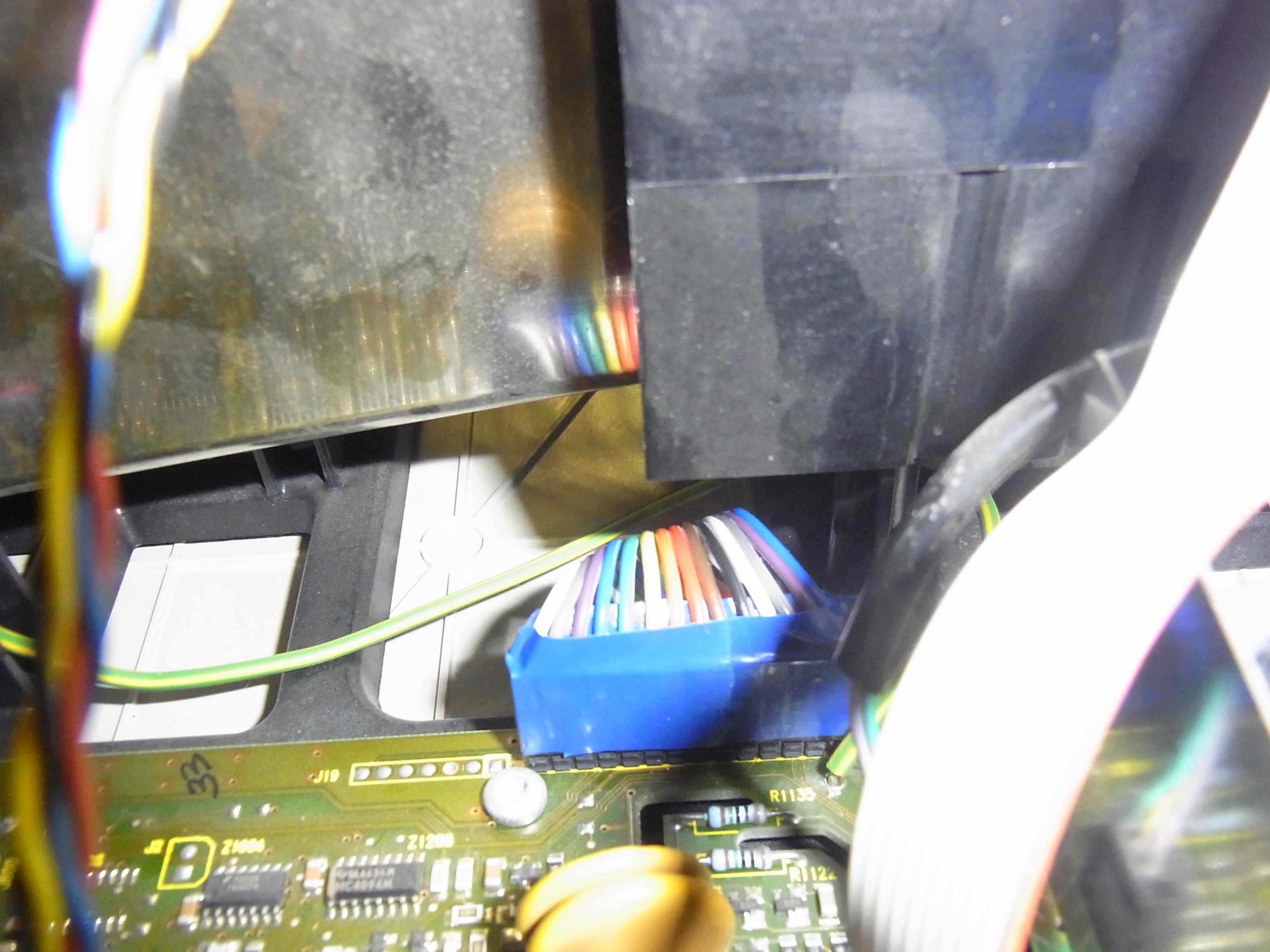

                .. I also connected up a chunk of ribbon cable to J18 and brought it out through the base of the scope, so I can prod around on that connector without much risk to life and limb. I ran out of time, so I can't yet report on the signals on the pins on that header yet, but I hope to probe it with the office Rigol tomorrow.
                I'll also see if I can get some voltage readings from the PSU <-> main board connector to assist others if they need to fix one of these in the future.
                Also of interest are J19 (unpopulated, not sure of its function) J301 (unpopulated, may give access to the analog multiplexer to allow the D to A card to overlay its image to the tube), and the front panel key connector I described previously (also unpopulated on the 803B).
                One other minor issue with my OX 803B, the component checker seems to have a minor defect, it shows a dot, offset from the zero ceter point, rather than a straight line throug the centre of the screen, although sometimes when you tap the front panel it turns in to a line. Looks like a dry joint or cracked resistor or similar. I'll take a look at that later, it is pretty low priority. Ill prod the area of the associated components with an insulated object of some sort, fire the freezer spay on it, that kind of thing.

                      I had 5 minutes to spare today, to check the signals on J18 this is what I have so far.
                      The colours in the list below are just those of the bit of ribbon cable I used, so they have no particular significance.
                      Code:
                      J18 Pinout - Pin1 at PSU end (same as J19)
                      Pin- Colour - Signal
                      1 - Blue1  -  0V slight periodic ripple (Polled output perhaps???)
                      2 - Purple1 -  0V slight periodic ripple (Polled output perhaps???)
                      3 - Grey1  -  0V slight periodic ripple (Polled output perhaps???)
                      4 - White1  -  0V slight periodic ripple (Polled output perhaps???)
                      5 - Black   -  0V slight periodic ripple (Polled output perhaps???)
                      6 - Brown  -  +12V
                      7 - Red    -  -12V
                      8 - Orange  -  10ms +5V pulses (20ms pk to pk square wave)
                      9 - Yellow  -  0V slight periodic ripple (Polled output perhaps???)
                      10 - Green  -  Ground (Confirmed zero ohms to BNC Earth)
                      11 - Blue2  -  0V but not tied to ground (serial port I/O perhaps???)
                      12 - Purple2 -  0V but not tied to ground (serial port I/O perhaps???)
                      13 - Grey2  -  +5V slight ripple (serial port I/O perhaps???))
                      14 - White2 -  +5V slight ripple (serial port I/O perhaps???))
                      I'll take a closer look at the signals, take a few pictures of the scope traces and probe with the multimeter to see if I can determine which are inputs and outputs when I get more time.
                      Now that i know the serial port protocol and that it can use 3 wires i.e. no hardware handshake and xon/xoff I can then experiment with a TTL level 9600 baud serial signal fed to which ever I think might be the inputs, so see if I can control the front panel.
                      The serial port consists of 5 wires and is described thus...
                      Serial link characteristics
                      Oscilloscope connector : 25-pin cannon plug
                      Cable : five wires (two transmission wires, one ground wire, two
                      control wires)
                      Protocol : RTS
                      Data rate :
                      Data format :9600 bauds
                      8 bits - no parity - 1 bit stop
                      Protection : per EIA RS232C standard
                      .. which may match up with the bottom 5 wires on J19
                      I haven't found any 3V3 signals so far, so I think everything should be 5V TTL
                      Pin 8 is interesting, I presume this is an accurate 50Hz pulse, which is the same frequency as the UK mains, and this might be for blanking sync perhaps for the A/D daughter cards. Pure speculation on my part of course.

                            Quick update on the pinout of the connectors.
                            Code:
                            Metrix 803B PSU
                            12 pin power connector
                            Although the board has no obvious markings, assume pin 1 is the one with the black stripe.
                            Note: DC ground is tied to main earth, and that for safe operation of the scope it must be earthed.
                            As with most scopes, all scope input BNC connectors therefore have the Ground side tied to mains earth.
                            DC Power connector (J1)
                            Pin 1) -12V Checked on multimeter
                            Pin 2) -5V Checked on multimeter
                            Pin 3) +12V Checked on multimeter
                            Pin 4) +5V 10mS pulses> See Scope trace.
                            Pin 5) +5V Checked on multimeter
                            Pin 6) GND
                            Pin 7) GND
                            Pin 8) ??? Looks like 0V perhaps feedback power good signal to PSU. Needs confirming
                            Pin 9) +120V DC Verified (6 x 2 x 10 V) Scoped Measured at 118.0V on multimeter
                            Pin 10) +180V DC Verified (3.6 x 5 x 10 V) Scoped Measured at 177.7V on multimeter
                            Pin 11) GND
                            Pin 12) +5V regulated checked on multimeter-> Option Card (A/D board) - scoped.
                            Note the +5V on Pin 12 is the same power rail as the +5V on J2 which goes to the option card (Digital (A/D) board in an 8050 etc).
                            2 pin DC Power connector (J2)
                            ===== <--Locking tab
                             1 2
                            Pin 1) GND
                            Pin 2) +5V
                            J18 Pinout - Pin 1 at PSU end.
                            1 - Blue1  -  Floating input???
                            2 - Purple1 -  Floating input???
                            3 - Grey1  -  Floating input???
                            4 - White1 -  Floating input???
                            5 - Black  -  Floating input???
                            6 - Brown  -  +12V
                            7 - Red   -  -12V
                            8 - Orange -  10ms +5V Pulses (20ms pk to pk)
                            9 - Yellow -  Floating input???
                            11 - Blue2  -  Floating input???
                            12 - Purple2 -  Floating input???
                            13 - Grey2  -  +5V (floating input ?)
                            14 - White2 -  +5V (floating input ?)
