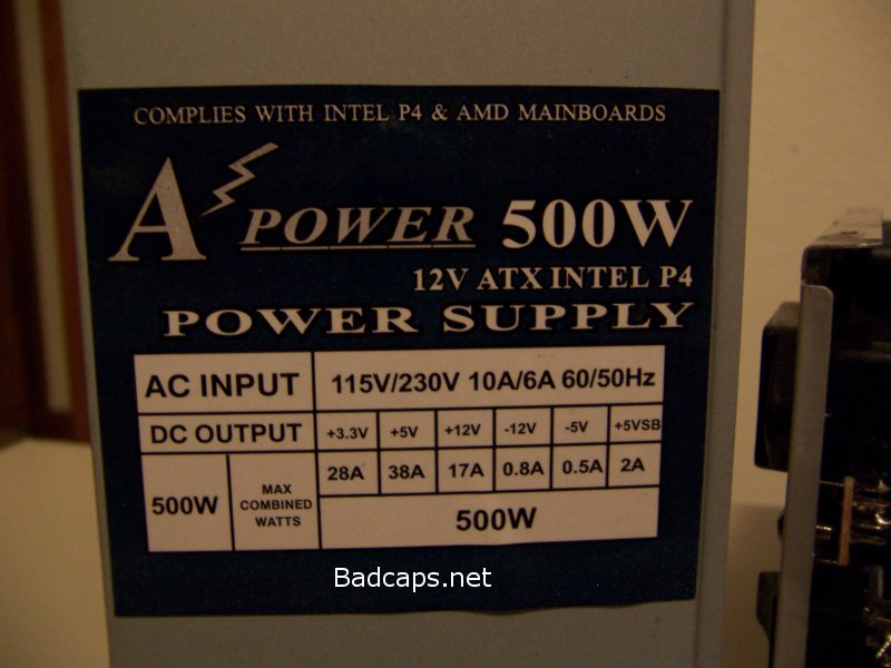

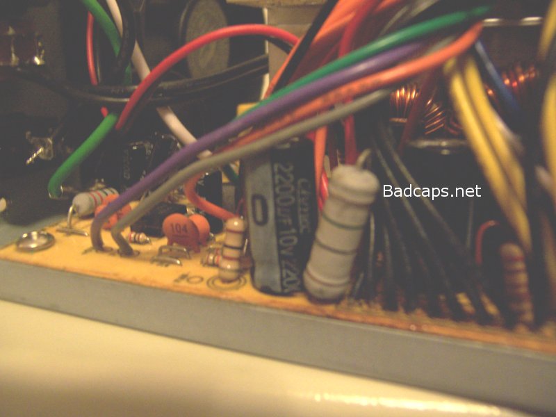

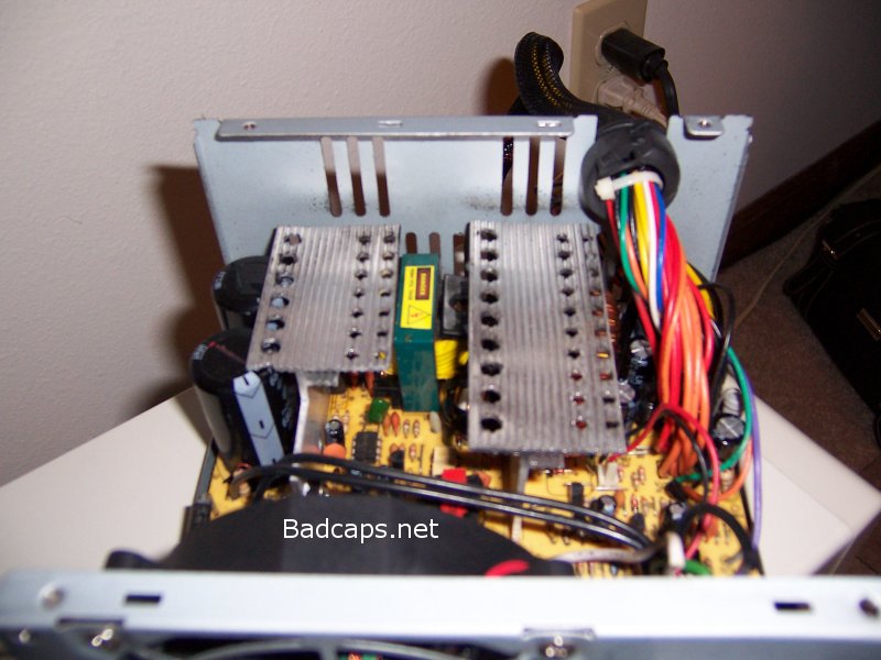

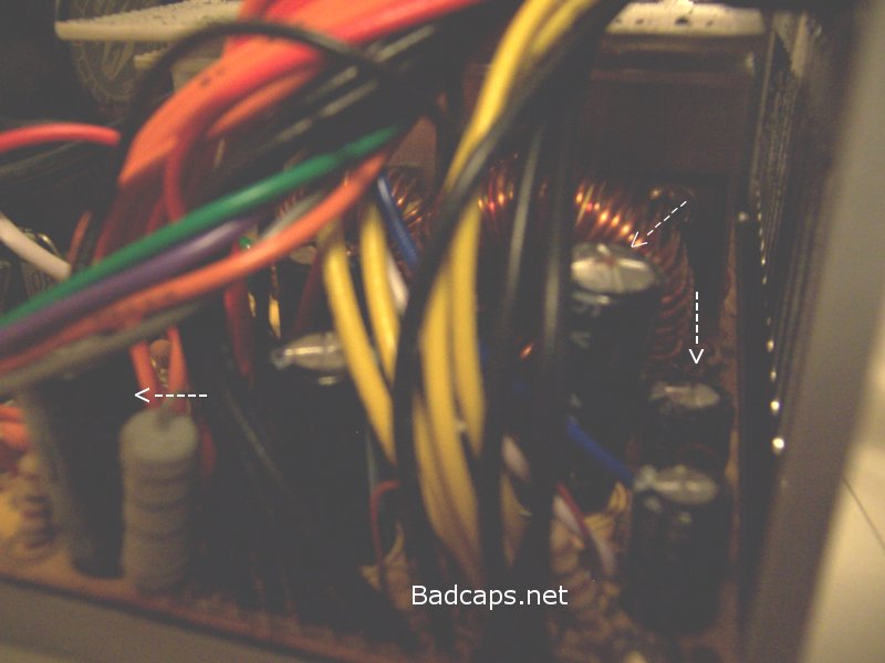

    This power supply is about 3 months old, you guessed it, roasted caps. I was repairing a PC for a woman, who was told by billy joe bob fly-by-night working out of his parent's garage PC tech that the power supply in her PC was bad. After waiting over a month for him to replace it, she brings the PC to me, along with the "high quality" power supply he sold her for $100.00. The PSU was new, still sealed in the box, cables all banded up, so atleast I know he didn't slip her a used one. Anyway, I swapped the PSU's out for her, PC worked again, and she went on her way.
    She calls me Tuesday, just mad as hell, telling me when she hits the power on her PC, it comes on, and then immediately shuts back off. She claims she has to hit the power button 10-15 times before it'll actually stay on, She continues on to say that she'll be in the middle of doing something, and the power just shuts off, and it won't come back on at all. She brings it over, and sure enough, she's telling the truth. The system was a P4 2.6GHz, 512mb RAM, onboard everything, pretty simple system....
    Of course that PSU was my first suspect, so with her standing right here, I removed it and opened the PSU, and sure enough.........roasted caps. This brand is a new one on me, I've never seen them before. The primary HV filters are fuckyou brand, no surprise there, but the secondaries are all "CHMEC" brand, one I've never seen before. Normally, I recap PSU's and reuse them, but I wasn't even messing with this shoddy pile of shit. It claims to be a 500 Watt, yet I've seen heftier heatsinks, FET's, and regulation on a cheap-o 300 watter...
    I had a new Enlight 450 watt supply lying around that I bought for someone and ended up not using, so I sold her that one, installed, PC worked great again. I explained to her the shoddy garbage that other guy sold her (which made her even more angry). She insisted that she was going to take that PSU over to his house and shove it where the sun don't shine. Before she left with it, I asked if I could take a few pics of it.
    This is the worst I've ever seen, even worse than a Deer or a powmax..... The absolute most shoddy cheap piece of garbage PSU I've ever encountered! It lived a little over 2 months in a normal working environment, powered up maybe 3~4 hours a day (according to her). PC had above average cooling, and all fans were working. It didn't overheat.

    I've seen those cross-drilled heat sinks somewhere before - just wondering which brand. Perhaps it is a Powmax variant? What were the rectifiers like - the usual wimpy 3A ones on +12v?

      I am sure there is a few in the photo psu post of that style heat sink.

        It's typically what you'd get from Raidmax, rated at 400W but worth about 230W for short term use. On second thought, this does have marginally larger caps than the 400W version, but obviously still not good enough.
        As much as I'd like to bash the tech that sold it to her, this is an industry problem more than a technician problem. Specs are supposed to be scientific, qualification factors and a PSU that is so blatantly deceptive shouldn't even be let into any 1st/2nd world market, should be seized at the docks.

          Interesting, i got a a-power Ultra Edition rated 550W new in box a few years back (paid $29 CDN) and never used it, looking in through the 120mm fan it looks almost identical to topcats pics. Maybe i should sell it in the BST

                That's a Leadman Power aka Powmax unit if ever I saw one... and I have two dead ones sitting next to me
                One's even identical, right down to the cap brands.

                  ha it is even so cheap that the fan doesn't have a full frame

                      You are CORRECT sir! That IS a Leadman/Powmax unit in the flesh, good for 150W or so BEFORE the caps pop.

                        Fans in L&C and probably DEER power supplies also are like that.
                        They probably guessed that putting dirt-cheap unreliable fans in their PSUs would save them big money.

                                  Look at the size of the transformer... and the small heatsinks... can't be a 500W PSU.
                                  It is better to buy PSU with UL/CSA mark, check the UL file no. for the manufacturer:
