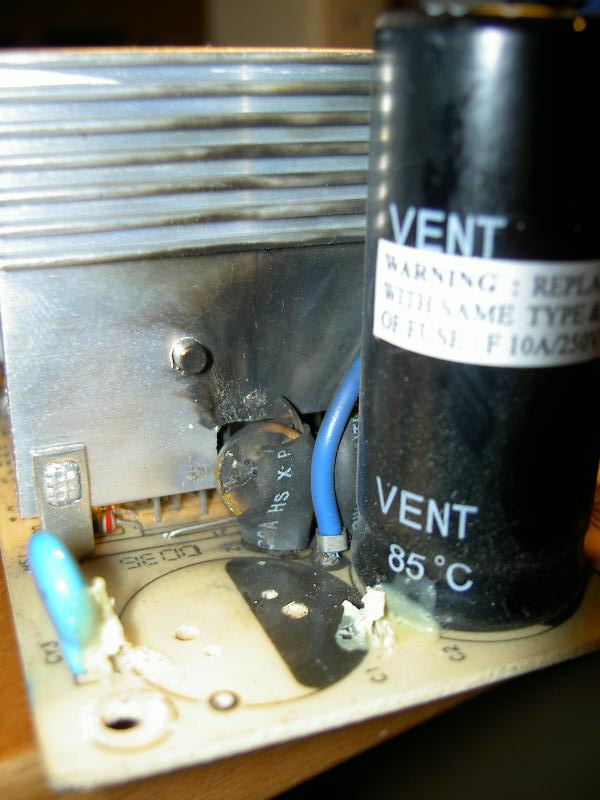

    Jou Jye JJ-300AP 300w Fail

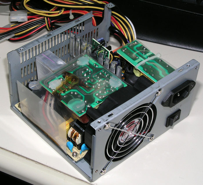

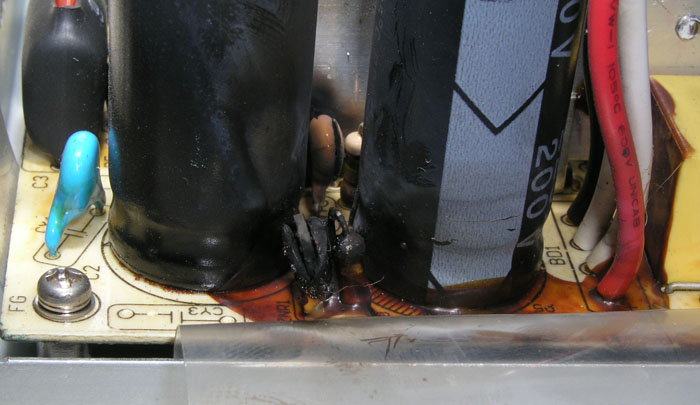

    This is a friend's psu. Turned it on one time and burning smell. Then turned it on a second time! (electrician by profession)
    Between the two main caps there is a ceramic capacitor which has burnt. There appears to be leaking from the bungs of the main caps which has travelled up onto the pcb on the top near the fan. (as the psu would have been upside down in the case) i am not sure about that though. All the caps are Jun Fu.
    There is no burning on the ATX or 12v mobo connector.
    anybody have any idea about the reason for the fail?

    Re: Jou Jye JJ-300AP 300w Fail
    Are you sure it was a ceramic cap? They rarely fail.
      the pcb says ZNR1 for that item and there is another one right behind it in the photo (the brown one) marked ZNR2.
      might not be the cause though, it might be the effect.
        I'd say it was a varistor - for overvoltage protection.
          Is the blown component a ceramic capacitor, or is it a zener or MOV? Because next to it the circuit board is labelled "ZNR1", which could stand for ZeNeR1. Could that mean there was a voltage surge?
          If this PSU failed the very first time it was used, then maybe it was built for 110V instead of 220V. I don't see a voltage selection switch on back, and all the PSUs I've seen that had automatic voltage selection had only one big high voltage capacitor, not two, but maybe a jumper was wired when it shouldn't have been.
            PSU was working fine for 3 years and then failed. It is a 230v unit. ZNR appears to be in common use on pcbs for ZNR Surge Absorber (varistor) / Zinc Oxide Nonlinear Resistor / MOV etc. So thanks for that tip.
            I guess we are indeed talking about a surge from the wall unless the MOV failed on its own?. Fuse is not blown though. Might be a good idea to recommend a UPS.
            Here is an interesting article on Metal Oxide Varistor Degradation
            http://www.iaei.org/magazine/04_b/04_b_brown.htm
            I am thinking the brown stuff is not from the caps, just some wierd glue. it is also in another place (near the fuse) and looks like it did not flow there.
            Would it be repairable if i salvage some varistors from another unit, or would there be more damage? I dont see anything obvious. I hope the pc is ok but since it took 2 weeks to remove the psu from the case i think we will have to wait for a while for that news to arrive.
              I think it should work after replacing the MOV.
              Nice photo in that article - http://www.iaei.org/magazine/04_b/brown_photo1.gif
                Just replace the varistors with ones with equivalent voltage rating - somewhere between 200-250 V DC will be fine across each cap. The fuse and the bridge rectifier should also have gone. Check the other stuff on the primary side carefully, including transistors, inrush thermistor, etc.

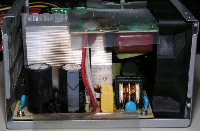

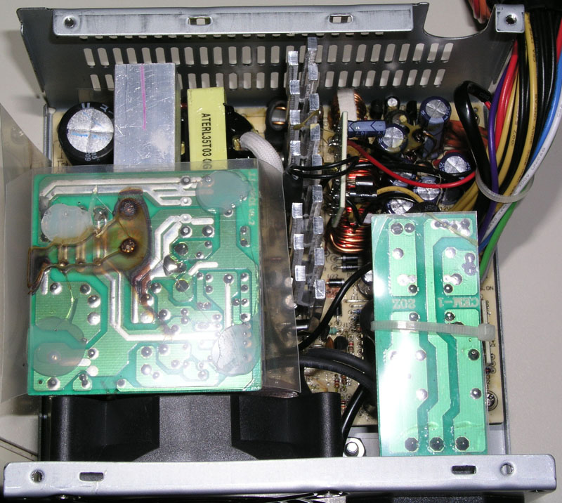

                      On the PCB near the fan with a burn mark: I think it looks like the PFC module (which probably has a blown MOV).
                      Those 220uF 200V electrolytics are inadequate for a 300W supply... suggest replacing them with 470uF or higher units, board space permitting, as well as replacing the Jun Fu electrolytics on the secondary.
                        the larger caps will also allow you to ride through minor glitches.

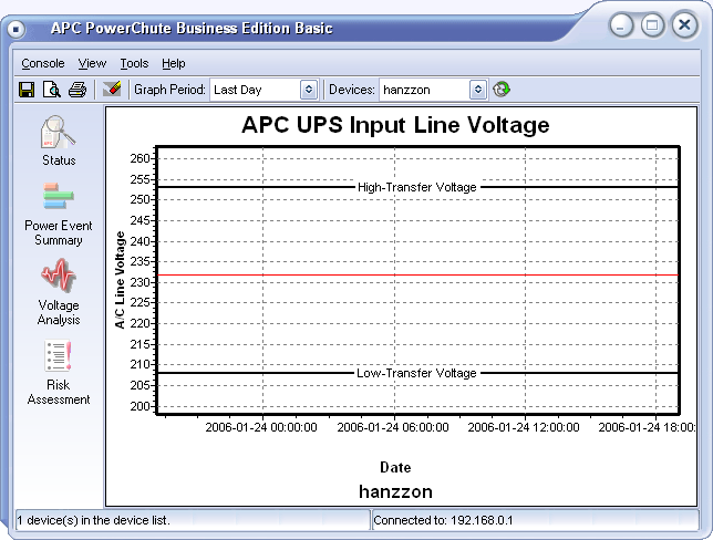

                          And this was attached to the "lovely" power system in Greece I take it. How's the voltages in your friends area?
                            probably shitty. better in the city. things have improved a lot since the 80s though.

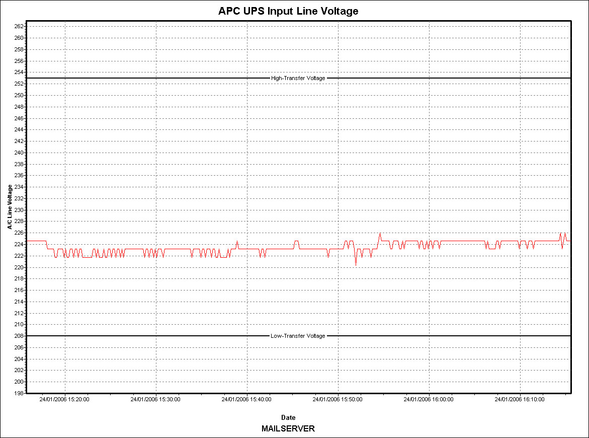

                              Haha, that is excellent bro!
                              You should see my graphs.... I don't have any software to make a nice graph though, unless you want to see the graph from my APC Smart-UPS 1000 UPS connected after the Riello 6kW UPS
                              Now where are those spikes
                                  Originally posted by dood
                                  I didn't think you were supposed to plug a UPS into another UPS... And why would you want to?
                                  There will be no harm...
                                  Why? Well, I got it basically for free... And it should offer better protection against lightning strikes...
                                  I've got another Smart-UPS 700 in a corner doing nothing, maybe I should hook it up aswell :P
