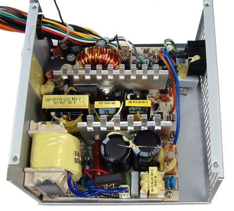

                                  Some pics of an Powmax psu, i removed as an safetty messure from a new case.
                                  i don`t know if you can see how flimpsy this psu realy is.
                                    Re: Power supply build quality pictorial
                                    Some Pics from a realy decent Delta PSu. Got them cehap for about 16€.
                                    Most caps are Capxon, but don`t know what brand those green caps in the middle are.
                                    The case is somehow other than most psu's, if 5 screws are unscrewed, you can slide the whole psu out of the case and have the bottom of the pcb handy for soldering.
                                    I/P caps are 2x 680uf 200v.
                                    Comment on the Powmax: the i/p cap is an 400v 120uF cap. It seems to be slightly bulging.
