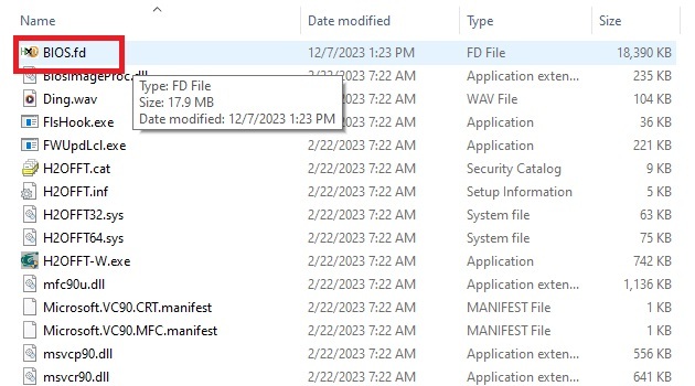

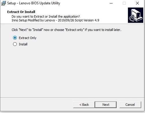

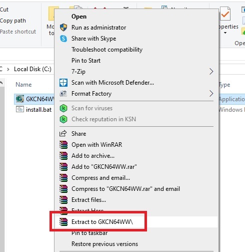

                    #50
                    Originally posted by Rickkap
                    BIOS request for the above model, please.
                    Brand: LENOVO
                    Serial: PF2TFEX2
                    Model name: Legion 5 15ACH6H
                    Main Board: NM-D562 Rev:2
                    Original bios attached.
                    If someone could explain what tools are needed to convert the .exe BIOS from the manufacture websites to .bin I would really appreciate it.
                    Lenovo extract bios by it self like hp
                    run exe downloaded from lenovo support
                    and follow the step
                    once you get your extracted bios than you need to trim with help of old reference backup bios by matching header(TOP) and footer (BOTTOM) with expect size
                    1
                    2
                    3
                    4

                      #51
                      Thank you for the write-up on how to extract the bin file from an exe.
                      I tried your way but i'm getting an error when extract to
                      The error is:
                      ! C:\Drivers\Flash\nm-c711\DKCN55WW.exe: Cannot open C:\Drivers\Flash\nm-c711\DKCN55WW\Ding.wav
                      The system cannot find the path specified.
                      ! C:\Drivers\Flash\nm-c711\DKCN55WW.exe: Cannot open C:\Drivers\Flash\nm-c711\DKCN55WW\Microsoft.VC90.CRT.manifest
                      ! C:\Drivers\Flash\nm-c711\DKCN55WW.exe: Cannot open C:\Drivers\Flash\nm-c711\DKCN55WW\Microsoft.VC90.MFC.manifest
                      ! C:\Drivers\Flash\nm-c711\DKCN55WW.exe: Cannot open C:\Drivers\Flash\nm-c711\DKCN55WW\platform.ini
                      ! C:\Drivers\Flash\nm-c711\DKCN55WW.exe: Cannot open C:\Drivers\Flash\nm-c711\DKCN55WW\H2OFFT.cat
                      ! C:\Drivers\Flash\nm-c711\DKCN55WW.exe: Cannot open C:\Drivers\Flash\nm-c711\DKCN55WW\BIOS.fd
                      ! C:\Drivers\Flash\nm-c711\DKCN55WW.exe: Cannot open C:\Drivers\Flash\nm-c711\DKCN55WW\H2OFFT.inf
                      ! C:\Drivers\Flash\nm-c711\DKCN55WW.exe: Cannot open C:\Drivers\Flash\nm-c711\DKCN55WW\FlsHook.exe
                      ! C:\Drivers\Flash\nm-c711\DKCN55WW.exe: Cannot open C:\Drivers\Flash\nm-c711\DKCN55WW\FWUpdLcl.exe
                      ! C:\Drivers\Flash\nm-c711\DKCN55WW.exe: Cannot open C:\Drivers\Flash\nm-c711\DKCN55WW\H2OFFT-W.exe
                      ! C:\Drivers\Flash\nm-c711\DKCN55WW.exe: Cannot open C:\Drivers\Flash\nm-c711\DKCN55WW\WDFInst.exe
                      ! C:\Drivers\Flash\nm-c711\DKCN55WW.exe: Cannot open C:\Drivers\Flash\nm-c711\DKCN55WW\BiosImageProc.dll
                      ! C:\Drivers\Flash\nm-c711\DKCN55WW.exe: Cannot open C:\Drivers\Flash\nm-c711\DKCN55WW\mfc90u.dll
                      ! C:\Drivers\Flash\nm-c711\DKCN55WW.exe: Cannot open C:\Drivers\Flash\nm-c711\DKCN55WW\msvcp90.dll
                      ! C:\Drivers\Flash\nm-c711\DKCN55WW.exe: Cannot open C:\Drivers\Flash\nm-c711\DKCN55WW\msvcr90.dll
                      ! C:\Drivers\Flash\nm-c711\DKCN55WW.exe: Cannot open C:\Drivers\Flash\nm-c711\DKCN55WW\H2OFFT32.sys
                      ! C:\Drivers\Flash\nm-c711\DKCN55WW.exe: Cannot open C:\Drivers\Flash\nm-c711\DKCN55WW\H2OFFT64.sys
                      Can you advise what i'm doing wrong, or an alternative way.
