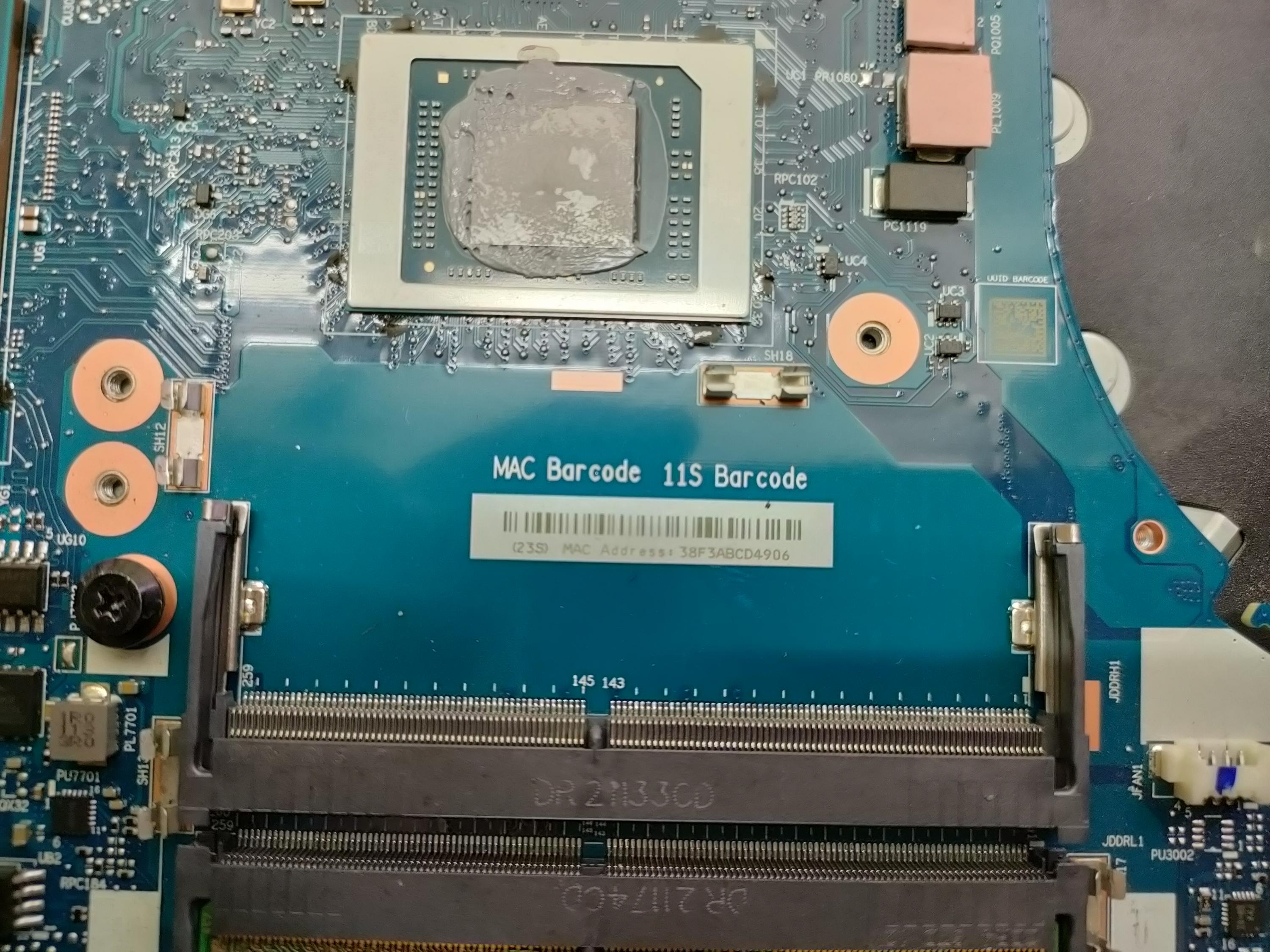

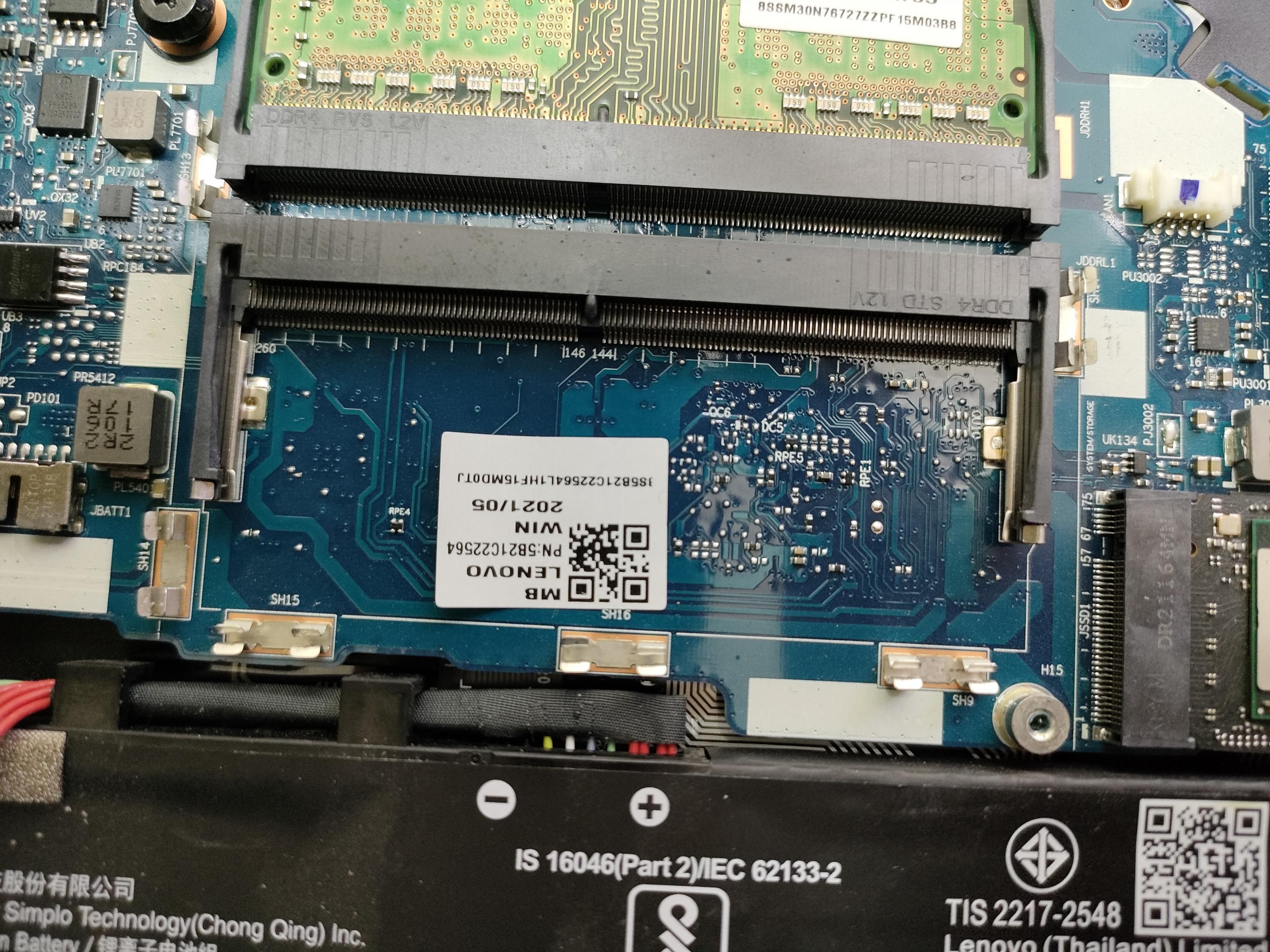

    Originally posted by philipgwen
    serial number PF2YRXV3
    New bios file.

      New bios file.
      thank you, please i will try and get back to you

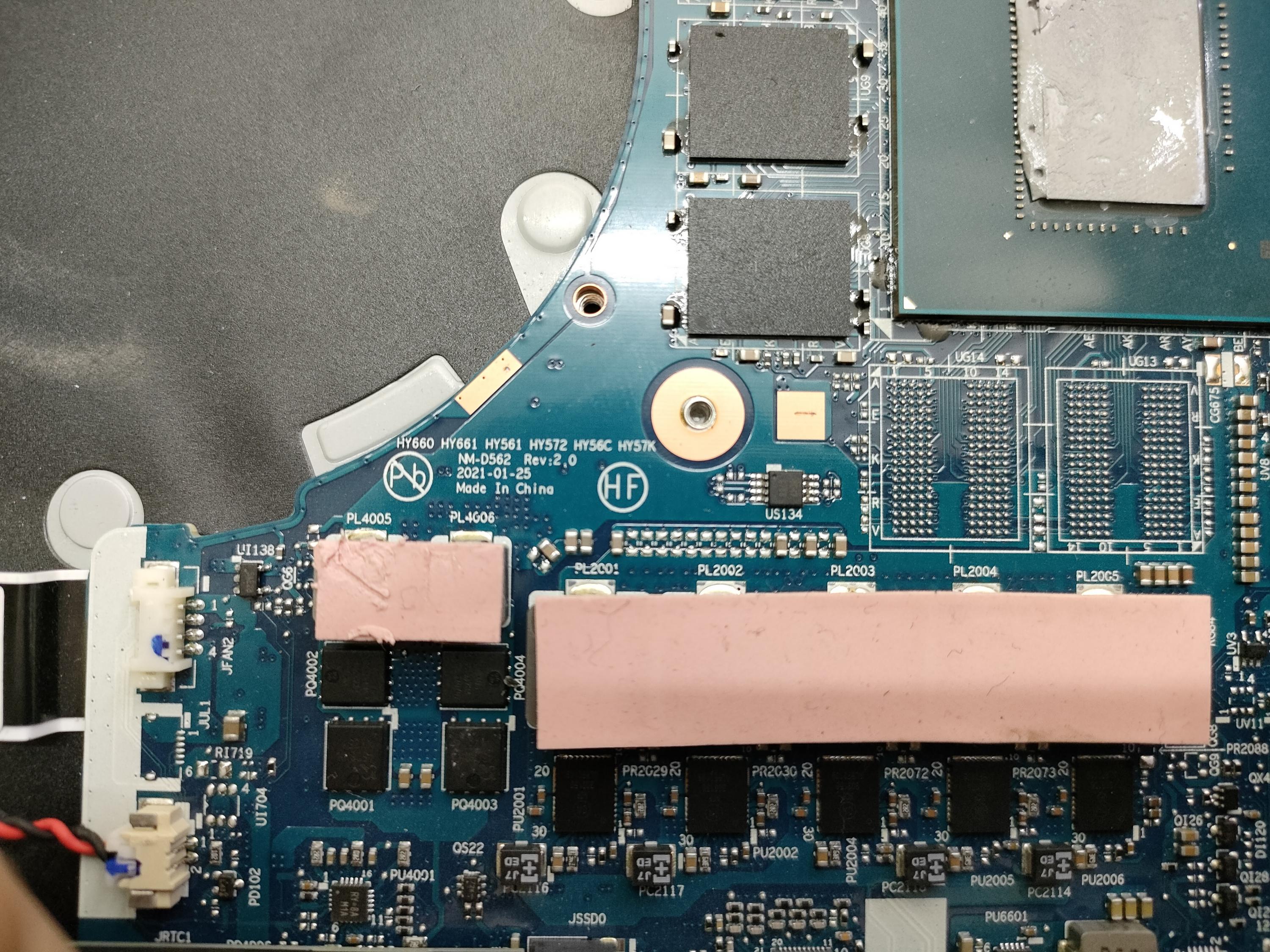

                nee bios Lenovo Legion 5-15ACH6H Type (82JU)
                hi need bios Lenovo Legion 5-15ACH6H Type (82JU)
                nm-d562 rev 2.0
                and i dont have the dump help plz

                              Brand: LENOVO
                              Product ID/MTM/: 82JU00A1PB
                              Model name: Legion 5 15ACH6H
                              Main Board: HY660 HY561 HY572 HY56C HY57K NM-D562 Rev:2.0(2021-01-25)
                              CPU: AMD Ryzen 7-5800H(100-000000295)
                              GPU : RTX3060 6GB (GN20-E3-A1)
                              Screen: 15.6" (1920 x 1080, Full HD, IPS 120Hz)
                              EC/KBC: IT827E-192 CXA (UE1, 192KB)
                              BIOS: GD25LR128DSIG, (UB3, 16MB)
                              VBIOS : W25Q16JWNIQ (UG10, 2MB)
                              BIOS version: GKCN40WW
                              EC version: GKEC40WW
                              Others: Batches downloaded from a working disc.
                              - S/N cleared, optional xxxxxxxxx.
                              - System key cleared, optional xxxxxxxxx.
                              - ME Region cleared.
                              - VBIOS for GPU 130W TDP.

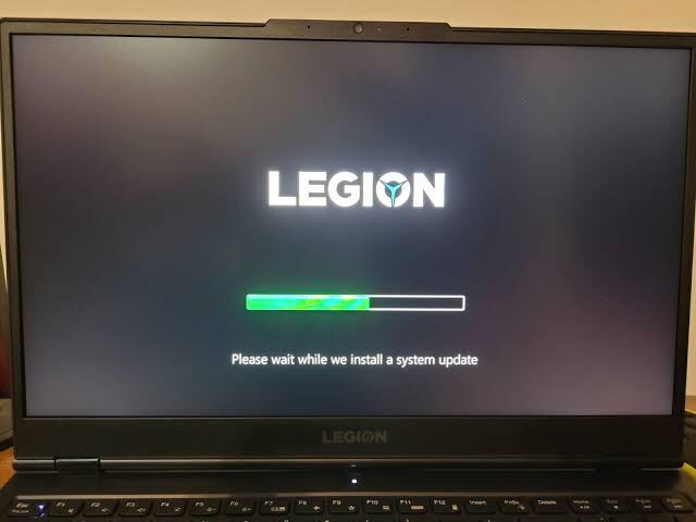

                                      I'm sorry I wasn't aware of the roles. My laptop issue was I updated my laptop window update and It presented a bug to my laptop it shuts down after 1-2 minutes of starting, But if I boot to Windows and sleep it before it shuts down then wake it up and use it it works like normal. It doesn't matter where I was it just shuts down, Bios, windows Installer, window recovery, or updates it just shuts itself down. I updated every driver, not nothing worked but the last driver I updated was the Lenovo firmware driver I downloaded and updated the laptop and restarted to install the update it was in the middle of the update the laptop turned off and the update failed. Now when I start the laptop fans are running keyboard lights up but no screen no sound no bios. I think the BIOS needs to be reprogrammed. I bought the CH341A with the 1.8v adepter. I just need the latest BIOS GKCN60WW .bin file. If I am missing anything let me know.
                                      Laptop details:
                                      Lenovo Legion 5 15ACH6H
                                      Serial number: PF3M82X2
                                      Mo: PF9XB2317078

                                        Post the bios backup file.
