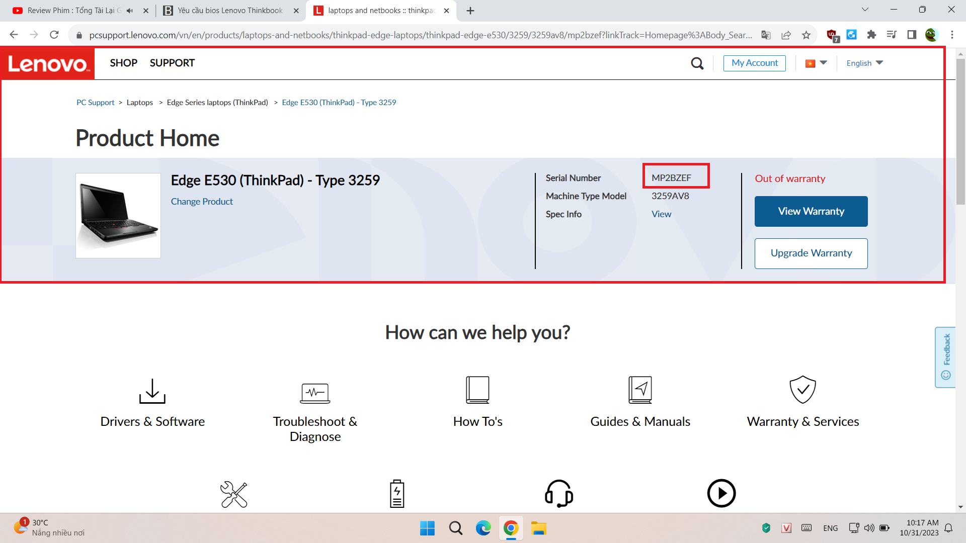

    Re: Lenovo Thinkbook 15 G2 ITL i5 (serial number: MP2BZEF) bios request
    Check the serial number again.

      Re: Lenovo Thinkbook 15 G2 ITL i5 (serial number: MP2BFZEF) bios request
      Sorry, the serial number is MP2BFZEF instead of MP2BZEF.
      Machine Type Model:20VE011AFR.
