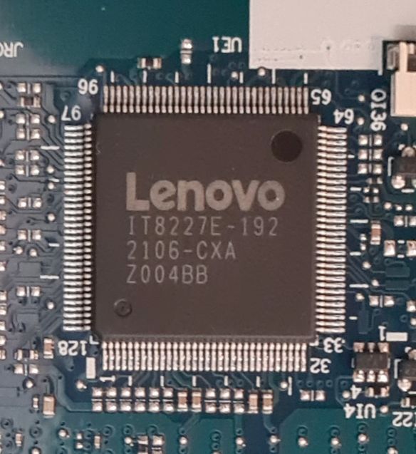

                                    #198
                                    legion 5-15ach6h
                                    sn PF2YWDN8
                                    Dead laptop, tracked the problem and it seems to be IT8227E-192 (see pic) shorted
                                    Can someone provide me with a new chip already programmed ? (for money of course)
                                    Hope not to be against rules
                                    TY
                                      • 22203
                                      #199
                                      Originally posted by pappothar
                                      legion 5-15ach6h
                                      sn PF2YWDN8
                                      TY
                                      You can buy pre-programmed ones at aliexpress and on ebay
