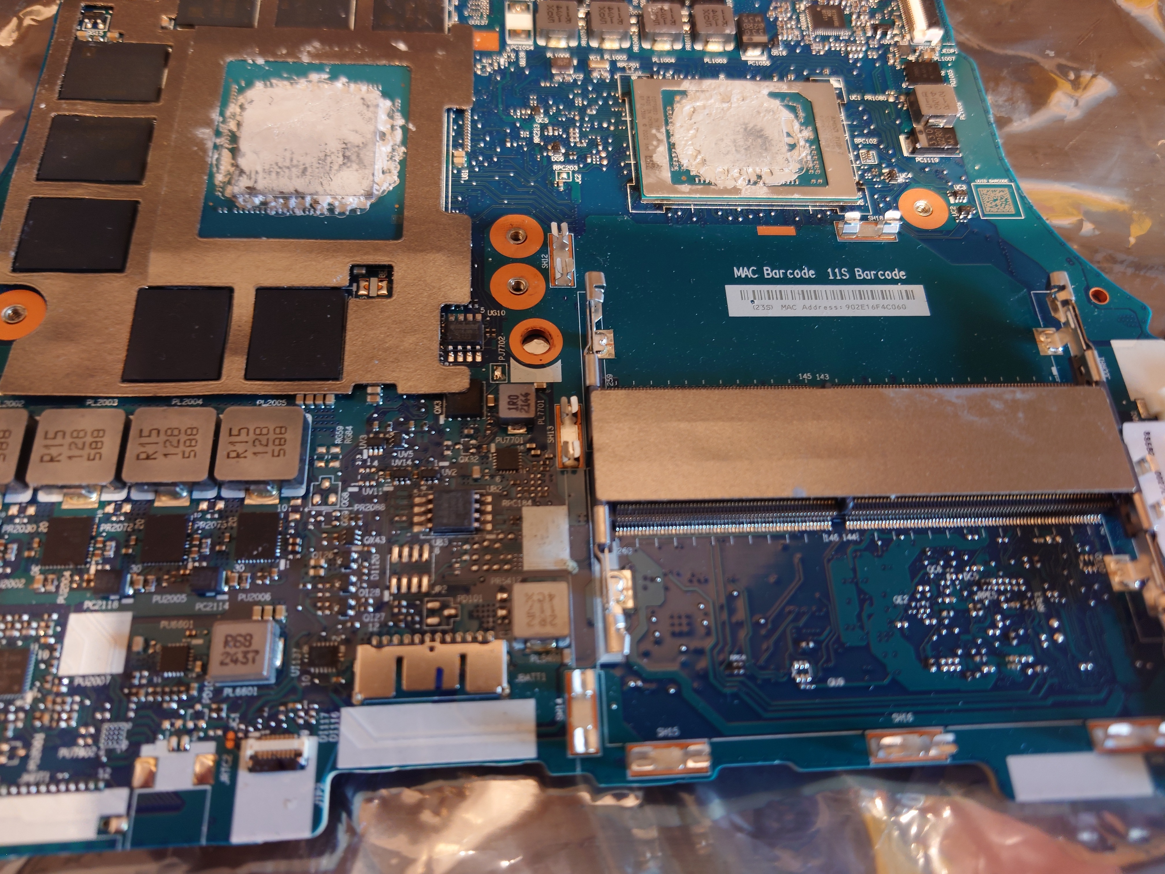

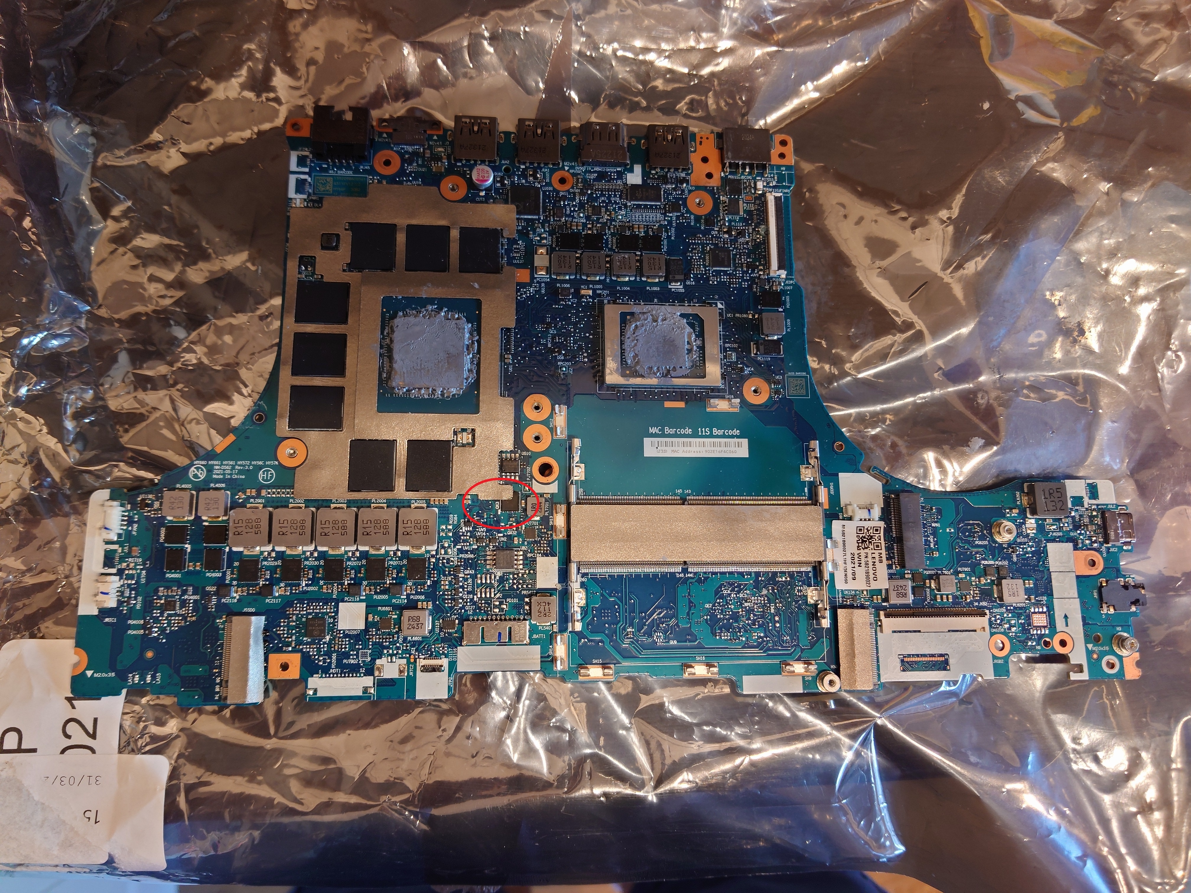

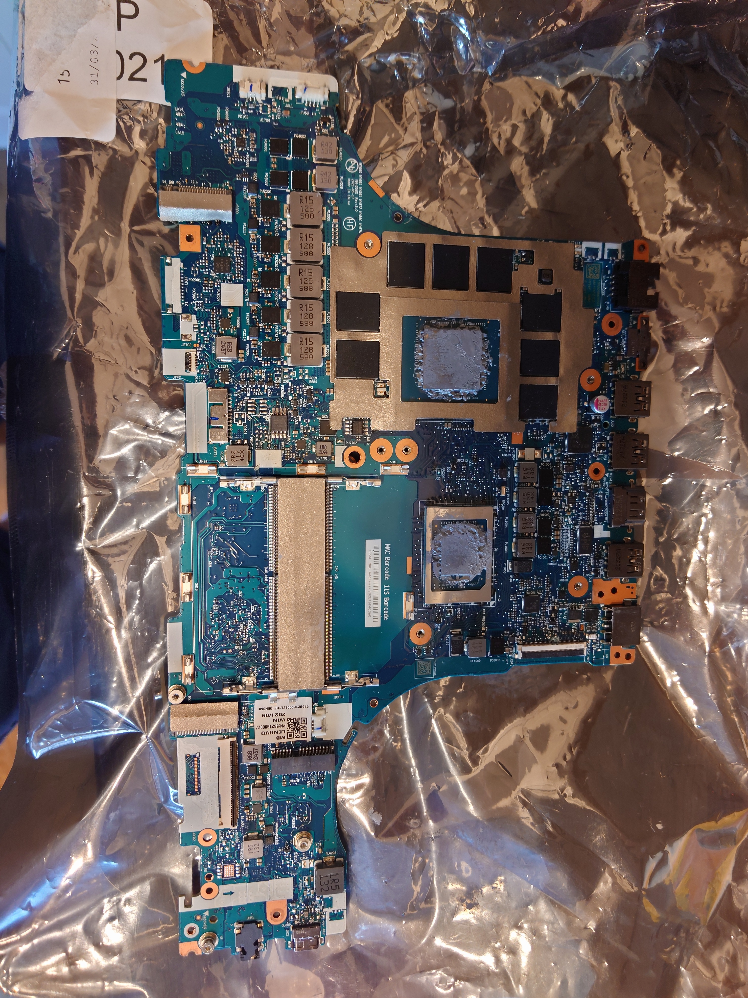

    Originally posted by kalilinux25
    please post a full image of front and back
    Please see attached thanks
    I assume it's the bottom of the 2 chips on the CPU side

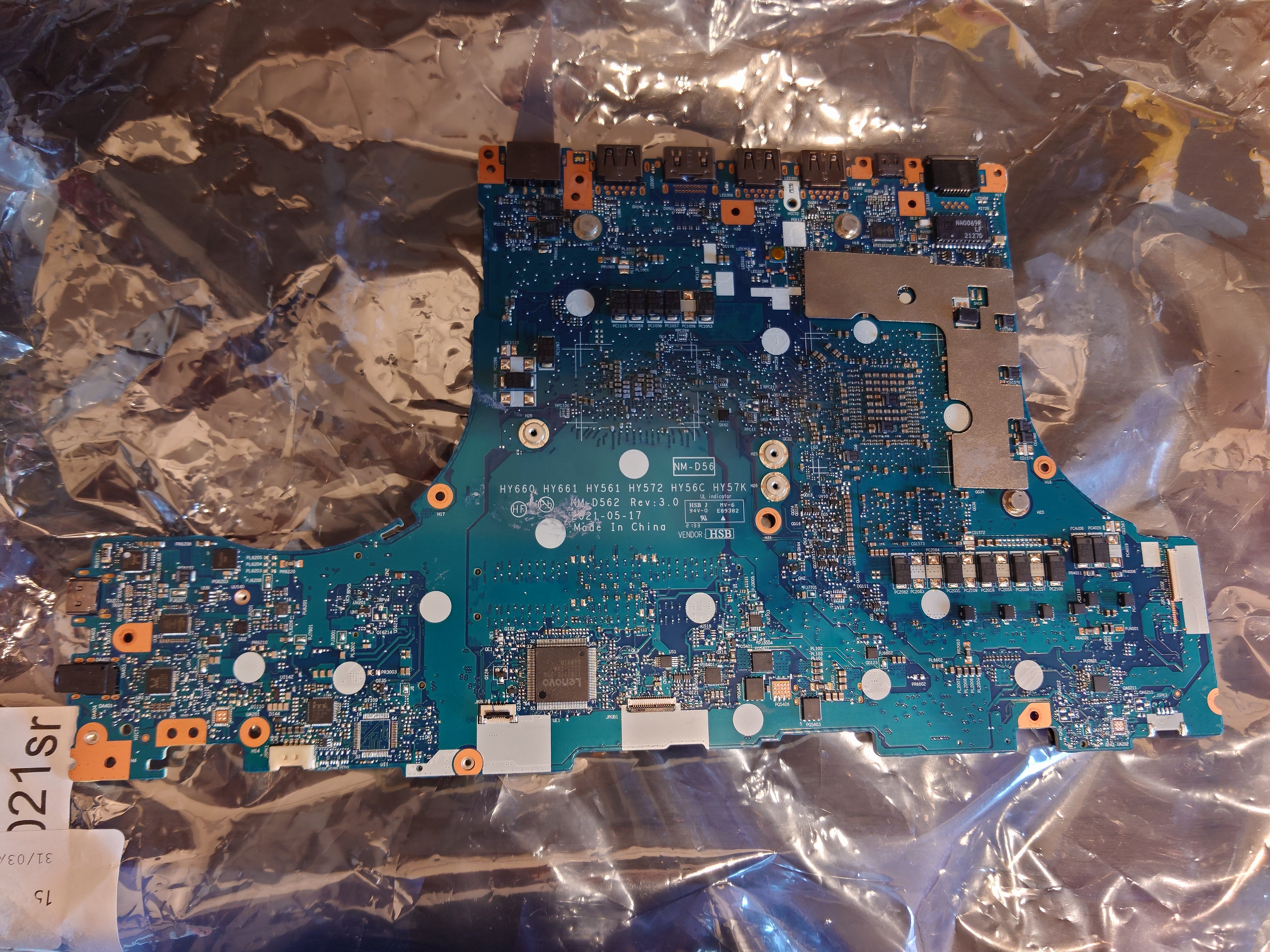

      #82
      Looks like labaled as UB3 and the up chup read and post the backup
      HY660 HY661 HY561 HY572 HY5C HY57K NM-D562 REV:3.0 2021-05-17

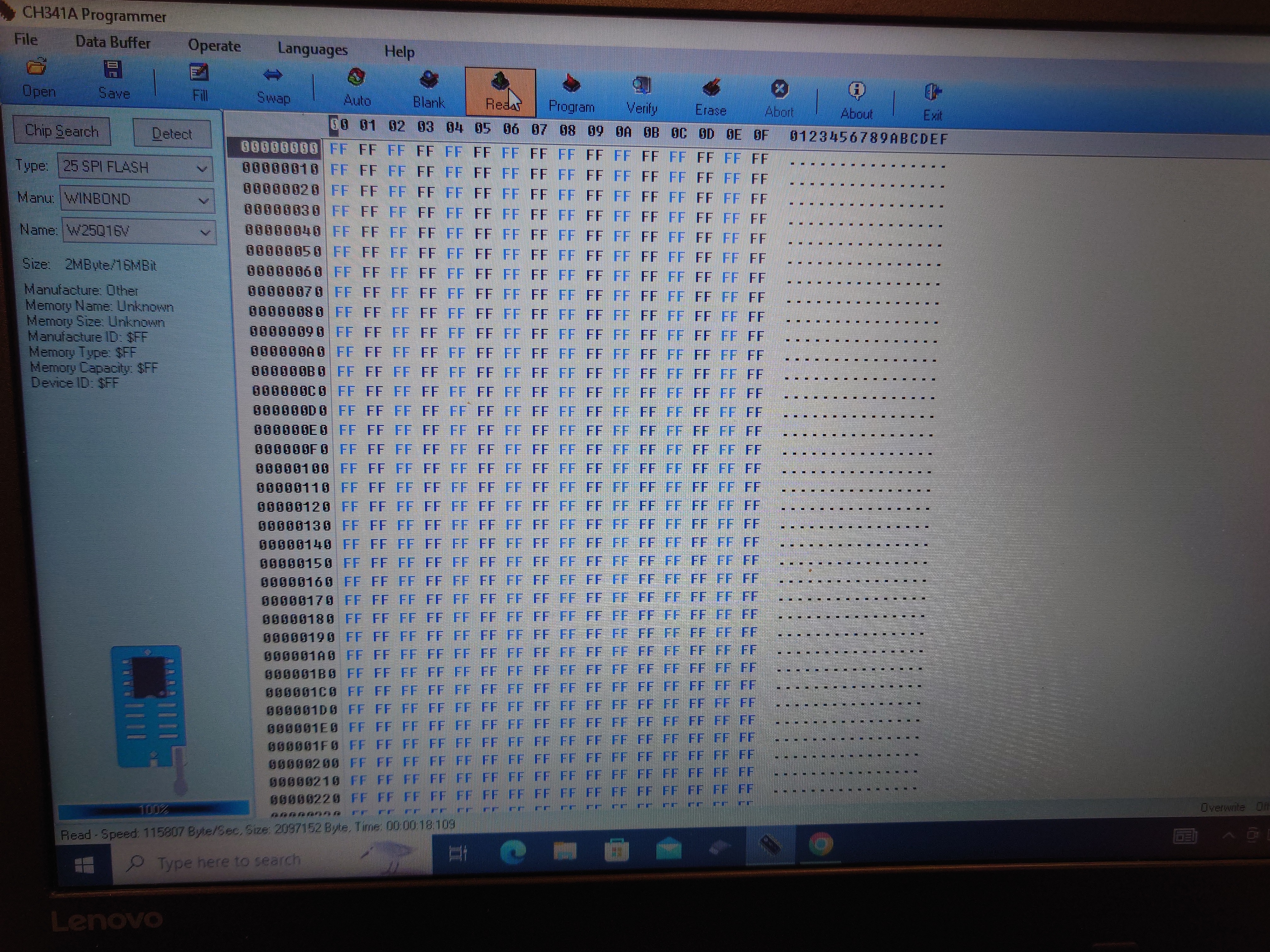

        #83
        Looks like labaled as U83
        Ok thanks ibreally appreciate that.
        Been trying again tonight to get it to work.
        Software seems to semi work for reading, but struggling with it about.
        Extracted the bin file from the .rar in post 5 but still says something about chip size etc.
        Do you know what I'm doing wrong?
        I'm perfectly fine on technical side software I'm not so good with
        Do I need the 1.8v adapter?

            #85
            please give me the model of the chip the two chip exaclty
            Hi Here are the part numbers
            Bottom circled one - Winbond 74M12JWSIQ. 2130
            One above it - Winbond 25Q16JWNIQ 2123
            Hopefully added a dump of circled chip

                  #88
                  Sorry for the delay, I have a spare motherboard that I'm testing on as I don't want to ruin my good board this is what my read looks like. Does this look ok?
                  its empty , you need to remove the chip then put it manually to the bios programmer maybe your using a clip?

                        #91
                        yes for better reading
                        Ok Thanks I finally received hot air tool and removed chip fitted it in an sop8 adapter,
                        Its actually read the chip and i have a .bin file,
                        How can i convert it to add it here as a dump file to be checked, This is my test motherboard at the moment so i don't break my good corrupted one till i know exactly what i'm doing.
                        Thank you for all your help
