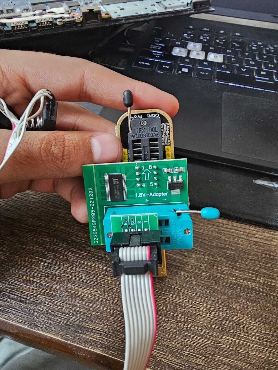

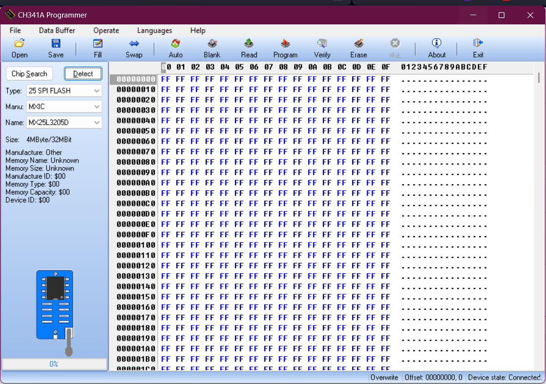

      Hi sorry took some time to receive the programmer. But it is not CH341, not CH341A what is the difference will both work on this laptop? I am trying to connect but it is not detecting the chip I tried multiple times but didn't detect maybe because of the programmer I couldn't find software for CH341 on Google the software's only for CH341A. Can you please help? The blow image is the software I am using
      • nobody19
        nobody19 commented
        Editing a comment
        I connected the clapping to the front and it worked

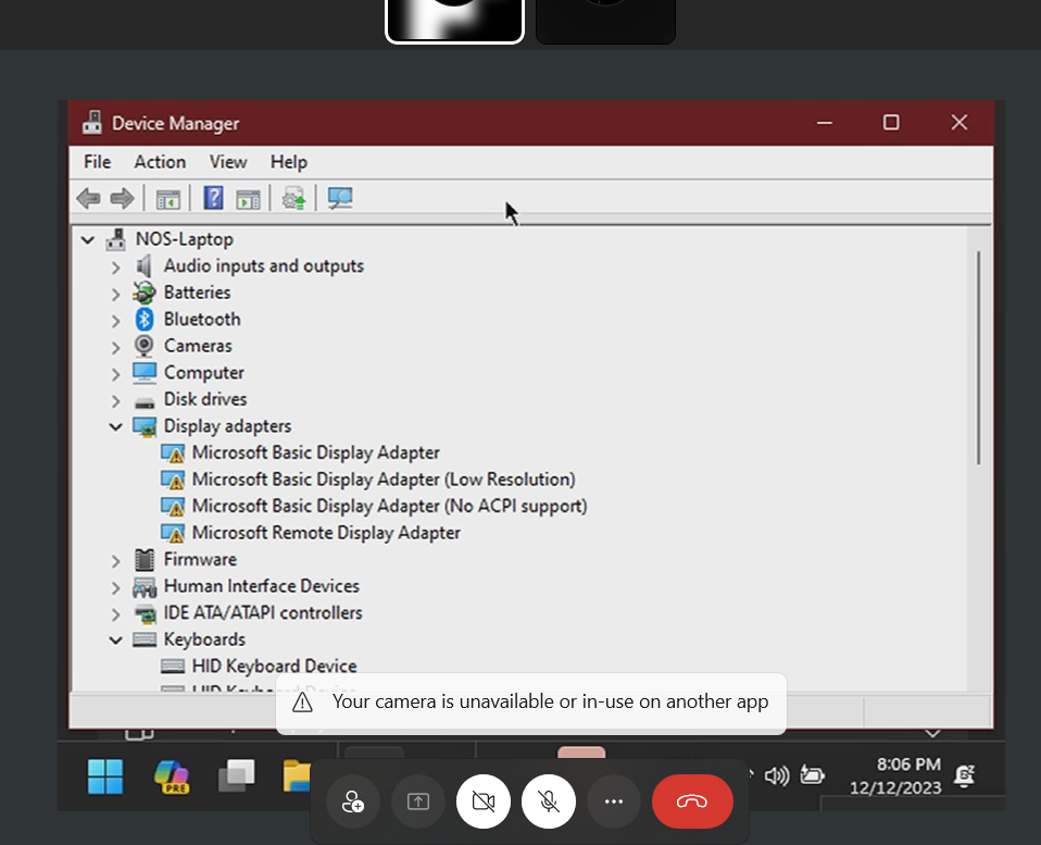

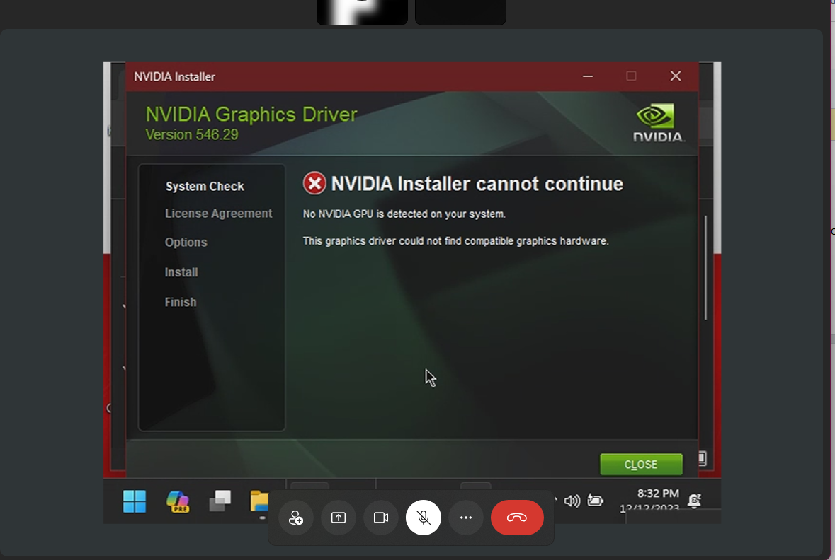

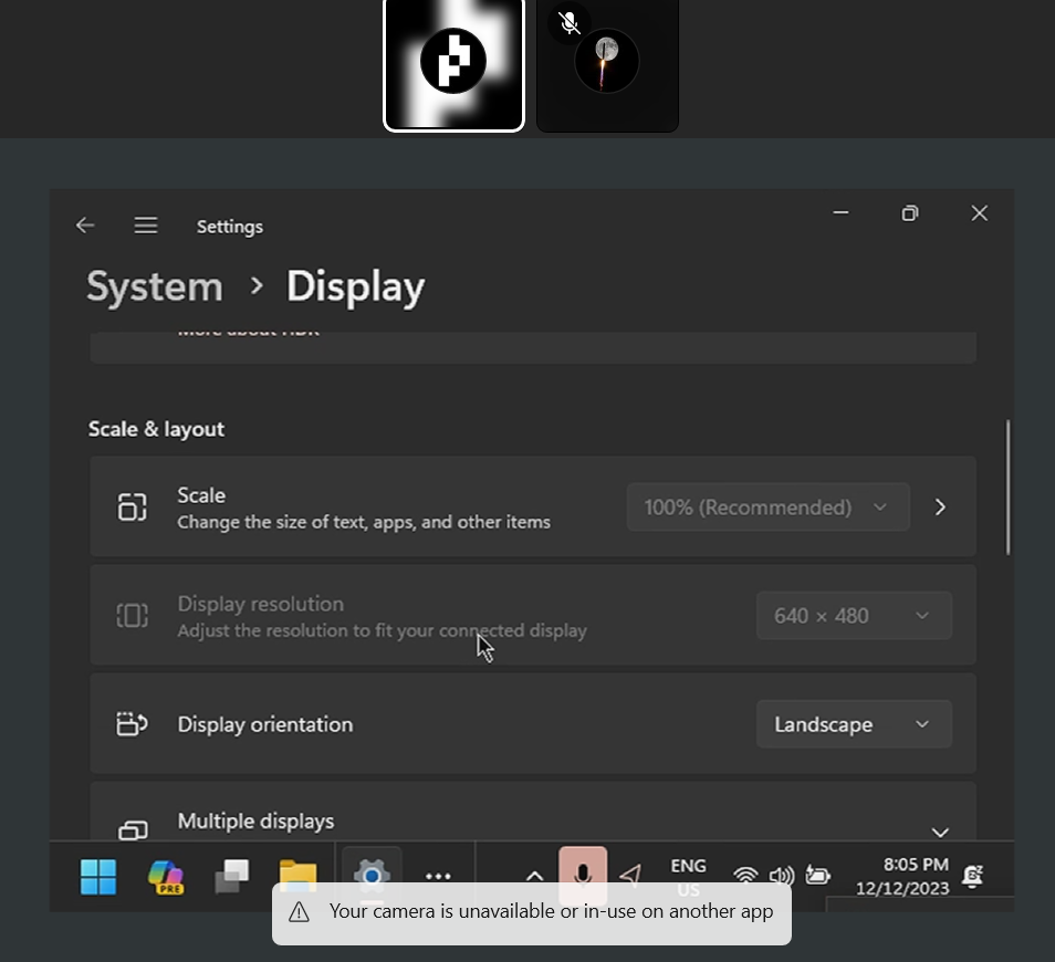

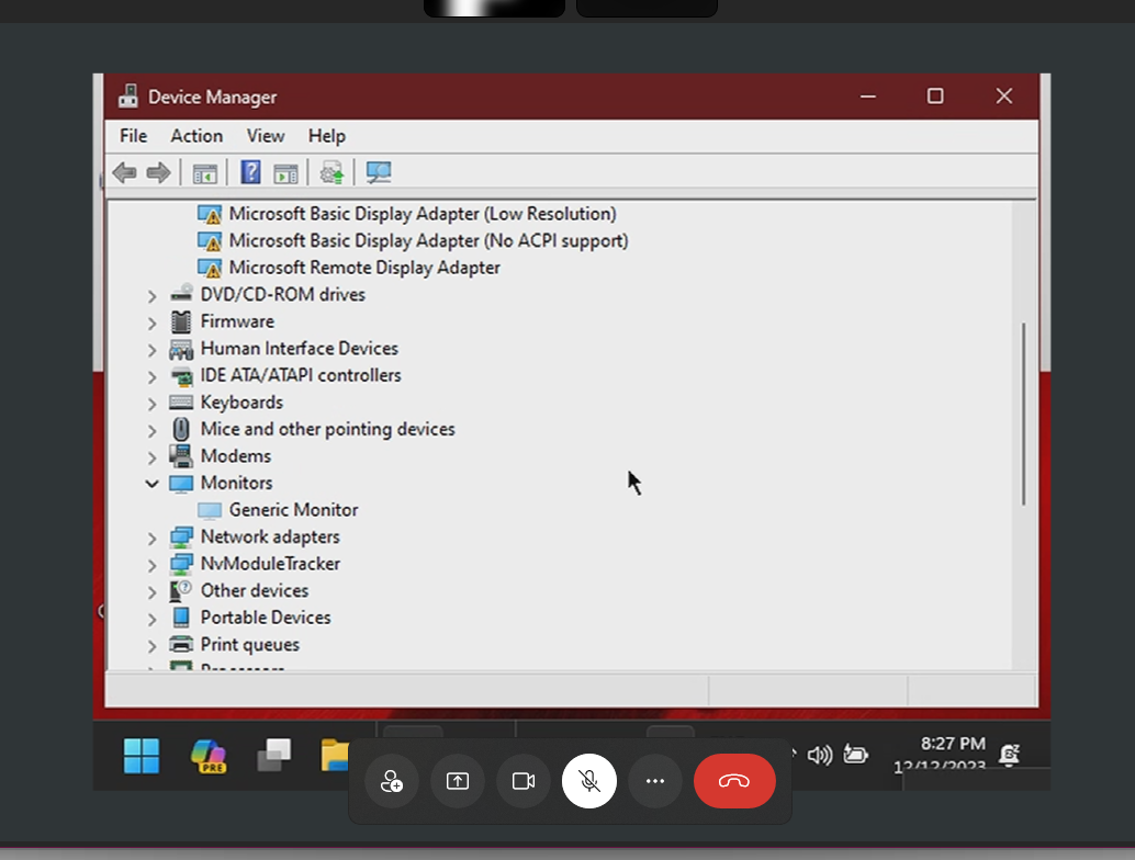

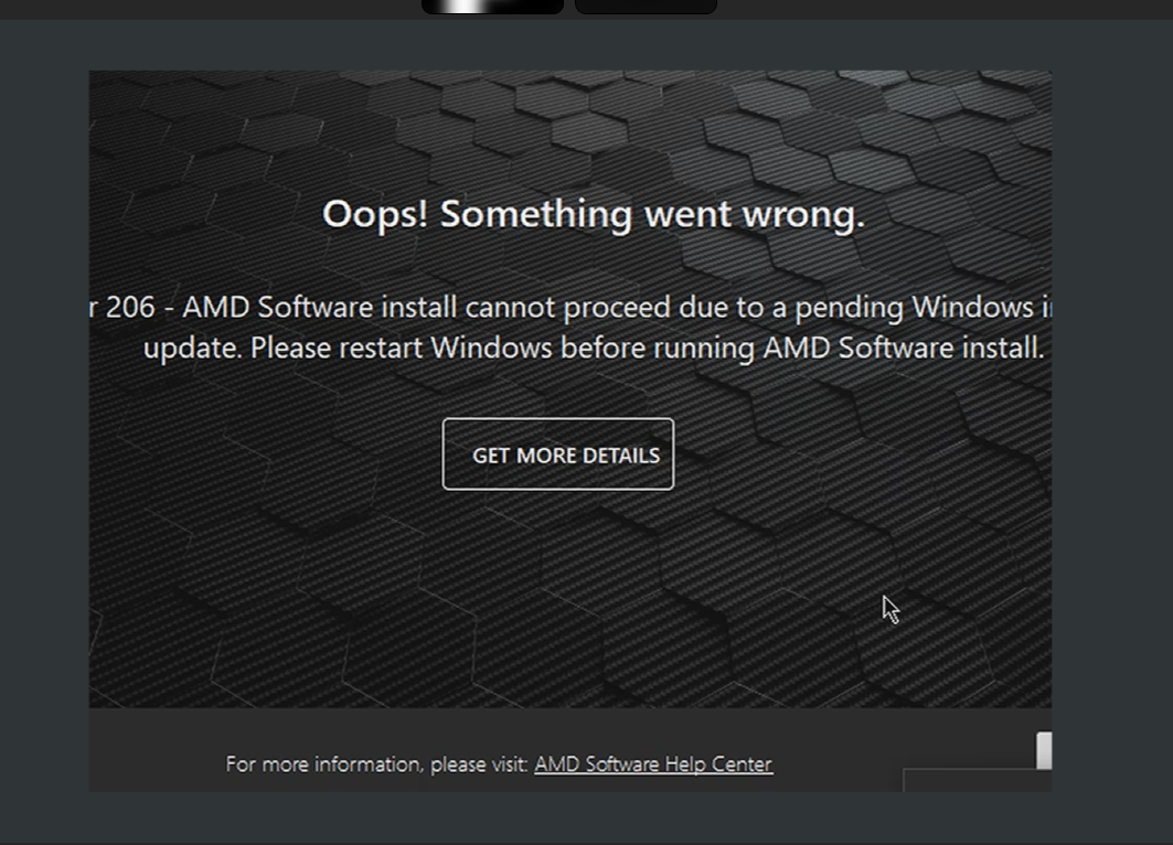

            The main thing is I managed to control the whole laptop using WhatsApp video calls and then sharing my screen. I updated all the drivers but nothing.
            You can see this in the below screenshots the resolution is 640x480 from WhatsApp screen share the main display is black nothing. I have full control over the window I can update/remove drivers the laptop stays on infinity after sleep.
            And in the device manager, there is no gpus detecting Nvidia and AMD raedion both are not there even in hidden devices.
            When I update readion and Nvidia graphic driver they show errors you can see below in screenshots.
            The GPUs are not been detected (Display adapters ) Check ss below
            The internal/external displays are not been detected ( Monitors ) check ss below
            And regarding the auto shutoff issues I don't have any idea what is causing it the window is different I copied my 2nd laptop window in the ssd. BIOS is reprogrammed thanks to you
            Nvidia and AMD drivers are failing
            Remember I am doing all this using screen share and sleep it before it turns itself off.
            Please help I searched the whole internet but couldn't find anything I tried everything even reprogramming the BIOS

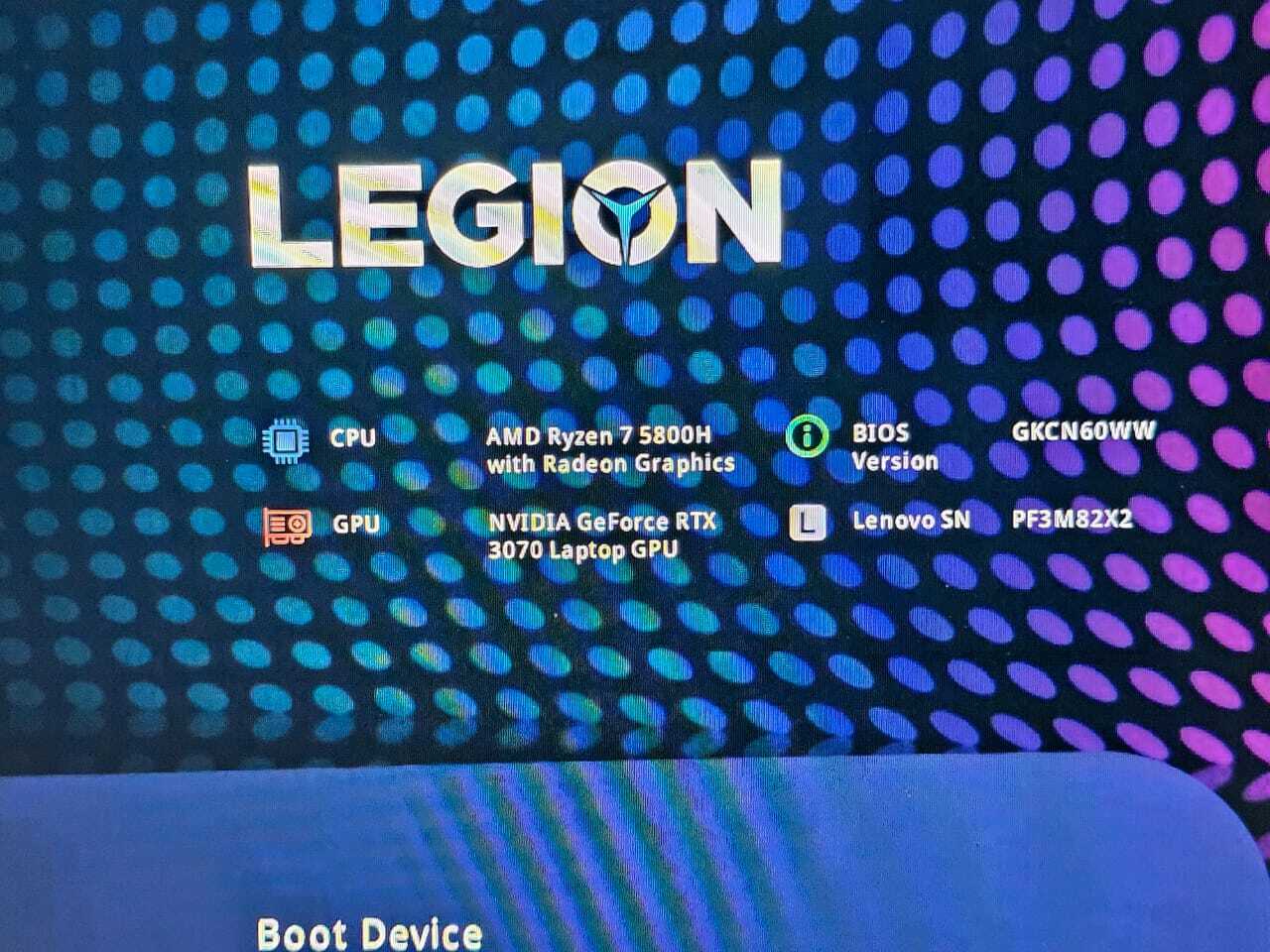

            Hi, I managed to turn the screen on just by doing random things in the window. But my Nvidia GPU is not working and I still have the auto shutdown issue

              #31
              what those the device manager say? maybe a error code 32?
              • nobody19
                nobody19 commented
                Editing a comment
                The GPU driver is not even on the device manager hidden device if I try to install it manuely nvdia shows me error "No Nvidia gpus is detected on your system"

                #34
                1st video is when I don't sleep on the laptop you can see it just shuts down. It happens everywhere BIOS, Windows Installer, Windows Recovery.
                2nd is after sleep. And you can my Nvidia RTX 3070 is not been detected even after uninstalling/updating anything. BIOS does detect the 3070 GPU(Image)

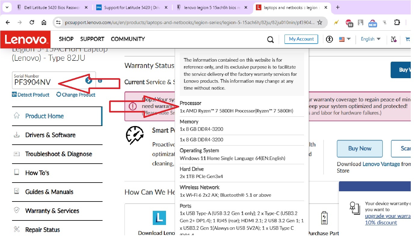

                  #35
                  Legion 5-15ACH6H Laptop (Lenovo) - Type 82JU
                  Serial Number - PF3904NV
                  Mother Board - nm-d562 rev 3.0
                  Hello, I need BIOS as my previous BIOS is corrupted.
                  Issue - When I turn the laptop on the Screen in Black, only the Keyboard lights up and fan spins and after a few mins everything turns off.
                  The Technician working on my laptop provided me these files linked below as BIOS dumps from my laptop.
                  As he is not able to fix or provide me with a new bios file, I am requesting here.
                  Any Question is welcomed and solutions too.

                      #37
                      posted bios doesn't match with laptop description
                      as per serial number laptop is AMD based cpu
                      Click image for larger versionName:	d.jpgViews:	0Size:	251.3 KBID:	3200725
                      • qayyum786
                        • Aug 2018
                        • 1959
                        • INDIA
                        #38
                        Serial Number :- PF3904NV
                        Bios extracted from Lenovo Support
