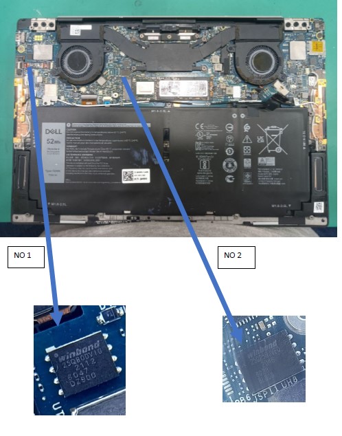

            #45
            Re: Dell XPS 9310 GDA30 LA-J143P bios repair please
            [ATTACH]307528[/ATTACH]
            [ATTACH]307529[/ATTACH]
              Originally posted by shah05
              Doc1.pdf
              "Do not touch the 25Q80xxxx chip"
              https://www.badcaps.net/forum/showth...58#post1236358
              25Q256xxxx is the bios spi chip.
