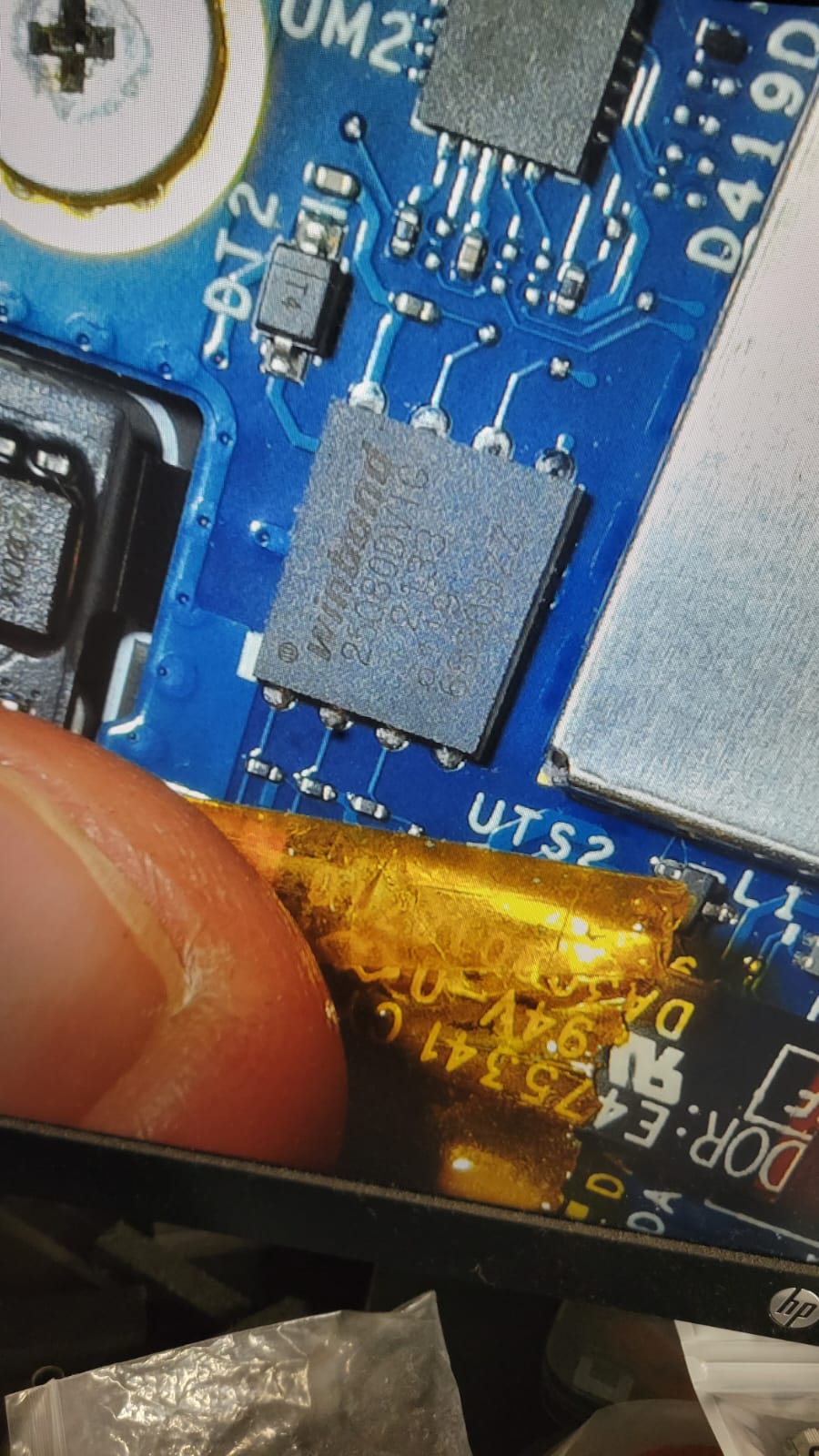

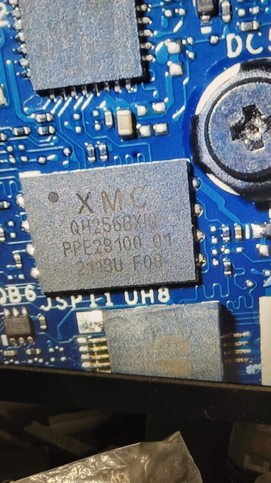

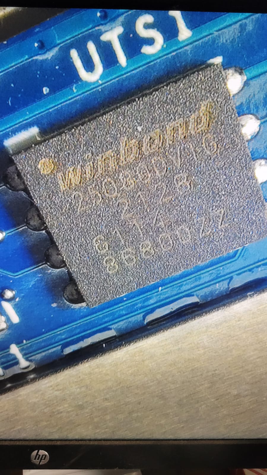

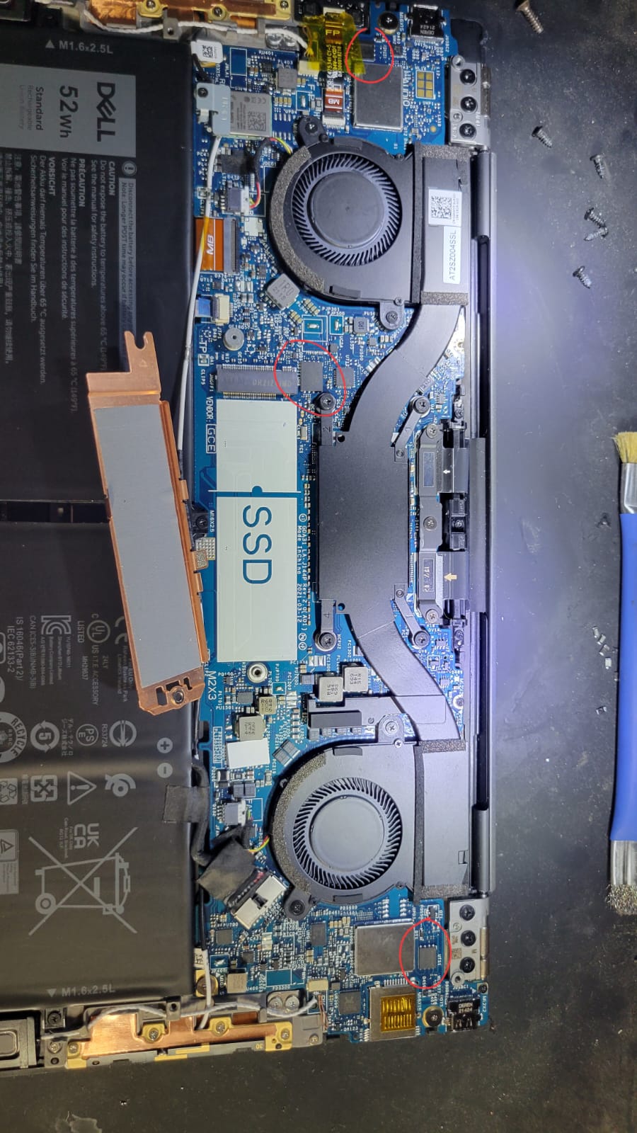

            Re: Dell XPS 9310 GDA30 LA-J143P bios repair please
            Hello, Total NOOB here.
            Sorry in advance if I'm wasting anyone time.
            Got a Dell XPS 9310 with a corrupted Bios.
            Service Tag : B5BCBK3
            Getting a bit of experience in micro soldering and board repair but never flashed a bios.
            What programmer should I purchase to start ? (TL866ii or etc...)
            Found 2 x winbond and 1 x XMC 8 pin chip, that I think it could be the bios chip.
            I've attached photos of what I found.
            Once I order and receive the programmer, I could desolder the bios chip, read it and upload it I guess.
            Thanks again for your help.

              We will need the content of that Chip (XMC/QH256) to fix it and stay away from the Winbond Chip.
              Read that Post to know more about Programmers and how to take a Backup:
              https://www.badcaps.net/forum/showpo...40&postcount=2
