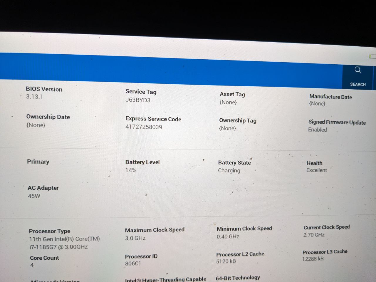

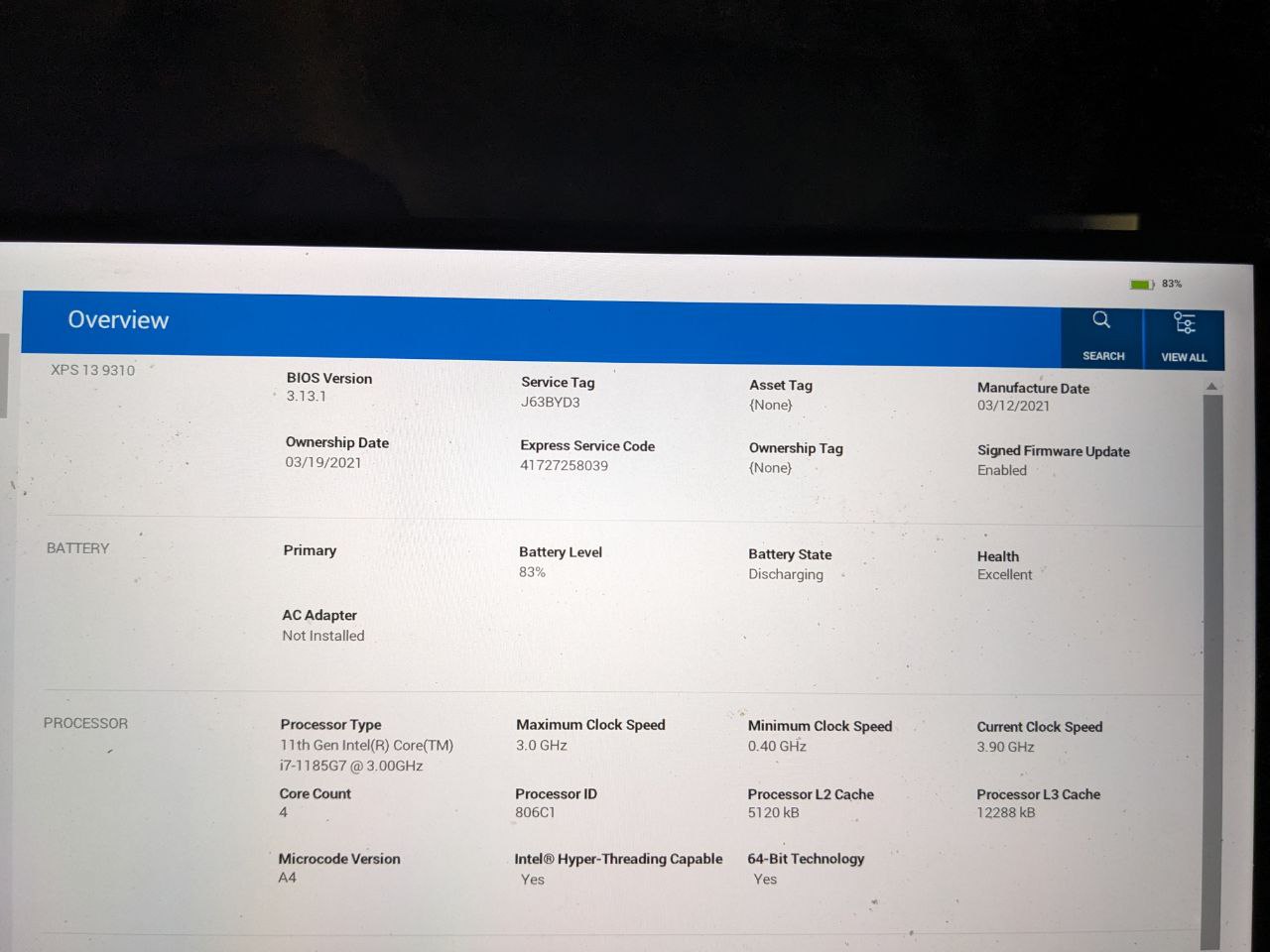

                #87
                Re: Dell XPS 9310 GDA30 LA-J143P bios repair please
                Hello hoaca388,
                I think you may have uploaded the wrong bios as it still has all the asset details from hardware1 original bios and not my asset details.
                I've attached a screenshot of what exactly I see.
                  #88
                  Originally posted by himmon View Post
                  Hello hoaca388,
                  So strange? I have already replaced your DMI block. Are you sure service tag J63BYD3 belongs to hardware1.
