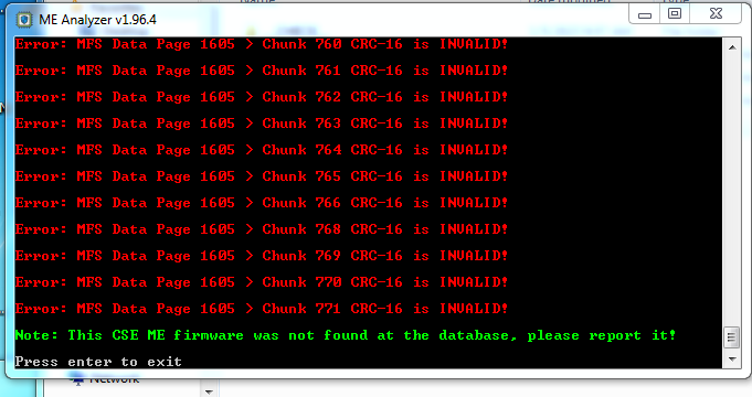

    Re: MS Surface no touchscreen after cleaning ME Firmware **FIX**
    Originally posted by Penetre
    after an official firmware update, the surface me must be corrupted.
    does not finish installing the firmware update, error Code 10. the touch does not work.
    The BIOS has never been touched, the only thing I have done is change all the hardware parts, LCD, Flex, touch plate...
    I think that I would only have to modify in the bios, so that the touch is activated.
    You havn`t mentioned the model number.If the flash descriptor is locked you will need an SPI programmer to backup the whole bios.
      the model is a surface 6 pro 1796. I have to desolder the BIOS chip, right?
      I have tried to boot from a USB efi Shell + ru.efi. It turns on correctly, but I don't know how to use it.
      is it impossible to get a dump from there?

        • 22109
        I'm sorry if my questions are silly, I'm still learning on this subject.
        You will have to use an SPI programmer.If the chip is a WSON type (no legs on the chip,soldered flat) you will need to desolder it and use a WSON adapter board,or use a WSON8 pogo adapter
        https://www.badcaps.net/forum/showth...ght=WSON8+pogo
        https://www.aliexpress.com/item/1005001830846980.html
        https://www.badcaps.net/forum/showpo...40&postcount=2

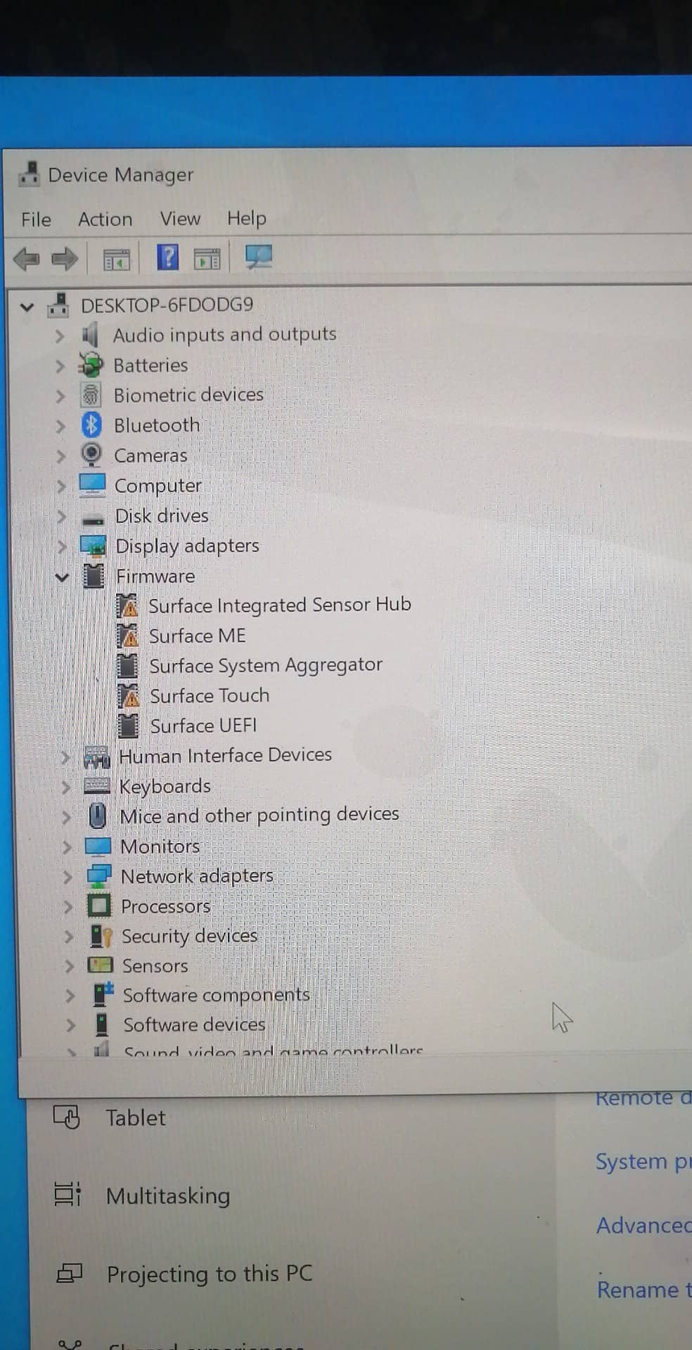

                                    • Lgatom
                                      • Jan 2023
                                      • Brasil
                                      #38
                                      Good afternoon, I have a Surface Pro 4 with the Touch not working and the error in the device listing, for the solution according to the procedure described above would I have to access the BIOS memory physically or would there be some software to be used?
                                      • hoaca388
                                        Badcaps
                                        • Jan 2022
                                        • 12419
                                        #39
                                        You have to access the BIOS memory physically by a programmer.
