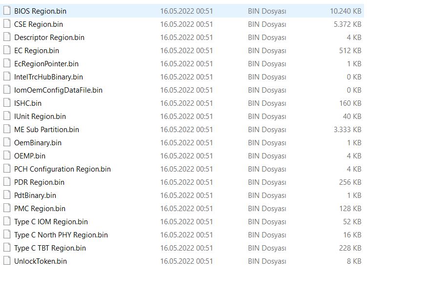

                Re: MS Surface no touchscreen after cleaning ME Firmware **FIX**
                Which file in pro 7 needs to be changed for me region cleaning?
                Premium supporters get full download access and other benefits.
                  • 22878
                  ME Sub Partition.bin .It is the ME firmware.The new PRD_RGN firmware from the repository must be renamed to: ME Sub Partition.bin .If you can`t find the same PRD_RGN version use the nearest older or newer one.
                  Follow the win-raid guide "D4. CSME 11 - 15 & CSTXE 3 - 4"
                  https://winraid.level1techs.com/t/gu...zation/31277/2
