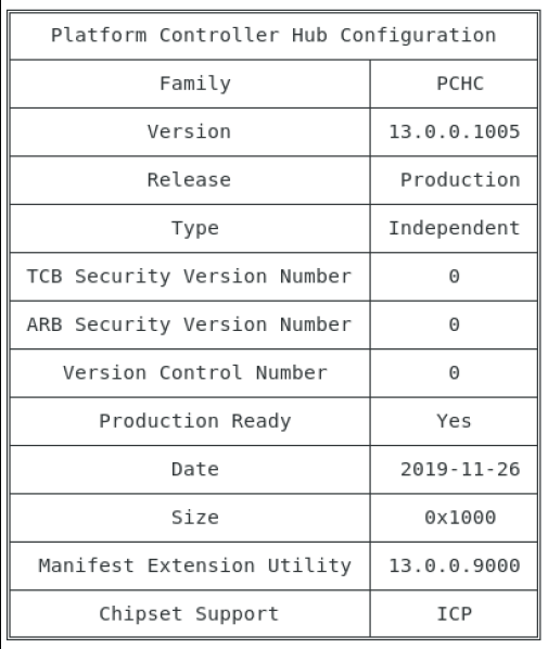

                    #229

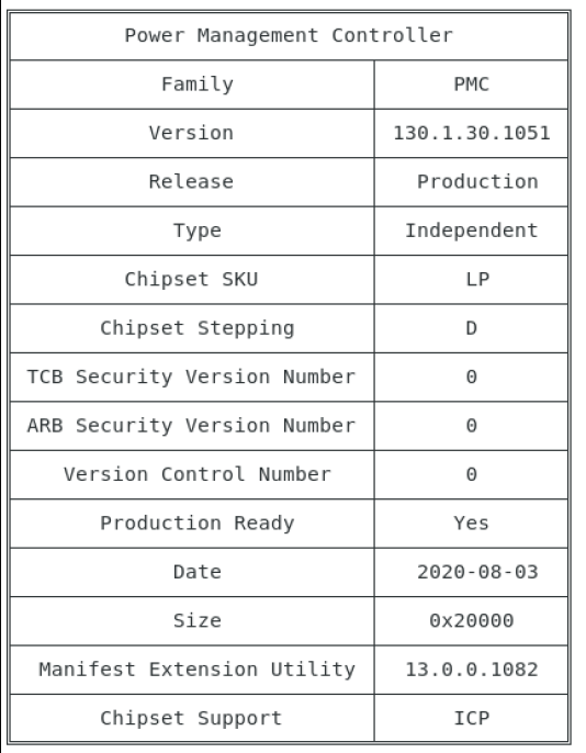

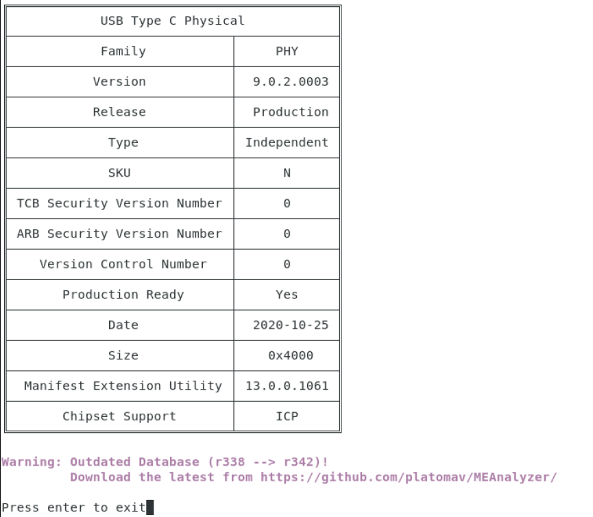

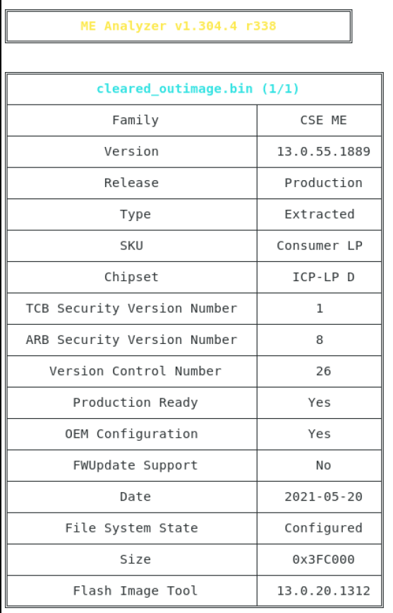

                    Please clean ME/TXE region in BIOS.
                    Microsoft Surface Pro7 i7/16/1024 1866 tablet shows the logo for a few seconds and goes to reboot.
                    The tablet worked normally and after the update it did not turn on.
                    I soldered the bios, read the dump. I manually cleaned the ME region and saved the bios. After that, the Windows logo appears not for 3 seconds, but for longer, about 20 seconds, and goes to reboot again.
                    ​Please clean ME region in bios, because maybe I'm doing something wrong due to lack of experience.
ID:	3217444 Click image for larger version
ID:	3217445 Click image for larger version
ID:	3217446 Click image for larger version
ID:	3217447 Click image for larger version
                    what means "manually cleaned the ME"? Replaced ME Region with UEFITool, or what?
                    • blcksmthprnt
                      • Nov 2023
                      • 14
                      • Ukraine
                      #231
                      I opened the dump that I downloaded from bios using "Intel (R) Flash Image Tool. Version: 13.0.20.1312"
                      disabled the option "build->build settings-> GenIntermediateFiles NO"
                      clicked save bios in the program
                      renamed the file "13.0.55.1889_CON_LP_D_PRD_EXTR.bin" to "ME Sub Partition.bin" and replaced file "ME Sub Partition.bin" in the folder "Decomp"
                      Click "Build image"
                      write and verify to chip winbond 25r128jwpq
                      soldered the chip back to the motherboard
                      after that, instead of 2..3 .. seconds, the tablet turns on the logo for 40...55 seconds and cannot boot. Only the logo is visible. and after a few minutes of the boot loop, the processor cooling fan starts spinning. power on the USB port does not appear (before that it appeared for half a second)

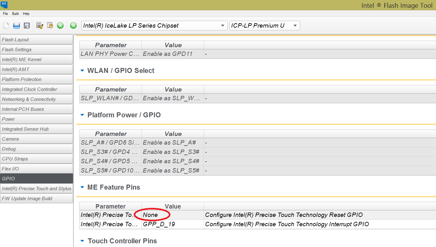

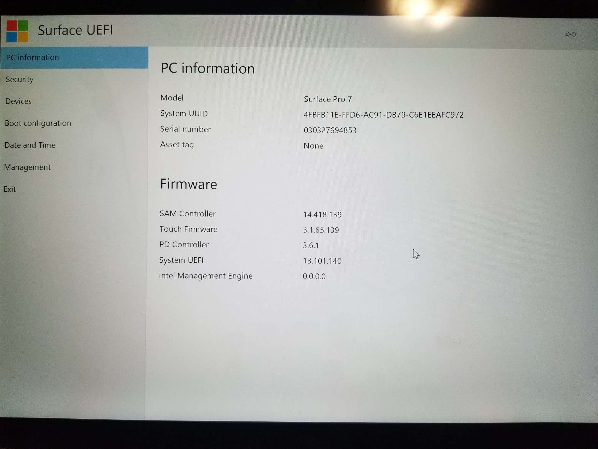

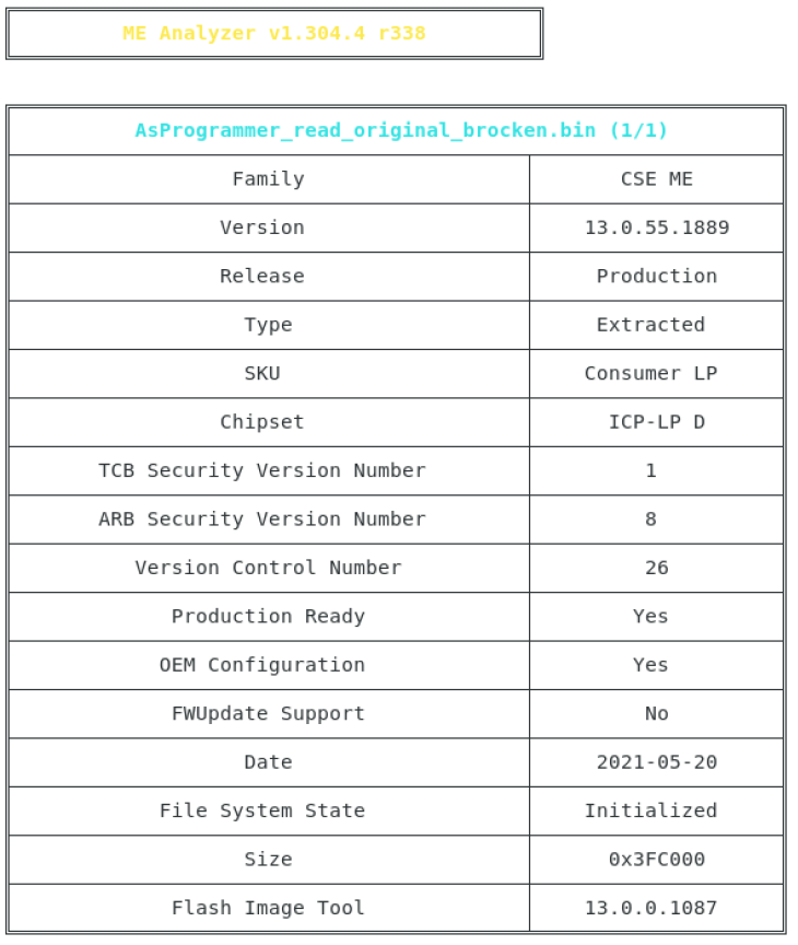

                      model:1866
                      SN: 030 327 694 853
                      board: JALAMA_ICL_MB DV:10B
                      Please help to edit the bios, or tell me where to go next.
                      problem at the moment:
                      - the tablet takes a very long time to load (about 1.5 minutes to get into the bios interface)
                      - the touchscreen does not work
                      - there is no "Intel Management Engine" firmware
                      Click image for larger version  Name:	1708191106306.jpg Views:	0 Size:	121.6 KB ID:	3218445
                      A short story:
                      After the update, the tablet has a boot loop every 3 seconds. Only the logo is visible for 3 seconds. I can't enter UEFI, I can't boot from USB.
                      I read bios backup 1_AsProgrammer_read_original_boot_loop.rar
                      I opened this backup in the program "Intel (R) Flash Image Tool. Version: 13.0.20.1312"
                      replaced that file "ME Sub Partition.bin" with this "13.0.55.1889_CON_LP_D_PRD_EXTR.bin"
                      and made a build 8_outimage.rar
                      Now the tablet takes a long time to load, in about 3 minutes I can see the Windows recovery page and I can see the files on the SSD to choose where to recover Windows from. From this we can conclude that the SSD is working
                      Click image for larger version  Name:	1708192244406.jpg Views:	0 Size:	119.6 KB ID:	3218448
                      it looks like the tablet is physically working, and there is no damage to the hardware.
                      Please tell me what to do next?

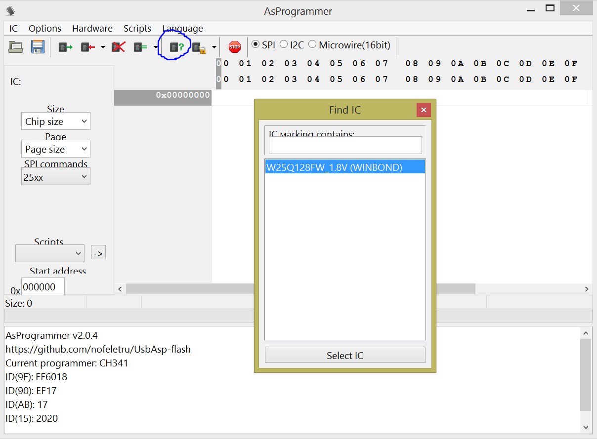

                          What programmer are you using? Because my CH341 programmer reads this bios for about 3 minutes and writes for about 23 minutes.
                            I have CH341, that was my first one. Then I had RevealProg, it's very good but fragile.... and now RT809F, this one is really really good and stil cheap.
                                model:1866
                                SN: 030 327 694 853
                                The touchscreen does not work after cleaning the ME region
                                What I did:
                                The tablet does not load, only shows the logo for a few seconds. I cleaned the ME region (with Intel (R) Flash Image Tool. Version: 13.0.37.1556) and got no noticeable result. Then I cleaned ME region and disabled only one option
                                ME Feature Pins: TouchResetGpio value="GPP_D_14" -> TouchResetGpio value="None" (Configure Intel(R) Precise Touch Technology Reset GPIO)
                                The tablet started up, Windows updated the bios, but the touch screen does not work either in UEFI or in Windows.
                                I compared the bios settings (xml via winmerge-2.16.38) with other bios from similar tablets and all the options are identical. Only when i change this option TouchResetGpio value="None" then the tablet turns on.
                                Who knows what this option means and how I can repair the touch screen?

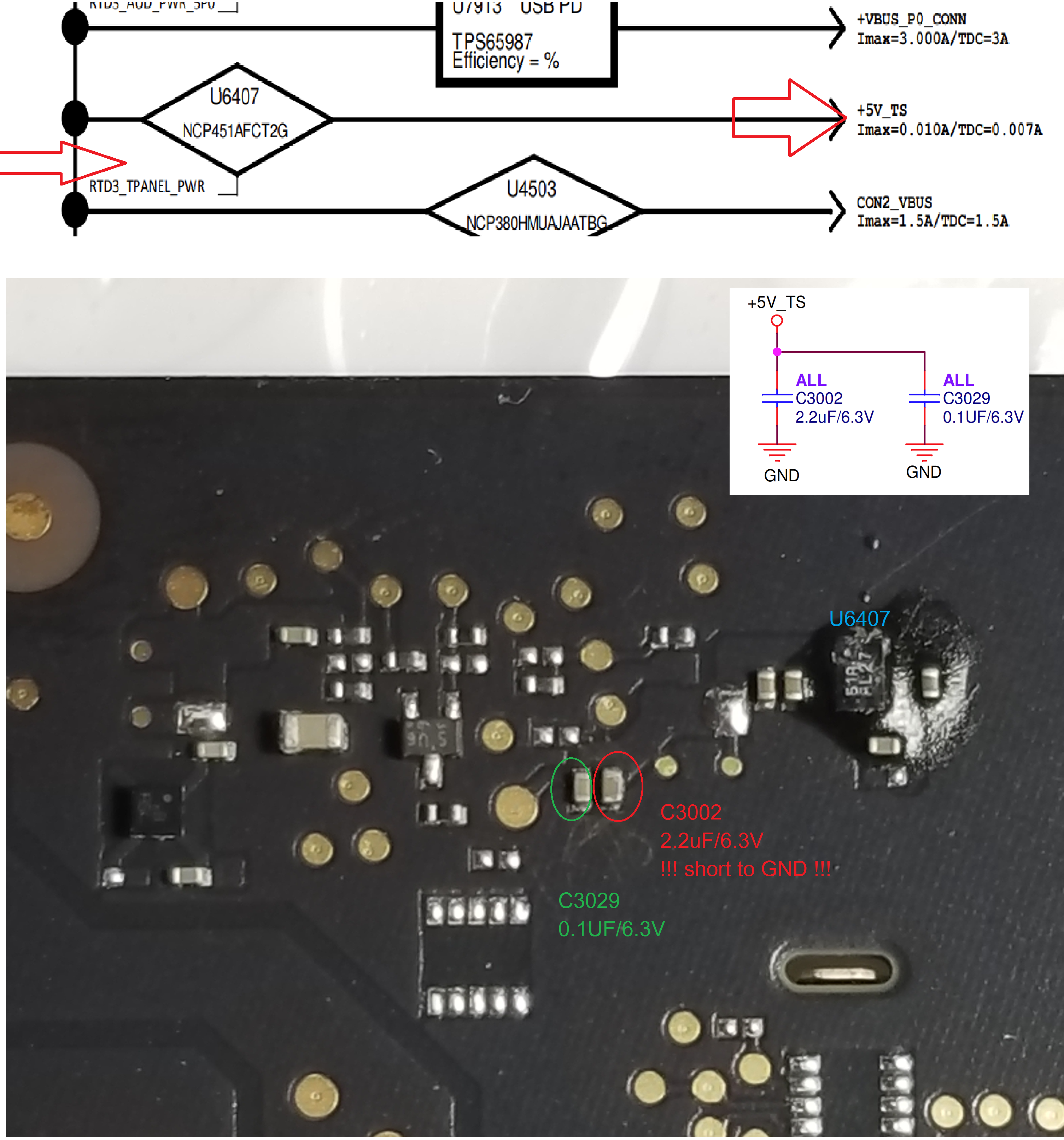

                                  #238
                                  model:1866
                                  The issue is resolved!
                                  The error was always in the hardware and not in the bios!
                                  I understood that if I turn off GPP_D_14, then the tablet works, but if I turn it ON, then i get boot loop. I started looking for where this contact goes according to the schema motherboard_surface_pro7_1866.zip
                                  the tablet had to be a boot loop because the capacitor always shorted +5 volts to ground.
                                  GPP_D_14 -> RTD3_TPANEL_PWR -> U6407 -> +5V -> R6417 -> C3002 !!! has a short circuit !!!
                                  I replaced the C3002 with a good one and everything worked.
Name:	touch screen short.png
