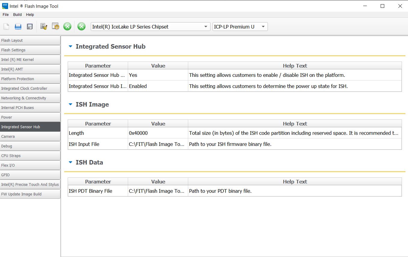

            initially i had single touch problem after update. edited the working bios on the site with fit, but the touch did not work. The original and edited files are attached. Could you help

                  My device has a multi-touch problem. When I modified other bios, the touch did not work at all. I just want your touch fixed.

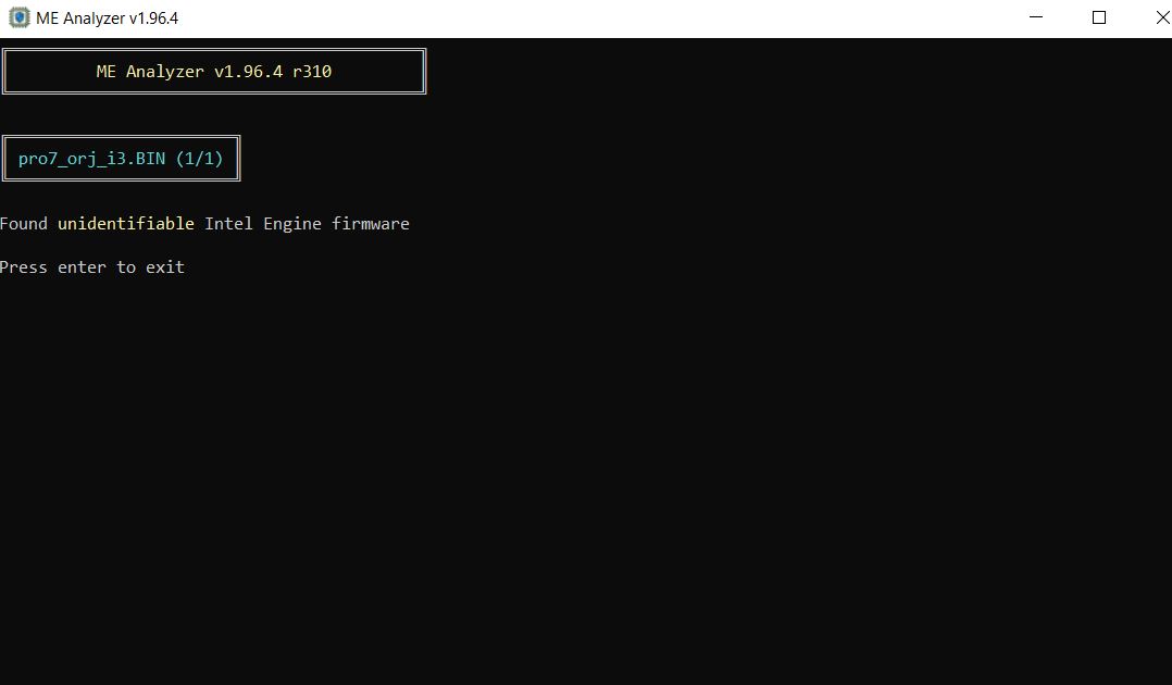

                      Thanks for your answer, but there doesn't seem to be a problem with the FIT settings. But Me analyzer gives an error
                        Your (ME Analyzer) is very old, search for a new version and use it.

                          Database latest version DB r310 . No problem in other pro 7 bios
                          Modified bios, touch firmware does not update even if the system is powered on. A short update text appears at the beginning but it does not update.
