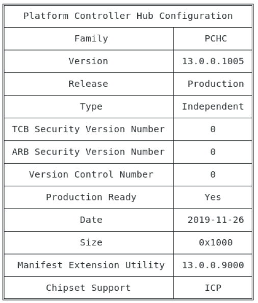

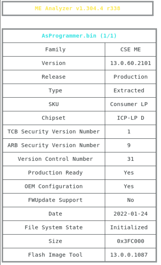

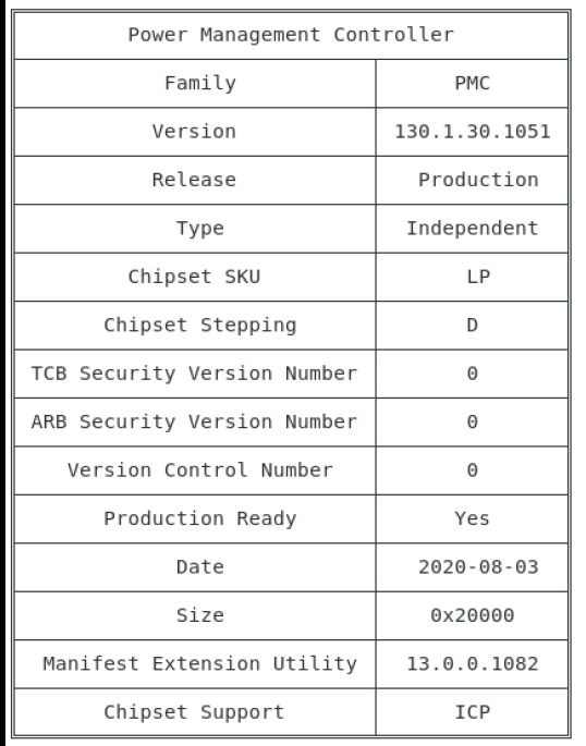

 My problem is that the Microsoft Surface Pro7 i7/16/512 1866 tablet shows the logo for a few seconds and goes to reboot.
 I bought it on eBay and have never seen it in working order.
 I checked the motherboard Jalama_DV1.0B volts in various places according to the schematic and everything looks fine.
 I looked at the board through the thermal camera and did not find any element that heats up except the i7 processor which heats up and
 cools down while the Windows logo flashes for a few seconds.
 I unsoldered the bios winbond 25R128JWPQ and read it using a CH341A programmer (in fact with a CH341B chip) with a 1.8 volt adapter
 Using AsProgrammer_2.0.4 I selected automatic chip detection w25q128fw_1.8 and read the dump

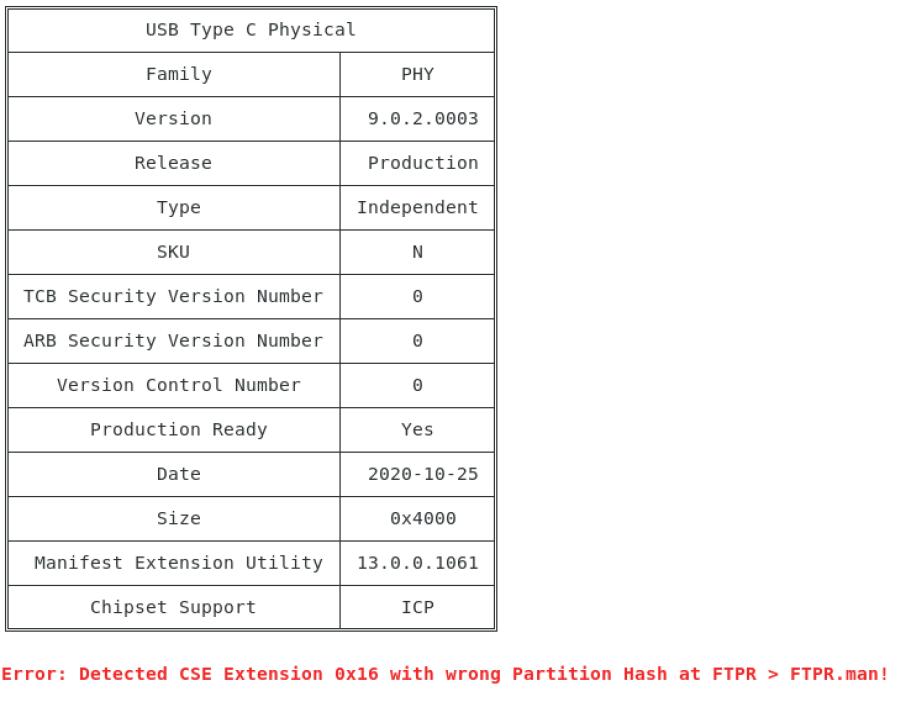

 Using MEAnalyzer-1.304.4-r338 I got information about the bios, but then I don't know how to clean ME/TXE region and whether I read the
 dump correctly. I also got an error "Error: Detected CSE Extension 0x16 with wrong Partition Hash at FTPR > FTPR.man!", and I don't know,
 maybe this error is the problem that my tablet doesn't boot.
 Please tell me what to do next, or fix my bios if this is the problem in it.

 try your bios with cleaned MEAttached Files----------------------------------------------------------------------------------------------------------------------------------------------------------------------
 ----------------------------------------------------------------------------------------------------------------------------------------------------------------------Comment-
 Thank you! Everything works! on the second attempt.
 The first attempt I cleaned ME region myself. soldered the bios to the motherboard. BUT!! I did not put the radiator on the processor!!! I think the processor overheated and went into protection, but the Windows icon appeared for longer and the tablet noticeably warmed up.
 I soldered the bios. I read the data from it and saw that it had changed.
 Attempt number two. I wrote your bios. Assembled a tablet with a radiator. The programmer pushed into the USB port to see if the light would light up. (to understand that power appears on the USB port). it was necessary to wait about 20 seconds and the tablet turned on. (USB power also came on) I was able to get into the UEFI bios. But Windows was not loaded through Bitlocker.
 I turned off the protection in the bios. Inserted a recovery flash drive. Installed Windows. And for now, I will finally glue the tablet with the hope that it will work.
