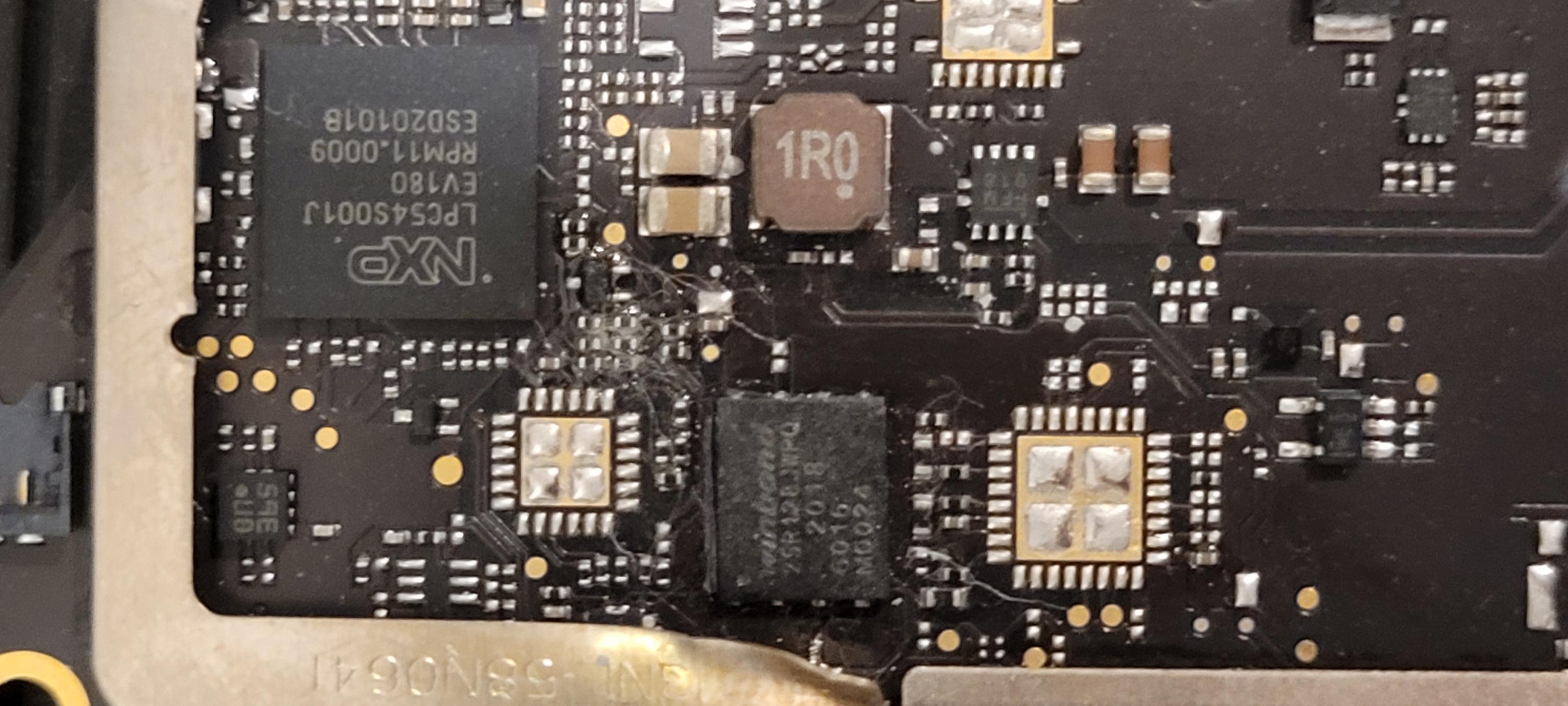

    I have a similar problem Lulinha - updated the bios week ago, then it was stuck in a logo loop (turns on for a few second and then off). After cleaning the ME region it still persists, with an exception of the logo being displayed only a second instead of two.
    I wonder if the corrupted update destroyed something else in the bios other than the ME region and that's why replacing the ME with a clean one won't help.
    The surefire way would be (I assume) to take a working bios from other Surface and adapt it to our models (not sure what are the other device specific variables besides a serial number / computrace), but I am not savvy enough to do that yet. Can't find a software to edit those variables or a place in the bios file where I could change them manually with a hex editor.
    If anybody has any tip for more resources regarding this, please let me know. If I will find a way to fix my bios I will update with a solution.

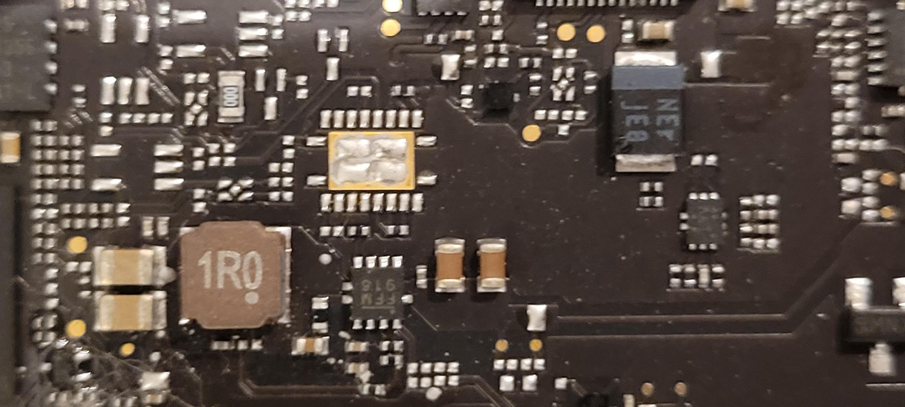

      I have a bootloop with a BIOS chip, and even without a BIOS chip, can it be that something else is defective?

        maybe some components are missing, can someone compare that with their own motherboard.

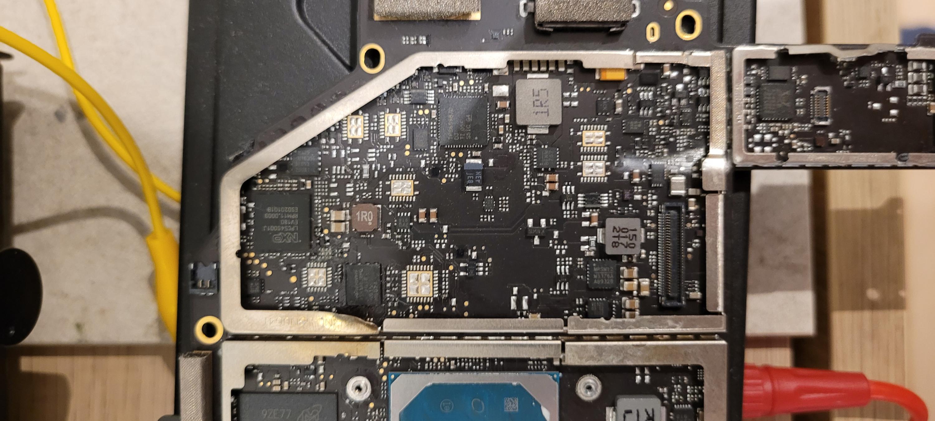

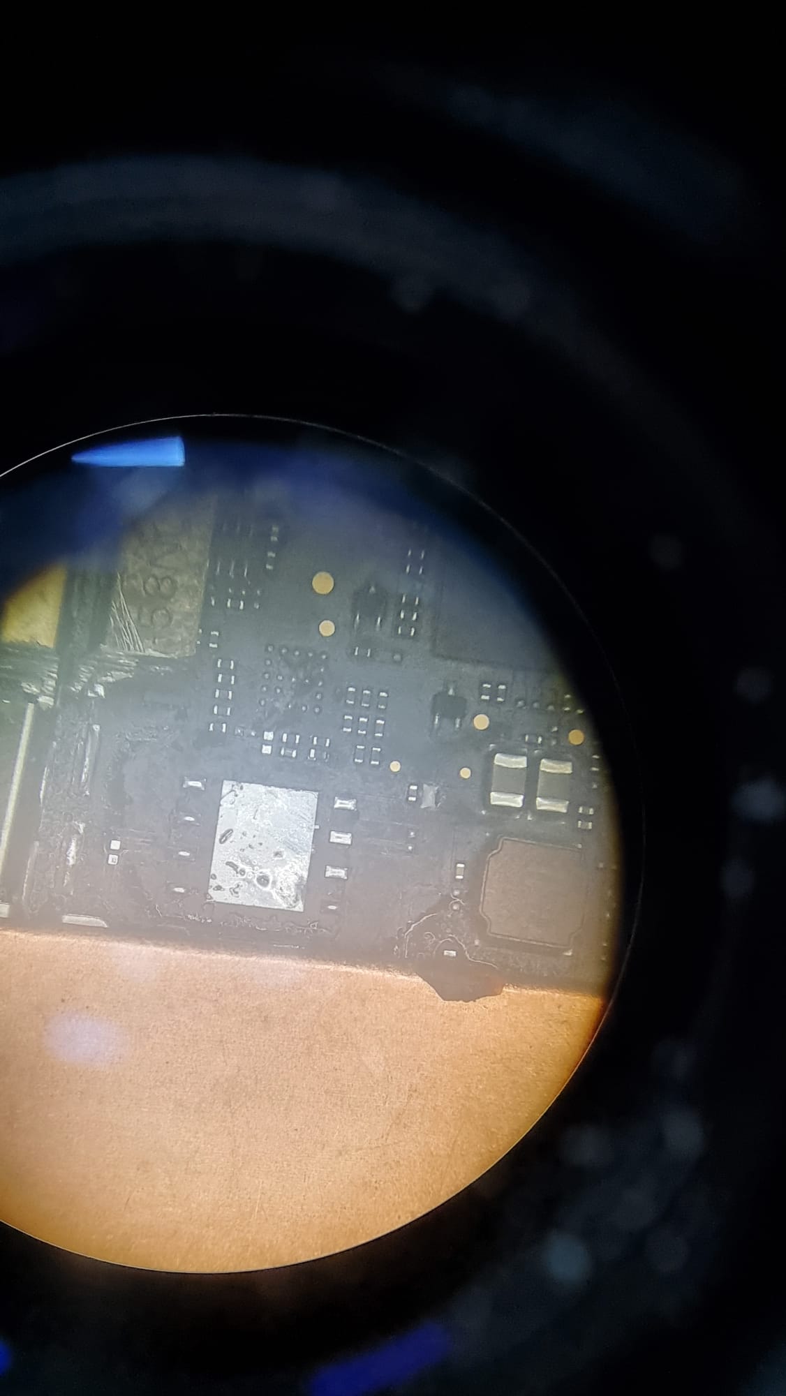

          I have a different revision of the board, but let me check anyway and take photos. Will update as soon as I am back after a dog walk. Can you remove the headpipe and check also under it?

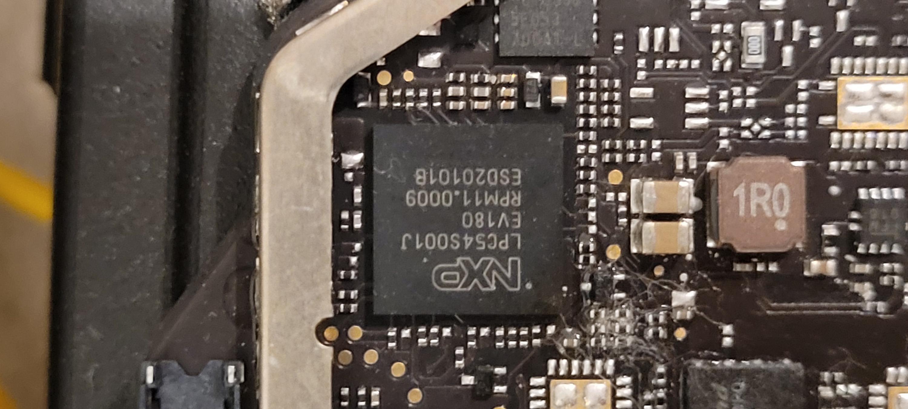

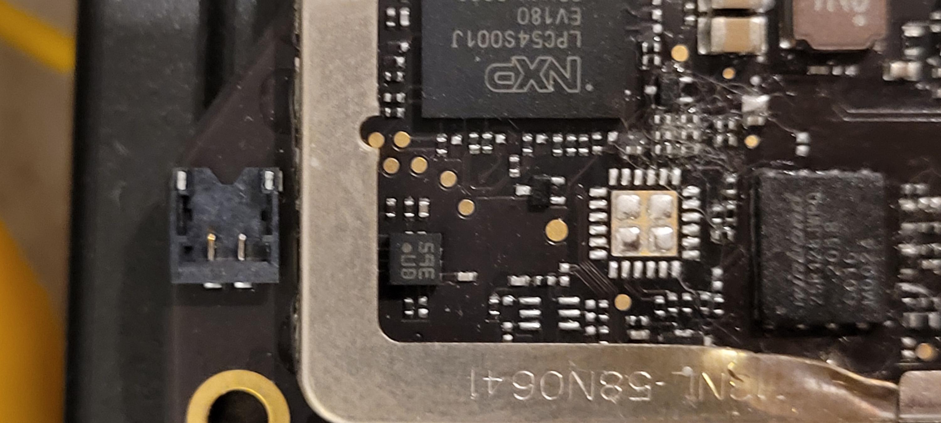

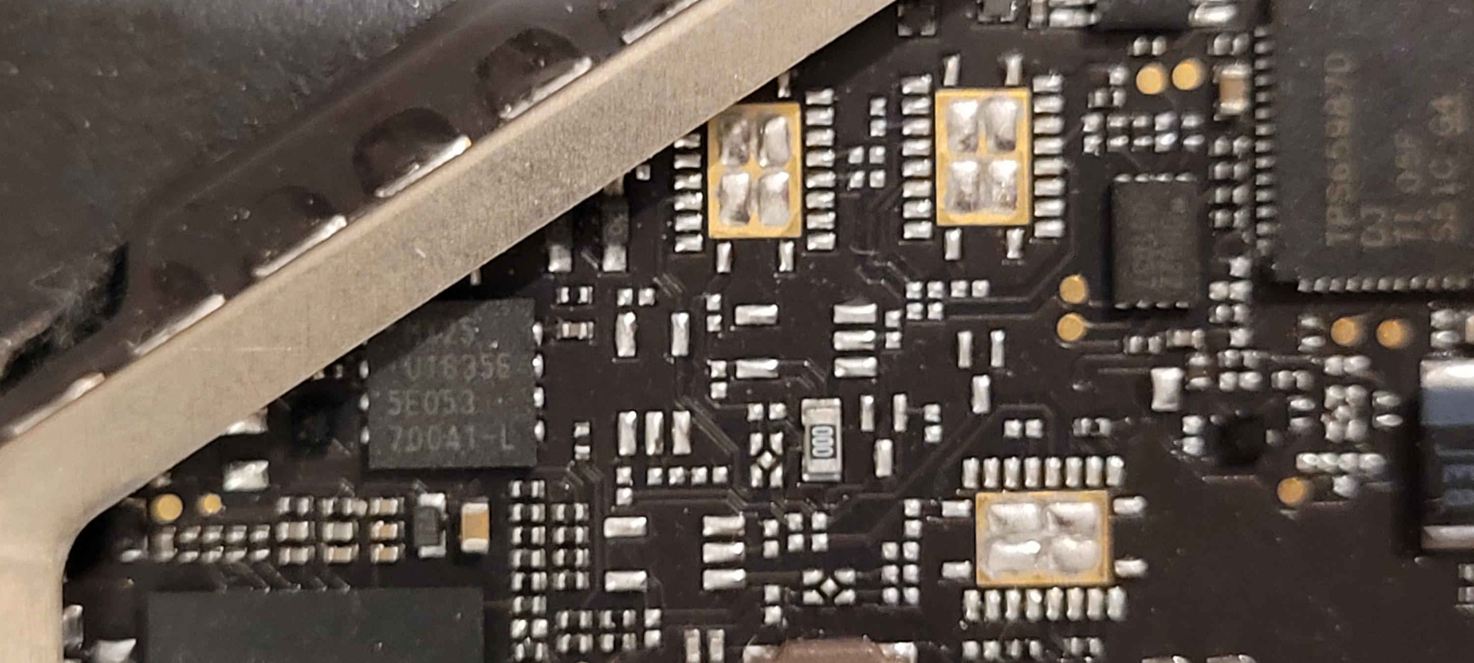

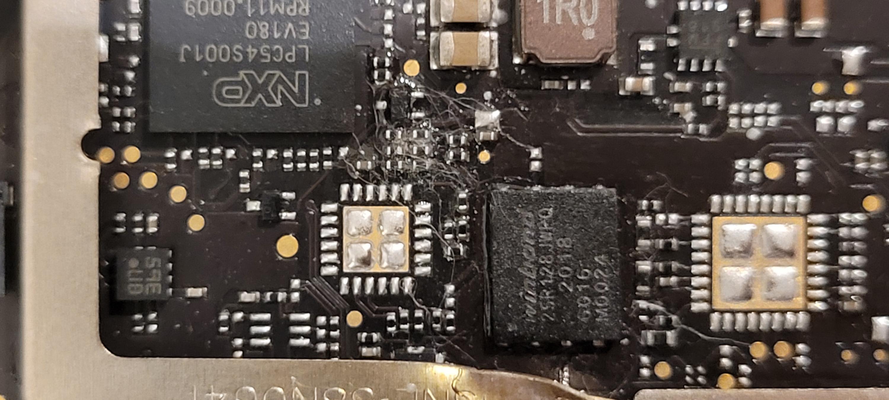

            Here it is. Let me know if you would like photos of anything particular. I can take them with a microscope.
            EDIT: Sorry about the fluff. Have to ultrasonic it later.

              Does anybody have a working dump of the SAM bios? It has it's own flash memory (MX25U1635EZUI) which might be the culprit in this case.
              I checked the signals and it seems as if the SAM is not even attempting to enable the phase for the CPU. It enables the logo to be displayed, turns on the backlight and then craps out.

                UPDATE: My theory is that during a bios update the PMC region got corrupted to a point that the PMC can't turn on the Surface properly anymore. Without turning on the main CPU it can't get a new (uncorrupted) update from the main BIOS flash for the suplementary PMC flash, because updating of the PMC flash needs the main CPU to be active to access the main bios flash.
                I will try to grab the PMC region from the known good bios and write it to the PMC bios flash manually. Let's see :-)
