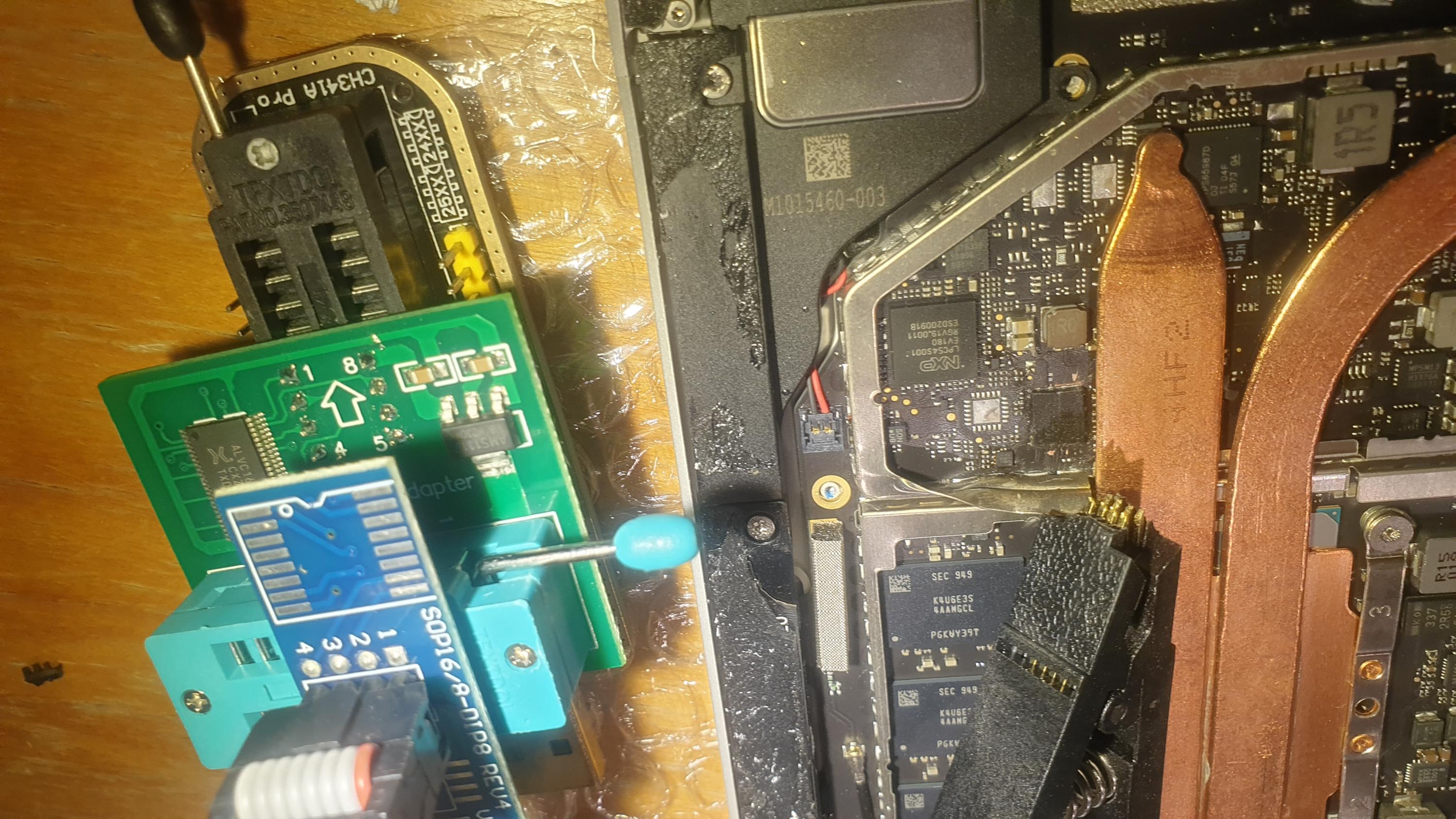

                                    I have two SP7's - both power up for 2 seconds then shut down.
                                    I have CH341A programmer, with 3.3v mod and 1.8v adapter
                                    Thanks in advance,
                                    • Prott
                                      • May 2022
                                      • 154
                                      • Czechia
                                      #158
                                      Re: Microsoft Surface Pro 7 NEED BIOS. HELP!
                                      Hey mops,
                                      I have the same problem, but wasn't able to find anybody that could advice me how to create a working bios so far.
                                      To your question - it helps a ton to preheat the board (I am usually going to 100 C from the bottom). Then I set my hot air to around 400-420 C (400 on the hotair station which means 300 on the IC... don't heat the IC to 400 C! ) and slowly heat the entire IC. There's a huge ground pad in the middle of it, so it takes a bit of heat to remove it. With the preheat it's usually around 30 seconds before it lifts nicely off. Try VERY gently poking the corner of it to see if it "floats". Only attempt to remove it once it does to avoid lifting a pad.
                                      I have CH341A as well and it's working fine. Only quirk that I recently discovered is that I have to erase the chip before programming, otherwise I get an error when checking the data.
                                      EDIT: Looking at the photos it seems like the adapter scraped the board around the flash chip... hopefully it's ok, but it might not be. You should check for damaged traces or ripped components. I don't think this adapter can get any contact on the chip - to program the flash without desoldering you need a different adapter that's made for WSON8.
                                      EDIT2: And I hope you removed the board from the tablet before using hot air.
                                      • mops
                                        • Mar 2023
                                        • 5
                                        • nz
                                        #159
                                        Originally posted by Prott
                                        Hey mops,
                                        Thanks.
                                        No success removing the chip so far. I burned the whole board around the chip with heat but the effing thing wont come off.
                                        Im dissapointed to hear that you were not able to fix the unit with re flashed bios. Have you tried few of the bioses from this thread ? Given its so hard to install and remove them i really dont want to be doing it several times.
                                        • Prott
                                          • May 2022
                                          • 154
                                          • Czechia
                                          #160
                                          That sounds weird. Sometimes an IC can get stuck to a board because of a short that welds it to it, but I don't think the 1.8V rail on Surface has a potential to do that.
                                          Which hot air station are you using to heat the chip?
                                          I have a hard time obtaining a BIOS that is not matched to any serial number - as far as I understand people here are providing their own bios which is either repaired or unlocked by somebody else (and is still matched to their serial number). Those are not working on my Surface.
                                          But I would like to know about this issue from somebody that has more experience. Maybe I am just understanding it totally wrongly.
