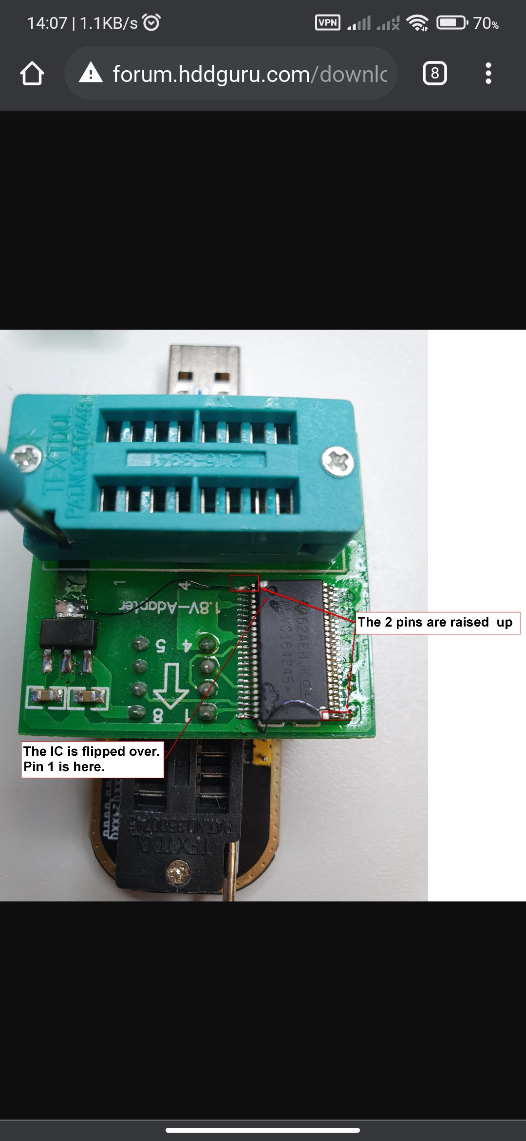

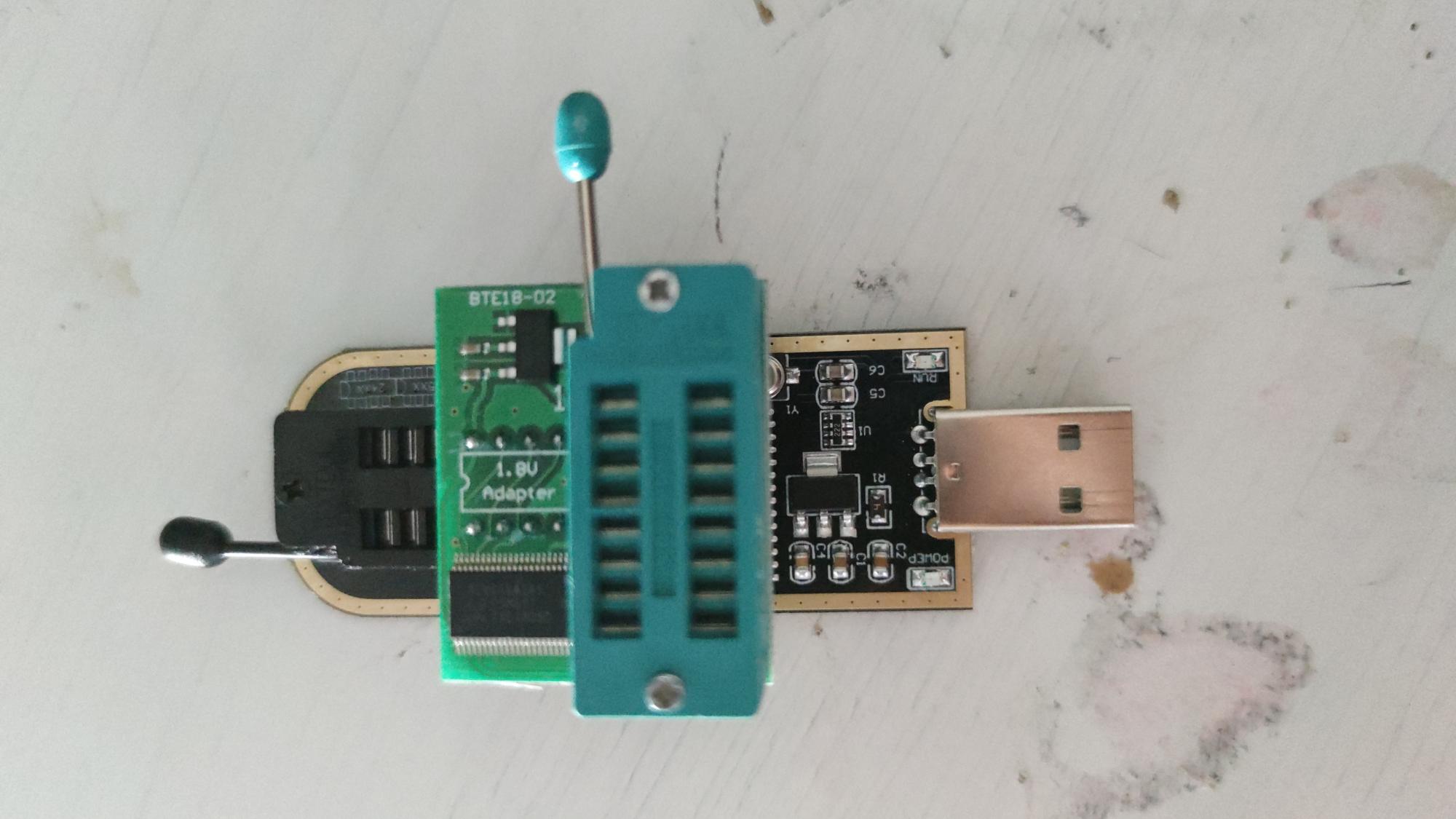

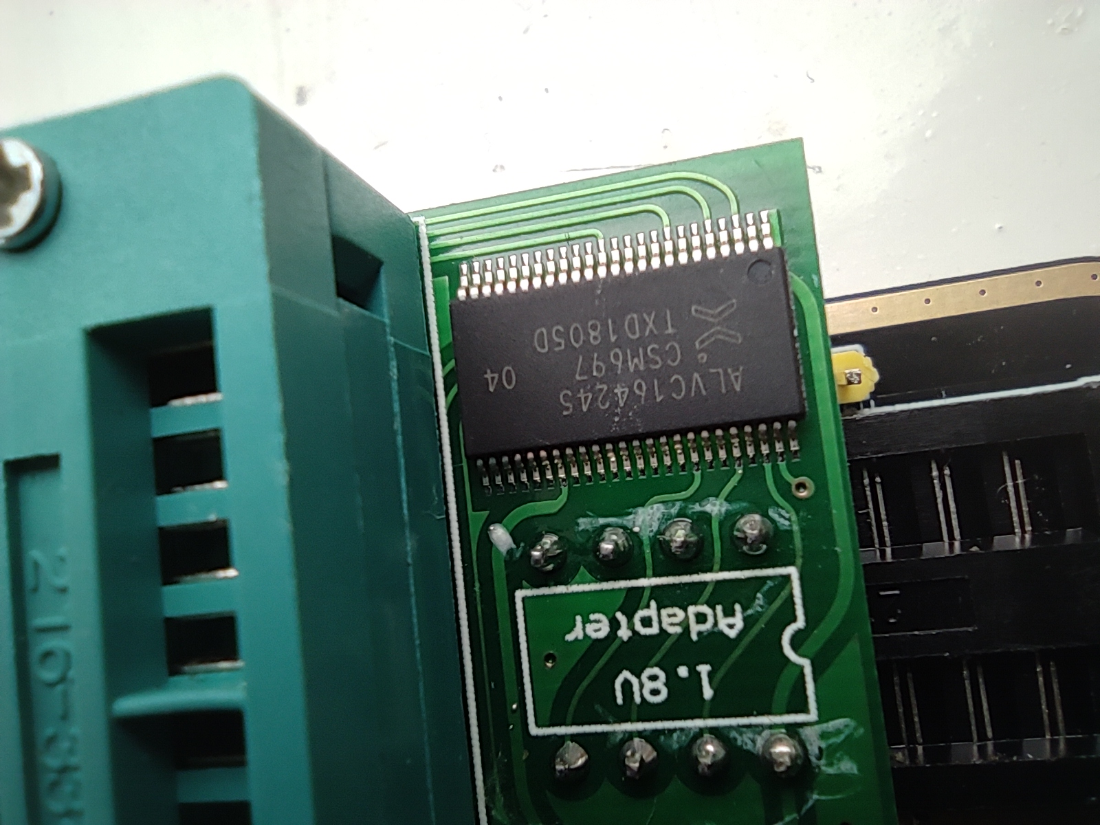

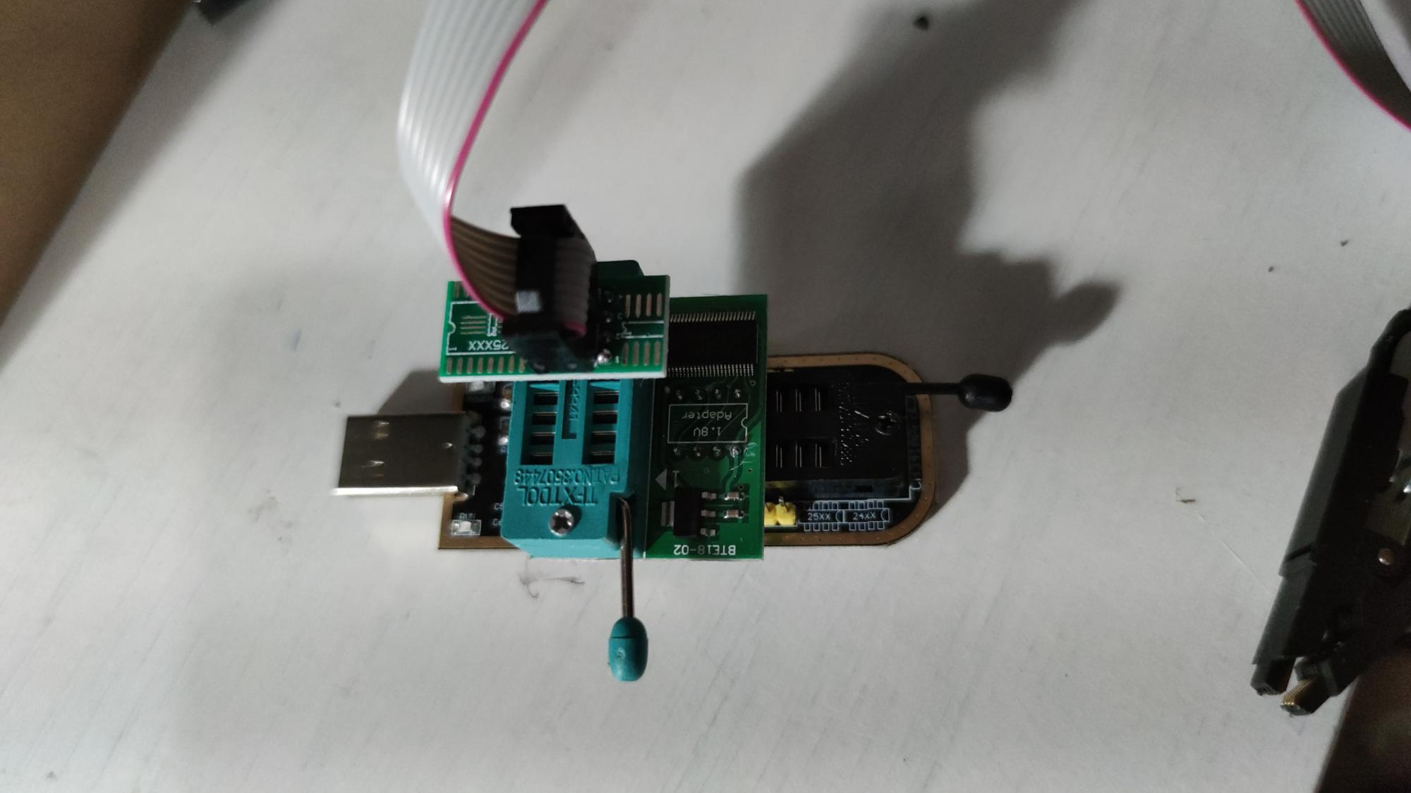

                                I tried 1.8 v adaptor. Still no detection. It does shows detect and try to detect but evenly says manufactory unknown. I cannot find chip in programmer uc list as well.. Plus searching across net I came across a post where they say ic in 1.8v adaptor is wrong ly soldered it should be rotated 180. I am attaching pictures of my configuration and also a picture from that post.
                                Any help please.

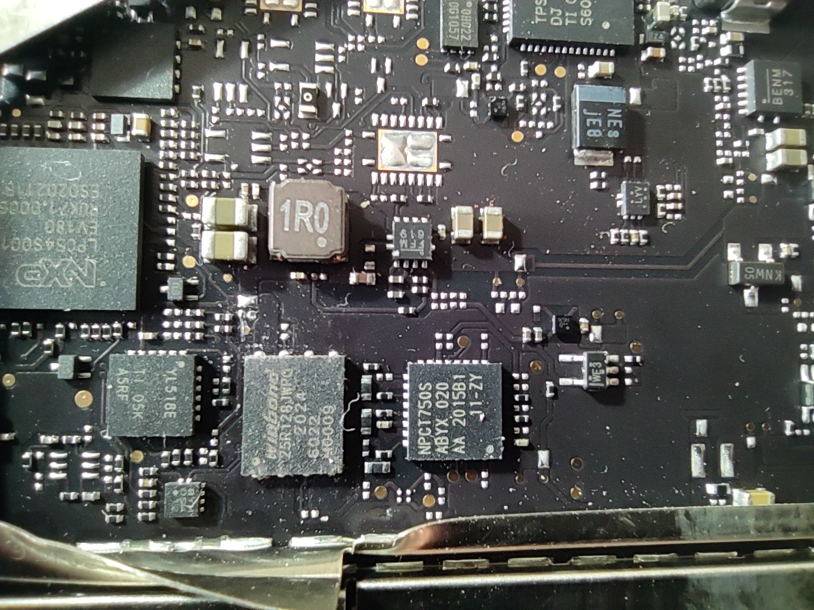

                                  And this is the chip in picture. Is Soic8 clip is ok to grab it fully as this bios chip doesn't have any leg.

                                    Pin 1 of your chip goes to the corner where the latch is. Ignore the picture in that software.

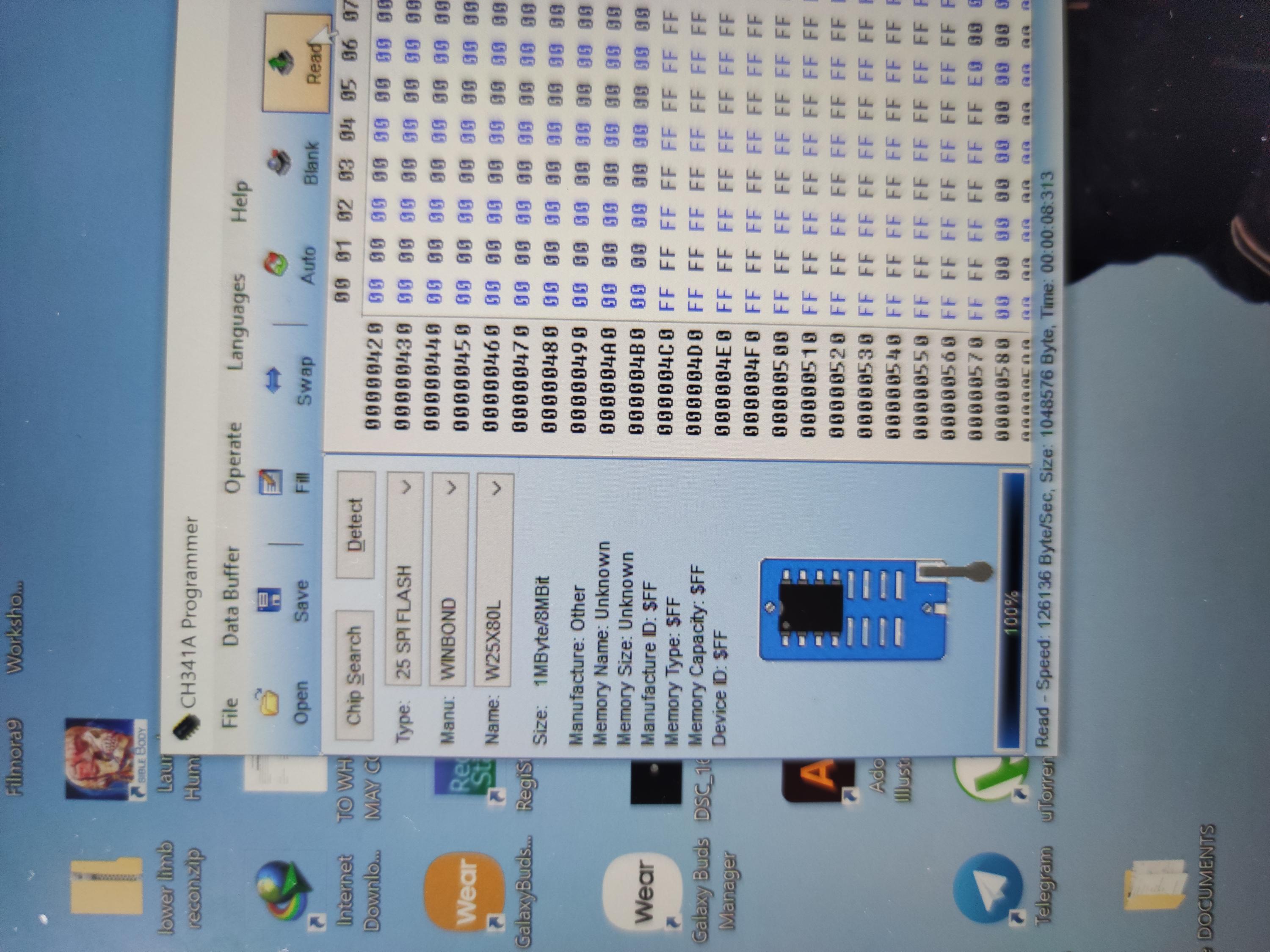

                                      Yesi have done everything. It does detect as 25xx soi at times but on reading only shows blank bios with oo or ff

                                        Re: Microsoft Surface Pro 7 NEED BIOS. HELP!
                                        I have tried my ch341 programmer on other chips. It immediately read and detected other chip first time. So there is some other problem. Can any one guide me how to add this chip to programmer software please?
